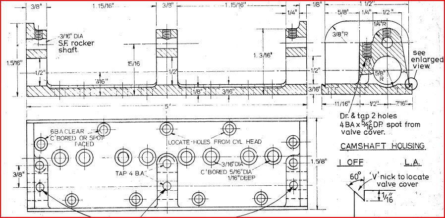

      Hi guys, I am about to drill the holes for the camshaft bearings in the aluminium casting of the Westbury Sealion.
      The part has three supports about 50mm apart and each support is 12mm thick. Length over all is 132mm. I was going to drill and ream using long drills and reams bought for the job.
      Is there anyone who can offer advice? This has to be accurate and right first time.

          Worth investing in a long series centre drill to start the central hole I have a 3" long 3/16" dia one which would be ideal.
          J
          EDIT I did at first read it as teh crankshaft and suggested between ctrs but deleted that when I saw it wa steh camshaft though looking again at the drawings a 3/8" bar may just do it without too much whip

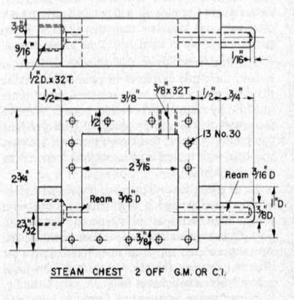

              I have a similar job to do on a gun metal steam chest, a reamed 3/16" hole through the chest 4 1/8" across with a 2 3/16" gap in the middle, main problem I foresee is starting the second half of the hole in a cast surface true to first.
              I am hoping a split point drill will not wander.

                I'm not quite clear about what you are doing but I had a problem with starting a hole across a steam chest. Like you I first reamed a 3/16 hole. I then took a length of 3/16 silver steel and, with it set in a collet. drilled a hole in the end to take the body of a No.1 centre drill which I then secured with loctite. This was very rigid and easily spanned the space producing an accurate starting point for the second half the hole.

                  The two faces of the central web can be milled flat first to help stop the drill skidding about and then try something like this or make an extension as Norman suggests

                      Just had another look at the drawing and I think you will have to go with a between ctrs bar to cut the 5/8" clearance for the cam lobes anyway so may as well do the lot like that.
                      This is the job for those that don't know, three 1/2" holes to take bronze bushes and a 5/8 clearance ( that should read 5/16"R on the drawing)

                        Following the views above I have found a No 2 centre drill (3/16) 5" long, so my thoughts are centre, drill and ream the first side then use that hole as a guide for second. Will all be done in the lathe, job held in collet chuck and with out removing the work piece.
                        A 5" + long centre drill should span the gaps in the Sealion casting allowing a straight hole to be drilled.

                                To make a guide , use either square or round stock, what ever will fit inside what you are drilling. Drill/ream/bore to suite the drill you are using. After drilling through the 1st, then put the guide into place. You will needs shims and clamps to support, or else you make a external packer to support it. You will know when it is correctly aligned as the drill will spin freely. Then drill the next hole and repeat.
                                Another way is to make a hinge drill jig. Like it says, it is a piece that had been drilled though and cut away or made up of segments like a door hinge,1 side only. The drill goes through the 1st hole of the hinge, the ist drilled hole is in the space, the drill goes through the second hinge hole as a guide, the last gap is where the part is being drilled.
                                It all depends on your drilling set up etc as to how it can be achieved. Long centre drills can be easy 0.1mm off centre.
