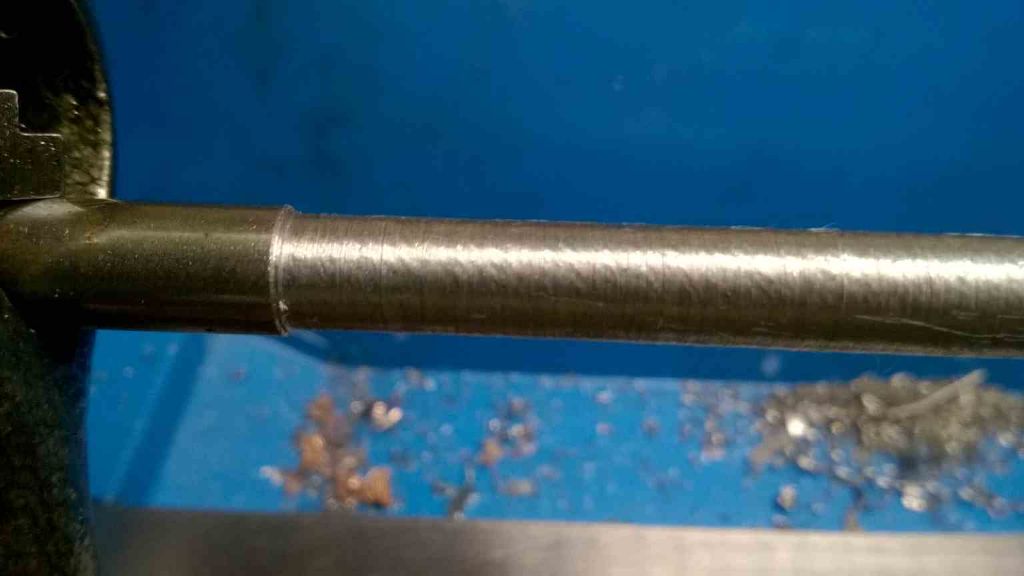

                              Thanks to all for the advice and my apologies for the delay in responding – the day job does get in the way…
                              I can fairly describe my first attempt at turning between centres as .. well pretty grim. The (10×200) bar ended up resembling an ice cream cone rather more than silky smooth test bar. It was 1mm thinner at the chuck end, oval at the tailstock end and corrugated throughout. My shame is shown below
                              Obviously a travelling steady is a minimal requirement! I also found that the tailstock was out. Most particularly it wasn't straight.

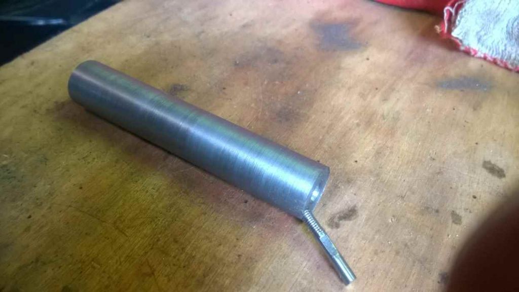

                              Anyway – after a little while off, I've had another go. THis time I believed I'd got the tailstock reasonably straight. Running the carriage along it with an indicator it was about a .03 mm further away from me at the tailstock end of the barrel (which was the limit of the adjustment such as it is). I got the centre in the tailstock fairly correct as well. Again .03 – .05mm out horizontally and .125mm vertically (which should affect the cut by less than .001mm according to my trigonometry!)
                              This time I used 20mm x 100mm and drilled and tapped a rod to put in the end to turn it per advice in this thread.
                              This is better. It's 0.3mm diameter out (smaller at the head end) and although a bit groovy, quite a bit better than the first go.
                              before I started I found that centre in the headstock was about 0.1 mm out (the spindle has no measurable run out on the face or inside the taper socket, so I'm assuming it's the centre). I turned a new end on it to centre it.
                              When I finished I check the tailstock alignment and it was quite clearly out, which is most frustrating. I don't know what is making it go off, but I feel a tailstock adjuster is likely to be my next project. Which I will seek advice on in the next post (or this will get silly long).

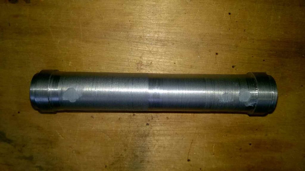

                                  If you set your tailstock as accurately as you can and the collars on your test bar are both the same distance from the end of the bar, then even with your inaccuracies the bar should come out OK as both collars are turned under exactly the same circumstances. That does assume you take the final cuts at the same setting after trying to get the collars as close as possible. This is how mine came out using this method, as near as my mike will tell me its 0.0003" out.:

                                      Hi, Neil. I'm presuming that what you've done is to turn the bar round in the lathe so you are machining each end with the carriage in the same place?
                                      That's a good idea for a test bar. Now to work out how to get the tailstock spot on …
                                      Hi Phil – Pannal, near Harrogate.
                                      Iain
                                      #222313
                                        Posted by Iain Downs on 23/01/2016 16:55:42:
                                        Exactly, and it compensates for a degree of tailstock mis-aligment.

                                            You may find that the blue paint is causing the front of the tailstock to lift slightly
                                            Neil.

                                              This is my version of Neil's test bar. The end pieces appear to be the same diameter to within the limit of my abilities to measure it (a electronic caliper claiming 0.01 mm resolution).
                                              On my first try I ended up with a noticeable difference despite not moving the cross slide. I put it back in and just re-cut about 4 times each end at quite a slow speed (200rpm?) each time taking the merest sliver off. Is that the right approach? I'm using a carbide knife tool,
                                              MY first go a the collars I did at high speed (<1000rpm and my first run in top on this machine), since I thought this would give a better finish. It really didn't and furthermore the lathe shook somewhat. Is this something which is acceptable? Do I try and balance the spindle and work piece with a dog bolt on the other side? Should I be trying to cut fast?
                                              Anyway. I'm quite pleased with this, though I'm scared that I will go out later in the week, re-measure and find that I was 1mm out in my measurements and it's all rubbish!
                                              Thanks for all the advice.
