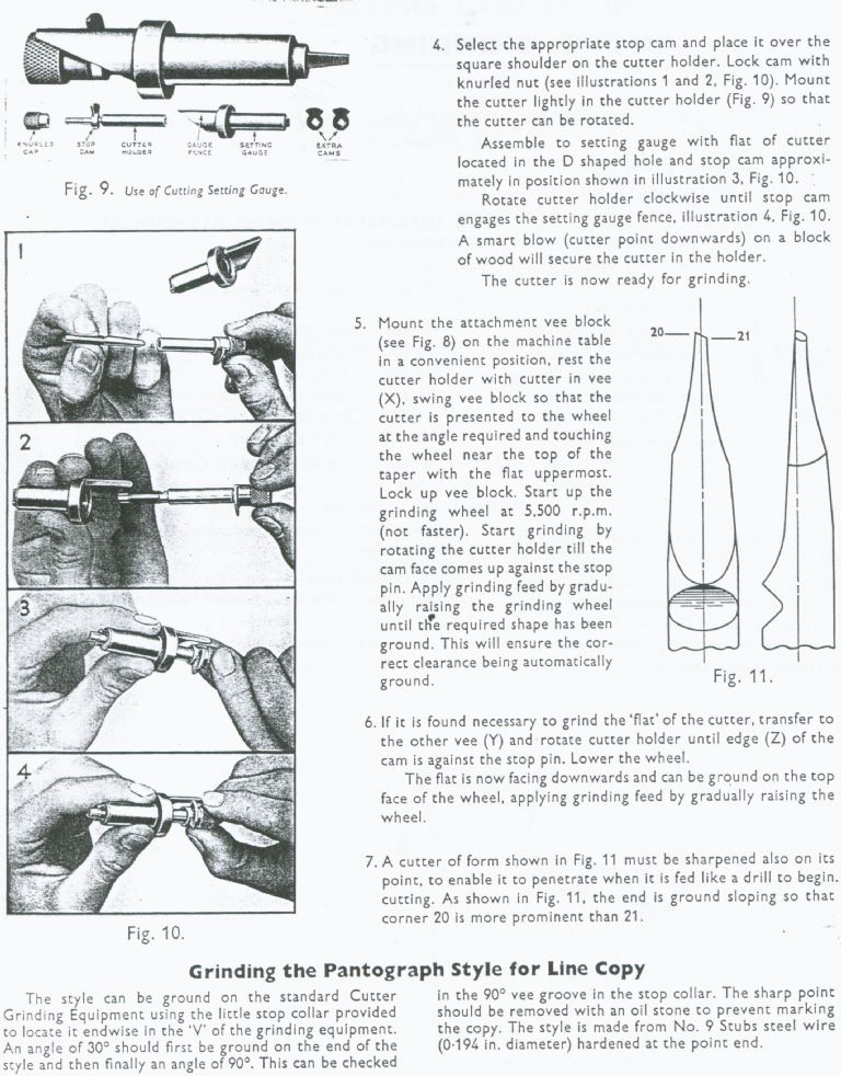

                        Clive, I thought there were a set of cams to provide back-off to the cutting face when the cutter was rotated so no further secondary clearance was needed.

                          No its definitely not a drill sharpener, the auctioneers dont know what it is and that is their best guess.
                          The previous answers are correct, it is for sharpening single lip engraving cutters with the correct angle and relief.
                          This is the cutter holder details.
                          I have a David Dowling one which is very similar in principle to the Taylor Hobson, but unless you are grinding engraving cutters it is of limited use, it is possible with a fair bit of work to modify it into a general cutter grinder of sorts.
                          Phil

                              Given that most of these grinders will have lost the holders illustrated above and the many regular T&C grinders used by MEs won't have such anyway I think an MEW design for handling engraver bits is called for.
