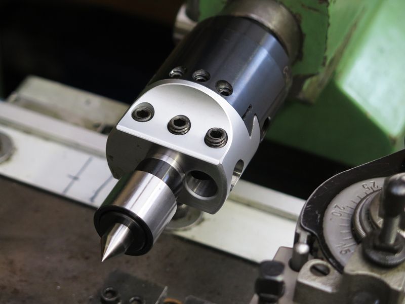

First thing was I had to buy an MT3 adapter to fit my lathe tailastock as my mill fitting is BT30. It was just a matter of screwing the boring head off that and fitting it onto the MT3 one.

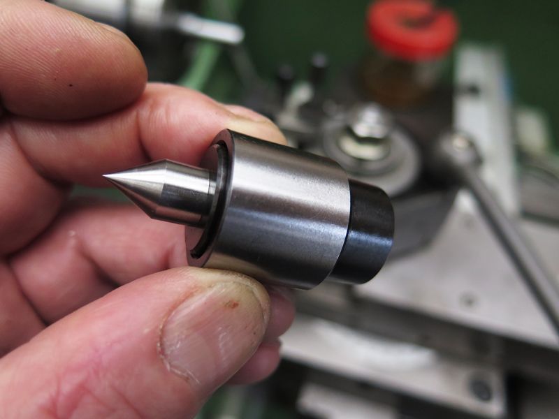

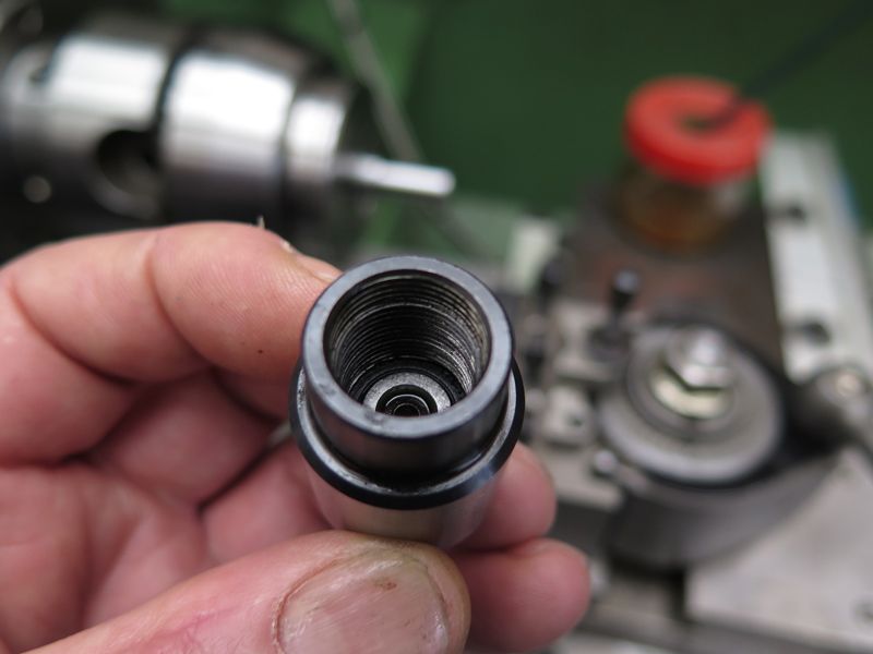

I purchased a small live centre that had a M14x1 thread in it. I imagine a straight shanked dead centre would also be fine.

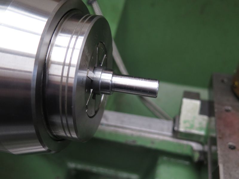

Turned a 1/2" section that would be a nice snug fit in the boring head.

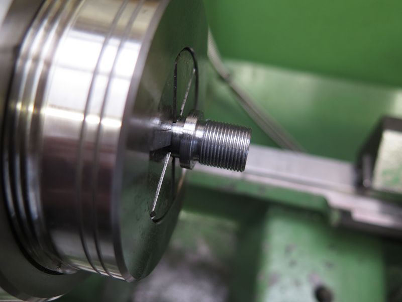

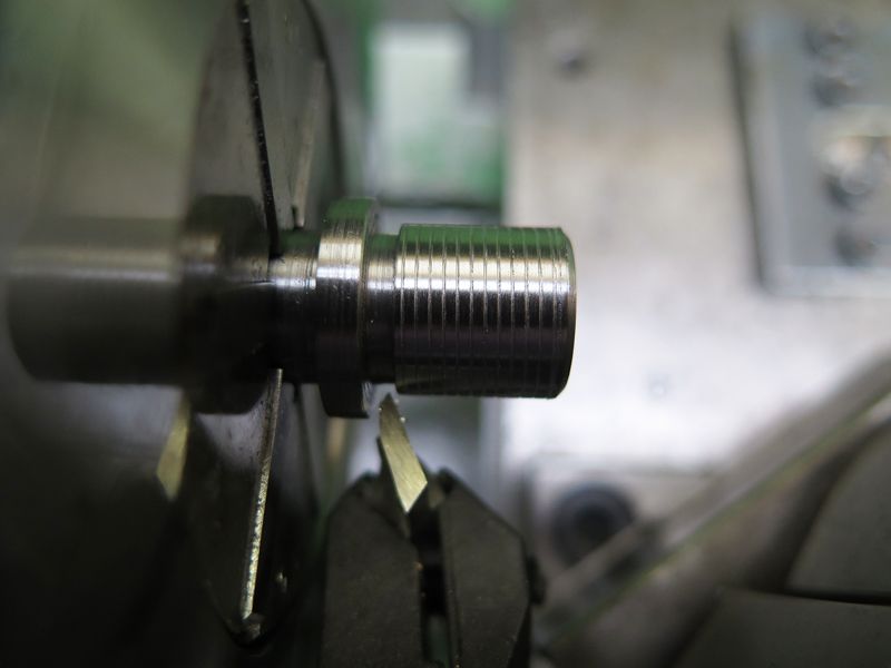

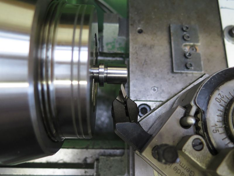

Reversed it in the chuck, turned to 14mm dia, trimmed to length and cut a recess for the threading tool.

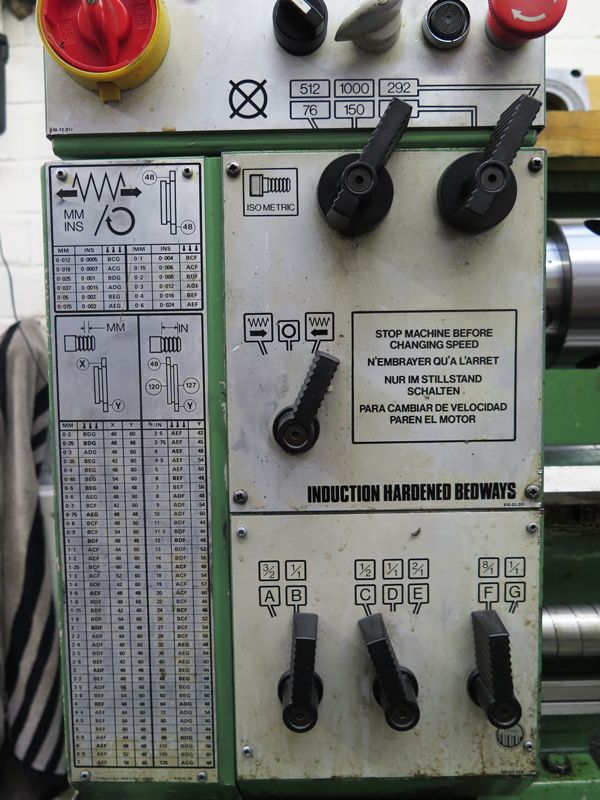

Correct gear settings on my lathe for a 1mm pitch is B C F
Scratch cut to make sure.
And a firm to turn onto (so ever so slightly tight) thread.

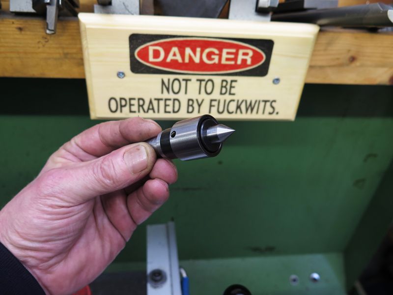

Boom.!
Slotted a flat in the 1/2" shank for the boring heads grub screw to rest onto.

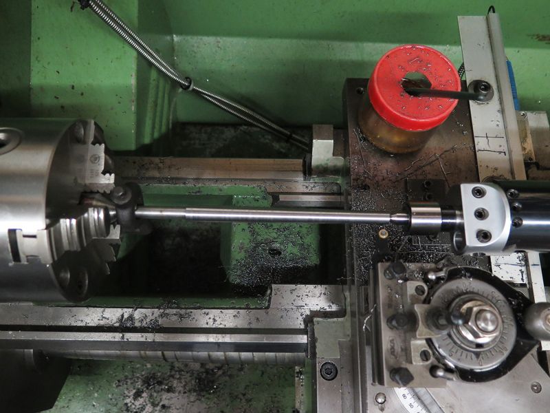

Time to try it out.
The taper length on a scrap bit of steel is 5 1/2" with a diff in dia of 125 thou for a quick test. Obviously for short tapers one would be better off using the top slide at and angle.
I have no idea what sort of angles and depth of cuts can be taken before one starts kicking the hell out of the boring head. Perhaps others that have done this can advise.
