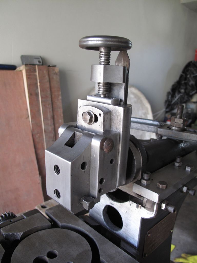

      h 012.jpgYou've never let me down so far, so here's another, doe's anyone know question.
      Doe's anyone know where I can source one taper pin 2.750'' long by 0.350 at the large end, its for a clapper box pivot pin, which has to be better that the coach bolt that was acting as a pivot when I bought it.
      Picture of the cleaned up and repaired tool slide.

        #98401
        Martin W
          @martinw
          Mick
          It may be a stupid question but why a taper pin? I would have thought that unless the taper ran through the clapper box and clapper (tool holder) then the clapper wouldn't be supported properly. If the taper was continuos then any sideways movement in the pin or clapper could cause the clapper to jam on the shaft ; it may be that I am just being naive blush!
          Would it not be better to ream a parallel hole through the box and clapper and fit something like a ground silver steel rod to act as the bearing spindle. This could be secured using screws tapped into the clapper box and fixing against flats on the silver steel rod.

          #98402
          Clive Hartland
            @clivehartland94829
            I should think a taper pin would not have the needed Tensile strength for a Clapper box pivot and would do as Martin says.
            A ground Sliver steel pin with perhaps two grooves and a circlip at both ends. A floating shaft would be better that a |Taper pin which would need to be secure in one part, but which part?

                #98407
                mick
                  @mick65121
                  Clapper boxes are always pivoted on a taper pin, the bore through the tool slide and clapper box is 1deg included, which will ensure smooth operation without any movement around a parallel pin, which might be transmitted to the work surface via the tool bit.

                      Ady1
                        @ady1
                        Seems to be standard practice, even on the tiny hand powered adepts

                              #98427
                              Sub Mandrel
                                @submandrel
                                You learn somethinge every day! When you don't, you are dead
                                #98431
                                Ian P
                                  @ianp
                                  I too have learnt something today.
                                  My first thought whan I saw the post was, why would anyone want to use a taper spindle? a conventional parallel spindle looks the obvious solution. Having followed the link I now know that a taper spindle is absolutely normal for a clapper box. I can imagine a variation of the idea using shims to change the axial relationship of the two parts to eliminate the need to have a reamer whan adjustment is required.
                                  I would have though that a clapper box bearing arrangement would not be in the least critical. In use any backlash or play would be taken up the moment the cutter tip hits the job. The clapper box will be pushed back against whatever stop it has, and as long as it hits the same stop every cut, the cutter tip will sit in the same place for every stroke.
                                  My curiosity is aroused now ! if a taper pin in tapered hole makes such a good spindle, why isn't the technique in much more common usage?

                                          #98506
                                          Ian S C
                                            @iansc
                                            The taper pin in the clapper box is a tight fit in the box sides, and a loose fit in the clapper (use the oil hole each time you use the machine). When the clapper becomes too loose, DON'T tighten the pin, you'll break the box. Ream the box and clapper and fit a new pin, the pin has a nut on the small end, this is just to stop the pin backing out of the hole. Think the most usual size pin is #8, it needs to be turned down at the small end for 1/2" to take a 5/16" thread. The nut should be counter bored, so that it can bare against the side of the box. Assemble with a light whack with a hammer, fit the nut and get shapeing.n Ian S C

                                                #98676
                                                Ian S C
                                                  @iansc
                                                  Once you have the pin (and unless you have one, a reamer), you will need to turn a 1/2" length on the small end to take a 5/16"/ 8 mm nut, see my previous entry. Ian S C
