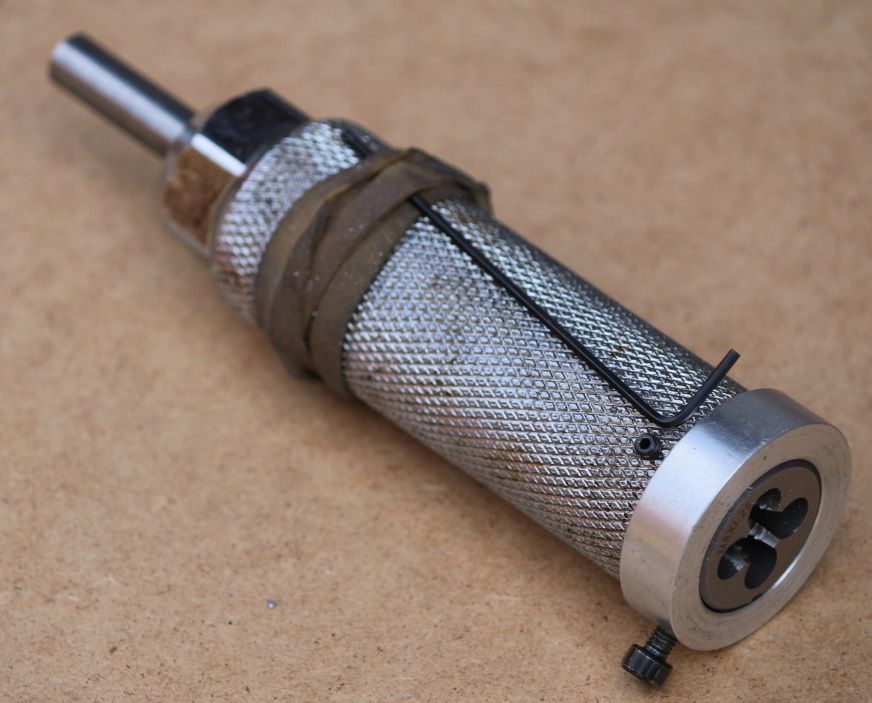

                  I made my own die holder with inter changeable heads for different size dies. For the smaller threads I normally hold the small diameter at the back loosely in the tail stock drill chuck and under power grip the knurled body to cut the thread while allowing the small diameter to slide in the drill chuck jaws as the thread is being cut.
                  For larger / coarser threads the above method will not work so here I rough out with a single point tool and finish with the die holder but as my lowest speed is a bit to fast for my liking when thread cutting I turn the power of to the lathe and use my trusty home made spindle mandrel made from a Halford tyre lever, a bit of broom stick handle and other sundry scraps.
                  Rik
                  PS The die holder body is made from a foot rest from the rear wheel on a BMX type bike.

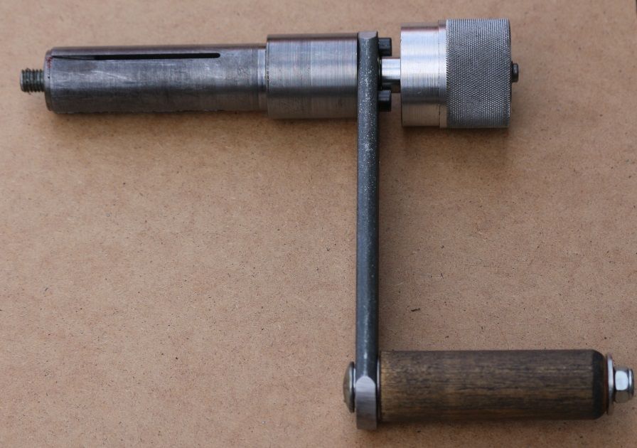

                          Sprung loaded mandrel  handleMy tailstock holder i made is the sliding type , And I use a sprung loaded handle for safety reasons
