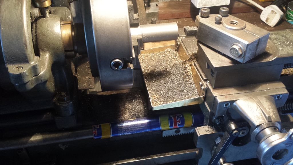

          Hi Jon,
          This works well for me
          A simple alloy tray, keep it low profile so it will pass under your largest chuck.
          Two lugs are screwed to the back. These locate in the end tee slots and are secured in place with two brass screws, one through each lug.
          The leadscrew guard is cheap and cheerfull but very effective. Other brands are available!!!
          hope this helps Geoff
          #493980
          jon hill 3
            @jonhill3
            Hi Geoff
            Let me get this straight the swarf tray screws into a couple of t nuts, which are themselves held in the slots by grub screws…..
            Like the leadscrew cover, perhaps a famous brand of stout might be more to my liking. wink
            #493994
            geoff walker 1
              @geoffwalker1
              No Jon,
              They're not tee nuts just flat lugs cut from 6mm flat.
              Cut to the same length as the width of the tee slot and attached to the tray with two small screws.
              They slide into the tee slots. The round head screw is tightened which lifts the lug upwards and clamps it in place.
              The tray is set up so it just clears the bed.
              Geoff

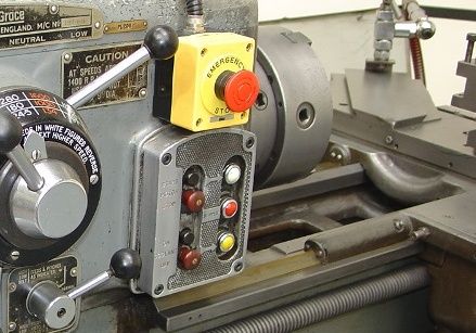

                  I am thinking about making some extensions that bolt to the saddle as used on Dean Smith & Grace lathes.
                  Geoff's idea is great though and I'll look into a version of that too…

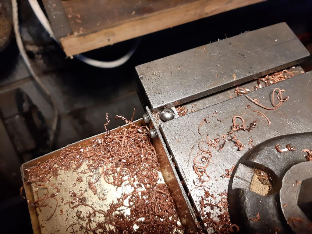

                              Mike Crossfield
                                @mikecrossfield92481
                                Picture shows the swarf trays on my Super 7. The front one is held on with a screw into the hole normally used for the travelling steady. I think the hole is there on the ML10 as well.
                                Mike
