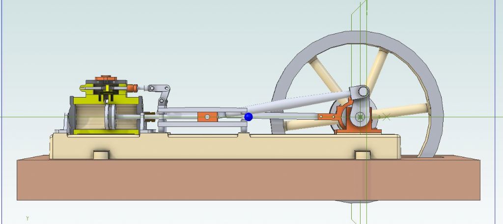

      I'm just starting to build a Stuart Victoria engine.On examining the drawngs, I'm slightly surprised that the crankshaft is positioned 1/4" above the cylinder centre-line. Does this height difference have a noticeable effect on the running of the engine, eg a slightly uneven exhaust beat. Do any other Stuart horizontals have this feature? Just curious.

          Should not be. The ctr height of the hole in the main bearings is 5/8" from bottom. (wrong on the 1993 drawings) The ctr line of the holes in the cylinder support brackets are 5/8" from bottom and adding up the various bits of the cross head guide put the cross head pin 5/8 up.
          Horizontal green ctr line runs straight through all three points
          You may want to have a look at this thread where depending on what drawings and or book you are working from there are errors, I'll going to post a set of corrected drawings soon if you can wait.

            Thanks Jason. I have the 1993 drawings. I had read the linked thread where discrepancies were pointed out but these seemed to relate to the longitudinal positions of the cylinder, slide-bars etc. I've fabricated the bed and was intending to measure up as the job progressed and make items such as the con-rod to suit. However, my drawing clearly dimensions the main bearings at 7/8" above the bed compared with the cylinder at 5/8". Scaling off the drawings also confirms these figures, the draughtsperson must have been having a bad day. I'll make my bearings 5/8" as you advise.
