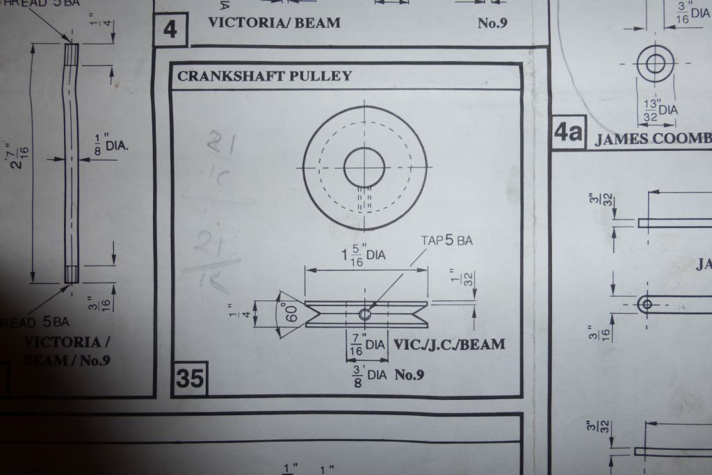

      hello has anyone built up the beam engine governor kit ? I have the casting set but no instructions . I am working on the crankshaft and it would be useful to know how big the pulley needs to be . ( be useful to know how to put it together !!!!!! a plan would be the answer &nbsp
      regards Phil

        #215198
        Steve Withnell
          @stevewithnell34426
          The Stuart Governor kit is a one size fits all affair, so don't want to part with my plans, but here is the crankshaft pulley to keep you going –
          Steve
          #215204
            Goes together so it looks like this
            Don't have my drawings anymore but you should be able to buy a set from Stuarts

              #215208
              phil burley
                @philburley12227
                thanks for the information , I havn't tried Stuart's because the plans aren't listed anywhere but an email might find out if they are available
                #215209
                  Bottom of page has the governor drawings
                  #215249
                  phil burley
                    @philburley12227
                    oh great thanks , why couldn't I find that !!!!!

                          #215564
                          phil burley
                            @philburley12227
                            plan sent overnight from Stuart Models . that's good service
