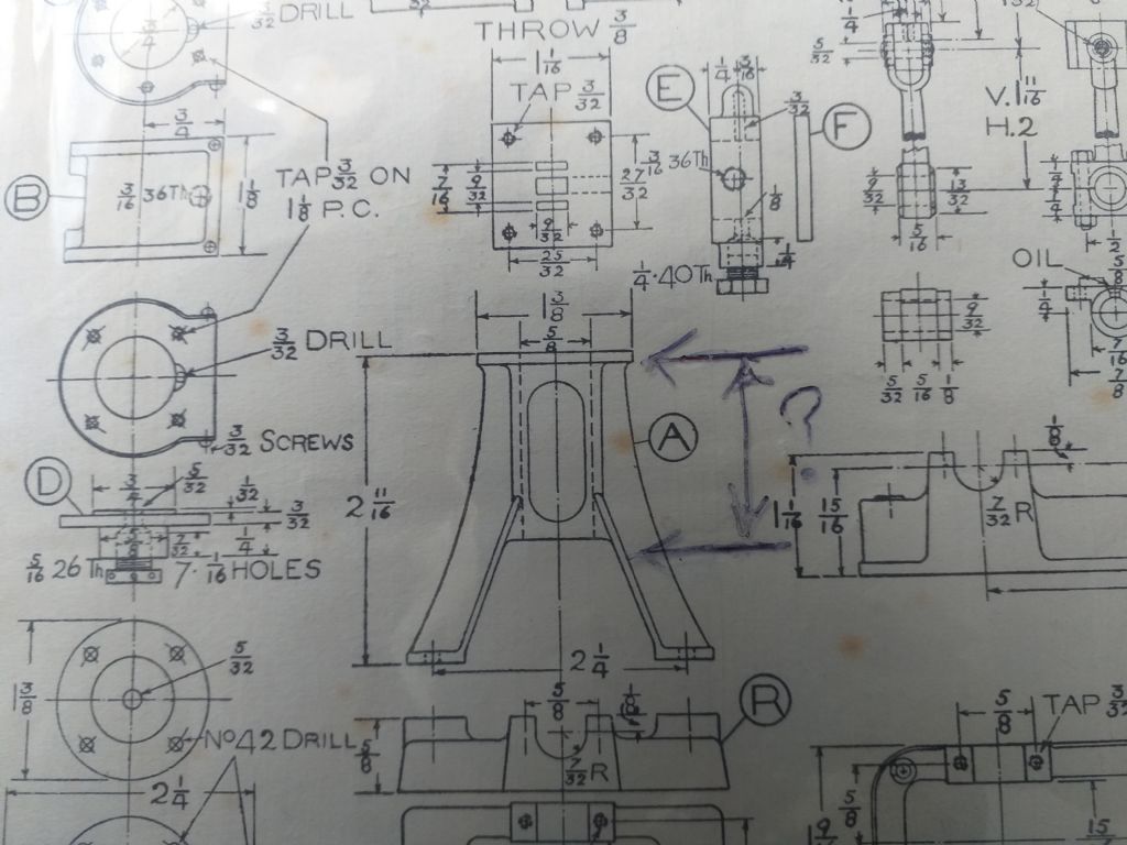

      Hello all, I picked up this booklet from 1940 of the castings needed for a Stuart No 10, the dimension needed is part A , marked with two arrows. Also I would like to add the reversing gear has anyone got those please. Interesting the set of castings cost 8/6, the finished engine was £2-10, around 200% inflation to today's prices. I know the rough size but I want to get it correct

          It's not critical just leave as cast. Aim to get the top flange 1/8" think provided that does not make the feet too thin and just leave the trunk guide end cast.
          But if you are fabricating the 1 5/8" would be about right.

            If I read it correctly the only dimension you should concern yourself with is the over all height from the bottom of the feet to the top of the cylinder flange – 211/16. As it is a casting the bottom face between the legs can be dresseed & left as is. IIRC on my S10 I only dressed the bottom to remove the rough casting. Others may have differing comments.
            George.
