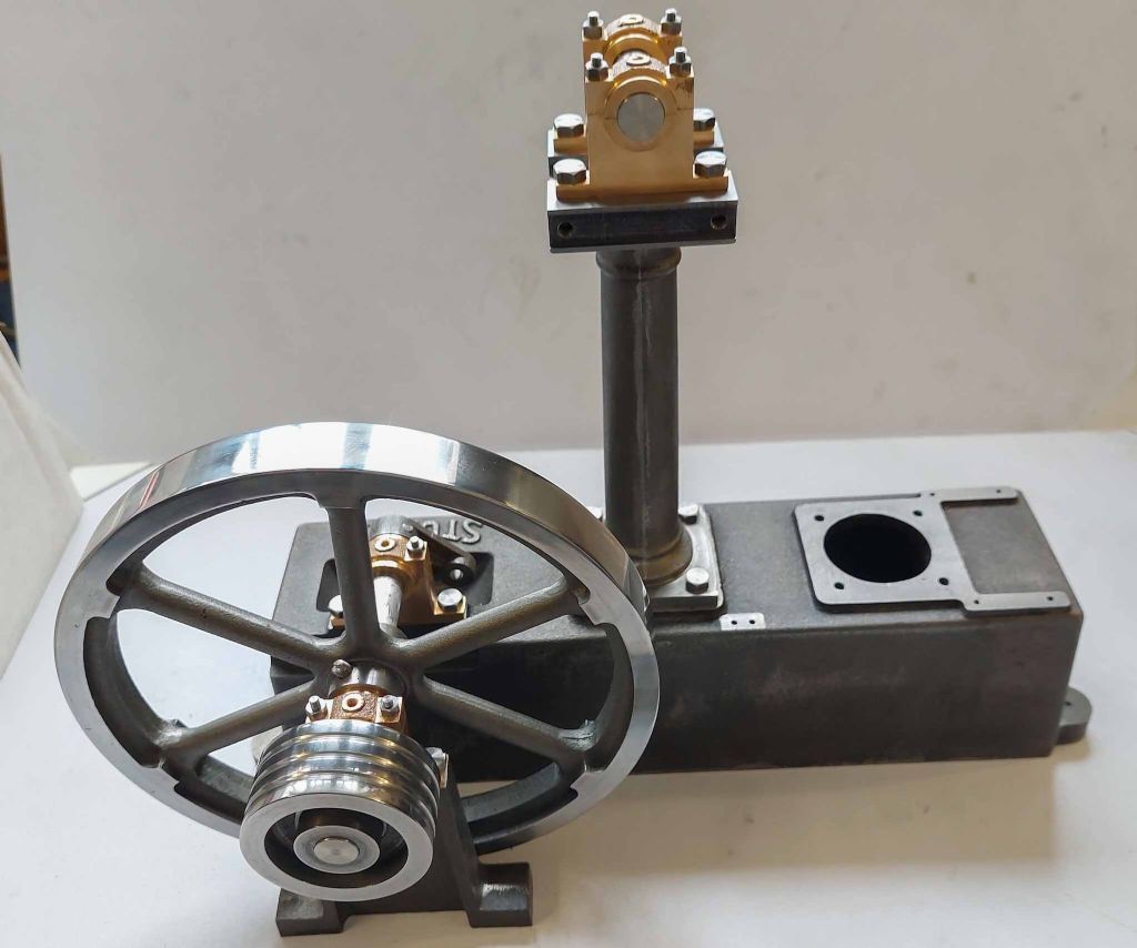

      Good Morning,
      I am working on Stuart Beam engine and Governor casting kits. The picture below is my progress so far.
      I have previously made a 10v, the Beam is my 2nd engine so I'm still a novice.
      My question is regarding the Governor crankshaft pulley, I'm thinking of making the pulley with double the circumference than the plan says. Just wondering if anyone has any ideas if this will work.?
      My reasoning is that I have seen youtube videos of Stuart beam engines running and they seem to run very fast with the Governor fitted. I'm wondering if I make the pulley twice the size and spin the Governor twice as fast the engine will run at half the speed?

          Governors do not scale easily. There was an article by Tubal Cain (the English one) in ME a long time ago. I might have a scanned copy, I'll have a look tomorrow

              Or you could reduce the air pressure, or steam pressure as the case may be. A small cheap pressure regulator sold at hardware stores for regular air compressors will supply down to a few PSI, on which model engines will chuff over slowly quite happily. If running on steam from a small boiler, a throttling valve right at where the steam leaves the boiler works well. Dries the steam nicely too.
              #631238
                You really only need a governor if the load on the engine is changing. I most cases they just get run for display in which case a low VOLUME of air/steam will slow the engine. Speed like on full size is controlled by regulating the flow not the pressure.
                But if built well with no tight spots then you don't need much pressure for display, it's only when the engine needs to work that you need to use higher pressures 5psi should be enough for display and the push fit pneumatic flow valves work well to adjust engine speed.
                Running the governor faster will increase it's effectiveness but there are still a lot of losses due to friction in the linkages to overcome and the sprung belts are not the best for transmitting an even drive so best treat the governor as eye candy unless you intend to have varying loads on a working engine.
                Also bear in mind that this is a model of a small beam engine not a massive great pumping engine so it would have run faster than what most people think of as a beam engine though you do still get people thrashing them.
                Edited By JasonB on 29/01/2023 07:59:52

                                    In a full size situation the governor is mainly there to keep a constant set RPM – ie the working speed. If the engine for what ever reason speeds up the throttle closes and if a load comes on slowing the engine then the throttle opens up to bring it back to the set RPM
                                    From a model perspective it's difficult – though not impossible – to achieve that but if a model engine is just for display then it's probably best to just ignore the throttle and let the governor follow whatever speed the engine is run at.
                                    Increasing the governor pulley diameter relative to the drive will slow things down but even with a perfect throttle is very unlikely to achieve the result you are after.
                                    I have made three engines with governors – the first, a twin Victoria had a throttles of my own design rather than the butterfly type recommended. These were on each steam chest connected by a common shaft. These were a barrel type similar to an RC carb. The second was on a scaled up Waller engine, again a barrel type and the third on a Corliss engine that controlled the timing of the valve opening.
                                    All worked to a degree, the TwinVic the best of them – if a load was applied to the flywheel the governor would operate the throttles or valve gear but not enough on any to call a 'successful' governor.
                                    The key from a model point of view is 'Throttle' – I'm my view its difficult to make a really effective and efficient throttle – especially the butterfly type – that works smoothly and efficiently relative to the governor speed
                                    It's each to his own of course but a lot of time could be spent trying to make an effective governor set up to run the engine at a constant speed when for the most part it's visual effect that's required. In that case a governor that just goes round at a speed relative to the engine speed is all that's really required.

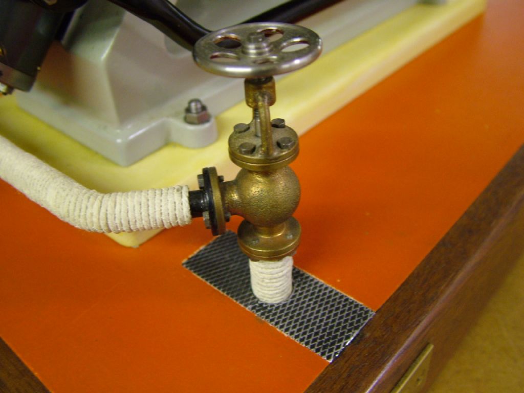

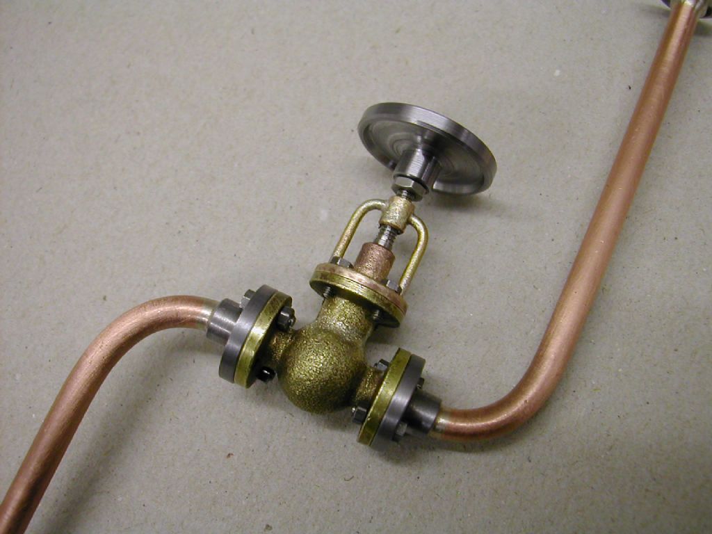

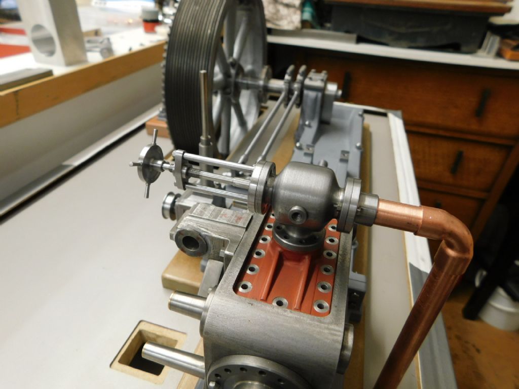

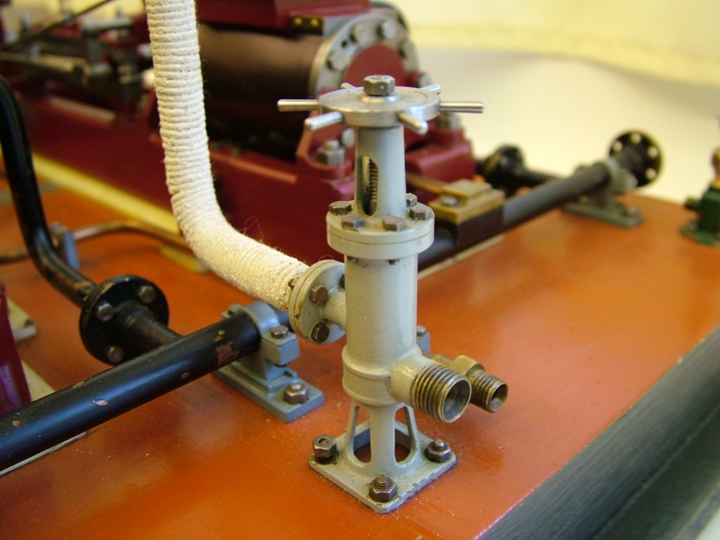

                                              Jason is right in that controlling the exhaust outlet does slow the engine but why not do it at the correct point – at the inlet
                                              There's a big difference between the 'throttle' operated by the governor and the 'steam inlet' or to be correct the 'Stop Valve'
                                              The governor throttle is usually shown as a simple butterfly valve but the difference in movement relative to the airflow is very small indeed. Most, though not all, full size stationary engines have a stop valve to open the engine to the steam pressure but it's the governor that sets the speed, either via a throttle or by affecting the valve gear opening period. A stop valve is much the easier option to control speed on a model. Relatively easy things to make to be in keeping with the model a bespoke one gives a lot of satisfaction but a commercial ME sized valve is fine.
                                              All engines made so far have a stop valve to control the airflow and speed of the engine irrespective of incoming air/steam pressure.

                                              Here are some valves made to suit
                                              The Twin Victoria
                                              The Lang Bridge engine
                                              For the Waller engine

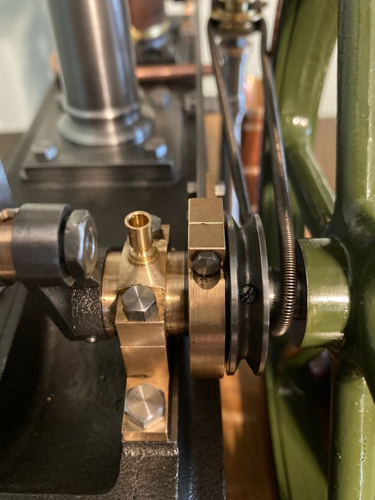

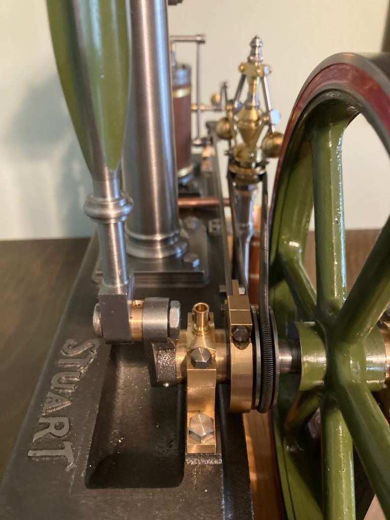

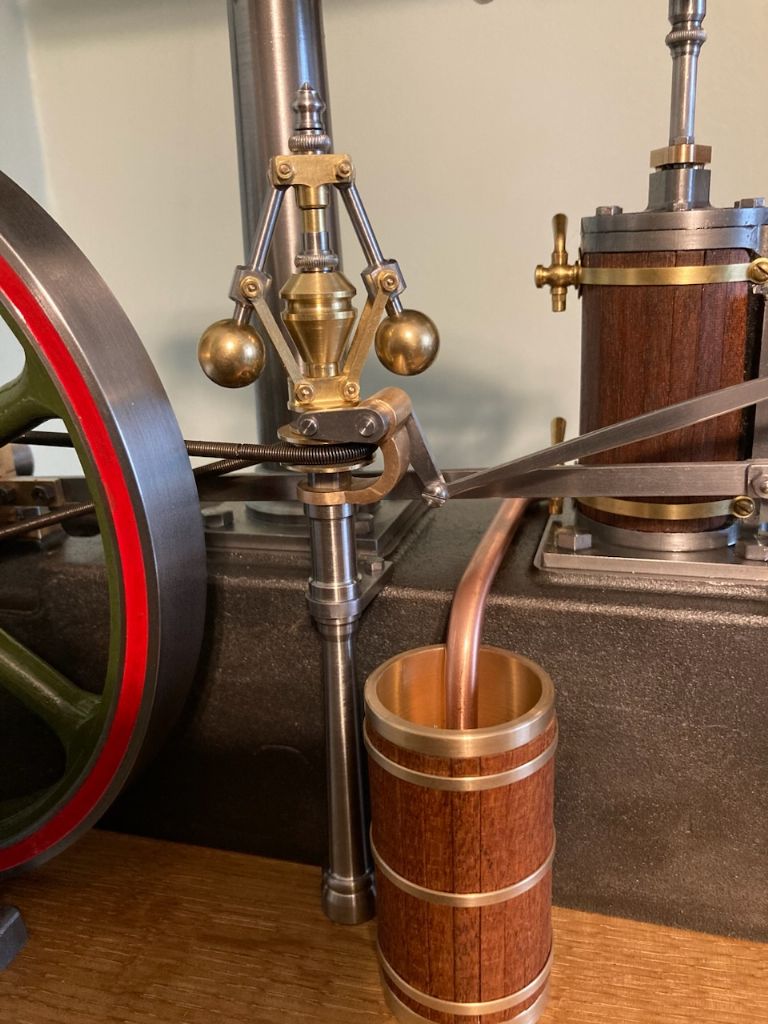

                                                Your engine is looking great. Regarding the governor, mine begins to do its job at approximately 200 rpm. I used the Stuart ratio which is if I remember correctly, approximately 1.75:1. My governor’s balls are scaled down 20% and I substituted a weight for the spring and made other changes to improve efficiency and hopefully improve the appearance. I prefer to run mine at about 60 rpm, so the governor is not doing anything more than revolving.
                                                One additional note about the Stuart governor. The drawing has you making an eccentric with a grub screw in the center and a separate pulley to drive the governor. This makes valve adjustment a problem because you have to dismantle the eccentric strap to adjust the timing. I simply bored the pulley out large enough to mount it over the cylindrical portion of the eccentric and use a single grub screw that is in the center of the pulley.
