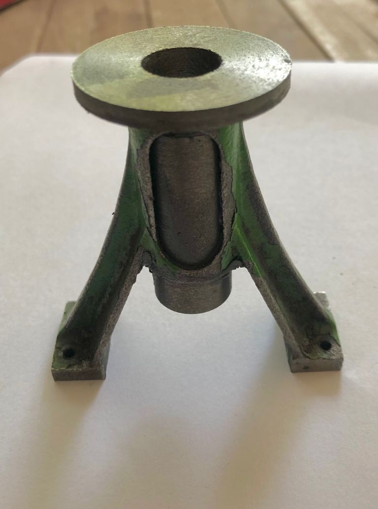

      Here I have attached the new parts for the standard now waiting to cure before final machining.

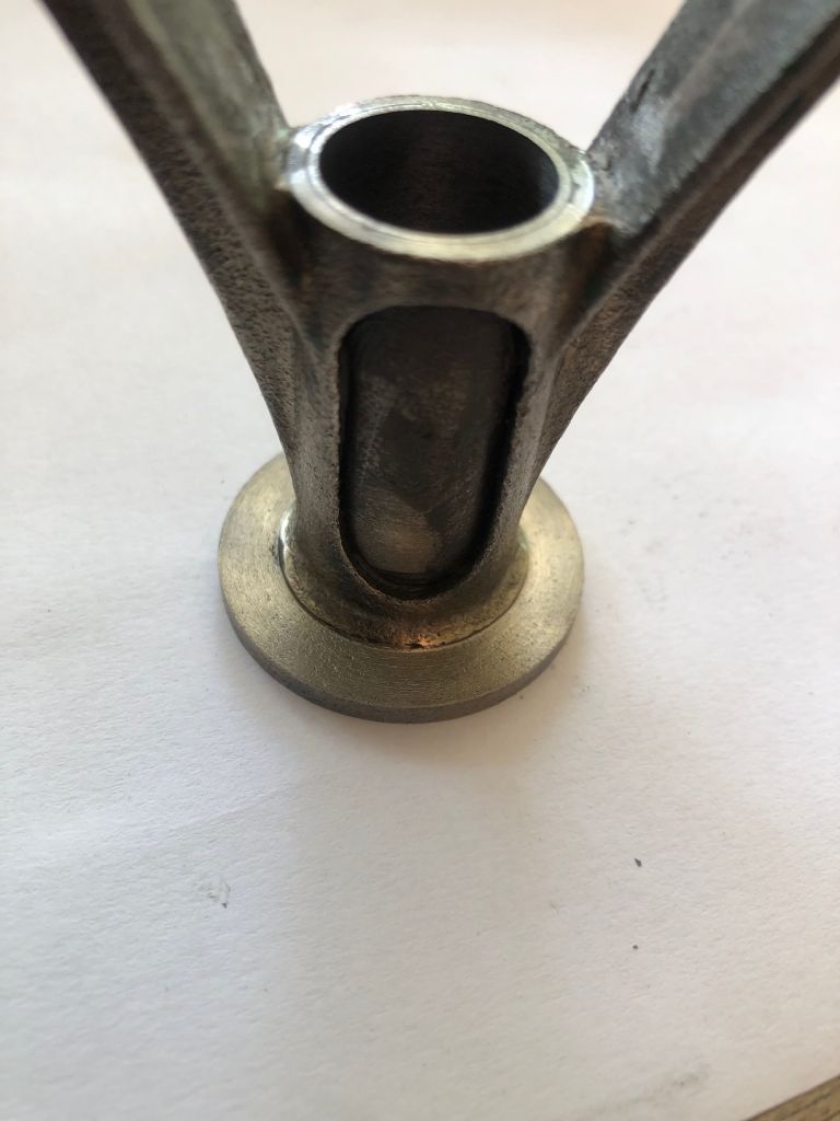

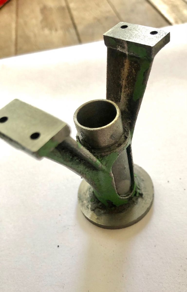

        This morning almost finished the standard just to remove sleeve from the side ports, haven't decided whether to mill them away or drill and Dremel them away and a little fettling.
        I have removed all old paint and have to now think what paint to use as I am in Thailand it is a bit short on choice, i can use Tamiya paint that is used in models but I need to check if it is good with metal first, it does say it is enamel.
        Next, is the color will it be Stuart green or a Maroon, any suggestions?

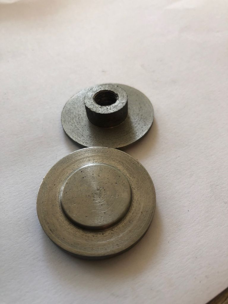

        A bit of a schoolboy mistake today on the bottom cylinder cover I was finishing off and I thought that I still had some metal to remove on the thickness so instead of taking it out of the recessed aluminum to check I had 1mm in my mind and it was removed so I will be looking for another bit of cast iron to make a new one a bit of a case of too much hurry and not cross-checking felt a bit stupid with this one.
        All in all, i am quite pleased with the outcome so far.

              I have just finished machining the cylinder and the covers for a Stuart 10V engine. It's been hidden under the bench for years in its original packing. In some ways I could have wished I had left the length of the cylinder a bit oversized to accommodate a slightly longer spigot on the 3/4" diameter of the covers.
              To my mind a spigot length of only 1/32" is a bit mean. It means that the lathe tool has to have a sharp corner as there is no room for an undercut on the diameter to clear the corner of the cylinder bore. You cannot put much of a chamfer on the bore otherwise you lose the location. I suppose that I could have cut a relief into the face of the cover rather that the diameter, but I did not think of that solution until after I had finished the machining!
              As it is, I have made my spigots a rather "full" 1/32" long and intend to adjust other dimensions to suit. The 5/8" diameter spigot at the other end of the lower cover is no problem as it is long enough to accept a small undercut in the corner.

                For the holes in the top and bottom covers, I see in the Stuart Turner drawings the top cover has 5 holes on a p.c.d on both.
                In the book (Build a vertical steam engine) it indicates the top cover as having 6 holes and the bottom cover as having 4 holes
                Would there be any reason that the author Andrew Smith has stated 6 holes on the top cover?

                    Top pattern does nor really matter, on that size engine 4,5 or 6 would do provided you arrange them to clear in inlet passage.

                      The original Stuart Turner (Henley) drawings for the 10V and 10H gave 6 holes for the top cover and 4 for the bottom cover. The later drawings give 5 holes for both covers.
                      When I machined mine I did 5 holes on the top cover, but retained 4 holes for the bottom cover as my castings are very old and the two ribs on the standard go right up to the top flange. This would mean that two of the holes would be very close to these ribs, making the nuts awkward to fit. I did not want to machine these ribs away as I thought that it looked better with them, I am not intending to fit drain cocks on this model so the position of the holes was not an issue.
