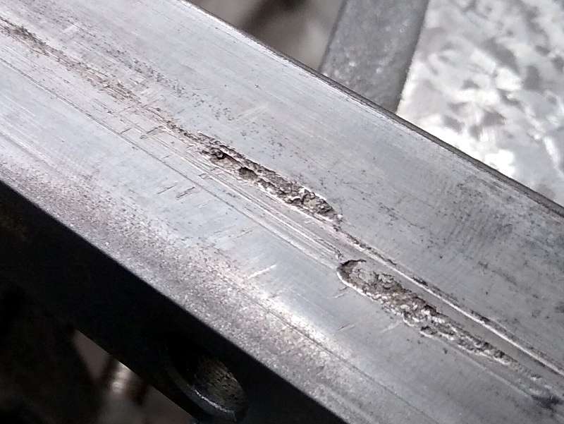

      Hi, having recently bought my 1st ‘proper’ lathe an ML7 I’ve just started making chips. I’ve been watching a guy (Steven Jordan I think) on YouTube and following his idea of grinding 3mm off the back of a toolpost holder so I can use 12mm stock.
      Its my 1st machining since 1980 and loving it. I’ve noticed that the compound slides movement is VERY stiff compared to that of the cross slide. Is this normal or should it be just as ‘smooth/easy’?

        This might sound stupid, have you tried to adjust it?
        Three grub screws with lock nuts.

              With something stiff on a newly acquired lathe I would be inclined to strip it down and investigate.
              Strip, clean, examine, adjust and reassemble. With the feedscrew and its bracket removed, you should adjust the topside gib screws so that you can just move the slide backwards and forwards smoothly without tight spots. When refitting the bracket, wind the feedscrew fully home in its nut before tightening the bracket mounting screws.

                                          Running any slide without oil will tear up the ways. You should do something.or you’ll eventually end up with damage like this:Eagle y axis gib damage
