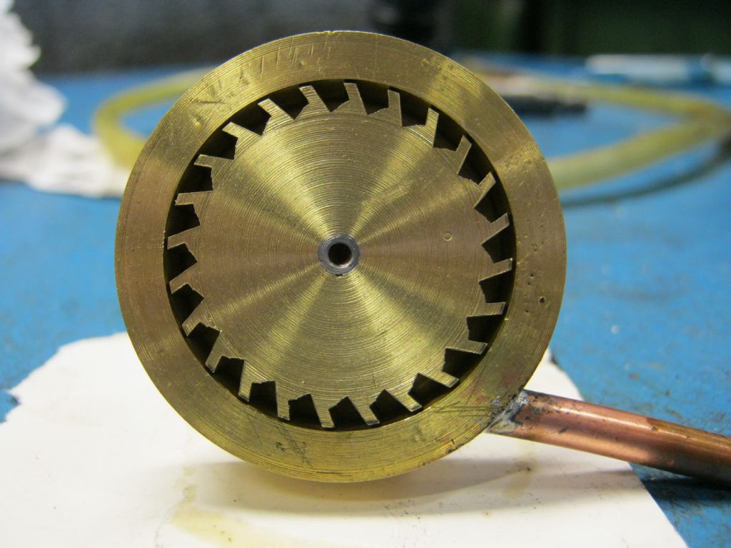

                        Hi folks!
                        I has maked the steam turbine after the drawning of Elmer Verburg steamturbine with ball bearing.
                        Then i took the test with difference oils in the bearings.
                        Here are the tests of oils and measured revolutions per minute:
                        Work pressure= Mobil ESP 5W-30 / Air tool oil /  Diesel oil (fuel for diesel engine as lubricant)
                        1 bar= 4700 / 13230 / 17600
                        1.5 bar= 6200 / 17900 / 25700
                        2 bar= 11400 / 21660 / 31500
                        2.5 bar= 15500/26340 / 36700
                        3 bar= 18600 / 28800 / 41800
                        As i can see the ball bearing get less friction with diesel oil as lucricant, it is sensitive for jet stream from nozzle. With high revolution above 15000, i can feel there are enough torque when trying to stop the turbine shaft.
                        I can think: With less friction means less waste of the steam and fuel for heating the boiler.
                        What is your meaning about the oil/rpm to a “fixed” working pressure?

                        #68007
                        MICHAEL WILLIAMS
                          @michaelwilliams41215
                          Hi Jens ,
                          (1) The energy loss which occurs in lubricated ball bearings running at high speed is almost all due to pumping loss – not simple friction as such . The oil has to be continually squeezed or ‘pumped’ through the passages of the bearings as it rotates and there is a large amount of viscous drag .
                          (2) Your results make complete sense – the higher the viscosity of oil , the higher the pumping loss and the lower the running speed .
                          (3) Designing bearings for high speed machines is much more difficult than for low speed ones . If you would like to send me a copy of the part of your drawings showing the bearings I’ll see if I can suggest some improvements .
                          (4) You don’t mention whether you were running your turbine on air or steam for these tests . Lubricated ball bearings running on hot steam have different problems to ones running on cold air .
                          (5) As general priciple most turbine designers use bearings which are much to big for the purpose . There is almost no load on the bearings of a well designed and well balanced turbine wheel so very small bearings will serve and have less pumping loss problems . For your turbine of about 40 mm diameter 4 mm bore bearings would be adequate or even possibly 3mm experimentally .
                          (6) You don’t have much choice in tiny bearings but generally the more ‘open’ the design of bearing and especially of the ball cage are the less pumping drag will occur .
                          Best wishes ,
                          Michael Williams .

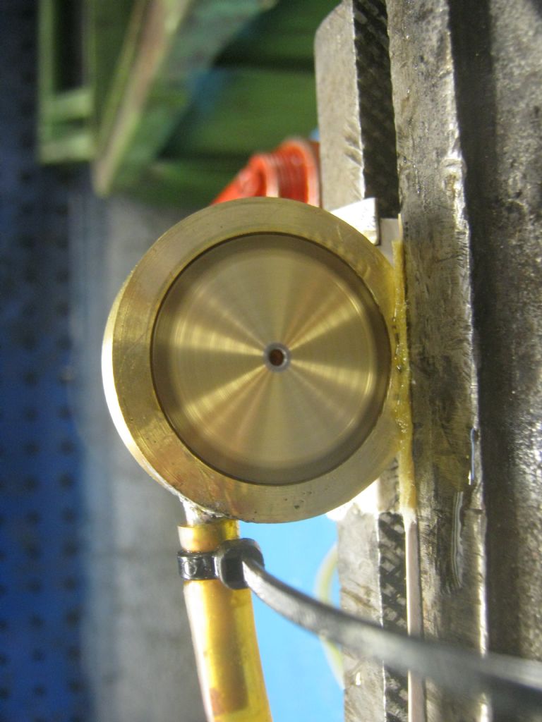

                              Today i tested with steam with good results No problem with ball bearing with diesel oil, no mixed with water. The turbine ran above 35000 rpm with good torque. When i removed the heat of the boiler, the steam turbine was still running up to 2 minutes before the pressure was dropped of.. there was enough torque.
                              I am uploading the movie of my turbine in Youtube.. ready to see later..
                              I added the ball bearing 4mm x 9mm x 4mm instead bronze bearing. The turbine wheel in brass, 5/16″ thick and the wheel is near close to the turbine house, about 0,5 mm clearance. The vanes is milled with 2 mm saw cut wheel. The shaft was silverbrazed to turbine wheel before complete machining the whole turbine wheel. There is no out of balance.

                                MICHAEL WILLIAMS
                                  Hi ,
                                  Jens :
                                  The mechanical design of your turbine with the 4mm bearings etc is quite ok and for a simple turbine I would not change it .
                                  The gas flow design of the turbine is not so good and efficiency will be much lower than it need be . It depends now on whether you want to stay with this simple design and just use it directly for your original purpose of running a model boat or whether you want to get into the more general topic of designing high performance turbines .

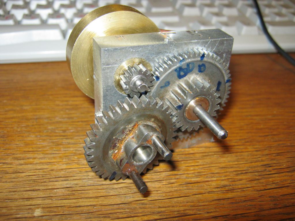

                                      Hi, i has maked the reduction gear to steam turbine, the gear ratio is 10.2:1. But not tested before the sear set is completed and ready to run. I am planning to test the horsepower with miscellaneoud air screws and tachometer + the program “Thrust hp”, then i can learn out how much effective is the rpm range and steam pressure.

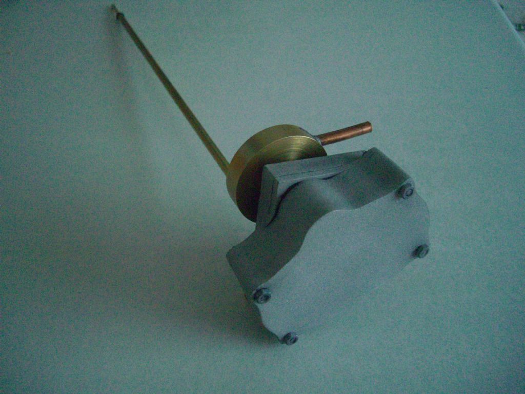

                                            Jens Eirik Skogstad 1
                                              @jenseirikskogstad1
                                              Hi folks!
                                              The turbine is near complete and there is propeller shaft added. It is some parts to make ready to the turbine and add the propeller. I has tested the turbine with reduction gear, there is really good torque, difficult to stop with the fingers at the propeller shaft while the turbine is running, but it is a question about start torque from zero revolution to working revolution. The reduction gear house has oil inside to keep the gear lubricated. I will rig the test stand to test the turbine with boiler connected to the turbine and the propeller in watertank.
                                              I early post i wrote: I am planning to test the horsepower with miscellaneoud air screws and tachometer + the program “Thrust hp”, then i can learn out how much effective is the rpm range and steam pressure.
                                              I will drop this test since there is enormous torque in the turbine to test a lot of propeller in watertank.
