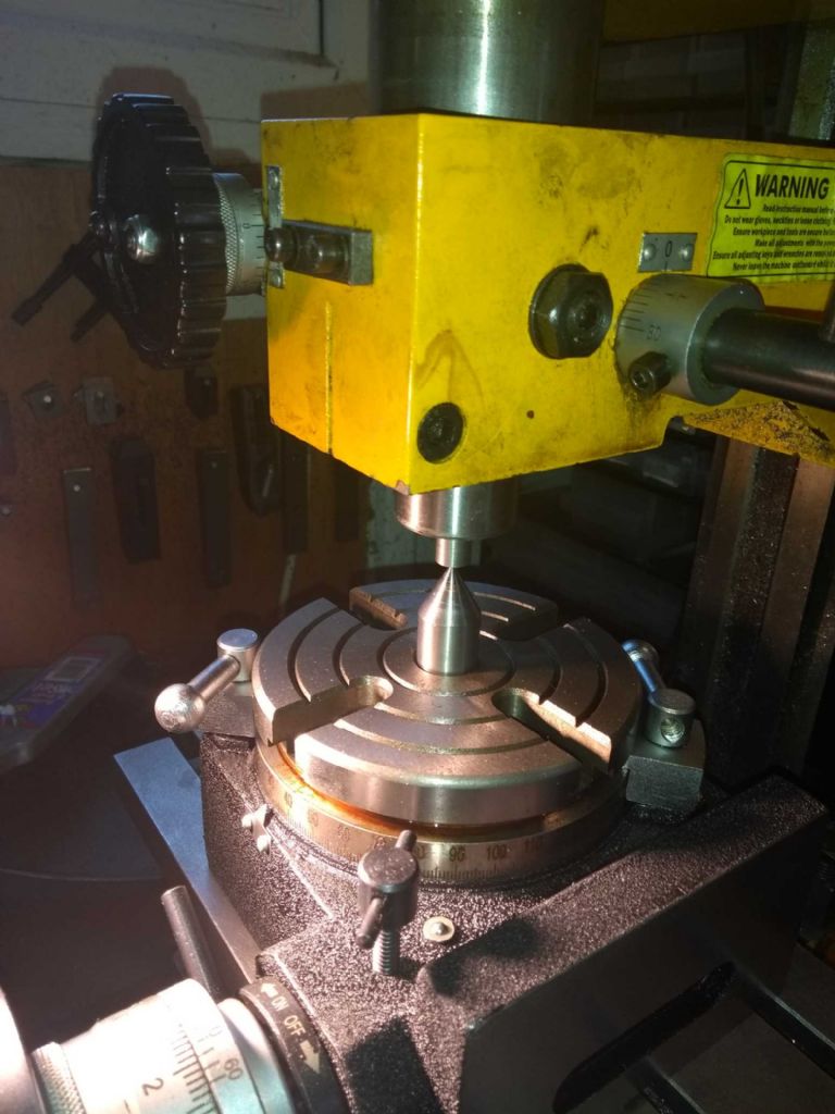

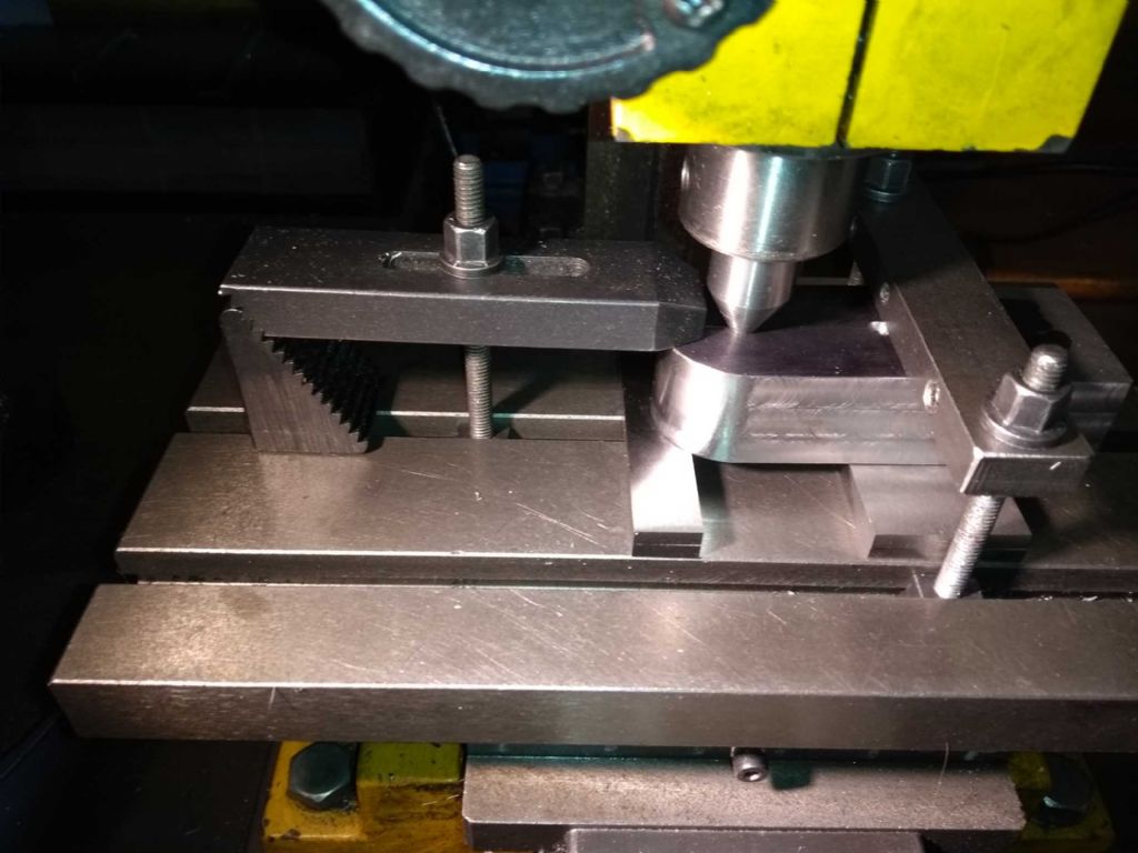

        So the Journals will have a nice round end for the big end and a counter weight (yet to be worked out) on the opposite end. My first proper use of a rotary table….

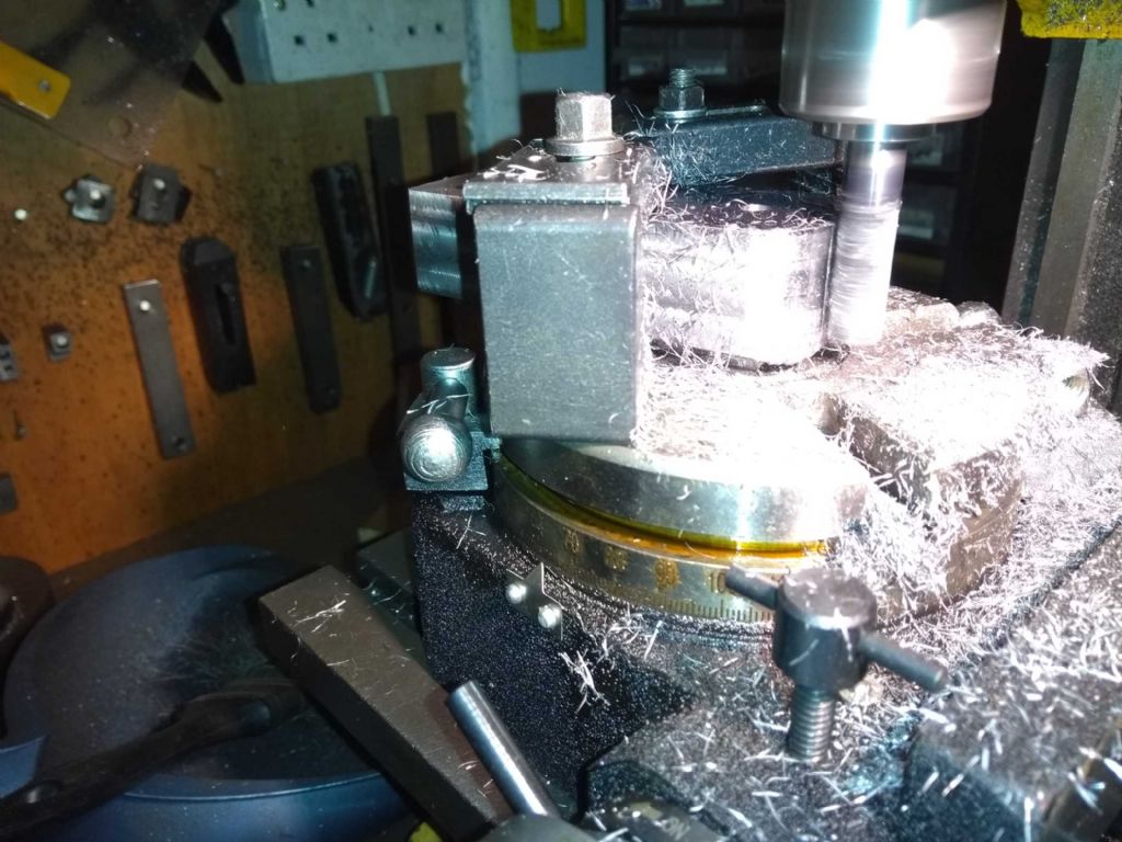

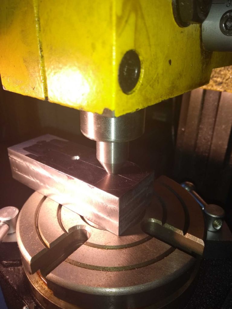

        I've turned a reasonably accurate 10mm round bar with a centre drilled end. The idea is that I mount this in the mill collet and an MT2 centre in the rotary table. bring the bar onto the center wiggle the table a bit and the table should be centred. I mean, I didn't try and measure this afterwards, but it makes sense.
        Then put the MT2 centre in the mill spindle and lower into the centre drilled hole in the journal exactly where the bearing centre will be.

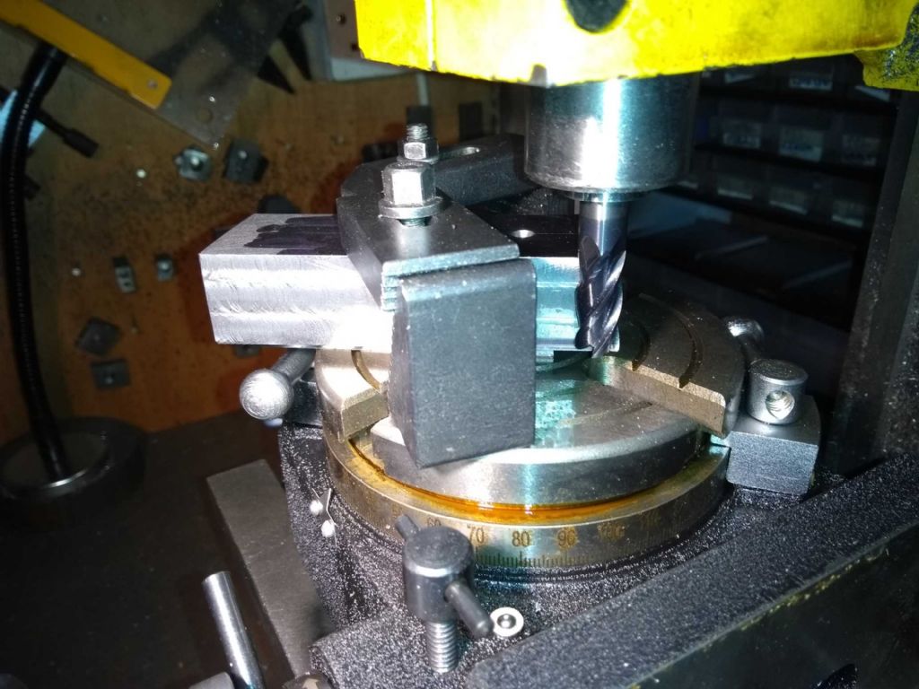

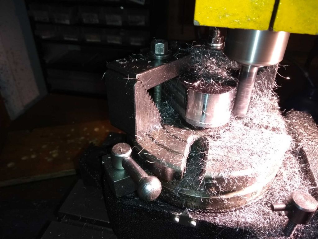

        Now for the exciting part! Clamp the journal (sitting on a 4mm parallel) back off the X axis rotate and then cut.
        I took off about 1mm each time (10mm 4 flute carbide cutter at 2000rpm).

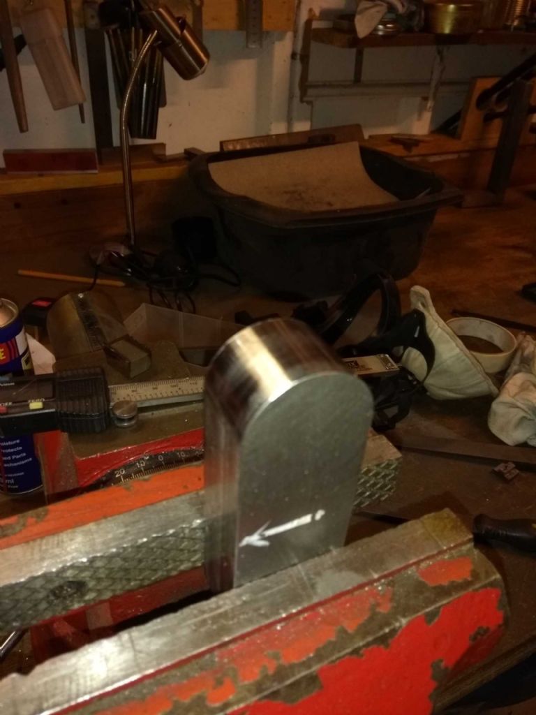

        The cutter isn't quite long enough so I lowered by 4mm and took a second pass every couple of turns – you can just see the ridge at the bottom before the second pass.
        Which I'm unreasonably pleased with!

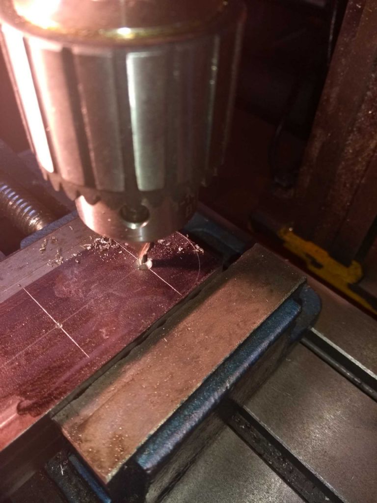

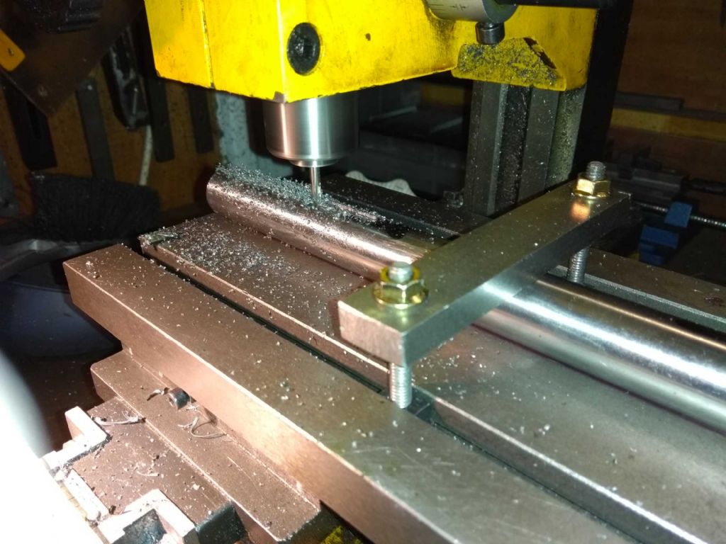

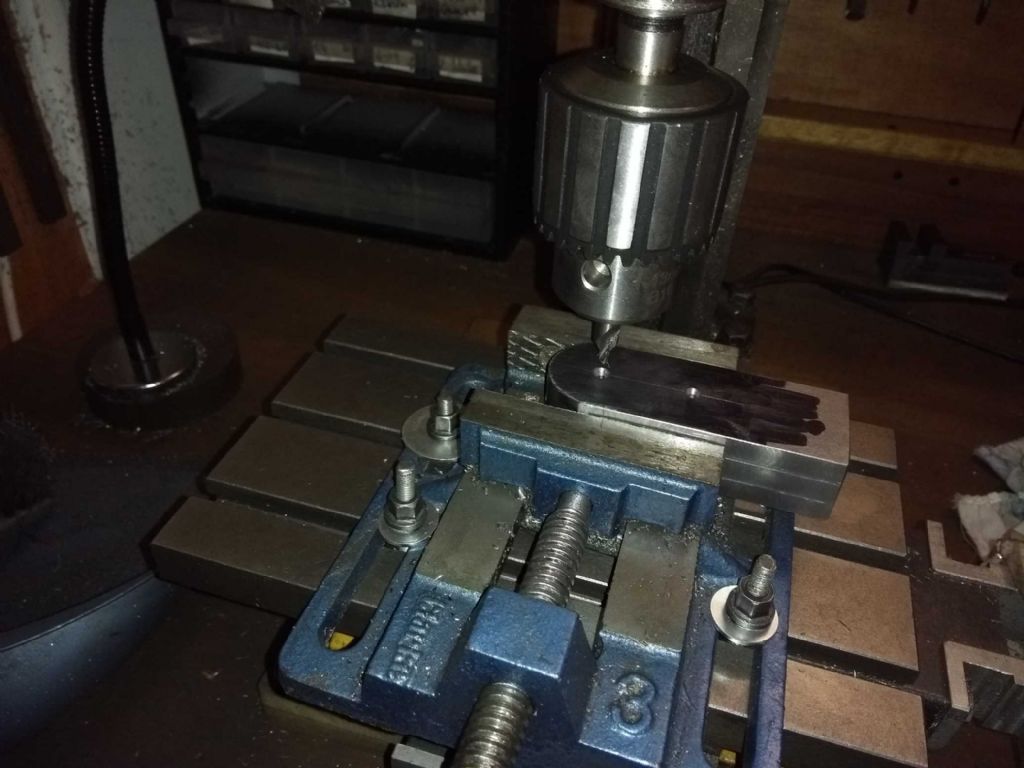

            Yesterday and today I continued to work on the journals.
            First task was to drill out the centre-drilled shaft centres to be big enough to bore on the lathe. I do have a boring head for the mill, but the mill and it are far to non-rigid for something requiring a reasonable level of precision.
            I started off trying to do the job quickly. Mounted the journal in a drill vice, and centred it using a centre drill (not turning!) in the chuck. This seemed to centre, but when I secured the drill vice, the centre drill no longer entered the hole smoothly! I guess that tightening the vice mounting bolts applied some torsion and shifted something. Tried a variety of combinations and didn't like what I was seeing.

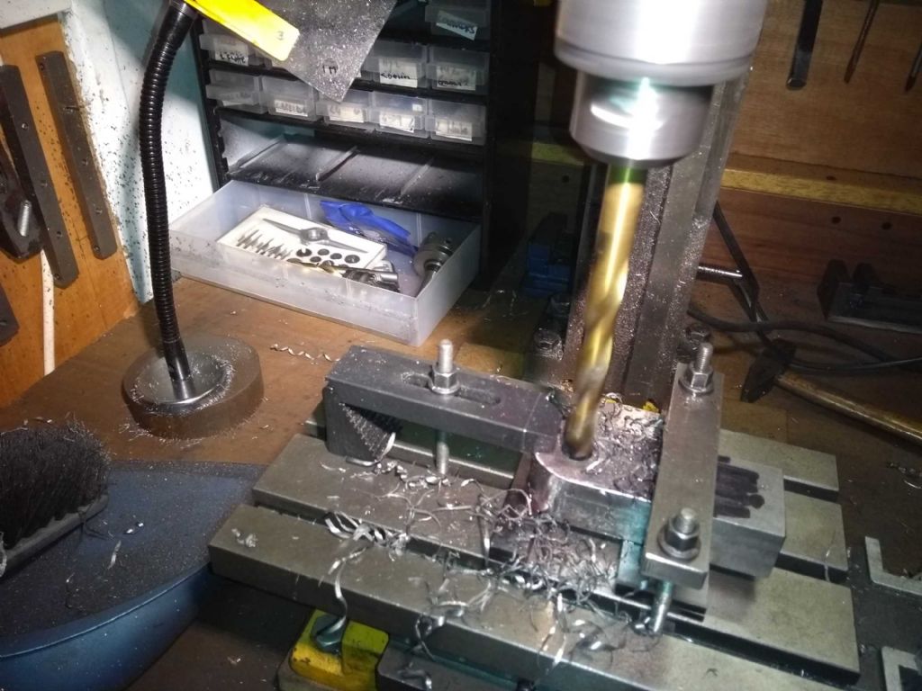

            So back to an MT2 centre and mounting the journals directly on the table with some parallels and clamps.
            Drilled with 4mm, 6mm, 10mm and finally 13mm.
            The big drill here turns out to have a chip out on the end, which was more apparent when drilling the other hole. Somewhere i have a drill sharpener that sometime I will try and use to fix it.
            Before mounting the journal on my faceplate and boring, I checked that there was enough clearance. yes, but only by using low profile nuts. However, first I thought I should cut the big and shaft and main shaft and trim them. I'm thinking to use the main bearing shaft (44mm) as a try fit when approach the 20mm internal diameter of the shaft bore.
            Perhaps tomorrow I will get round to doing the faceplate work and boring out the journal for the shafts. A bit nervous about that – it requires a level of accuracy which I don't normally manage!

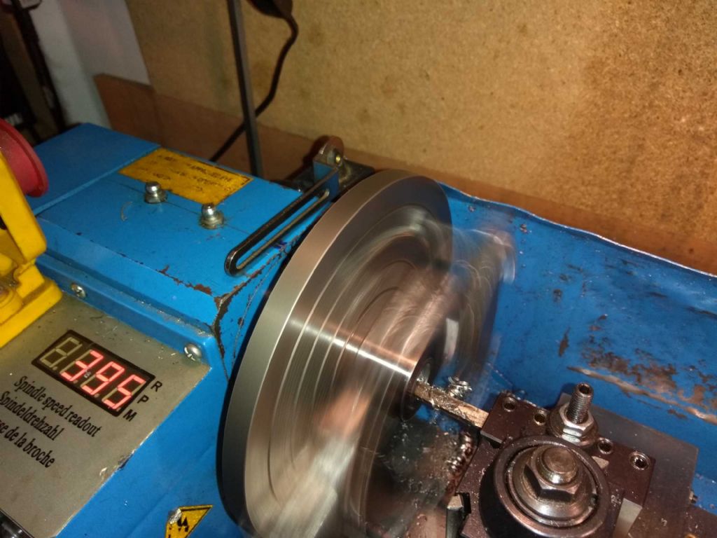

              Crisis!

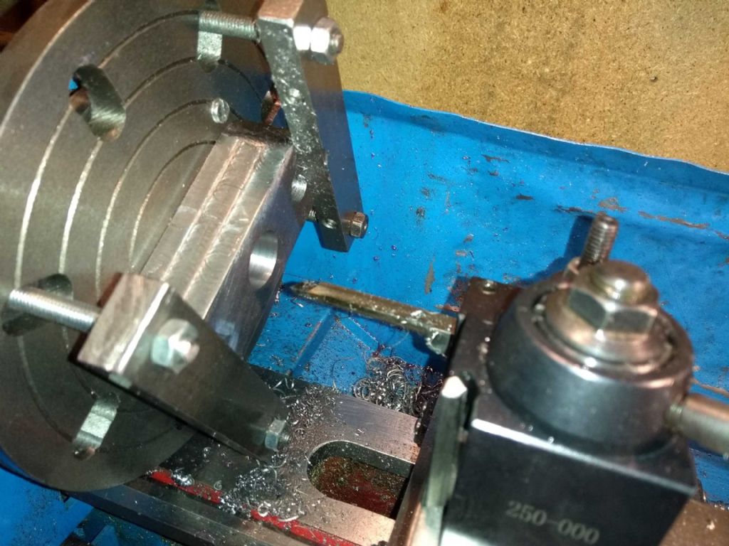

              I've overbored the journals. The main axis bore turns out to be about 20.35 and a wiggle fit for the shaft angry
              In the traditional amateur way, I'm going to make an excuse.
              The plan was to drill to 13mm (my biggest drill) rough it out with my carbide insert boring bar and finish to size with a self ground hss boring bar.
              I managed to get the 13mm bore centred on the faceplate to about 2 thou with aid of a rubber mallet and a bit of wood. I was reasonably pleased with that! My first faceplate work!
              The carbide insert boring did not go well. To start with it seemed incapable of actually cutting and it graunched and groaned as it went into the rougher parts of the bore.
              So I swapped out for the hss tool (specially sharpened). that cut nicely enough and I have about 3 miles of 1 thou thick coiled steel as it pulled in and out and took just a bit off.
              My mistake was to get to what I thought was about 5 thou under with 3 or 4 runs through of the tool and then pull back that 5 thou. Then kept cutting until there was no more coming off the inside.
              What's happened (I think) is that the spring in the tool (it started live as a 5/16th toolbit) was much bigger than I thought. So the last cut but one had not finished cutting when I measured. When I kept on in the final cut I was obviously still pulling against the spring, hence the over cut.
              Sadly, I don't see any way of rescuing this piece, though advice from experts is welcome.
              Which means ordering some more steel and starting again sad.
              Ah the joys of amateur engineering!
              Iain

                            Thanks to the advice of Jason and the Gods of eBay, I've ordered a 22mm silver steel shaft, got it delivered and VERY CAREFULLY trimmed out the centre bore to fit.
                            The end result appears to be just a tad tappered. the mouth is a reasonably easy fit for the shaft, but the part by the faceplate is tight. That is it needed a little tap to get through the last few mm.
                            I think the difference in diameters at each end is sub-thou (guess) and most probably outside my ability to measure accurately.
                            Good enough for me!
                            hopefully, this weekend I will bore the pin (20mm) trim the main shaft and add a keyway. If I get really excited I will try and glue them together!
                            Iain

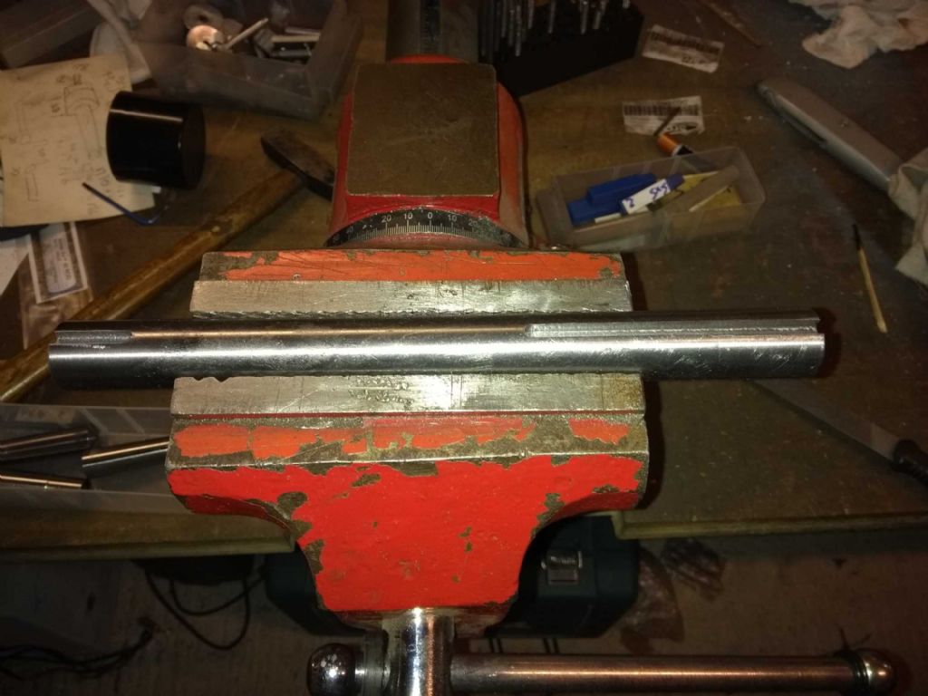

                              Journals: Done! Main Shaft. Done!
                              Pin bored out to 20mm. I must say I'm seeing the same thing with this bore. The outer diameter is just a little bit bigger than the inner one (by the faceplate). The only thing I can think is that the head isn't exactly in line with the ways that that might be awkward to fix.
                              You can't see it in this picture but I was able to balance the faceplate with a bit of steel clamped on the periphery. It was good to about 400rpm with negligible vibrations.
                              Next to cut the key way.
                              Used a wobbler to centre the head – then double checked by eye and found I'd added up wrong . Corrected!
                              And the result!

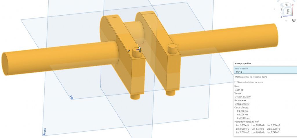

                                      Crank Balance
                                      One of the things I've been working on is how to get the crank balance – by science rather than trial and error.
                                      I started trying to use maths – without the aid of my Mathemetician son who demanded payment!
                                      I had quite a few goes at this – with online resources doing the calculation, but despite having put quite some time into it, it soon became obvious that solving complex integration is something I'm going to have to look back on and not forward to.
                                      My next though followed the hammer and nail principle (if the only tool you have is a hammer) and, as software chap, I thought I'd write a program which would calculate the balance numerically rather than analytically.
                                      Fortunately, before I dove into this task (fun though it may have been), it occurred to me that this was an everyday task for proper engineers and perhaps OnShape had something built in!
                                      It does and with a bit of trial and error it would seem that the crank as designed is nearly in balance and just needs some 8×6 mm cylinders attaching!
                                      Iain
                                      #384601
                                        The crank itself may be in balance but once you have the mass of a conrod and piston attached that is going up and down all hell breaks loose.
                                        The balance weight is generally more than is needed to balance just the pin.
                                        #384648
                                        Iain Downs
                                          @iaindowns78295
                                          Ah. So wrong again! But learning smiley.
                                          So what does one do? Is it trial and error? Can I start by balancing the mass of the big end bearing?
                                          Should I just put a threaded hole through for now so I can experiment?
                                          Iain
                                          #384650
                                            There are methods for doing it but not something I have really gone into. I seem to recall that the conrod complere with big end bearing is held horizontally with the big end resting on scales and the small end otherwise supported so you can get the weight. Though the piston must come into it somewhere.
                                            You then add this weight around the pin and calculate the weight needed to bring this into balance.
                                            May be best to ask in a new thread which may attract more attention of those that know about these things.
                                            Definately add the threads for the weights as then you can always play about later.

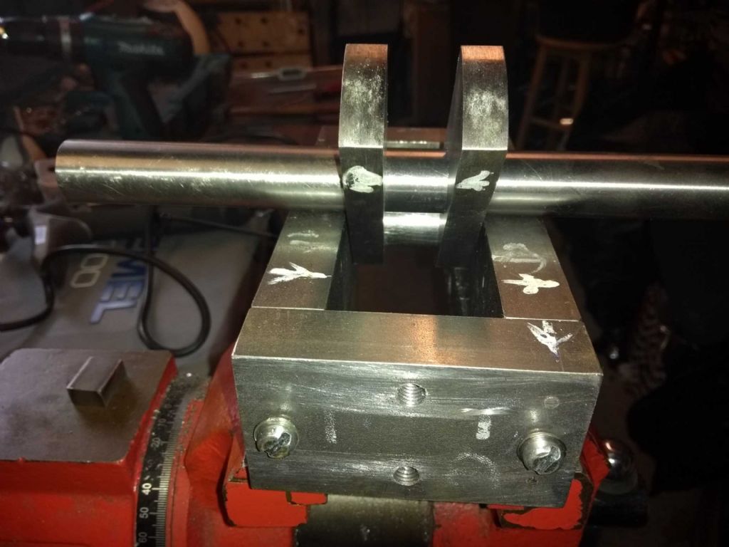

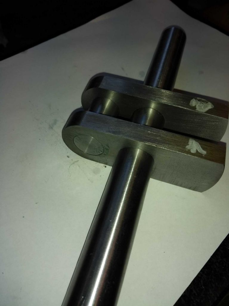

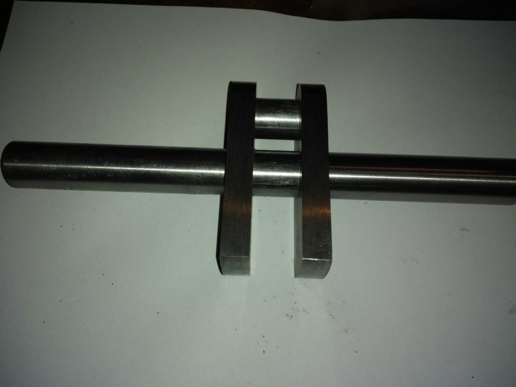

                                              Today, I trimmed the non pin end of the journal to be a bit nicer, split the journals apart with some heat and cleaned them up a bit.
                                              Next step is to glue the pin end.
                                              My plan (subject the sage advice of my elders and betters), is to
                                              • rough up the ends of the shaft and bore for the pin side of the journal
                                              • keep the main shaft in place
                                              • spread the journals out and apply some loctite 638 to the bores ( i think bores rather than shaft, but I'm not sure why)
                                              • push the journals into the pin shaft (with a couple of bits of scrap to get the position right.
                                              • Leave it for a bit.
                                              I'm thinking that I want to leave the main shaft out until I've done the main bearings and I can use it with a bit of grinding diamond paste to lap them in. The glue the main shaft in, cut the middle out and finish.
                                              Originally, I'd got another 20mm bar to act as a lap, but I'm loathe to buy yet more silver steel (main shaft now 22mm).
                                              Iain

                                                A rule of thumb for a single cylinder is balance the rotating weight then add 50% of the reciprocating weight.
                                                Will have some tearing their hair out, but for an engine of the size you are building it should be fine.

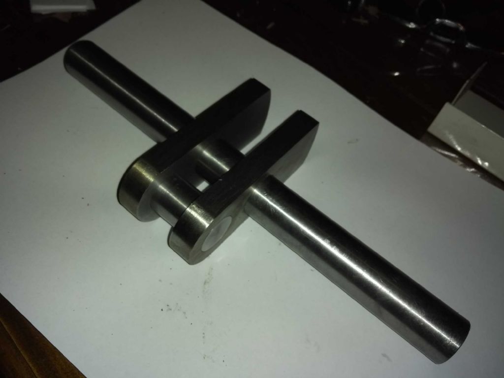

                                                Iain Downs
                                                  @iaindowns78295

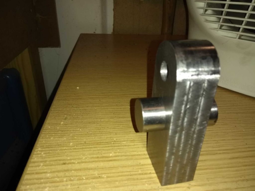

                                                  So after a few digressions, a bit more work on the engine.
                                                  All that was left (for now) to do with the crank was to slap some loctite in and glue in the pin. I used a couple of bits of scrap to make sure that the pin shaft came to exactly the end of the journals. I was in a bit of a panic for this thinking I only had seconds to get it right, but I now gather setting (curing) time is more flexible.
                                                  As you can see I assembled it on a (protected!) surface table with the main shaft in place too (not glued yet) to make sure every thing lined up.

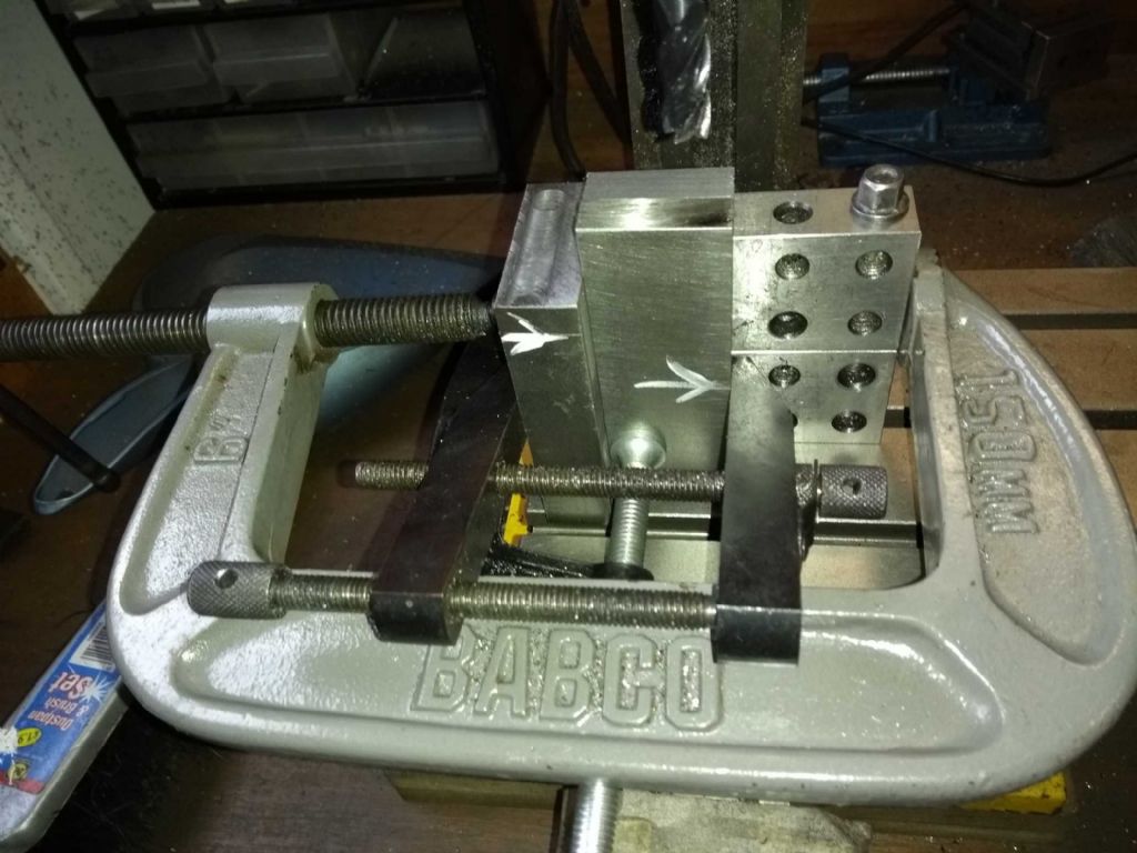

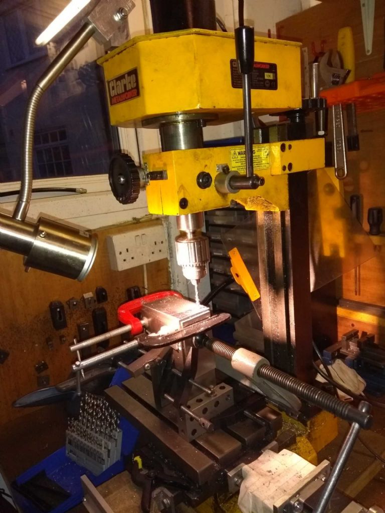

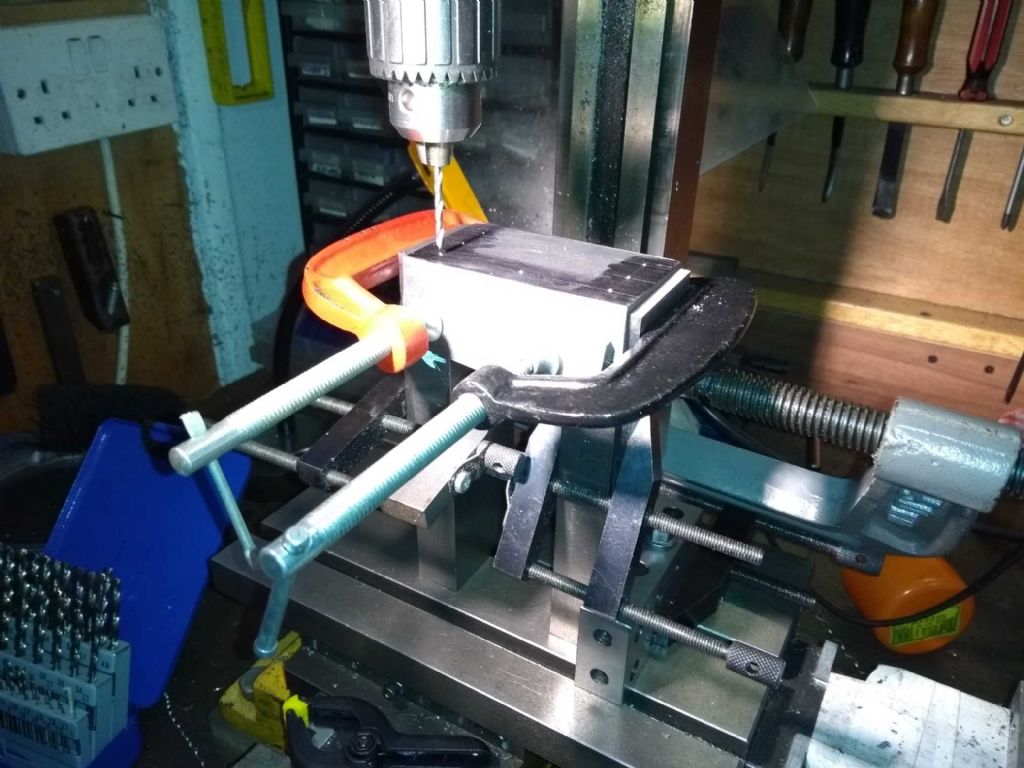

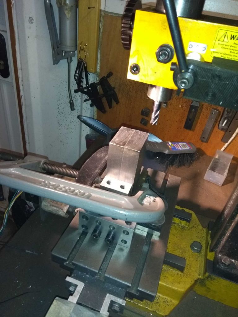

                                                  Next was to assemble the crank case. The original plan (well the last original plan) was to sliver solder it, but experiences elsewhere put me off that as an idea – there's far too much metal. I originally originally intended to just bolt it together, but felt that this was too inaccurate.
                                                  Instead, I decided to pin it in 4 places and secure with a pair of bolts at each end.
                                                  First task was to drill the pin / pilot holes. These at 2.8mm with a view to reaming to 3mm and using some silver steel I'd bought at a show 'because it might come in handy'. It has (OK, 18 months later, but..).
                                                  I thought about entitling this one, 'you can never have enough clamps'.
                                                  In fact this task took my little CMD10 right to it's limits.
                                                  If the crank case had been 5mm longer I would have been very hard pressed to do the drilling. Well done! you might say for such careful design work. Hmmmm. (blush – absolute luck!).
                                                  Next to ream out to 3mm. It turned out that I had only got 3mm in machine reamers and I actually don't trust any of my kit to be accurate enough to hold a machine reaminer and not overbore, so I got a 3mm hand reamer.
                                                  Next to pin, bolt and hammer in the pins.
                                                  And finally, here is the crank on the crankcase. Cosmetically – I still need to make the main bearings.
