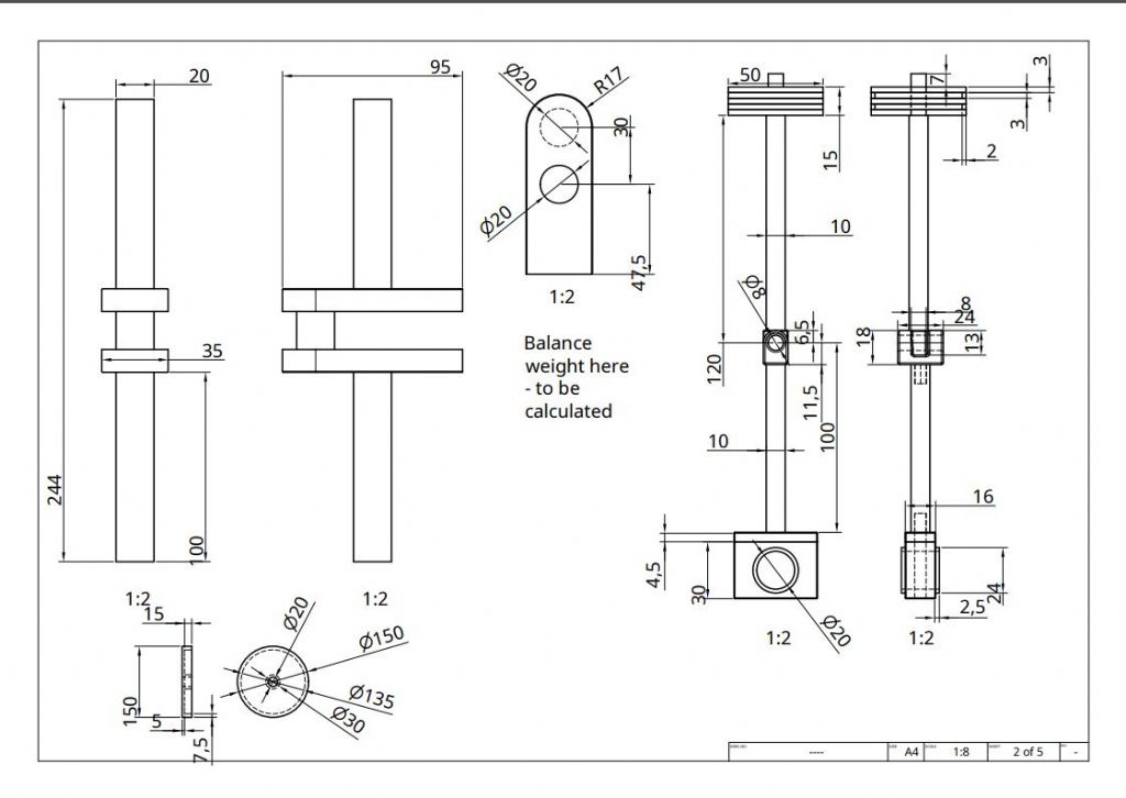

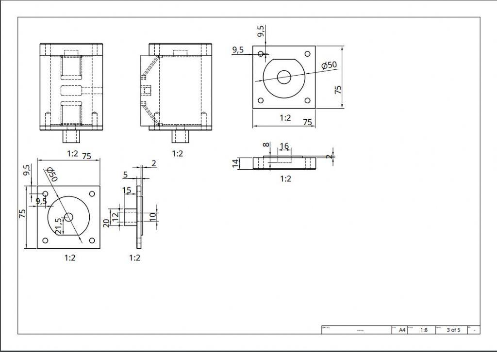

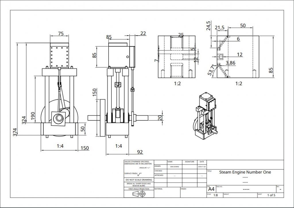

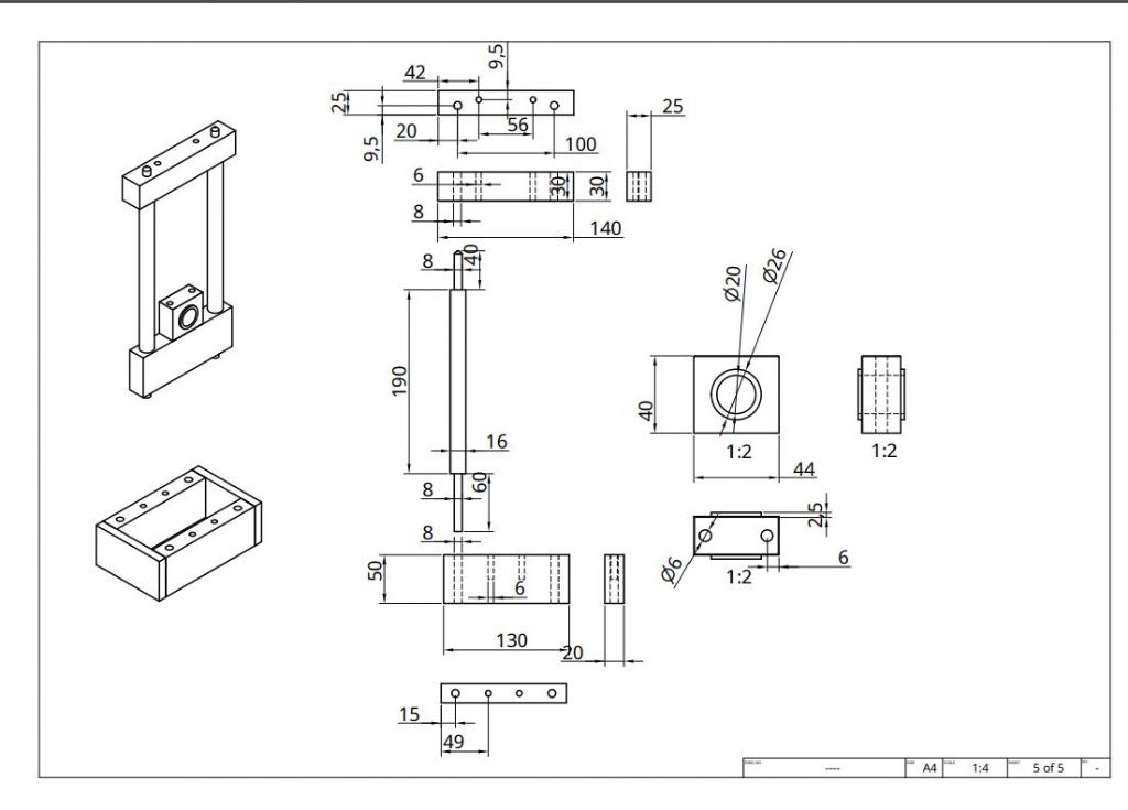

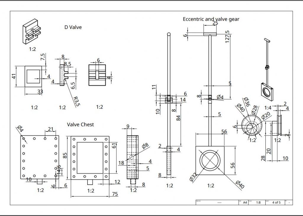

      Here are the drawings as they stand at the moment. They aren't engineering quality and a lot of things like fastenings aren't included, but I think the overall structure is there. Comments and critiques welcome.
      The Overall Engine
      Cylinder Details
      Crank and Piston
      Valve Gear
      Frame

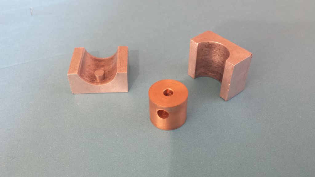

          Crankshaft, Crank Case and Main Bearings
          Shaft 20mm Silver Steel, Journals 12×35 mild steel. Fix shaft with Loctite 638, pin through with (4mm?) steel.
          Bearings cast iron, split pair, split in two and loctite together, bore to 20mm and heat to release (4 parts).
          Frame Mild steel (squared and milled to size already!) bolted together. bearings set in place and lapped to a running fit with a spare bit of silver steel.
          I intend to bolt a counterweight to the flat end of the journal but I've not worked out size and shape yet. It will involve integration .
          The drawings don't show oil channels for bearings, but I will add those in.
          Cylinder and Caps
          I'm thinking this would be one big bit of cast iron with the two end caps cut off and machined separately, though I may go for separate caps made of mild steel. This is the most complicated piece of work I think, though I've already has some advice from Richard Gribbins (Hope I spelt your name right, Richard) on how to do some hard parts.
          Piston to Big End
          Not sure if I will make the big end bearings from cast iron or bronze, but the rest is steel. I'm also not sure if I should assemble the rods and joints from components and silver solder or try and machine out of whole steel. Most likely I will solder – the machining is probably too much.
          Frame
          Connect the Crank to the cylinder. I'm thinking of using stainless for the support struts for the shinyness, even though it costs a bit more. Not quite sure how to finished the model off, paintwise. I did think of brass for the supports struts, but that's very pricey (and I'm not much of a one for polishing).
          At this point I should be able put the whole thing together and make sure that it runs smoothly.

          #381628
            As few thoughts after having a quick look.
            Cylinder – I would make the ports a bit deeper to reduce the angle of the passages and try to get the passage area equal to the port if you want it to do work. Exhaust could do with being larger as by the time you have screwed some pipe into there you won't have that large a bore so will be restriction flow, maybe a flange screwed to the outside if you can't fit a larger threaded hole in.
            If it is going to work then mill away a lot of that cast iron to reduce the mass if you don't want a bucket full of condensate and lag the void, drain cocks would be needed too. It will need a large boiler too.
            Crank/piston – You don't have anything to guide the cross head so will get a lot of sideways forces that will soon wear glands and the cylinder bore. Either add a trunk guide, single guide to one side or guides both sides. Cross head joint looks quite spindly for the size of engine, there is not a lot of metal around the 8mm pin.
            Valve – Thread the rod and have an adjustable nut, that T piece at the end will not allow for setting up the valve for equal movement. Like the cross head you have nothing to guide the valve, either extend it into a hole/bush in the top of the valve chest or have a bracket from underneath to guide it. No sign of a stuffing gland to seal the rod. Joint between rods looks weak.
            Frame – I would fix the lower bearing halves from below with counterbored cap heads, that way when you take the caps off they will stay in the same position so all your lapping won't be wasted. This will also allow the tightness of the two halves to be adjusted without the whole lot moving about Or have steel blocks with turned bronze bearing shells
            Edited By JasonB on 21/11/2018 08:07:03

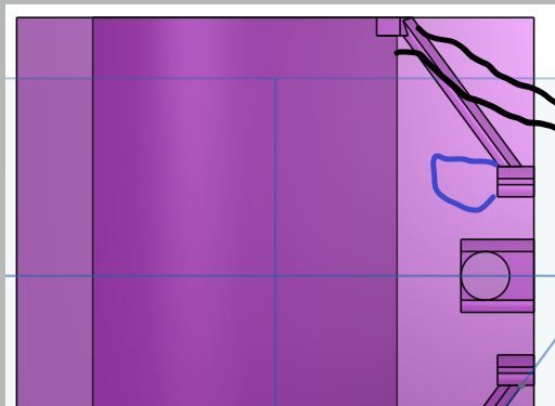

                Cylinder
                when you say make the ports deeper, do you mean that the bit that comes down from the valve surface should be deeper (blue), or that the angled port should be steeper (black), by which I mean the gap from cylinder to surface should be larger.
                My guess is you mean black?

                I was wondering about using shims under a plate that attaches to the eccentric bearing for valve adjustments.
                And I've read that the pressure on the outside of the D holds it against the slide so no additional guide required.

                    Make the blue port deeper, infact as you have plenty of cylinder cover overlap you could make the top notches go a bit further towards the edge and then just come straight down with the passages.
                    It is more to do with the steam hitting a cold cylinder when you start running, the cold metal will make the steam condense robbing it of energy and filling your cylinder with water. by removing metal to leave a thinner wall and flanges at the end there is less metal to heat up and the space can be lagged to further reduce heat loss.

                    Shim would do it but a bit of a faff to keep undoing screws and adding more or less shim until you get it right. With a threaded rod you just pull the pin and turn the rod then pop the pin back in place.
                    Yes the steam/air pressure will hold the valve to the port face but the sideways action of the eccentric will soon wear the gland.

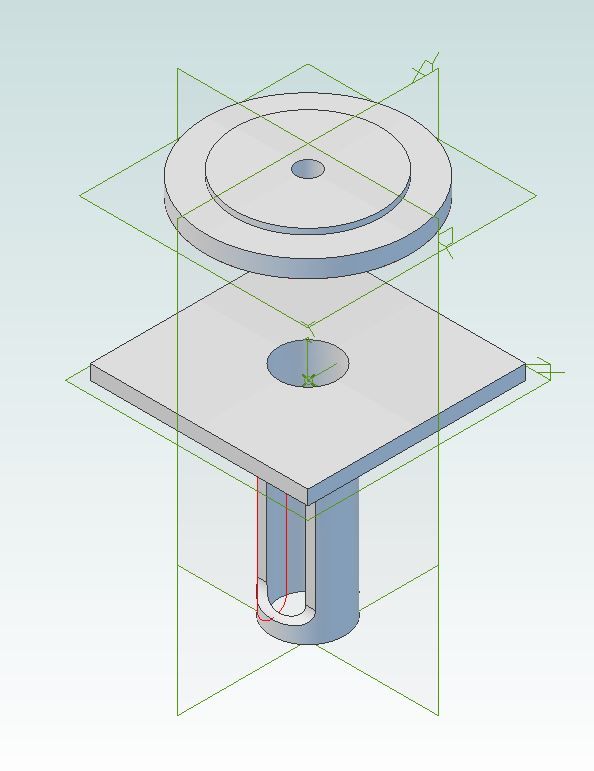

                            Hi Iain,
                            I have been looking at your plans. This engine is similar to one I made last year.
                            Could I make the following suggestion regarding cross head design which you may wish to consider.
                            Your first drawing shows 2 cross bars which support the cylinder block. Why not replace this with a plate across the top. This plate would have a hole in the centre for the piston rod guide. The top of the piston rod guide would locate in the bore of the cylinder and that would of course register the position of the cylinder.
                            The under side of the plate would need a female register turning which truly concentric with the hole in the centre. The cross head guide is made from square stock turned round for most of it's length. On the top of the cross head you would need a male register to match the one in the plate.
                            Here a two pictures from my picture flle, Jepson Engine. Geoff

                              Geoff, I like the idea of switching to a plate and it's something I'd considered, Having to add a guide makes this more appealing.
                              As I understand it, you have a cylinder whose bottom hole is s slidefit for the piston ron and the top has a registration plate which fits into the underside of the plate.
                              How does the gland get fitted? Is that what the holes either side of the top of the support are for.

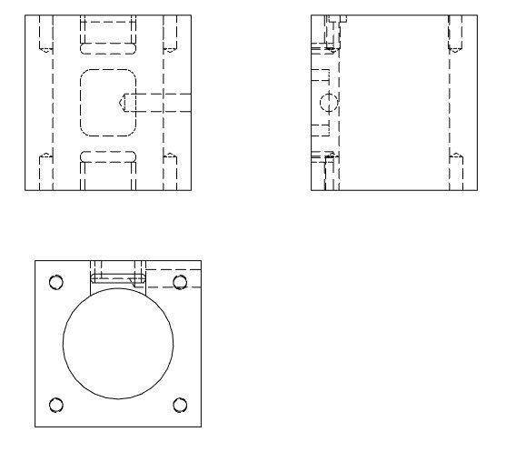

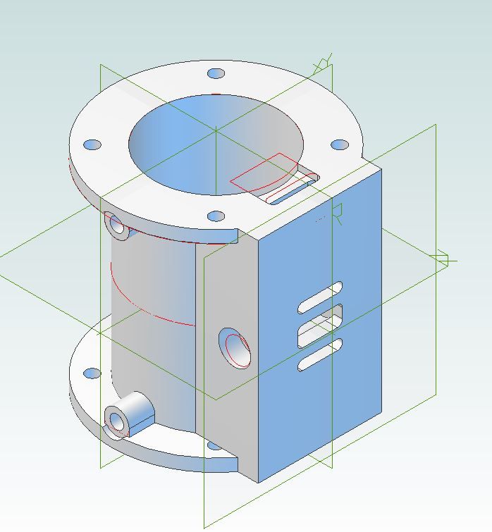

                              Jason the sketch below is (roughly) what I had in mind originally. And a lot easier to build than angled ports!
                              A question: I've been trying to minimise the amount of space in the passages and 'closed' cylinder. I'm not sure I know why, but I suspect an early dabbling with car engines has something to do with this. Also, there is less 'unused' steam to exhaust with smaller / shorter ports than with wider longer ones and more space in the cylinder at the end of the cycle.
                              I read in one of my books that 4% ish was right for a medium speed engine, and whilst I've not tried to measure that, I have tried to keep that space down.
                              The question is, 'Am I wrong about this?' – fully expecting the answer, 'yes you are!'.
                              I've been off ill for the last few days, so not even look at the computer let alone attempted a cold dank shed with smoking metals, but today or tomorrow I may brave it! MY Loctite 638 arrived today so I have no material excuse to avoid finishing the crank.
                              Iain

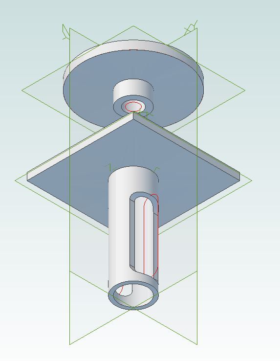

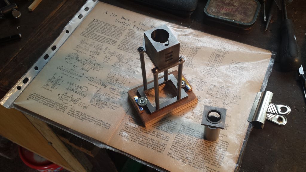

                                This is the proper version of what I have in mind now (still some bits missing, but it's close). I can carve it from a 90mm cast iron round,
                                I had in mind to finish the bottom of the ports with my newly acquired ball nose carbides to get them smooth.
                                #382101
                                  Just got in from a day out so will look at the cylinder later.
                                  For a trunk guide I would put a rough hole of say 18mm through some 25mm bar and then silver solder that to some 6mm plate. Then hold by the 25mm diameter to skim the face of the plate down to 5mm thick and at the same setting open up the hole with a boring bar to say 20 or 22mm. This will ensure you have across head and cylinder mounting surface true to each other. lap the bore then mill the notches out of the side to give access to the cross head pin.
                                  You still want a cylinder cover so on one side of that have the 2mm spigot that located the cylinder and on the bottom make the spigot that takes the gland a good snug fit in your trunk guide so they are concentric when assembled
                                  #382125

                                    I get the basic idea of the mechanism (I think), but I don't quite get how it stops the piston rod moving.
                                    Unless there is a mechanism which clamps onto the outside of the notch that's on the outside of the cylinder.

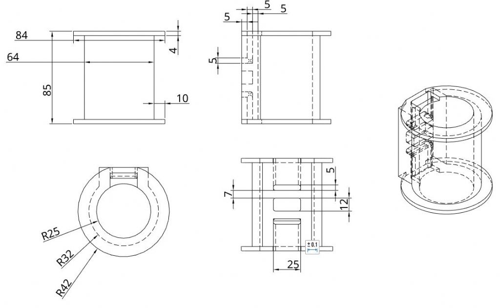

                                    Also, and my apologies, I sometimes get a bit stuck on the technical terms. I guess the cross head is where what I call the piston rod (connects to the piston) joins the con rod (joins to the crank.
                                    I'm looking at using Geoff's idea of a plate as a bottom cylinder cover, but I don't want to mill out huge amounts of metal to make a gland spigot. I was wondering about making the guide (trunk or otherwise) and the gland separate to the cap and then bolting on (with suitable registration cuts of course.
                                    What do you think?

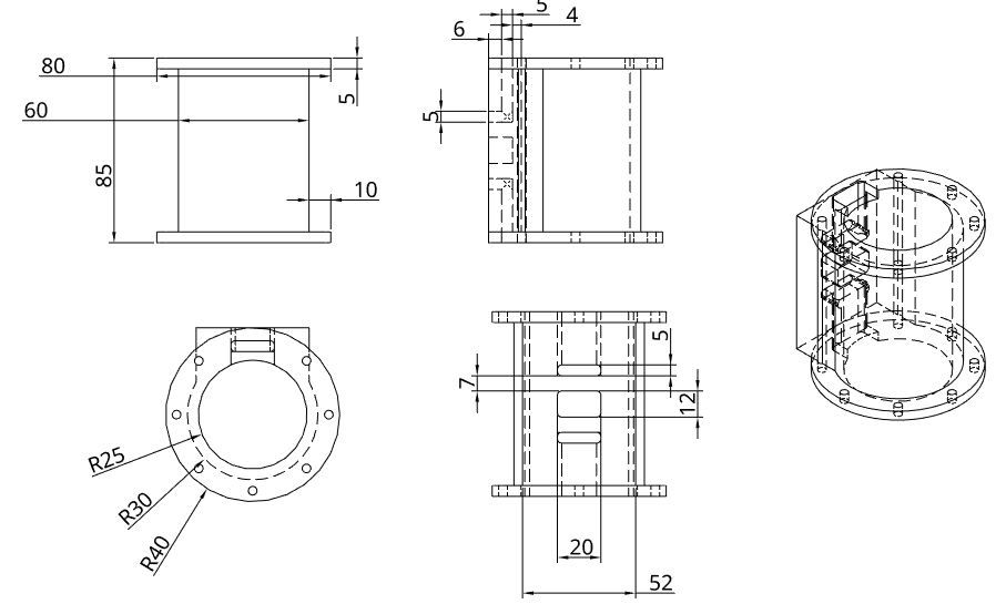

                                      looking at the latest cylinder drawing the biggest issue I can see is that the valve face is going to be too narrow by the time you have the sides of the valve and the thickness of the valve chest walls you will be hanging over the edge.
                                      Having said that your ports do seem rather large for this sort of size engine. You could safely come down from 25mm wide to 20mm width then have the exhaust 8mm across, 4mm between ports and 4mm inlets. This is a similar sort of size to the Stuart No1 of which many have done real work.
                                      This would give you a valve cavity of 20mm wide x 16mm high, make the overall size of the valve 28 x 28.
                                      If we then said 1mm clearance each side of the valve and 10mm wall thickness for the valve chest then that would give a 30mm cavity in the chest and 50mm overall width.
                                      You could also happily reduce the cylinder wall thickness down to 5mm from 7 mm giving a 30mm radius.
                                      Finally take the flanges to 5 or 6mm thick to give the studs a bit more meat to bit into as you only have four of them
                                      Finally bring the passages in a little closer to the cylinder bore so you get a decent width seal to teh outside edge, reducing from the 5mm to 4mm will also help with that.
                                      #382129
                                        So with all the bits mentioned above plus chopping the cylinder down to 82mm overall height you get something like this

                                          Bloody hell, Jason, do you have a direct brain link to a 3D modelling tool?!!!! It would take me an hour to draft that!
                                          (well it did actually – or my bad version!).
                                          The port sizes are taken directly from a 5A. As my may recall I had a go at working out the science on this, but gave up and just copied something that worked – an excellent engineering approach IMHO. I say directly – I converted 32nds to mm, but close enough.
                                          I shall have a look at this tomorrow – too late now for thinking!

                                              What are you drawing it with? On my Alibre one I selected the inner face of the flange, drew a 10mm rectangle and then extruded that 8mm, then put a 5mm radius on the corners, drilled hole and cut extrude to do the counterbore out from the face of my block.
                                              As for machining something like this. Assuming you will have wood or sheet metal cleading it does not have to look perfect.

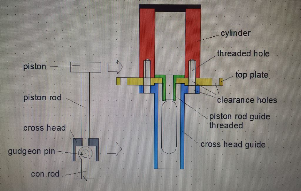

                                              geoff walker 1
                                                @geoffwalker1
                                                Hi Iain,
                                                One last post from me with a diagram I did last night.
                                                Not quite like above Iain the piston rod guide is separate from the cylinder. The register is on the underside of the top plate.
                                                Have a look at the jepson drawings on plans-for-everything.com and also the drawing with this post.
                                                Hope it helps you Geoff see also the photos of the cross head

                                                  On an other matter: Silver soldering.
                                                  I'm trying to understand where I should use sliver soldering around the cylinder. Do I need to worry about it softening or melting, or can I just use it anywhere? Do I need to worry about the thickness of the solder disrupting registration (angling the registered item fractionally?).
                                                  In my youth I did a LOT of electronics soldering and I've done a smidgen of plumbing. Neither of which help here.
                                                  Iain
                                                  #382260
                                                    It would be quite a big lump to solder so probably better to cut from solid CI but what I usually do for things like cylinders if make the flanges say 0.5mm thicker than finished and the bore 1-2mm less then once it is soldered treat it as you would a casting by finishing the bore and machining one flange at the same setting then flip it around to bring to final length.
                                                    If doing it this way bosses for drains etc can just be soldered on. This will give an idea of how I do a silver soldered cylinder
                                                    #382272
                                                    Iain Downs
                                                      @iaindowns78295
                                                      Thanks. I was looking at making the bottom plate and the gland as two parts and then soldering. I guess I'd need to ream the piston hole afterwards – or would I need to do the truing up of all the parts after soldering/
                                                      Iain.
