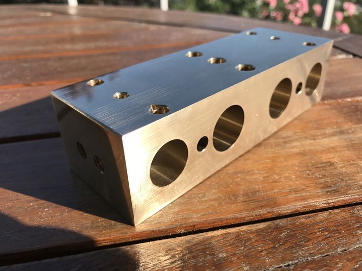

          Well I decided to build this steam engine using the rectangular block. I drilled 3 holes across the center so that I could bolt it to the crompound slide. Put a quarter inch steel plate underneath to center it and used a dial gauge to line it up. I tightened two of the gib screws to clamp the compound and cross slides. This meant that I could bore all the holes on the same plane. I made a boring tool holder for the 4 jaw chuck and used it to bore two main cylinders 22mm diameter with a planned stroke of 36mm and piston length of 10mm.
          I bored two cylinders for the valve pistons which ended up 20mm diameter after making the mistake of boring before drilling the port holes which left terrible burs in the cylinders. So I had to bore them again. I wrote in my notes "drill before boring", but with weeks passing between stages I forgot about that!
          I drilled steam galleries parallel to these cylinders placed between each main cylinder and valve cylinder, but not passing right through, and drilled similar holes on the other side part way through leaving metal blocking the mid-portion.
          The plan is to make heads that duct the steam from these galleys into the main cylinder heads. That way the piston can reach the end of the cylinder without getting fouled up with a port.
          I have a good drill press and used that to drill vertical holes from the top of the block – one near each end of the valve cylinder to act as steam inlet ports, and a single hole at the center as a steam exhaust port. This should be bigger as the steam expands so I drilled right through the block so that steam can exit from both the bottom and top of the block. Again I could have drilled holes side by side to act like a slotted port, but I am concerned that all these ports may damage the piston. I was going to make the pistons from bronze but perhaps I should use stainless.

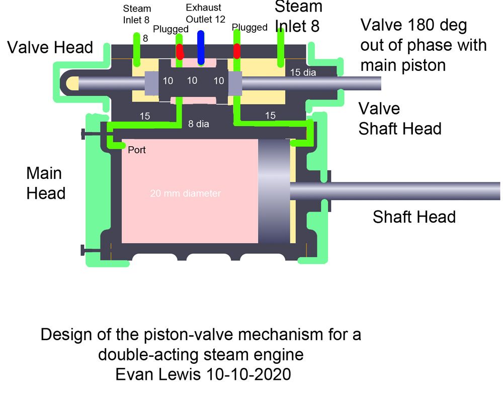

            The valve piston works exactly the same way as a D slide valve and the cross section of the piston assembly is exactly the same as the cross section of a D valve. It consists of two pistons, each 9mm long with only 5mm space between them. Steam galleries 6.5mm diameter were drilled from the ends of the cylinder block, straight across the valve cylinder and into the steam gallery described above. Then the holes in the end of the block were tapped and blocked off with 8mm stainless steel grub screws. That is why the 6.5 mm drill was chosen.
            The biggest flaw with this design is that the steam galleries are too small. And the large mass of brass will take a long time to heat up resulting in condensation. A third problem is that I have read that you should not use brass with steam because it will corrode. I am not sure how quickly that occurs and wether it is really a problem for a model.
            The diameter of the ducts is restricted by the limits of the valving system. I was surprised at how precisely this has to be made so that the inlet and exhaust valves do not open at the same time. Usually slots are used to increase the steam flow. At one stage in the design process I was going to have two sets of these galleries for each piston but forgot about that when I actually came to make it! See photo. Since the holes are 6.5mm and the valve pistons 9mm there is 2.5 mm total overlap giving 1.25 mm steam lap and 1.25mm exhaust lap but i have not been able to find any documentation on how to design the lap. It may be too much? When the main piston is at the mid-point of the cylinder the valve pistons occlude with inlet and exhaust ports.
            I have not decided on rings for the pistons. I was just going to manage without rings but that may not be wise, so I think I will use O-rings but could use some tips and tricks to work out how deep to cut the grooves. Should I have rings on the valve pistons – they would have to pass over numerous port holes and might get torn up? Also the valve pistons would ideally be sealed along their whole length.
            Also I have not worked out how to seal the glands that the con rods pass through. O-rings here too? Placed inside the bearing surfaces?

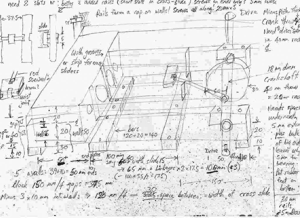

            So now I plan to bolt flat plates on each end of the brass bar as a frame with a brass plate for the floor screwed onto the under side of the walls. These walls will support the crankshaft. Then I will place additional 3 walls between the cylinders and mount brass bars 5x20mm across the tops of the 5 walls to make a T shape 100 mm long for the cross heads to slide on.
            The cross-heads will be about 10mm thick (is weight a concern?) with grooves milled down the side. I do not have a mill but have a milling attachment for the lathe. (Otherwise it could be made from 3 plates screwed together.) The connecting rod will screw into the crosshead and the "swing rod" which connects to the crank shaft will require a wrist joint.
            I plan to have double eccentrics for each cylinder so that they can be connected to a C-shaped slot controller to provide forward and reverse and variable power. But in the first instance I will just use one of them to make it a bit simpler until I am sure it will work.
            I do have some scrap bronze and all the bearings and cross heads will be made from that.

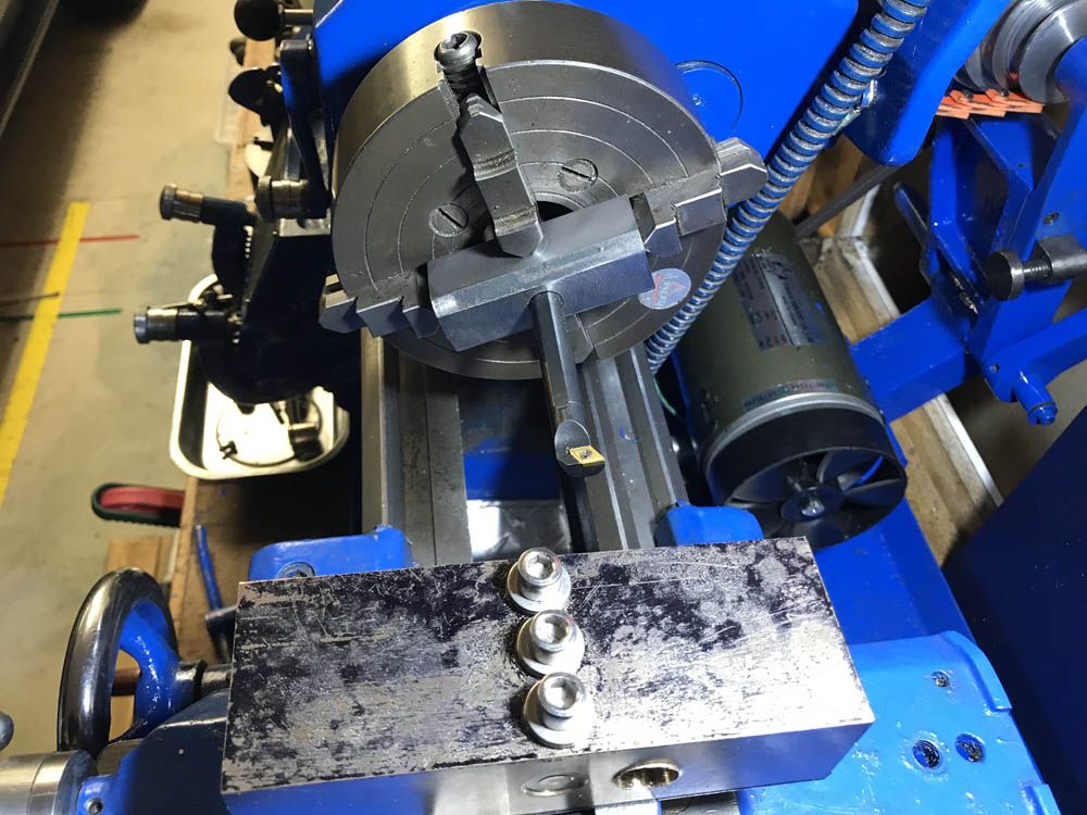

                This is a photo showing the cylinder boring process with the block of brass (covered in engineers ink) mounted using 3 bolts on the compound slide.
                Incidentally you can see the DC treadmill motor I just installed with variable speed control 2.5 HP at 4700 RPM motor speed.
                A photos of the boring bar holder in the 4 jaw chuck for boring cylinders

                Rough sketch of planned engine design #1
                Sketch #2 includes the cross head and crankshaft. It top left I sketched two types of cross-head slider and plan to use the design to the right. Probably made of bronze.
                Rough Sketch
                The following is an image I took from an animation in Wikipedia and this has been the basis of my design. I altered the slide valve to make it look more like a pair of pistons. The gap in shaft shouldn't be there! I said the valve pistons would be 180 degrees out of phase with the main piston, but this is adjustable and an approximation.
                Rough Sketch #3
                This is the end view showing the "walls" between all 4 cylinders with a brass bar on the top to act as slider surfaces for the cross-head. The 4 cross heads will be about 25mm square and 10mm thick with grooves cut down the edges to run on the brass slider.
                Rough Sketch #4 - End View of the cylinder block with slide rails

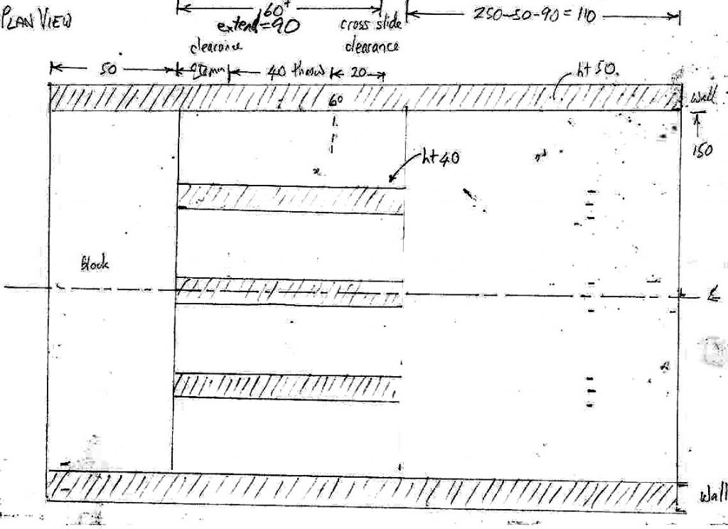

                Plan view showing the walls and the brass sliders will be mounted on top and screwed to the walls. I have reduced the thickness of the walls to 5mm aluminum bar.
                Rough Sketch #5 Plan view

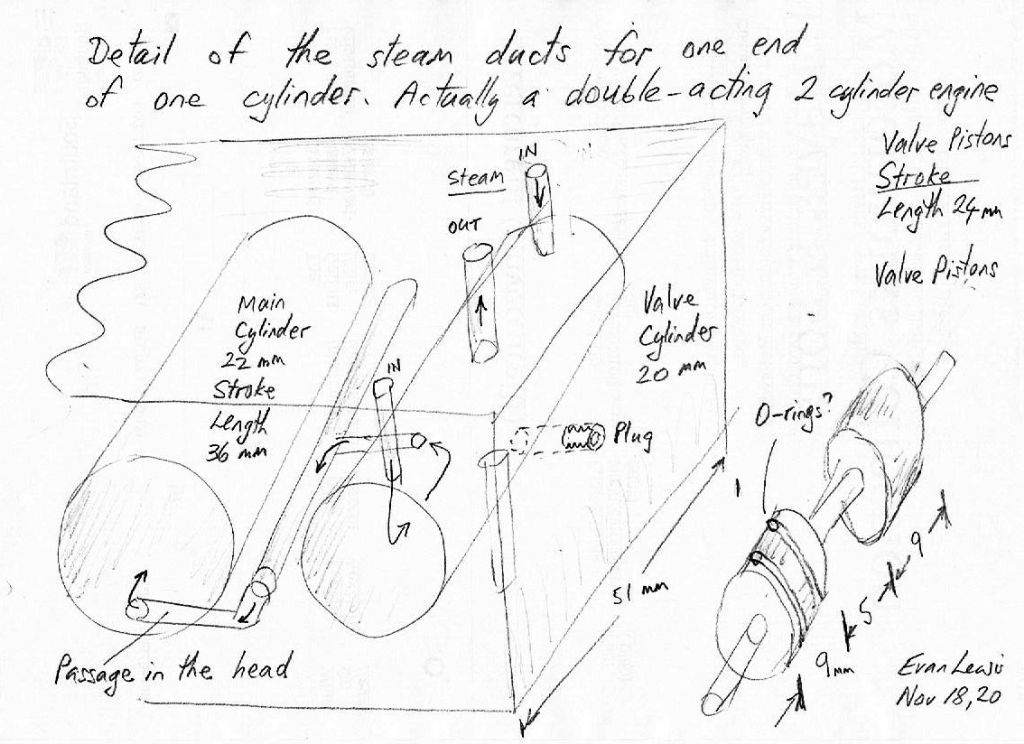

                  I just drew another sketch of the steam ducts and galleries which I have already drilled in the cylinder head shown above.
                  I have also realized that if I obtain a 50mm diameter steel bar I can easily achieve the 18 mm offset I need with my 5" 5-jaw chuck. So i will be able to make the crank shaft from a single piece.
                  Sketch #6: The steam ducts and galleries that have already been drilled into the cylinder block.

                      My observation is the valve needs to be 90 degrees (plus say 10 to 20 degrees advance) out of phase with the piston, not 180 degrees.

                            Side walls and internal "Walls" which support brass sliders (20x5mm brass bars) centered on the cylinder axes:
                            END VIEW
                            Showing the walls and slider bars

                            PHOTO of the brass block covered with engineers blue, mounted with 3 bolts on the compound slide of the Boxford A lathe. This uses a purpose built boring bar holder in the 4-jaw chuck. The position of the boring tool is fairly easily and accurately adjusted with a dial gauge.
                            Note: You can the motor I installed recently. It is a 180 volt DC motor out of a treadmill with a Chinese pulse width modulator HQ-SXPWM-X speed controller.  It is very nice to use!
                            PHOTO of the finished brass cylinder block. That is all I have made so far.

                              Thanks Neil for the timing tip. I knew I had to find out the exact phase difference. It will be adjustable by moving the eccentric cam on the crankshaft which will be held in place by a grub screw. So 90 degrees plus 10-20 degrees advance will be the starting point.
                              I assume the advance is to cushion the change in direction as the piston approaches top dead center?
                              I have read about steam lap and exhaust lap, but not sure what effects they have. Not sure about the role of "lead" either. Do the following numbers seem reasonable?
                              The ports are round, 6.5mm diameter (originally planned to be 8mm) and the valve pistons 9mm long by 20mm diameter. If these pistons are placed so that they are centered over the two inlet ports when the valve piston assembly is in the mid-position, this will give symmetrical laps of (9-6.5)/2 = 1.25mm. ie steam lap=1.25 and exhaust lap=1.25 with stroke length 24mm.
                              I have not made the piston assemblies yet. If I put O-rings on the valve pistons it might affect this behavior if the pistons are not a tight fit. Should I use O-rings. If not the design will be subject to decreasing efficiency with wear.
                              I plan to have two eccentrics for forward and reverse operation with a sliding control added later.

                                    To me your valves and passages are massive compared to the cylinder diameter, if running on steam it's not going to work too well and drag from those O rings will be high. I have done 24mm dia cylinder engines with 6mm dia piston valves and 3mm passages, may be worth sleeving down those big valve holes.
                                    #508408
                                    Evan Lewis
                                      @evanlewis60038
                                      Thanks for your advice Jason. I am surprised because I thought these ports and ducts were too small and didn't imagine it would be much of a problem if they were too big. What happens with the large size? Does it have difficulty maintaining pressure with the large volume.
                                      You mentioned specifically running on steam and that suggests to me the problem may be caused by the steam cooling down, and the huge mass of the cylinder block wouldn't help with that. Yes the large passages would slow the steam passage. But the pressure seen in the passages would be the same as the pressure produced by the boiler if the passages are large enough (?)
                                      If it is a volume issue I suppose I should insert sleeves in as many areas as possible? I can't change the ports themselves as that would require re-boring the valve cylinders yet again.
                                      The valve cylinder size was supposed to be half the final result of 20mm. I had some manufacturing problems. I did not figure out why, but on one occasion the cylinder turned out larger at one end -cone shaped. The boring bar must have moved. I bored the cylinders and THEN drilled the ports leaving serious burs inside so I had to bore it twice more. Again I did not think that the passages being too big would be a problem.
                                      Yes friction may be an issue, especially with O-rings. I may leave the valve pistons plain and even the main pistons too -depending on what advice I get from you and other experts. Of course I can always take it apart and add O-rings later.
                                      Thanks again.
                                      #508430
                                        It's more to do with expansion, after the exhaust stroke those passages will be at atmospheric pressure so as the fresh incoming steam enters them it will expand and loose some energy before it gets to the face of the piston. Ideally passages should be of sufficient area to supply the required load and any dead space kept to a minimum including gaps between main piston and end covers.
                                        Looking at your inlet, exhaust and passage sizes and comparing them with a similar bore Stuart 10 series engine they use 5/32" inlet pipework which would have approx 3mm bore and 3/16" exhaust with a bore of just under 4mm which is considerably less than the 8mm & 12mm OD of your engine.
                                        Likewise the 18mm diameter of the crankshaft is probably a good 10mm more than it needs to be creating more friction in the bearings and the eccentrics needing to be big enough to fit such a large shaft will also have increased friction for the size of engine.
                                        Piston rods (Conrods are what attach to them) are usually done in stainless and 4-5mm diameter would be well upto the job. I tend to go for graphite yarn to pack around the piston rod and valve rod, though O rings can be used. a single 2.4mm section x 19.4mm ID metric viton O ring in a groove 2.3mm deep and 2.6mm wide will seal the main pistons well and not produce much friction. Valves I would just lap into their holes.
                                        It's what is in the boiling water in the boiler that can affect brass not the actual steam so engine parts will be OK
