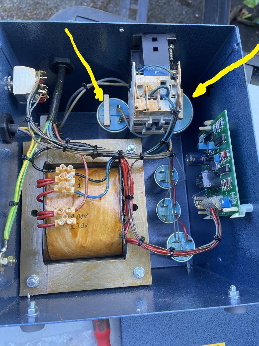

      Came across this static converter at car boot sale.
      Didn’t overpay but when home took the lid off, the start and run caps are missing.
      It is identical to this pic cribbed from an earlier post.
      Can anyone help me with the size (uf) of the start and run capacitors
      It is a 2hp Motorun static converter.

              It looks like a late model 2Hp unit. I take it that’s not your machine as the caps are there ? Noel

                  If you don’t mind taking a punt based on a bloke on the internet guesstimating:
                  • Big one – 250uF
                  • Little one 32uF
                  Exact values not critical provided you’re not too worried about phase balance, so ±25%.  Both rated 450Vac,
                  Risk is the values given turn out to be not “good enough”.  Suitable capacitors are expensive.
                  With luck someone else will recognise the model, and have a circuit or will look inside.   Replacing with what the manufacturer used is always the best place to start – if you can.

                    Interesting.
                    The values of 32/250uf seem huge.
                    I have another earlier Motorun converter that has 20/40uf and that starts the lathe and mill quite successfully.
                    I have tried transposing those but on switch on it engages but wont turn the machine….just hums.
                    Just beginning to wonder about that pesky pcb not quite sure what that does.
                    Just hoping someone has similar machine with pcb whoc can tell me start and run cap values.

                      It’s to do with how much power the motor actually consumes.   Motors often pull massive amps when first switched on, before settling at tick-over power.  When the user loads the motor by doing work, the amps increase again.   How far third phase shifts  depends on the current, so the capacitor values are a compromise.   Static converters usually allow the user, or a digital controller, to switch more capacitors in and out for best effect.
                      Results are mixed because they depend on the motor and what you do with it.  If the capacitors are too small, may not start at all, or be unable to supply full power to a big motor.  Especiall one that likes it’s phases to be power balanced 120° apart, not a wobby 180°.      The values I suggested should be big enough to start most motors in the 2HP range, fingers crossed!
                      Might well get away with smaller capacitors if the motor is friendly (low start amps), and isn’t called on to deliver 2HP.   In practice a heavily loaded 2HP motor will output a lot more than 2HP, for which big capacitors help.
                      The transformer is good.  It helps the capacitors balance the phase, maybe allowing smaller ones to be used.
                      That’s the best answer.  Judging by the size of the big one in your photo though, it’s lots of uF.
                      Static converters are great when they work, but there’s always a chance they won’t.  It’s why rotary converters exist.  VFDs are even better.
                      They all have pros and cons.  Static converter capacitors often fail after a few years because they take a real beating, and replacements are expensive.

                        For what its worth my early Motorun has 8 caps but it is an 8Hp unit in essence 2x4Hp.. With out dismantling I can only read some of the values. 75uf at 440v, 105-130uf at 280-350, and 8uf at 440v. There are 2 bigger ones and 2 smaller ones. As to the life of caps in this application my transwave is about 25 years old and never failed. The motorun starts at .5Hp to 1.25, then 1.25 to 2.25 and then 2.25 to 4hp by switching in caps. Good Luck. Noel.

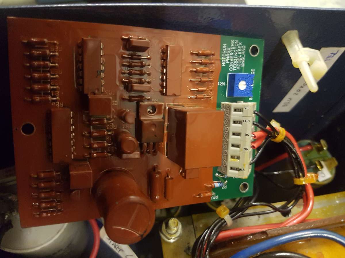

                                That pesky pcb board is a worry.
                                It has 2 x red wires labelled 20volt go direct to transformer,
                                It has  2 small black wires labelled con and yel they go to the start contactor.
                                It has 1 small black wire labelled blu that goes to the cap bank.
                                And it has a potentiometer labelled volt adjust.
                                I just don’t know how to test this………yet but i’m not giving up.
                                What I do find disconcerting is label blu but its black and goes to the cap bank wired red.
                                Then label yel is black?
                                Presumably they didn’t have the right colours availble.

                                  This is the junction block on pcb

                                          Neither do I!  Can you trace the circuit?   What it does is simple enough in principle – it switches capacitors in and out to match the motor’s actual needs.   Simple units provide switches and expect the operator to find the match experimentally.   More expensive units are semi-automatic, or automatic.  Much harder to reverse engineer.
                                              This Motorun unit has switches for power selection(switching caps) and a high low switch for start.
                                              The control board I have pictured I think maybe some sort of delayed start together with a voltage sensor cut off.
                                              I suspect this may be faulty but its way above my pay grade.
                                              I have to decide now what to do, either get to grips with the control pcb or use the  parts to make a simpler converter.
