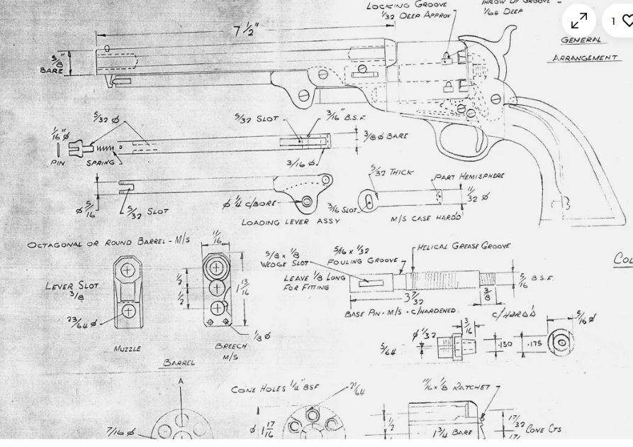

                  I did find the rest of the sheet that Michael posted a partial image of yesterday. That would give you a lot of sizes and if scanned into a CAD package would allow other sizes to be picked up, certainly good enough to make a gun that for all except the bullet counters to spot the difference.

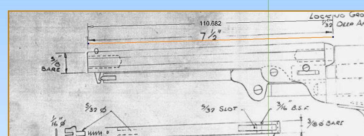

                      I noticed that drawing from Michael but can’t see the dimentions, being a dummy how do I scan on a CAD package.

                        Well after a visit to specsavers
                        You could follow my link and get the whole sheet at a better resolution. Or opening Michale’s ebay link the first thing to do is click the image and it will come up larger and easily read.
                        When you have it open take a screen shot or use a snipping tool so the image can be saved as a .jpg.
                        colt
                        Depending on the CAD it can differ but with Alibre I would then use the “trace” option to import the image. After that I tend to draw a line to a know dimension, in this case to match the 7.5″ barrel length. My line is not that long so a simple bit of maths will tell me I need to englarge the image by 1.72%

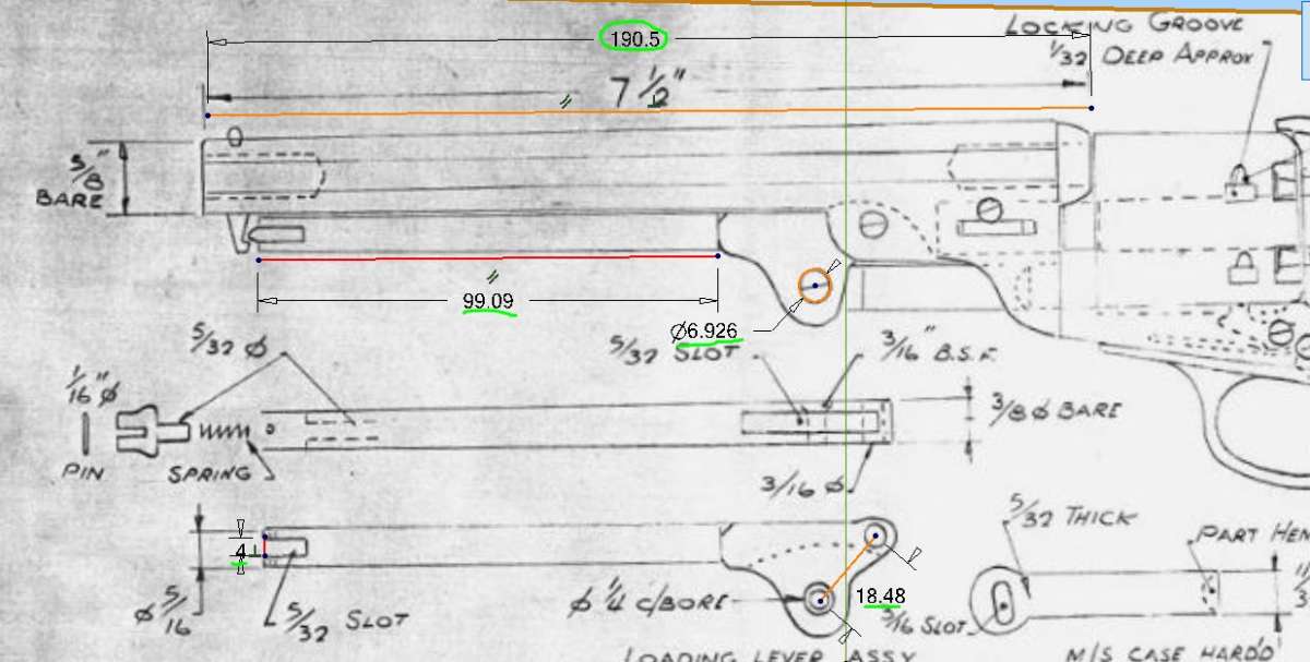

                        colt2
                        New line confirms I have the length right, also otated the image slightly. I can now draw lines and circles where there are no dimensions and the size of those will give me quite close sizes, a bit of common sense will be needed altering thing sto what may have actually been used eg the 99mm line may have been 4″ and the 7mm circle 9/32″

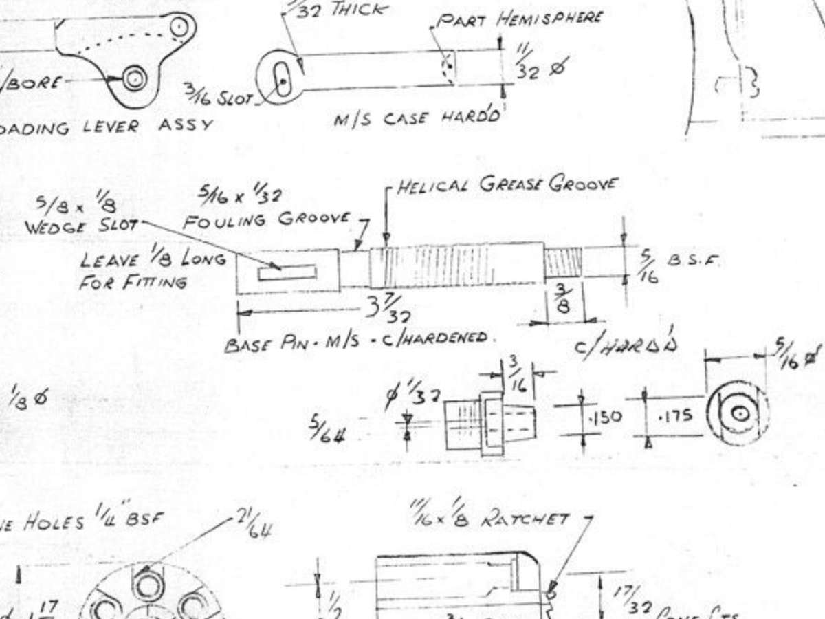

                          Thanks Harry
                          That first fragment of a sketch [1851 Colt] is packed with dimensions
                          … here’s a crop from it [using my iPad]
