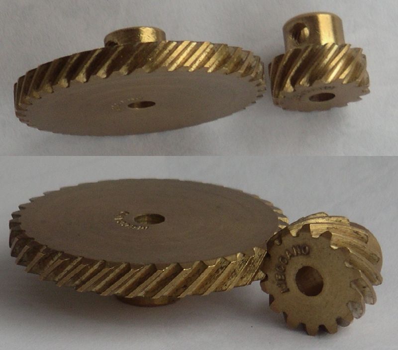

        Does anyone know where I can get a pair of worm and wheel gears for this sort of arrangement? The reduction ratio needs to be 2:1 (i.e. for a 4 stroke engine) and the diameter of the crank shaft will be of the order 10mm to 12mm ? I’ve spent a while trying to find them on Google, but haven’t managed to come up with anything yet.

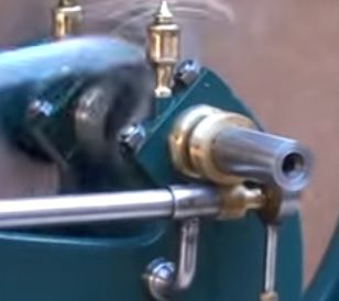

                              About 1:47 into the below video is an example of my above post.

                                It depends on the helix angle. For helical gears, if you want a right angle drive then the helix angles just have to add up to 90 degrees. The pitch diameter of a helical gear is given by N divided by (DP x Cos(A)) where N is the number of teeth, DP is the Diametrical Pitch and A is the helix angle. For 45 degree helix angles Cos (A) =1 so the relative diameters depend soley on the number of teeth – 36 teeth will be twice the diameter of an 18 tooth. If you choose 26.6 degrees and 63.4 degrees for the 2 helix angles then you end up with 2:1 gears that have the same OD – which is what the Wyvern uses:

                                    You can see the angle on this Domestic that I made, the shallow angle on the crank gear lets it be larger than the cam gear where you would normally find the opposite with spur gears. This allows the larger dia crank to pass through without such a thin wall as in Rod's photo
                                    Better shot where you can see the helix of both gears
