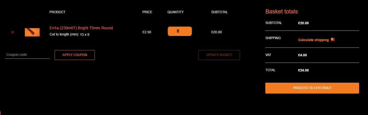

      Hello, I am new to the locomotive game, I am struggling to buy easy machining mild steel from which to make 8 No. plain wheels for my diesel loco. The finished wheels are 9.5mm thick and 72mm in diameter at the tip of the flange. I assumed that I would be able to buy material supplier cut disks (rough) say 3″ or 75mm dia and 13mm thick so that i could machine them down to size on a mandrel.
      However, all of my text books suggest cutting the discs your self from flat bar. This seems vey wasteful and hard on my tools just to get a blank.
      Am I missing something here? I thought that with the advent of water cutting getting steel disc blanks might be possible, even sensible?
      Are there companies that can supply standard size machined blank wheels? Again I have seen some reasonably priced wheels out there but only for one particular size which is a smidge too small for my loco.
      I hope that you can cast some experience on this matter. Cheers

        Look at M-Machine in Darlington; they will cut blanks to length from appropriately sized round bar.
        Julie
        #834385
          As Julie says I have also used M-machine to cut slices to length. The advantage of round over flat bar is you are also more likely to get a freer machining steel. 75mm dia EN1A would be nice to work with.

            speak to your local lazer cutter ! Cut from 10mm plate they will be fine. Noel.
            #834403
              About twice the price for laser cut S275 from the cutters I have used previously and it is not such a nice steel to machine.

                According to folklore, wheels made from plate tend to wear oval. This is reputed to be because rolled plate has a grain different in the direction of rolling than transverse. This probably doesn’t matter in a model, but starting from slices of round bar is easier anyway.

                  Try Rapid Metals
                  #834439
                    Rapid looks a good price, I’ve only bought 1m lengths of steel from them in the past where they were also a good buy.
