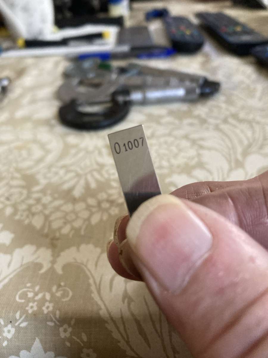

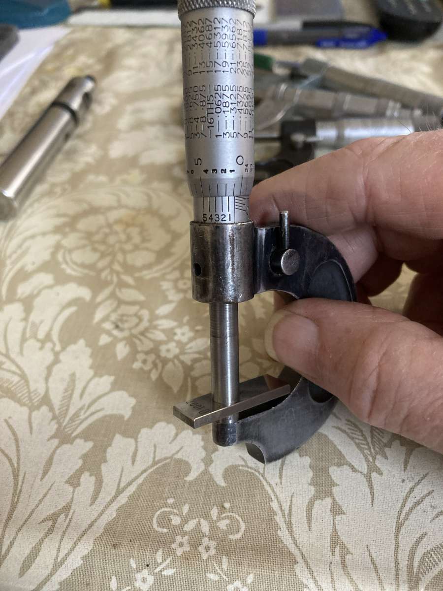

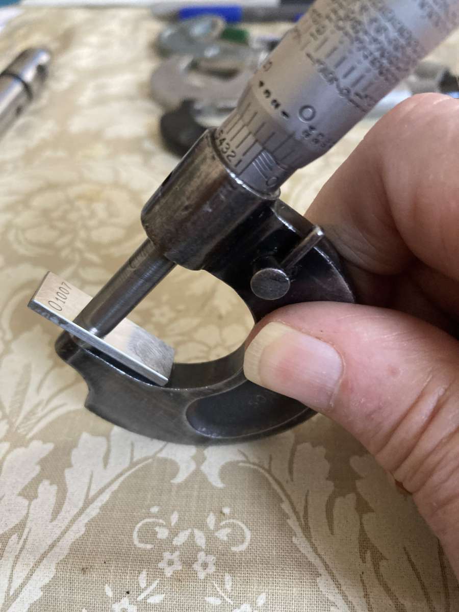

        It wasn’t created to “guess” anything. It’s right in front of you to see. This mic has 2 vernier scales directly opposite each other. Look at the photos and you will see the progression of the lines from gap to gap and the numbers are there almost in the middle. The numbers refer to the gaps. At the other end the numbers refer to the lines. The End.  Photos to come.
        #843205
        Graeme Seed
          @graemeseed34272
          1.0007 slip gauge, You have 1/2 thou as the barrel is past the 5, your looking for another 0.0002. The 2 line on the sleeve end is opposite the 2 space at the other end, Its in the middle so it 2 tenths or anywhere in that space.IMG_3948IMG_3947IMG_3946

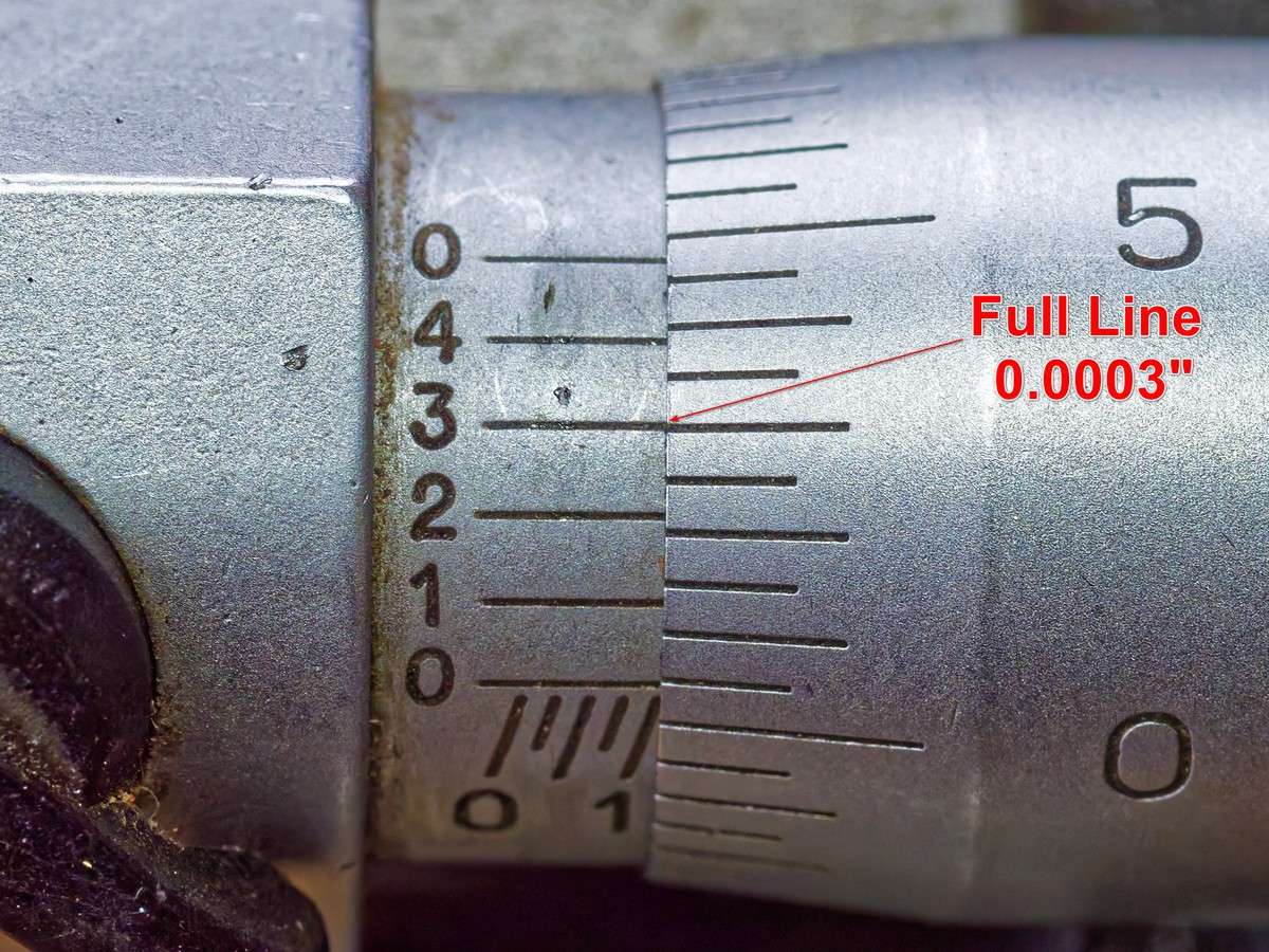

            I’ve been out playing again, having found an external mic with a 0-5 vernier.
            It’s a Tesa, rather than a Shardlow, and actually numbered 1-2-3-4-0, but the principle is the same.
            For the digits up to full thou, obviously read as normal off the thimble, the tenths digit reads off the body vernier scale as expected.

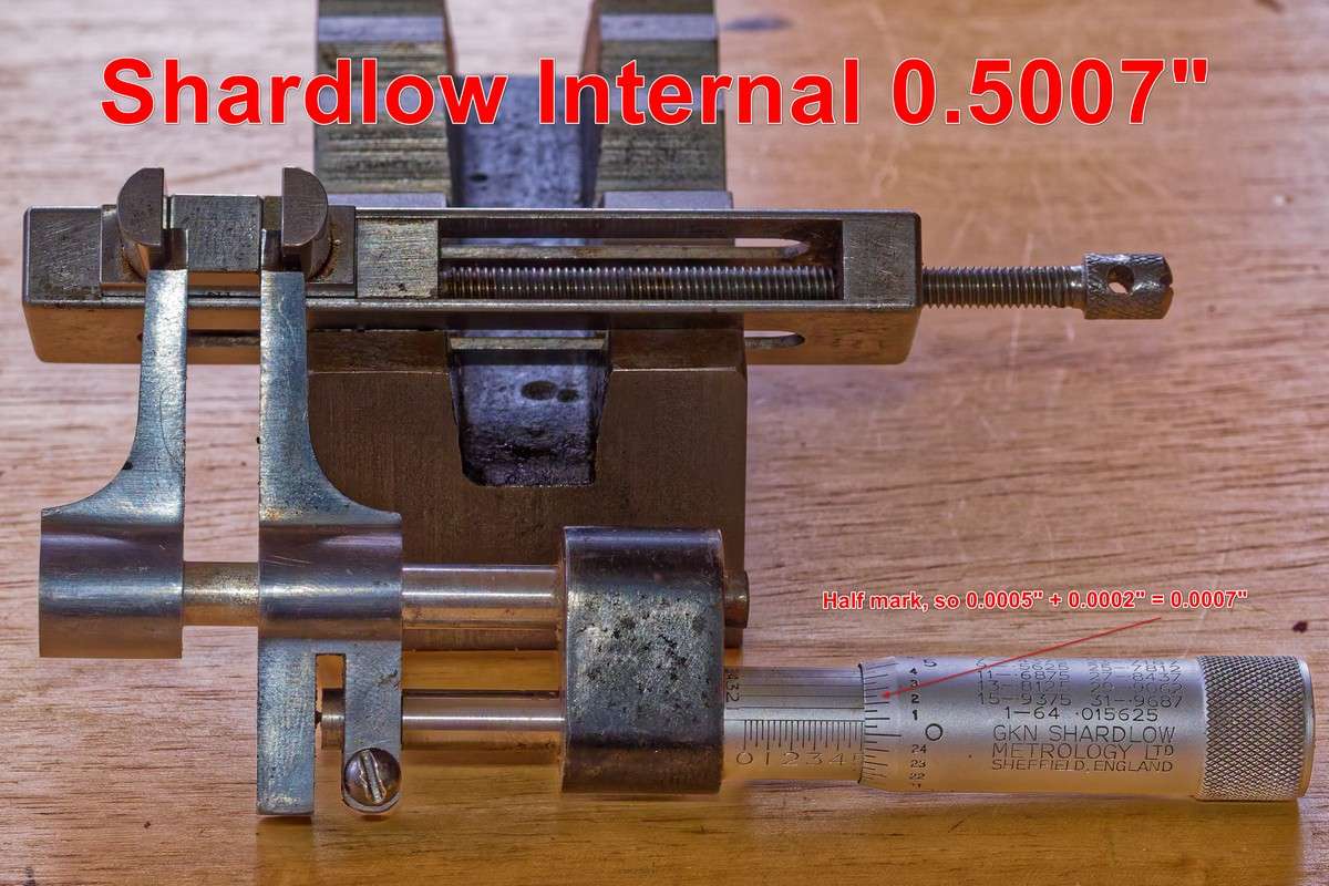

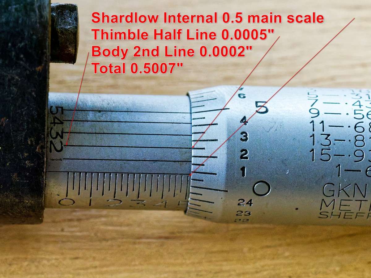

            Firstly the internal Shardlow, but with all that leverage, it’s hard to get fully repeatable results each time.
            I set it up with 0.4″ + 0.1007″ slips, giving a total of 0.5007″
            Shardlow Setup_tn
            Close up
            Shardlow 7 tenths_tn

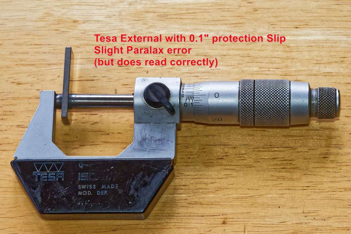

            All a bit fiddly, so swapping to an external Tesa shown here with a protection slip
            Tesa Setup_small

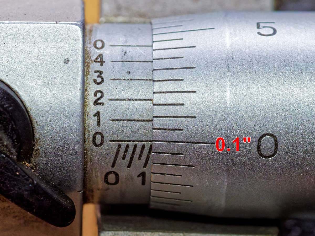

            Next we have just a plain protection slip 0.1″ side view close up
            Tesa Protection side_small
            0.1003″ side view
            Tesa 3 tenths_small

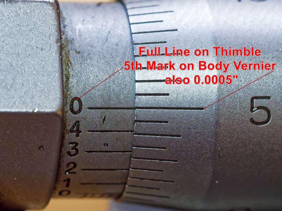

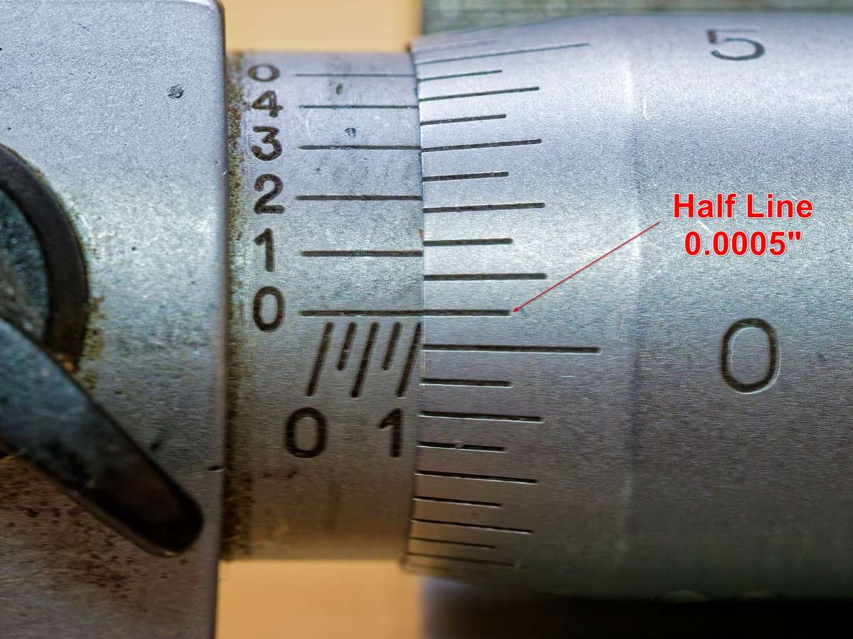

            Then 0.1005″ from the same perspective, so the half line on the thimble lines up with the zero on the body.
            Tesa 5 tenths_small
            But from the top view of the same 0.1005″ the long line on the thimble ties up with the 5 on the body (Or perhaps confusingly on the Tesa, a zero, but it’s still above the 4) so still showing the same result
            Tesa 5 tenths top_small

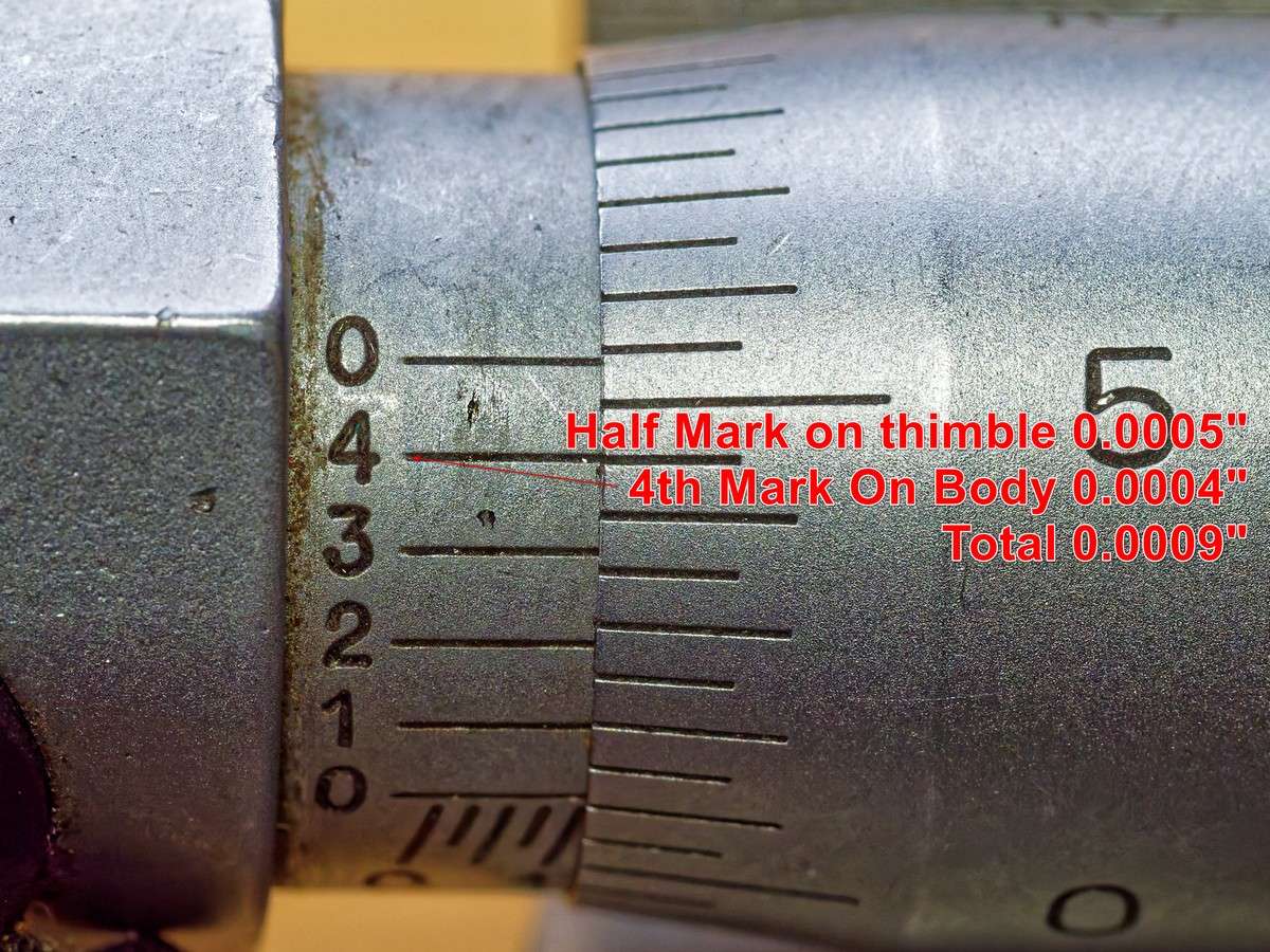

            Now for 0.1009″ Half line on the thimble lines up with 4 on the vernier, so 0.1005″ + 0.0004″ = 0.1009″
            Tesa 9 tenths_small

                Hi peak4, great reply thanks. Your internal mic is the same as mine except that you have 1/2 thous on the thimble scale and I don’t. The half line of 2 on thimble coincides with 2 as vernier so 0.0002, exactly as I’m saying, albeit I can see 1/2 thou and a middle  without a line
                Now for your 1.0009 — The mic is set at the top zero with thimble line at 5 1/2 reading over 0.0005, correct.  The vernier 4 coincides with the 1/2 HALF on the thimble . It’s exactly what I’m saying, its 1.0009.
                The vernier reading which is added to the 0.0005 will always be on centre small line. My mic also has something that yours doesn’t  – my thimble is numbered to 25 [24 then 0] yours only has increments of 5’s, but it does have the halves which mine doesn’t. I hope that our conversation has clarified my initial question to all involved in answering and wish everyone a happy Easter.
