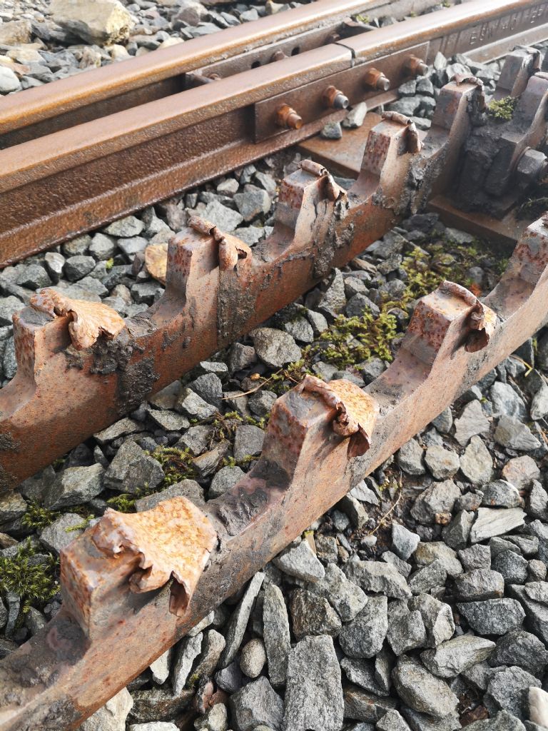

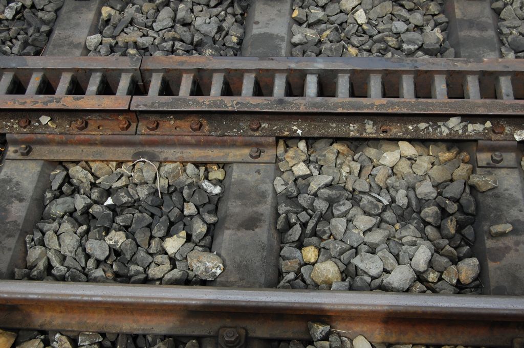

      img_20221129_124114.jpgWalked up Snowdon (Yr Wyddfa) today with a couple of pals. Fabulous walk and lovely weather.
      Coming up the Pyg Track we came to the Snowdon Mountain Railway track and I was astonished to see the wear on the rack. Whether this is one season's worth or more I don't know. There was a gang out lower down the mountain working on the track and I assume/hope they were replacing the rack.
      I thought folks might be interested to see the extent of the wear.

        Rack wear on the Snowdon Mountain Railway

        Mark Davison 1
          @markdavison1
          Looks like someone has placed fallen leafs on each tooth.

            I live in Switzerland and travel fairly often on rack railways. Generally they are well lubricated and I have seen nothing like that surprise

              Posted by Mark Davison 1 on 29/11/2022 19:23:04:
              Or someone has been welding with a material that has spread under load?
              One might wonder what the loco drives are like?
              BTW, it’s not (or won’t be for long) called Snowdon.  Too English, for the Welsh, apparently.🙂

                  The steel that the rack is made out of leaves a lot to be desired. I wonder if the sections were originally made with a symetrical profile, so they could be turned round?

                      Is it lousy modern material, in ‘pattern parts’ or have they increased the loads to such an extent that the design is no longer fit for purpose ?
                      I would love to see the original design specification.

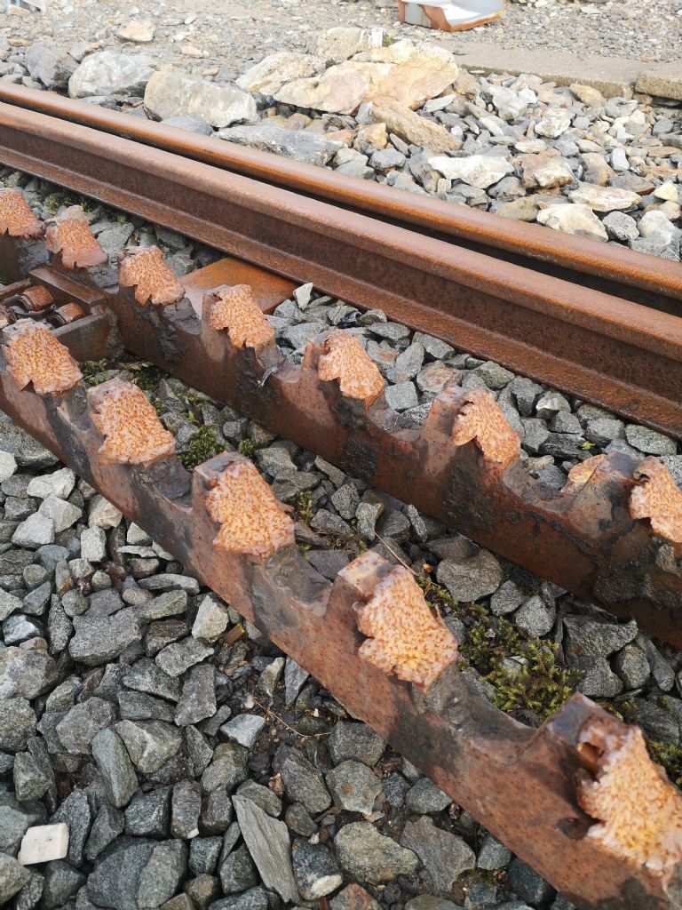

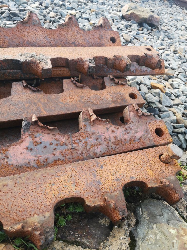

                          This is a photo of some bits of rack lying at the side of the track around half way down. I imagine they have a specification indicating how much wear can be tolerated before replacement, and an inspection regime to check the condition of the rack through the operating season.

                            Looks like the rack is sacrificial soft iron, almost a consumable

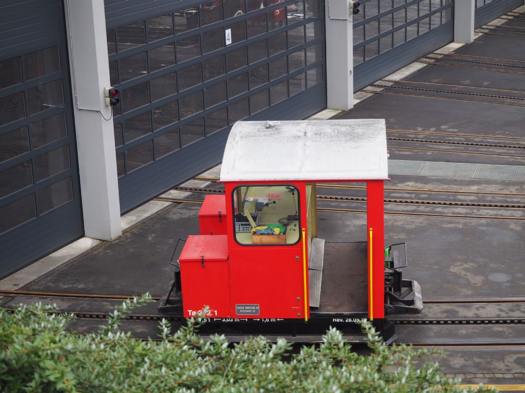

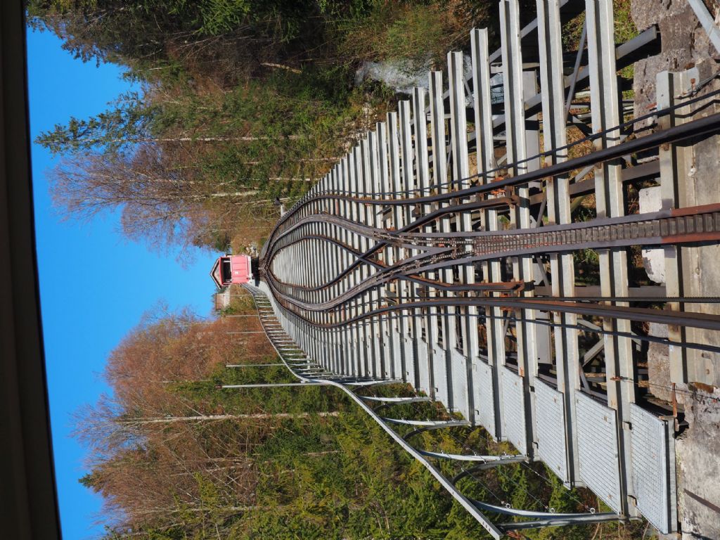

                                I had a look through my pictures to see what racks were fortuitously there. There is one of the depot at Vitznau and one on the Geisbach railway. Both are Riggenbach and virtually unworn. The rusty pictures are slightly confusing. They could be the points section of a Riggenbach system or an Abt system.

                                  Having the parallel pair of racks with the teeth staggered by 1/2 a pitch and the twin gear wheels underneath the locomotive also offset to match makes a smoother drive

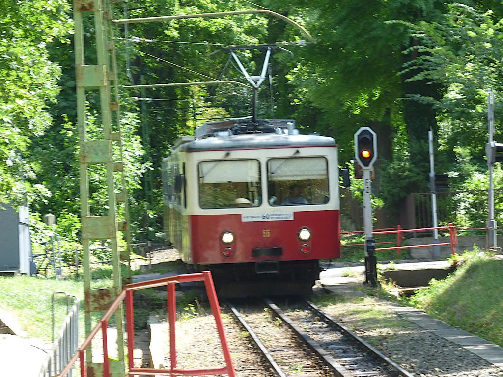

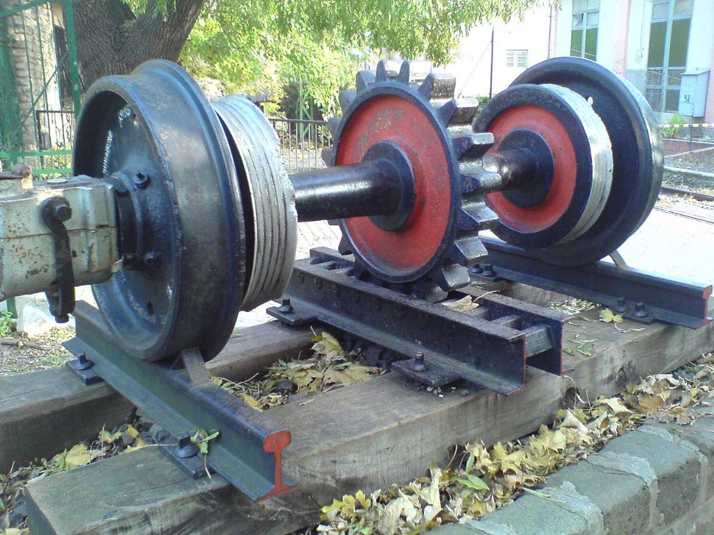

                                    This one seems to be a bit different, the Budapest Cog-wheel Railway, is a rack railway in the Buda hills part of Budapest. It connects a lower terminus at Városmajor and with an upper terminus at Széchenyihegy. The line is integrated into the city's public transport system as tram line number 60, is 3.7 kilometres (2.3 mi) in length, rising some 264m.
                                    Coming into the station.
                                    The rack
                                    The drive system consist of a single rack and wheel. It uses the Strub cog-wheel system. (the link is to Wikipedia) The wheel & rack display seems to have a slightly different construction to that actually fitted between the rails (might be an earlier version)
                                    Edited By Journeyman on 30/11/2022 18:56:47

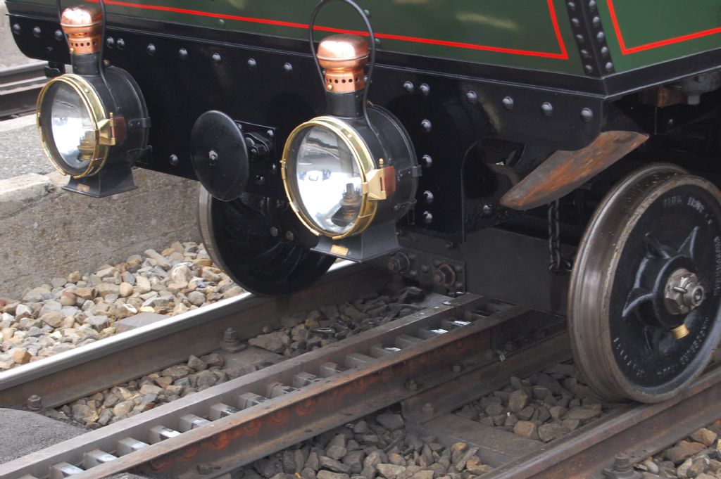

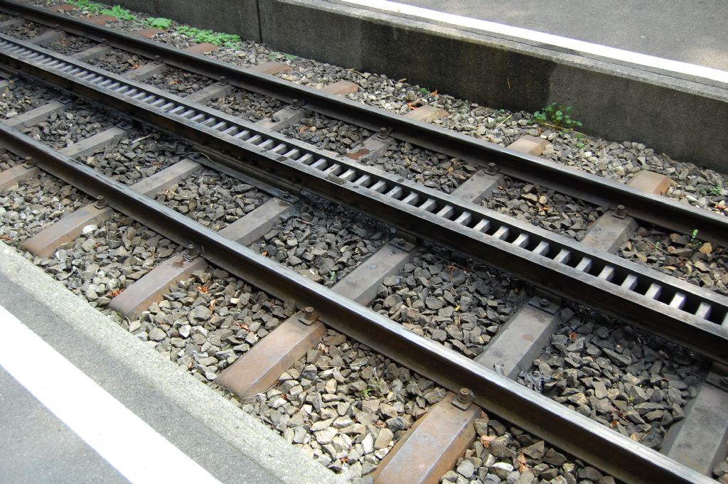

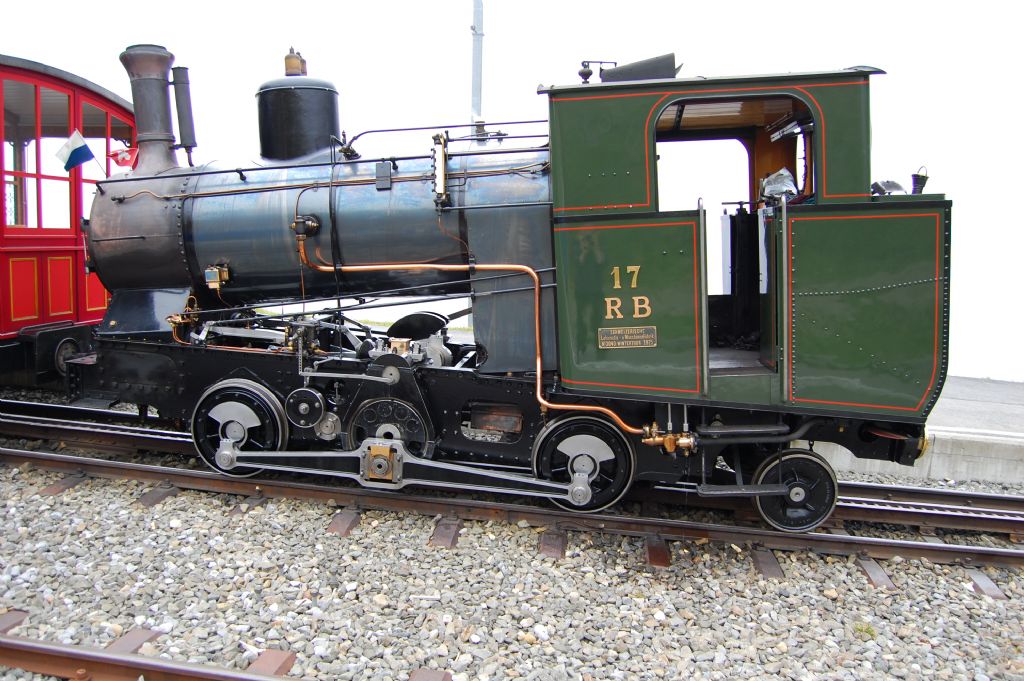

                                      Visited the Vitznau Rigi Railway about fifteen years ago, the following may be of interest.
                                      Rob

                                        Well, apart from a minor mishap on opening day in 1896 when an apparently overloaded loco lost control on the way down, and having been abandoned by its crew, fell off the mountain! The coaches stayed on the track only to be hit by a following loco…. **LINK**
                                        ….the railway seems to have an excellent safety record, so we must assume the team up there know what they are doing.
                                        It does look like the relatively soft rack is allowed to wear away protecting the hardened pinions on the locos which must be expensive and tricky to replace.

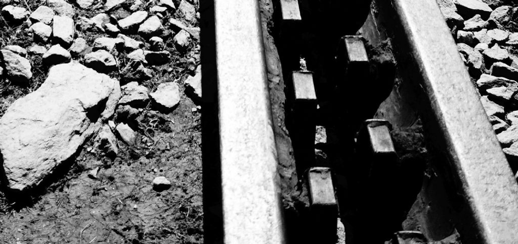

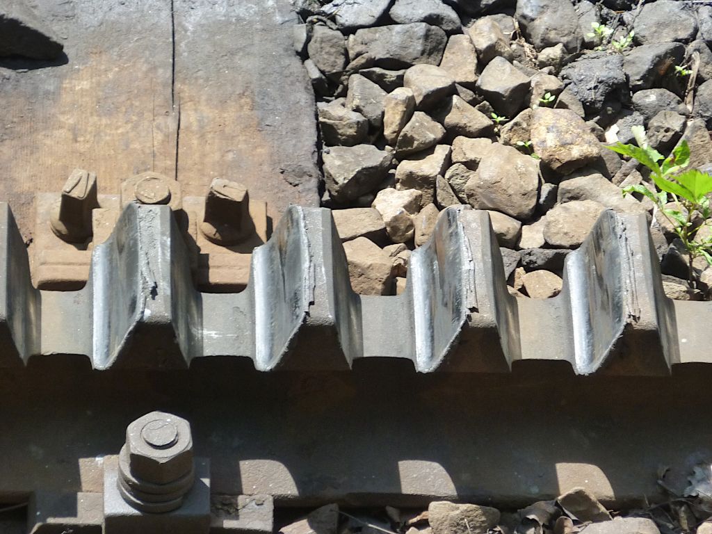

                                            This was the Snowdon Railway track in 2015 (you should be able to click for a larger version):
                                            (Please forgive the black and white – I was playing with a new camera)
                                            Edited By Andy_G on 01/12/2022 10:14:42
                                            Edited By Andy_G on 01/12/2022 10:15:34
                                            #623270
                                              Thanks for sharing that photo, Andy
                                              Monochrome suits the subject very nicely
                                              Foreground detail usefully shows some ‘smearing’ of the metal already.
                                              Edited By Michael Gilligan on 01/12/2022 11:52:14

                                                That shows the running rails as well. When I went up there many years ago you could see through the web in many placesno

                                                  I suppose it is a safety factor to have more wear on the rack than on the pinion on the loco. If you lose a tooth or two off the rack, the next tooth on the rack will stop the loco sliding backwards all the way to the bottom of the hill. But if you lose a tooth or two off the pinion, things could get rather tricky rather quickly.
                                                  (Ignoring of course the double rack safety feature and just focusing on the operation of one rack. )

                                                      Isn't the excessive smearing a function of the tooth shape of the cog, giving a sliding rather than a rolling contact – perhaps the cogs (or some of them) have a lot of wear which has destroyed the ldeal form. I guess the swiss can afford to keep the mating parts in better nick.
