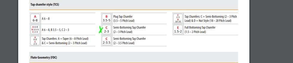

                          Snipped from the Dormer threading catalogue.
                          c lead
                          Most spiral flute taps have the “c” type lead which is a taper over 2 to three times the pitch. makes them less tapered than a plug but not quite as tapered as a bottoming. Other makes also use the same letter codes.
                          So that M3 spiral flute tap will thread to within 1 to 1.5mm of the full dia bottom of your hole. And no muck in the bottom to stop it going in as far as possible.
                          For things like oil cups consider a fine pitch much like old UK drawings would have specified ME threads and you will get even closer to the bottom as the pitch is less for the same given diameter

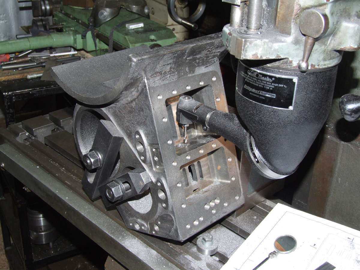

                                        Julie Ann
                                          @julieann
                                          On Clive Foster Said:
                                          …Will teh guy with a quill master attachment please stop sniggering!
                                          Never mind the guy, this girly has a Quillmaster, but I never snigger, it’s not ladylike:
                                          2021_10070004
                                          I rarely use Trefolex when tapping as it is such a pain to remove. It is mostly limited to use on stainless steel and bronze.

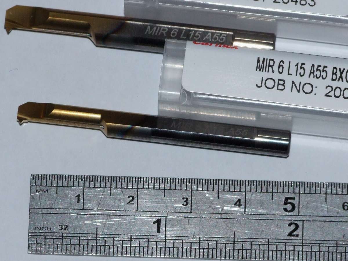

                                          On the rare occasions I need an internal thread to reach the bottom of a hole I screwcut it:
                                          2020_12010006
                                          These internal threading tools are Whitworth form, 32tpi and 40tpi.
