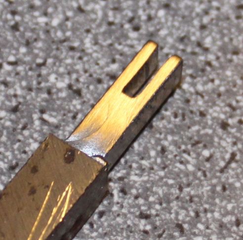

        Elsewhere I bemoaned the fact that I was struggling to mill a small slot accurately.
        I’ve been having another go at it today and lo and behold got it wrong again. TWICE
        Anyway I think its down to the fact that the smallest slot mill I have isn’t small enough so whichever line I line it up on, or whichever side I measure from its wrong cos my mill is wider than expected.
        Now the required slot width is 3/32″ but the smallest slot and end mills I have are 3mm. I just had a look at a tool site and the smallest they sell are 3mm or 1/8. Not small enough. So any suggestions as to how I go on cutting this slot??
        The stock from which I am starting is 3/16 square bar and getting rapidly shorter Its quite difficult to hold too as the finished item is only 3/8″ long.
        Edited By Wolfie on 30/01/2012 18:49:59

                                    Its teh forked end to go onto a valve rod if that helps people visualise what Wolfie is trying to make, off a Stuart S50 I think.
                                    Just one thought Wolfie how much metal are you taking off per pass, I know on your mill clamps you took a full 8mm depth of cut with a 8mm dia cutter. If you are doing similar with your smallest cutter it will flex sideways.
                                    J
                                    #83522
                                    Wolfie
                                      @wolfie
                                      Ha! No not taking 8mm cuts any more, learned that one quickly.
                                      Aye its the forked end piece for the S50 like Jason says (thus open ended) and I’ve made the bloody thing 4 times now grrr

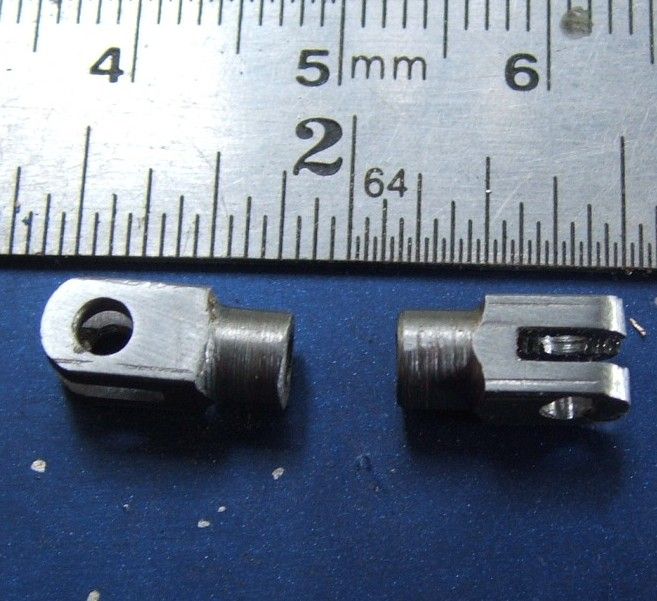

                                      Terryd
                                        @terryd72465
                                        Hi Jason,
                                        If it’s an open ended slot as In a clevis, surely a slitting saw is the way to go?
                                        Hi Wolfie,
                                        is this the type of thing you are making?
                                        Clevis
                                        I made this one below this morning for fun and to test skills I haven’t used in a long time. I had to mill down a piece of rusted 8mm bar to 3/16 (5mm actually). I then filed a groove across0 the middle of the end, to locate a hacksaw blade using the corner of a square file. I cut the slot down with a hacksaw with two blades in the frame which gave me a slot just short of 3/32″ wide and then filed it to width with a flat needle file.
                                        The whole thing (not including milling) took about 10 to 12 minutes, but then again I didn’t bother with marking out, I just did it by eye and guessed the depth, so that would add some time. I just need to turn down the shoulder now. It is steel, the straw colour is not heat treatment but the cast thrown by the lighting in the kitchen.
                                        My Clevis
                                        Best Regards
                                        Terry
                                        Edited By Terryd on 31/01/2012 09:17:39

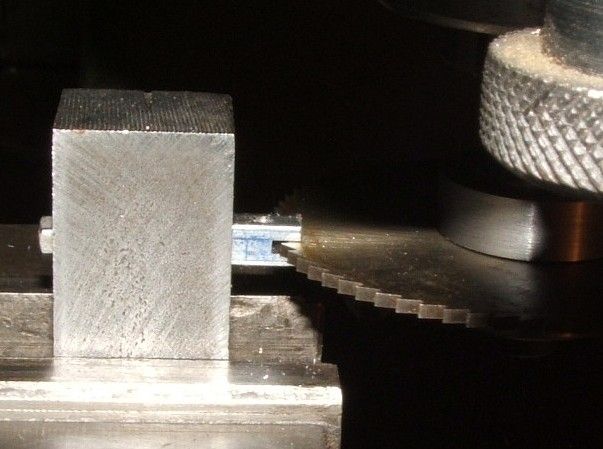

                                        #83524
                                        Terry Lane
                                          @terrylane
                                          Yes, a slitting saw is what you want for those – I have a photo series on making them on this page – be well worth you having a look.

                                              Yes as I said in the first post about positioning the cut a slitting saw is best but you will need to have a decent amount of metal to hold in the vice.
                                              “Another way to avoid an overwidth slot is rather than mill it do it sideways with a slitting saw, again touch the saw down onto the work and calculate how far down to lower the blade.”
                                              But they could be done with teh clevis stood vertically and light say 0.020″ cuts taken, as the slot is only 3/16″ deep your cutter will reach. Will save you having to buy a saw arbor and blade for now
                                              J
                                              Edited By JasonB on 31/01/2012 10:11:27
                                              #83684
                                              Wolfie
                                                @wolfie
                                                Thanks all managed it with a slitting saw.
