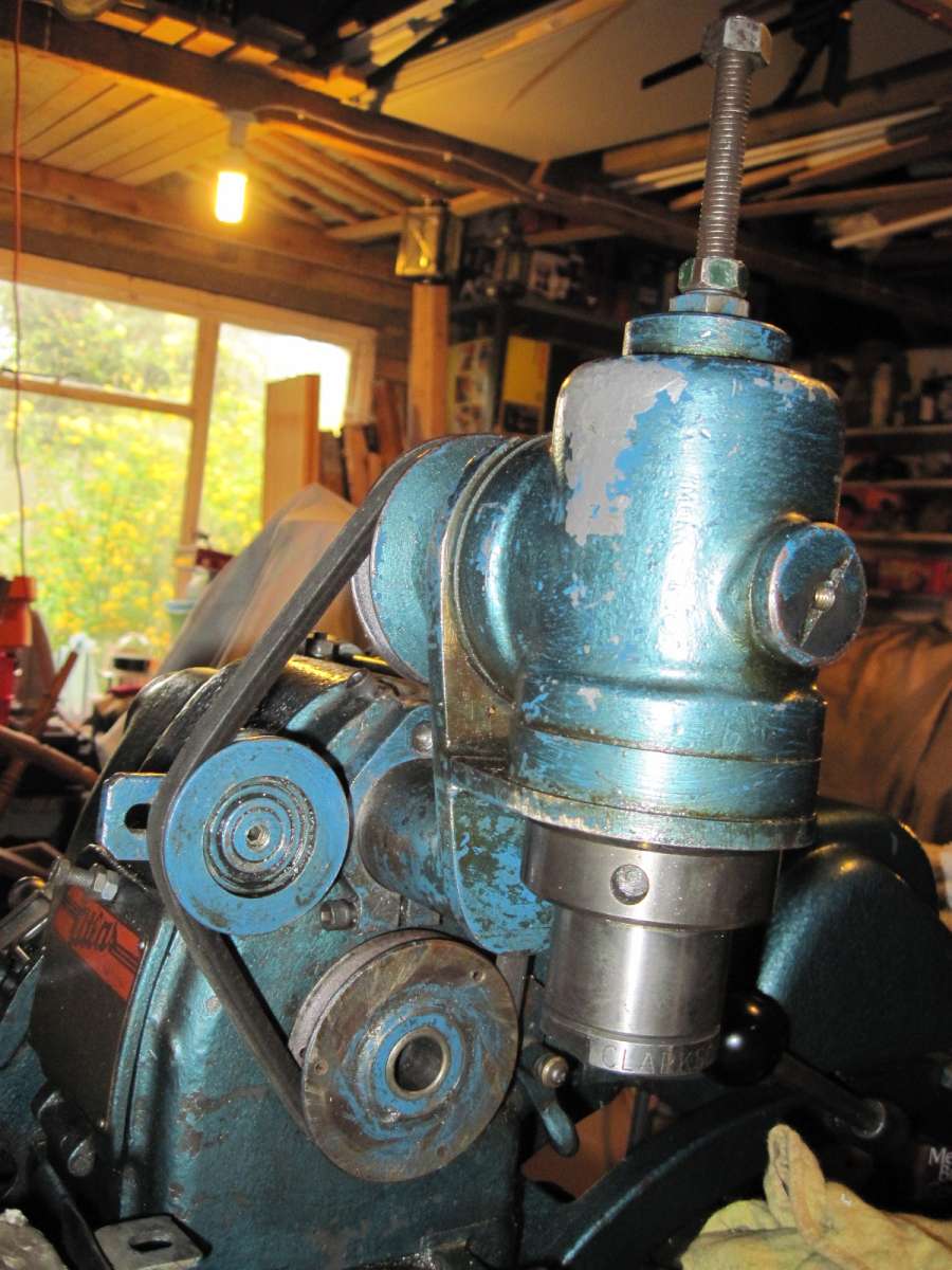

      I have recently purchased a pallas model c milling machine:
      Not this exact one, but the same model:
      pallas
      So, I have a spare 1.5kw 3 phase motor I can use for it, or a 900W single.
      My question is, what are these machines capable of? Ideally I would like to use it for making things from hard steel such as HSS, tool steet etc.
      Basically parts for lathes and milling machines. Is that doable on these?
      I have never owned a mill before so, any advice would be more than welcome. Cheers!

          The simple answer is not much. They were most likely intended for simple second operation use.
          Small horizontals are very limited in power when using side and face horizontal milling cutters, or insert face mills, and tend not to have the speed range for carbide endmills.
          If you want to machine HSS and tool steel it is the wrong machine, you really need a vertical mill with a much higher speed range. It is possible to mill HSS but need carbide cutters run at fairly high speeds so that the shear zone is red hot.

            Agree with JA. I have a somewhat similar machine, a Zyto. Useful in a quite limited sense, I use mine almost exclusively with slitting saws. A 1/8″ wide saw in mild steel is about its realistic limit. Unless modified, problems will occur with the lowest speed being on the high side for horizontal milling cutters and the drive belts lacking torque capacity. A horizontal milling machine needs real rigidity and grunt.
            I’m not really clear about what you need to make from hss etc. You say “parts for lathes and milling machines”, but aren’t these just the cutters themselves? A vertical mill is very much more generally useful in the amateur’s workshop.

                Do I detect a lot of “badge engineering” going on?
                That machine’s stand is clearly marked ‘Pallas’ but looks very like that for my Denbigh ‘H4’ so far partially restored. The very different colour suggests the stand and machine found each other in later life but are very happily compatible.
                Is the mill itself embossed Pallas? (The Denbigh has its name and trademark embossed on both the stand door and on the body of the mill itself.)
                The machine itself is nearly identical in appearance save that my Denbigh has its feed-screw under the table centre-line and the knee screw is operated by the more conventional right-angle drive on the knee itself, above the table.
                However, Tony Griffith’s site does show the Denbigh ‘H’ series, of which the H4 was the largest and most versatile, was designed with second-operation and small-section machining in mind. It was made for line-shaft drive, as was that Pallas, using flat belts laced after threading through the frame; and running vertically above the mill.
                The Pallas’ feed-screw looks like a previous owner’s addition. Some small horizontal mills, including the basic Denbighs, had lever-action feed because they were for light work only, typically batch-production tasks. The H4 though had self-acting feed (missing, or perhaps an option never fully fitted, on mine), but as we see only the left-hand side of this Pallas we don’t know it it was similarly provided.
                One advantage of gang-milling as Jason describes, with a suitable spacer between two side-and-face cutters, is that when machining polygons on ends of spindles etc. it does not try to rotate the work. This is particularly important if th work is held vertically in a chuck with a screwed backplate, transferred from a lathe to some form of dividing attachment.
                Provided you accept it is a small machine designed for light cuts at low speeds only, I see no reason why a small horizontal mill can’t still be a useful tool. A vertical mill is undeniably more versatile but there are operations for which the horizontal mill may be the more obvious choice, such as slotting, fluting, keyway- or spline- cutting and gear-cutting.

                      The mill looks remarkably like the Pallas H.O. mill shown on the lathes.co.uk website. The one major difference is that on the website the x-axis is lever feed. In the photo above the x-axis screw feed looks to be a bit of a bodge, for several reasons. I suspect it was added at a later date in an attempt to make the mill more useful outside of a production environment.
                      There may be some connection between Pallas and Denbigh as both were part of the Elliott group.

                              Here is my Atlas with a home-made (not by me) vertical head (with a MT2 spindle). It’s not perfect but works very well for smaller parts. It is speed limited, so an independant drive to the spindle would be more useful…and I’ve a TUIT to move my Taig milling head over to the Atlas for that use…
                              Vertical Head - Left View
                              By the way, for light milling work, these small Taig/Peatol milling heads are very good value. Mine has an ER16 nose but I’ve just noticed this earlier version on eBay…the ER16 is a better choice but I don’t know if you can still get them here…
                              Taig (original) Milling Head
                              I’d also check the Pallas spindle set-up. With luck it will be MT2 rather than some obscure taper, which would be a plus as mentioned above…
                              So, in summary, you have a horizontal machine that needs work to make itself useful. You need to think what you need – to do the work you want to do. Then decide if the Pallas can (be made to) do it or whether it would be better to get a different machine. But do think about how big this new machine needs to be – and whether you can afford and house it?  The Pallas is currently just an XY table (that can be moved in the Z axis) with a pre-fitted vertical column. Is it worth your time and money to get it working? Start at the beginning and work backwards to decide. What do you need it to do?
