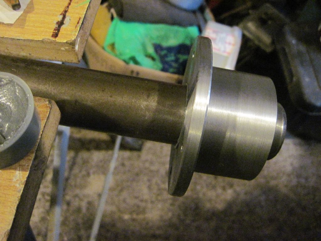

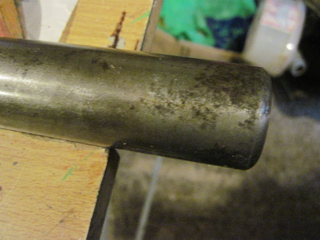

              However, lapping is certainly useful sometimes. Recently I've been making an adaptor to fit my Taig milling head to my MF (horizontal) mill overarm. I managed to find a suitable lump of mild steel and bored it to 1.5" (the overarm diameter) – a 2" deep hole. I was pretty happy with the bore dimension (as measured) but the overarm when offered up (had to remove the tailstock) would barely enter. I'd already taken several spring passes, so managed to avoid the temptation to take another cutting pass. I wanted a really nice tight sliding fit. Part of the problem was that the overarm is old and slightly corroded – although it felt reasonably smooth to the touch.
              MF Overarm
              I removed the work from the 4-Jaw and managed to 'work' the part onto the overarm – but I then had to use a puller to get it off again. I had some fine valve grinding paste (purchased from Halfords many years ago) and wiped this over the overarm and then worked the adaptor for a few minutes until it was a good sliding fit. I then cleaned both parts with Paraffin.
              Taig adaptor plate

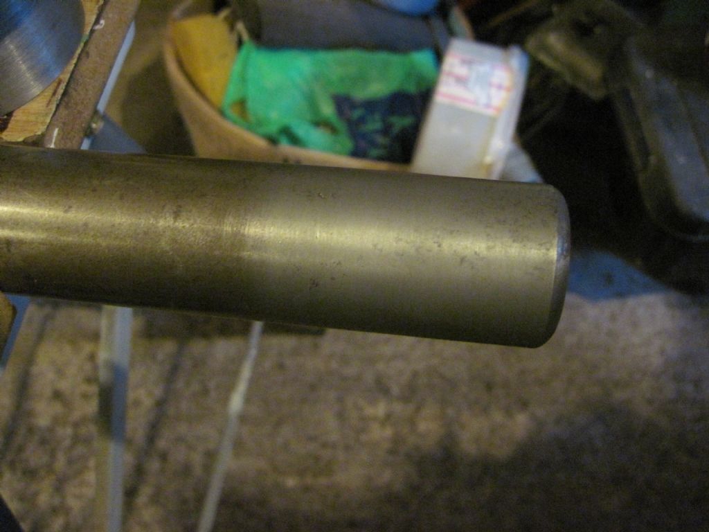

              Here is the overarm shaft after the lapping process and you can see the change in the surface – although very little metal has been removed.
              MF Overarm
              I just need to cut keyways in both parts now and hopefully I'll then be able to use the Taig (ER16) head on my MF.
