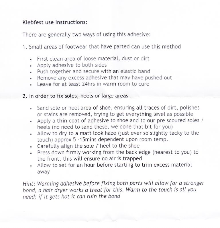

                      klebfast.jpgSimon, This works well for me.

                                    Thanks. Should a 30 ml tube be enough to stick the whole sole back on a size 12 shoe or is that a bit on the small side bearing in mind both surfaces need coating in the glue?

                                      Simon,
                                      Yes. Don't spread it too thick. Use some form of spatula, a lollipop stick will do the trick
