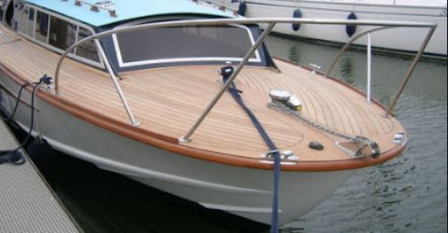

            I'm restoring a 34" model Fairey Huntsman and need to build a pulpit rail for the bow. my options are to fabricate out of 3mm stainless steel, silver solder or soft solder if possible and then highly polish or use 3mm brass, solder and then use this chrome paint, which has high opacity and would be quite successful (hopefully smiley) in giving the required finish.
            Roger

                This is what I need to make:
                devil
                Roger

                    Roger – the other material to consider is nickel silver – type of brass but silver in colour and easily soldered. Metalsmith ( link ) have it listed as nickel silver round bar in 1/8 inch at £2.70 for an 18inch length. Might save you quite a bit of hassle.
                    Never dealt with Metalsmith – they just came up with an internet search.

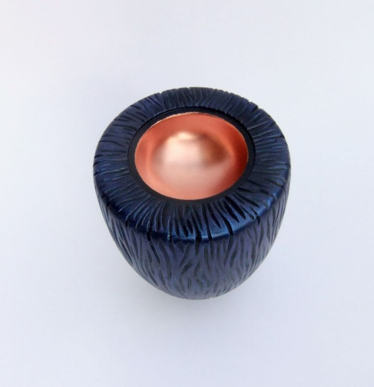

                              I have used this copper spray paint which is very good they do it in chrome as well if the chrome one is anything like the copper then it may be of use to you. The inside of this was done using it
                              Edited By Derek Lane on 21/04/2020 00:05:45

                                  Derek Lane, Nice item, Banksia Nut?
                                  Martin

                                    Roger, forget soft solder and paint. Go for stainless and silver solder, much more durable. CUP alloys are your friends.
                                    Regards Ian.

                                      Posted by Martin King 2 on 21/04/2020 07:43:34:
                                      Martin
                                      No a piece of boring "London plane" textured and painted
