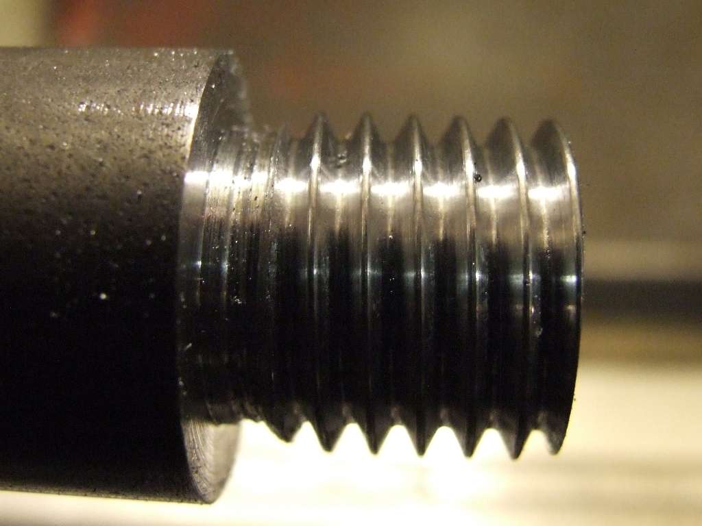

      Single-point tool on a conventional lathe.
      Task: a special Tee-bolt; a shank as close to 0.375″ as possible, and a 3/8″ X 20tpi BSF thread.
      Material: free-cutting mild steel 25mm diameter stock, though badly rusted.
      Machines & Tooling: Harrison L5. Myford ML7. Tailstock die-holder (commercially-made). Carbide insert threading tool.
      Attempt 1: On the L5 because it was a lot of swarf to make and I judged the bulk of the machine would make achieving that tight diameter easier. Outer end held on a steady, augmented by a half-centre as the diameter reduced.
      Also the tailstock die-holder would have some chance of success on this lathe. It’s almost useless on the Myford.
      Result: Accurate shank. High-quality thread…. Err, too short. I’d mis-read the drawing.
      Attempt 2: Same machine and method. High-quality thread. Correct length. Shank 0.004″ undersize and tapered! The taper might be related to the saddle now being on a more worn part of the bed as the stock bar becomes used up.
      Attempt 3: The bar was now rather short. Roughed down to about 5/8″ dia on the L5, took a finishing cut that proved the taper. Reversed it in the chuck to turned a short clean area on that end. Transferred it to the ML7, holding it by the cleaned part in a 4-jaw SC chuck. The shank length was not concentric but I had expected that. Centre-drilled for tailstock support.
      Result so far: Shank within 0.001″ on diameter, and a beautiful finish (HSS tool).
      Cut to about half-depth with the parting-tool to delineate the head for milling the flats, to avoid removing the work from the chuck, then set up for the thread….
      Back-gear, no more than 0.005″ depth of cut, eased down to the witness extension on the outer end. Tried it with an ordinary 3/8″ BSF nut: too tight. Took any number of spring-cuts. No better.
      Eventually finished the thread with a die. Those taper-shank die-holders are hopeless. Their tanged MT2 shanks do not grip in the tailstock properly on a small lathe like an ML7, and their use is always a gamble for anything more than about 1/4″ diameter.  As now. It gleefully removed so much metal the nut almost shakes down the thread, which has a central patch with almost no thread at all. Although the work is still in the chuck but now on the mill for cutting the flats I am considering having to spend more steel and electricity on Attempt 4.
      (The others won’t be wasted but kept as general-purpose Tee-bolts.)
      I have had this previously with these thread-cutting tools. They cut beautifully to about two-thirds depth then it becomes impossible to finish screw-cutting to a proper standard that fits the nut well, no matter how much care you take.
      Though I am not sure I’d be any better with an HSS tool, despite having a T&C Grinder so can shape it properly.
      Since I wish soon to cut two 1/2″ X 20 tpi UNF threads some 3″ long, for feed-screws, and possibly in stainless-steel, this does not bode well.
      Or is there something I am missing? Or we are not told?

        “I have had this previously with these thread-cutting tools.”
        Can you enlighten us as to what “these” are
        What profile was your threading tool, sounds like you are not allowing for a correct root and crest radius. A HSS tool ground to a simple Vee or  apartial form insert will not cut deep enough if only fed in to your witness dia assuming it was the core dia of the thread.

          As Jason says is your tool ground partial profile if so greater depth required and do you screwcut with the set over method or just plunge in?

            A side issue might be the lathes. The L5 could be well worn from its previous life so Vee ways not working, and the ML7 is notorious for saddle guidance problems. In either case engaging the nuts results in a less than adequate guidance to the saddle, and hence problems.
            An easy test is to chuck a piece of 1″ or so mild steel with about 2.1/2″ exposed. Cut two grooves at least 1/8″ deep in the end, one about 3/4″ in and the other 1.3/4″ in. Fit a suitable Vee tool that will cut equally well to the left and the right. Now you need to cut two surfacing areas on the bar. Put the tip of the tool in the end groove, put on a cut of at least 0.080″ so to make the lathe work. Lock the cross slide. Arrange for power feed to cut to the left and at a suitably fine feed rate, at a suitable speed. Make the cut from the first to the second groove. Quickly move the saddle by hand from the second groove back to the first groove. Reset the lathe to power feed to the right. Make the second cut from the first groove to the end of the bar.
            What you have done is made the lathe cut both to the left and the right at exactly the same cut depth, hence the locking of the cross slide. Therefore both the machined areas should be exactly the same diameter. Measure them and be very upset.
            In both cases the power feed will twist the saddle on the bed, moving the tool in or out of the cut. On the L5 the saddle is rocking on the worn part at the front left of the saddle, on the ML7 the saddle guidance touching the bed has space.
            You need the two diameters to be within a few tenths for the lathe to be usable.

              You should make the OD five thou less than .375″ for clearance. Makes life a lot easier without weakening the thread one jot.
              You rarely get a good fit at the theoretical thread depth, regardless of what formula or chart you use. (And never use tapping drill size to determine thread depth.)  Most often it is a matter of a series of light cuts and “try and fit” to finish off with. If you keep the topslide in the parallel to lathe axis position, you can carefully take a one or two thou skim first along one thread flank and then the other to create a bit of clearance and a good finish without increasing thread depth. And always run the corner of a large flat file along the thread groove to clean the burr of the tops of the flanks before trying your nut for fit.
              The best tailstock die holders for that size range are the ones than have a handle sticking out for you to hold and take the torque with. The holder is a sliding fit on a parallel spindle sticking out from the taper that fits in the tailstock. No load transferred to the tailstock or the flimsy little key that holds the barrel in line.
              For any threads under half inch diameter, you might as well just cut it with a die in such a holder. No point in screwcutting anything that small really, other than as an exercise. Making a mandrel crank handle makes it all sooooo much easier than wrestling with the chuck key etc in the traditional manner. And remember to back off ever half to one turn to break the chips up. Trefolex etc on the dies helps too.

                              Thank you all for all these suggestions. I have examined them and what I was doing.

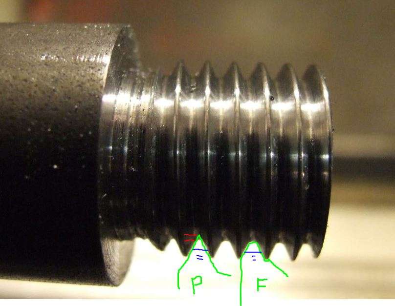

                              The insert is the sort with three sizeable triangular tips, so when cutting a fairly small thread these penetrate the work only partially (just over 0.03″ for 3/8″ BSF). This type will therefore leave a sharp crest. So would a plain Vee-tool unless ground specifically for the thread.
                              I find the thread depth from the Zeus book, and make a small root-diameter extension as a guide as well as using the dial.
                              Usually I do cut the thread to near-depth than finish it with a die, but even with the die open in the holder, this time it still spoilt the thread.
                              My die-holder is the type with the through-hole for a handle. Normally I use a rod bearing on a safe area of the lathe.
                              Its tanged arbor does not hold very tightly in the Myford’s tailstock so the action of the die pulls it out. I don’t know if the tang stops it going back just that tiny bit more. Other tools usually hold properly. It grips on the Harrison lathe, yet neither lathe has a tang-slotted tailstock barrel.
                              The Harrison’s bed is worn at the head end, with a definite step onto the gap-filler. My first attempt gave much more accurate diameters, because to save material I used a fairly long piece supported in the fixed steady, putting the saddle a long way down the bed.
                              Perhaps I should not to try to turn the full length, but finish the thread section then the shank section separately, so controlling the depth over a much shorter length. It won’t remove the taper completely but will reduce its effect.

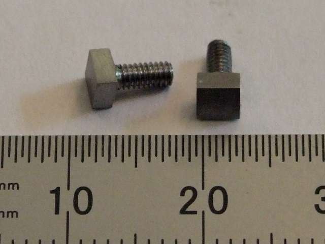

                              The saga continued, concluding in finding an enormous amount of play in the Myford lathe.
                              I took the embryo bolt still in the 4-jaw SC chuck to the milling-machine and screwed it onto the dividing head with the tip of the bolt supported by the matching tailstock, to mill the two pairs of flats. At the point needing 0.04″ total removing, 0.02 a side, I raised the knee 0.015″. The result measured not 0.03″ gone, but well over 0.03″ still to clear!
                              I was holding the cutter in an R8 collet. It seemed fully tight but I gave the drawbar an extra tweak.
                              The next cut worked, taking it down to 0.503″ wide. I wanted to finish at ~ 0.495″. Raised the knee 0.002″, skimmed the two flats, measured…. 0.474″ .  That’s rubbish!
                              Thoroughly dispirited: this was the second time that had happened. I cut the two steps (the stepped profile is not strictly necessary on a one-piece Tee-bolt, but never mind), took the chuck and work back to the lathe to part off the bolt.
                              I had not cut the preliminary groove deeply enough, so the two flats gave the 3/32″ wide, HSS parting-tool a sizeable interrupted-cut. Despite the small size and using very low speed, this lifted the saddle and the work visibly on each bump, until the parting-tool had gone below the flats. Then it started playing up again, and I had to saw the last bit.
                              The flats were too tight. I had to ease them with a file.
                              This Tee-bolt finished the correct length with a beautifully smooth shank within 0.001″ of size… but a very poor thread, rough, inaccurate and slightly unsymmetrical flats that produced ugly scars on the shank, and still tight in the Myford Tee-slots it is supposed to fit.
                              I had to stop there anyway as I was out for the afternoon, but I locked up the workshop knowing after over 50 years in model-engineering I cannot even make a simple Tee-bolt to Loan Section quality looks and function; let alone competition “Commended” level.

                                    It is what I said you are using partial form insert so need to go in deeper than the core dia of the thread that is given in tables. It is the flanks of the threads that need to be right hence why they are often measured by wires which don’t touch the root or crest.
                                    Taking Andrews Photo from above on the right I have drawn in green how a full form insert will correctly cut the thread going in as far as the core dia. On the left I have sketched a partial form insert with it’s more pointed end but that could also be an HSS tool. In red I have shown how much deeper it needs to go to achieve the same “depth” of cut to give equal flank depth in blue.
                                    The partial form insert will also not round the crest so you will either need to do that with a file against the rotating work or reduce the OD as hopper says

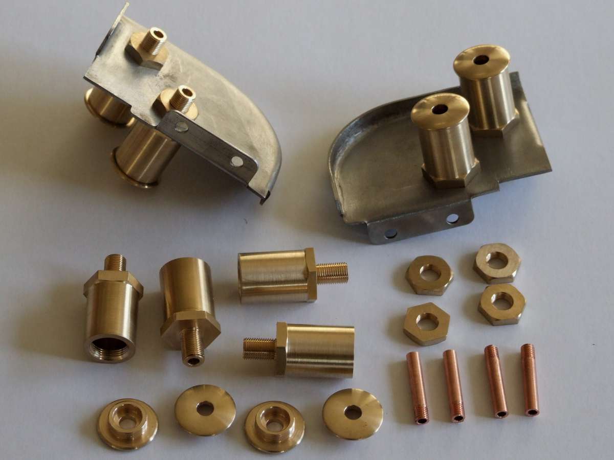

                                      One reason I use full form inserts when screwcutting is that the insert forms the crest, so one gets a nice looking thread. There would be no point starting undersize when screwcutting. Another, unrelated reason for screwcutting is the ability to thread to a shoulder, external or internal. The old school pictures of boiler fittings showed the internal threads on gland nuts going all the way to the end; how are you supposed to do that with a standard tap? Screwcutting means I can get within one thread pitch. Screwcutting also helps on short threads:
                                      2020_11260003
                                      The external threads on the oiler caps (bottom left) are only 1/8″ long. They would be difficult to cut with a die. The threads on the bottom of the bodies were also screwcut.
                                      The work by Tubalcain on thread strength was primarily aimed at determining tapping hole sizes, not reducing the OD of external threads. Although, to be fair, he does mention that reducing the OD of an external thread by a few thou may help. Not surprisingly I am an outlier on tapping sizes too. I use tapping drills that are larger than most people on here use. For instance I normally use 5.3mm for M6, or 5.4mm in tough stuff like stainless steel.

                                          Nothing wrong with the die I used. It was not some ‘flea-Bray’ cheapie but a little-used one from a reputable supplier. It was my using it that failed, and I don’t know why.
                                          I was also using very good, free-cutting mild-steel.
                                          Jason –
                                          That is what I was effectively doing: cutting the thread deeper than the nominal to compensate for the sharp tool point. I could see it grooving the witness stub on the end, at nominal root diameter.
                                          The test nut would screw on for a couple of turns then jam. Yet this bolt’s brother, differing only in length, had worked, perhaps because I had not tried to screw-cut the thread.
                                          Hopeless because I need also make two threads some 3″ long and this rate I can see the only way is to use studding and modify the rest of the design to suit!
                                          I could measure the flats in progress only with the work in place, so carefully brushed all the swarf off and moved the table clear to allow full access for the micrometer. I also measured the thing several times after I’d finished it, but whatever was happening doesn’t make sense.
                                          It’s possible the cutter was slipping in the collet, I suppose, but there was not enough room for the Autolock collet next to a dividing-head.
                                          Or something was springing, maybe.
                                          I just don’t know.
                                          I’m afraid you mis-read me.
                                          The nominal A/F size is 0.5″, to fit Tee-slots milled in the factory – when that was in Beeston, too.
                                          So I wanted the head close to 0.495″ A/F – as on ones that worked.
                                          Instead, despite all care to measure the head as I went, this specimen, and a previous one, came out at 0.475.
                                          Yet I’d only raised the work by two thou to take that last stage down to that very gently. How does 0.002 suddenly become 0.01″ ?

                                                    20240319_162631

                                                    Nigel Graham 2
                                                      @nigelgraham2
                                                      I am following a drawing that calls for 1/2″ – no decimals – so didn’t think to question it. The two T-bolts (different lengths) are to fit the ML7 saddle, and I found slight width variations on the upper part of the slots on mine. The bolt enters one but is tight on another.
                                                      The tightness on the bolt was on the steps I’d given it – since I am making two things in parallel, I looked at the salient dimensions for the essentially similar components but failed to spot the ones to fit the Myford are plain head type. That would not matter if the thing had actually fitted – it didn’t because I could not make it well enough!
                                                      I did not want the head too narrow because that reduces what little contact area they have anyway.
                                                      What was really upsetting was being unable to achieve the result I wanted, and trying to make just T-bolt had become a nightmare of my mistakes, worn machine-tools and things just going wrong for no clear reason.
                                                      I finally succeeded this evening.
                                                      I had only just enough steel of that bar left so had to fit the spindle back-stop to help hold the material in place, and support the end from the tailstock. Unable to rely on turning the full 2″ length of 3/8″ parallel I roughed it down to under half-inch then took the thread section alone down to 0.371″ diameter.
                                                      Using the parting-tool I cut a run-out groove of .032″ deep from that so in theory probably enough to accommodate the non-truncated screw-cutting tool. It proved about right.
                                                      This was where I solved –
                                                       Problem 1 – the loose-fitting arbor on the tailstock-die holder. It had spun in the tailstock at some time, gouging it just enough to prevent full engagement. I cleaned it with a small file and and that was sorted. However I was not going to use it with such a delicate set-up…
                                                      and….
                                                      My mistake 1. It does help to use the holder with the Whitworth-form insert, not the 60º one as I found I’d done. No wonder the BSF die had munched through so much metal. It was trying to trim a UNF thread!
                                                      Then My mistake 2: I thought the developing thread looked a bit fine for 3/8″ X 20 BSF. I’d not set the gearbox back from the fine feed, and was now cutting a 28tpi thread. Fortunately the cut was still shallow and the error disappeared eventually.
                                                      Tickling the thread down and lightly running a smooth file over the crest eventually produced something for the nut to run on almost as it’s meant to! I have no idea how many passes and tests this process took but the tool seemed to find steel to remove every time.
                                                      Now turned the shank, which will eventually fit a reamed hole. We can but hope.
                                                      Experimenting while still well above finished size I found an insert tool that gave a slightly better surface than the HSS one doing most of the work, though itself giving a very good finish. Very gently, without letting the tool rub, I crept up on that 0.375″ figure, using the self-acting feed on its lowest rate.
                                                      It is too! Well, in the centre of the 1.25″ length it is.
                                                      The wretched thing is still tapered by 1 to 2 thou over just that length!
                                                      So Problem 2 – Why can’t I turn an accurate parallel?
                                                      I’ll just have to live with it. I turned the material round, reduced the head to thickness then cut the flats. I think I found the source of –
                                                      Problem 3 – weird widths. Cutting the wider flange for the stepped head seemed to have left narrow ridges, and I was probably measuring either on those or the lower surfaces without realising it.
                                                      This time I used a slightly different technique and anyway was milling a much narrower flange, and this time did indeed reach that nominal half-inch less five thou.
                                                      So after 4 attempts I now have a Tee-bolt that is to drawing and close enough to work as it’s intended – but would fail any proper QC inspection.
