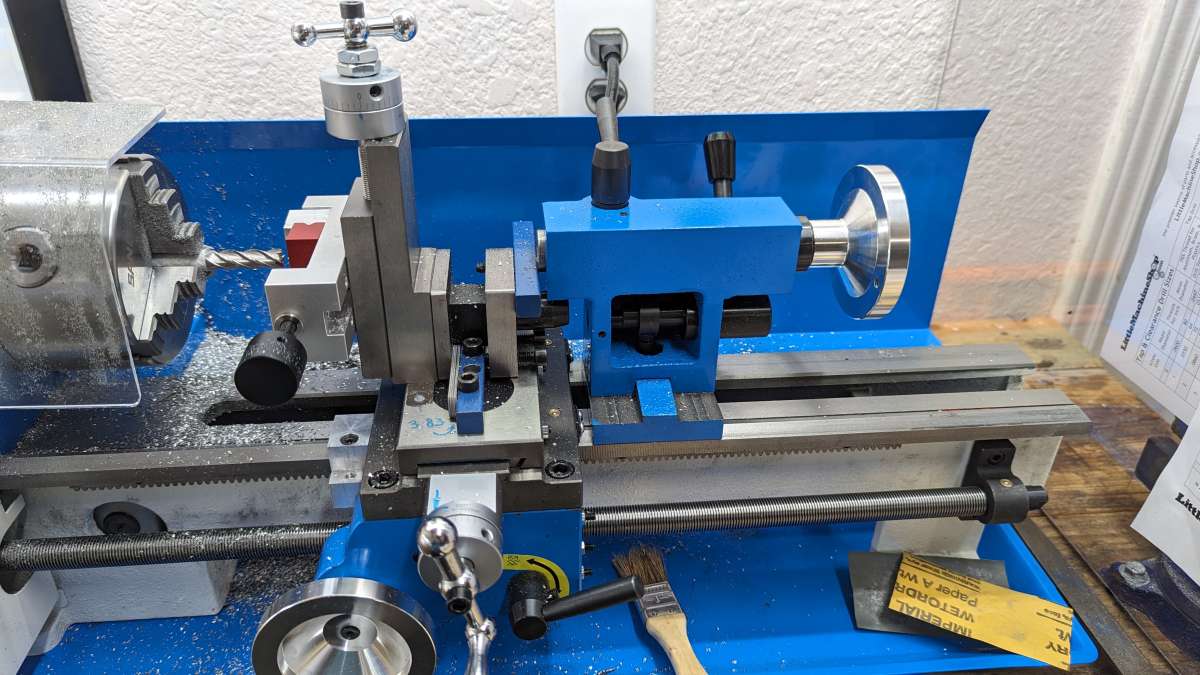

            Like many, I only have a mini lathe, but would like to expand my capabilities into milling. There are numerous ways to do this, but I stumbled upon a $0 solution that should work for many mini lathes (I own a Vevor 7 X 14).
            It’s easy to implement and, maybe a little surprisingly, quite rigid. It will cost you nothing (vice optional) if you follow my plan, and the results are, frankly, quite good.
            I used the lathes compound slide and tool post as my vertical milling attachment. Here’s a picture of the setup. (Hopefully will have details on my blog soon.)
            PXL_20240425_214234871
            #727908
            John Haine
              @johnhaine32865
              A neat adaptation Matt.  Same principle as the Hobbymat lathe which came with an aluminium angle plate to mount the topslide on for milling, and a small machine vice.  Hobbymat version let down by the very poor quality of the vice and the available milling area was very limited.  I assume you use the tailstock feed to set the depth of cut?

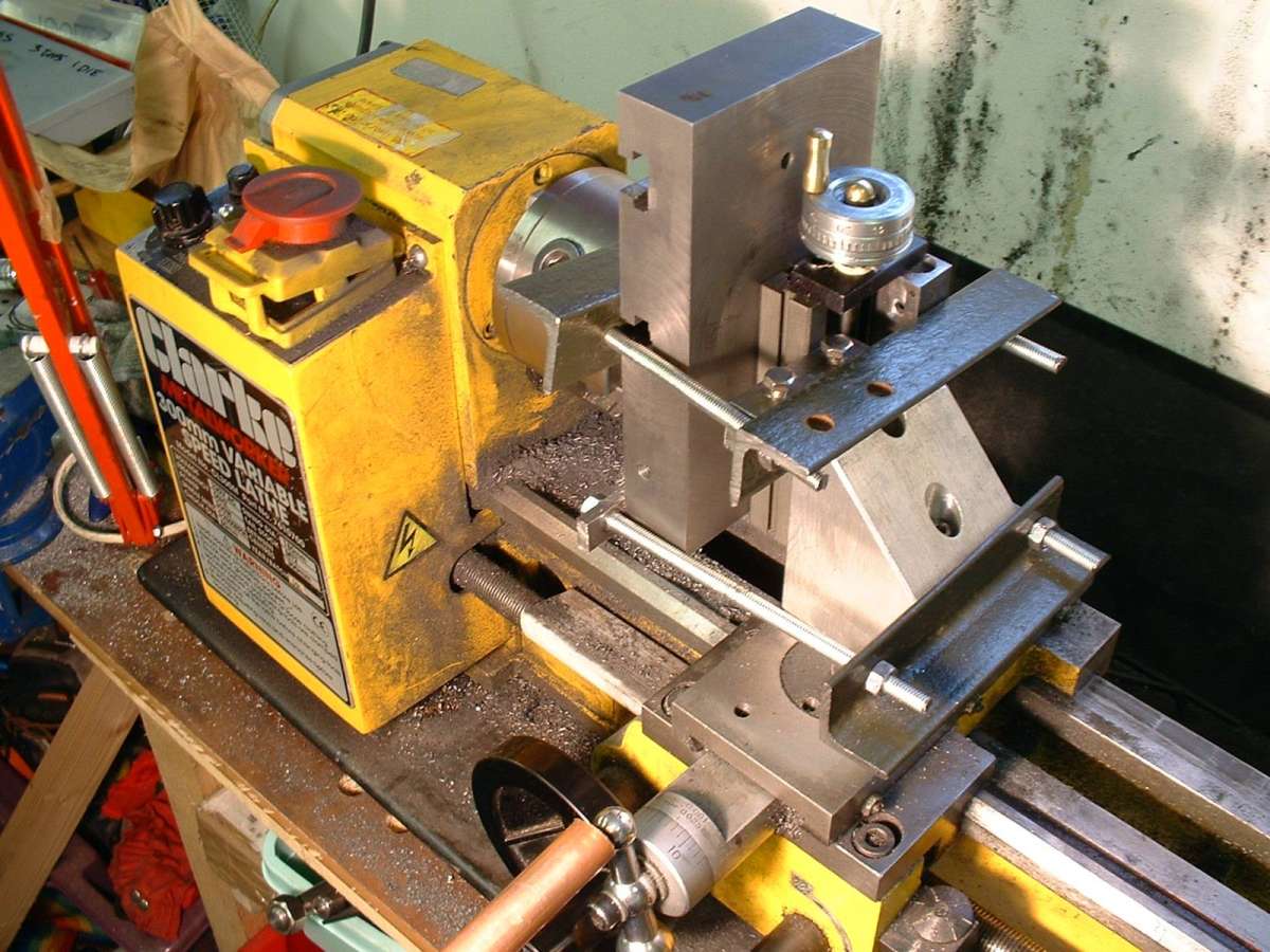

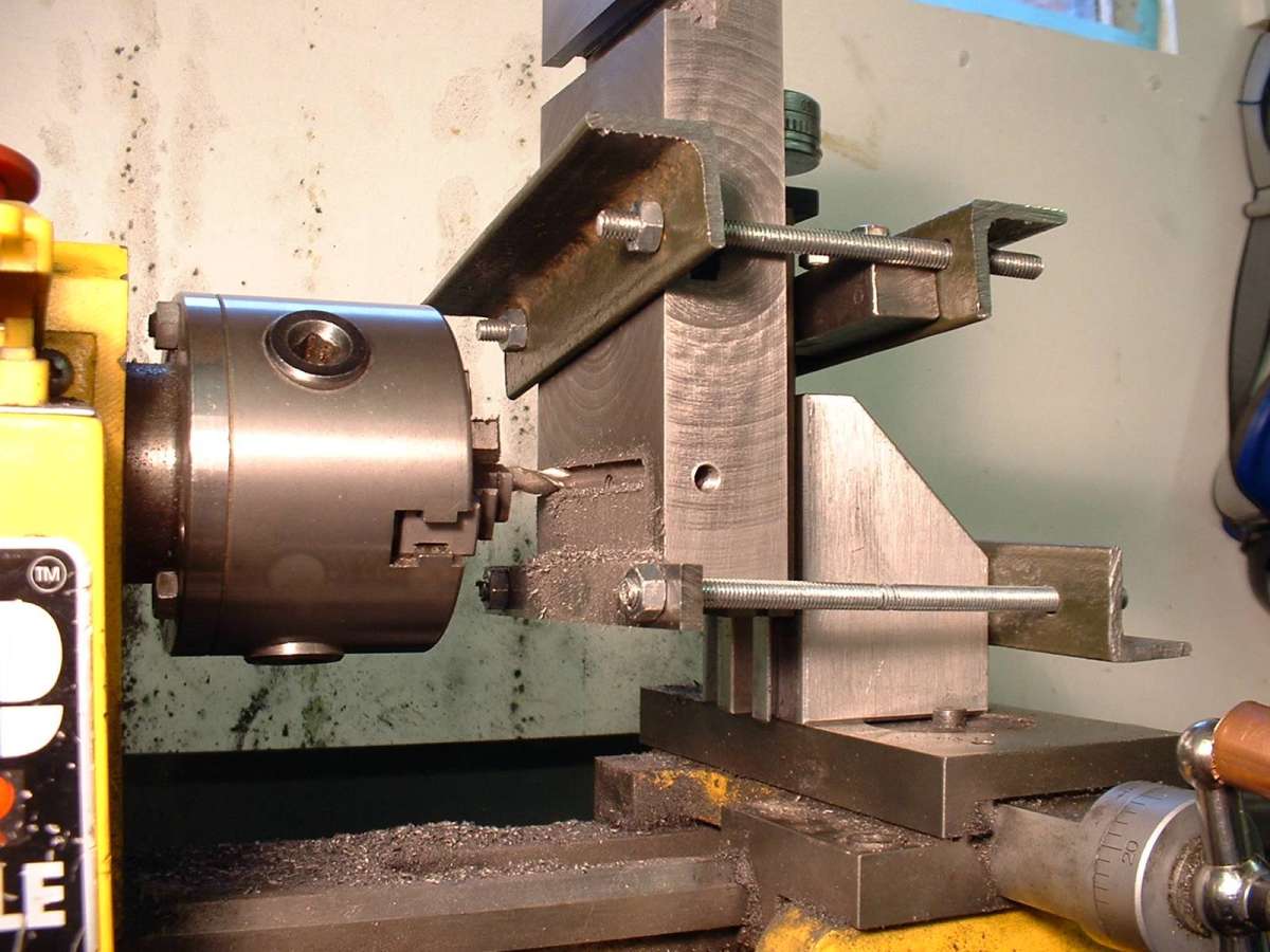

                Until about 20-25 years ago, the great majority of home workshops lacked a mill and milling in the lathe was a recurrent topic in the pages of ME and MEW. Also, the controversial subject of using a pillar drill as a ‘light milling machine’.
                The main issues constraint is work holding and capacity, issues of rigidity are easily addressed just by taking things gently.
                starting a tslot
                Despite the heath robinson appearance theis clamping arrangement was successful

                Matt Schneider
                  @purpleslurplegmail-com
                  Thanks John. I wasn’t aware of the Hobbymat kit, although have seen the Hobbymat spoken of. I’ll have to check it out. I am in fact using the tailstock to set depth. I also push the tailstock housing up against the tool post and lock it down to add rigidity (spindle retracted of course). Really tightens things up. But as Neil and others suggest, always easy does it 🙂 The creativity of hobby folks never ceases to amaze me: work holding, cobbled together (perfectly functioning) solutions, etc. Glad I’ve joined the community. This is a nice welcome.
