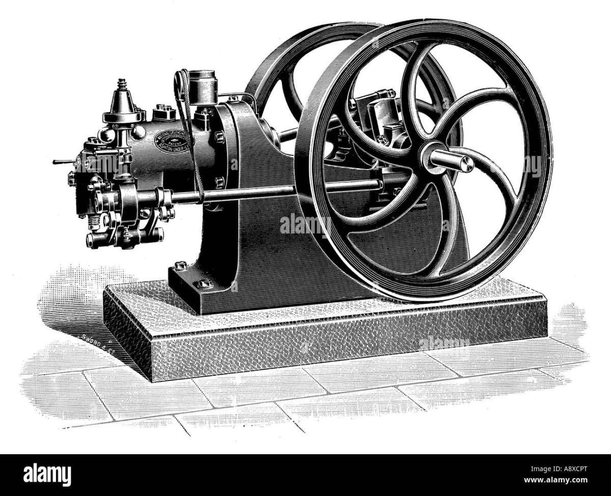

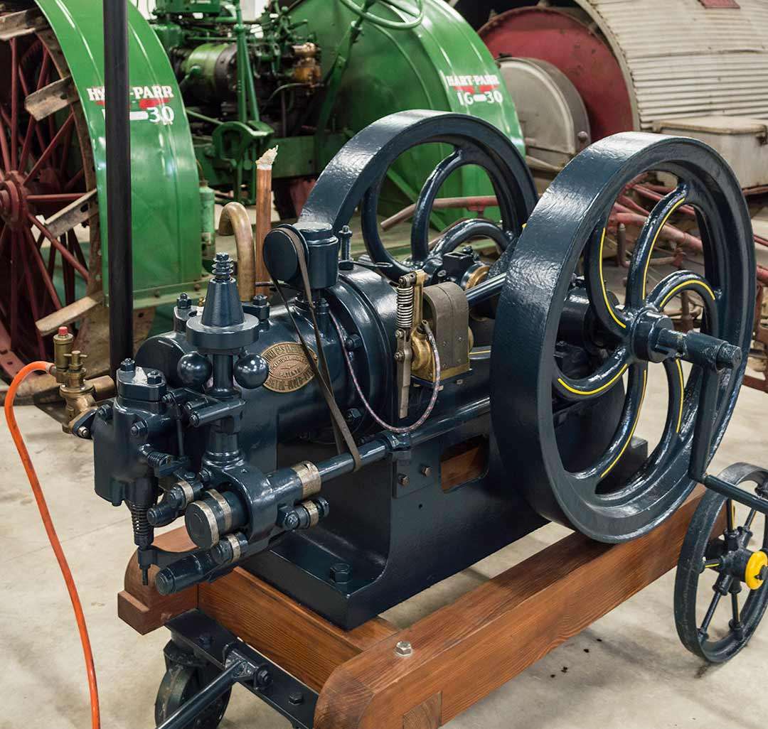

          #726927
            This is based on the earlier engines which were not that big, something like this one in a Spanish Museum
            MOTOR-NATIONAL-GAS-ENGINE-Co_00
            national-gas-burning-engine-A8XCPT
