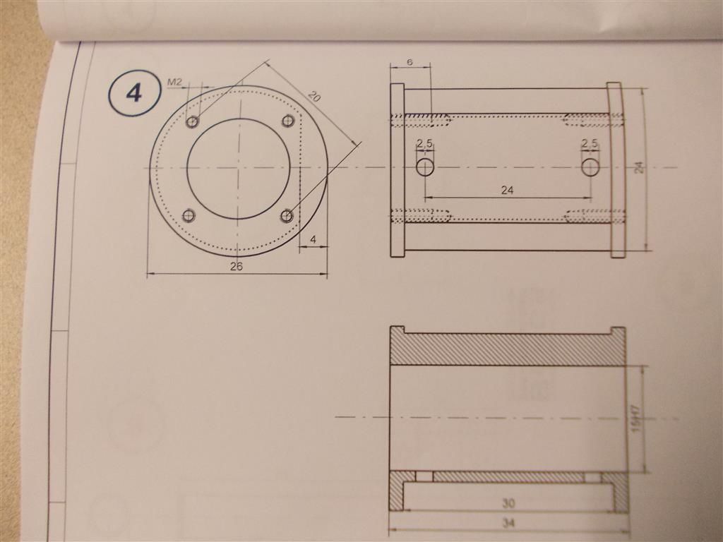

      I thought Beng's Danni steam engine would be a simple build but there are a few tricky parts to make. I do not have a milling machine so how can I slice off 4mm from the side of the cylinder ? I did something similar with the cylinder head of the flame eater engine but that was only 12mm thick so I held it on its side in the tool post and sliced it with a slitting saw. But that method will not work here.

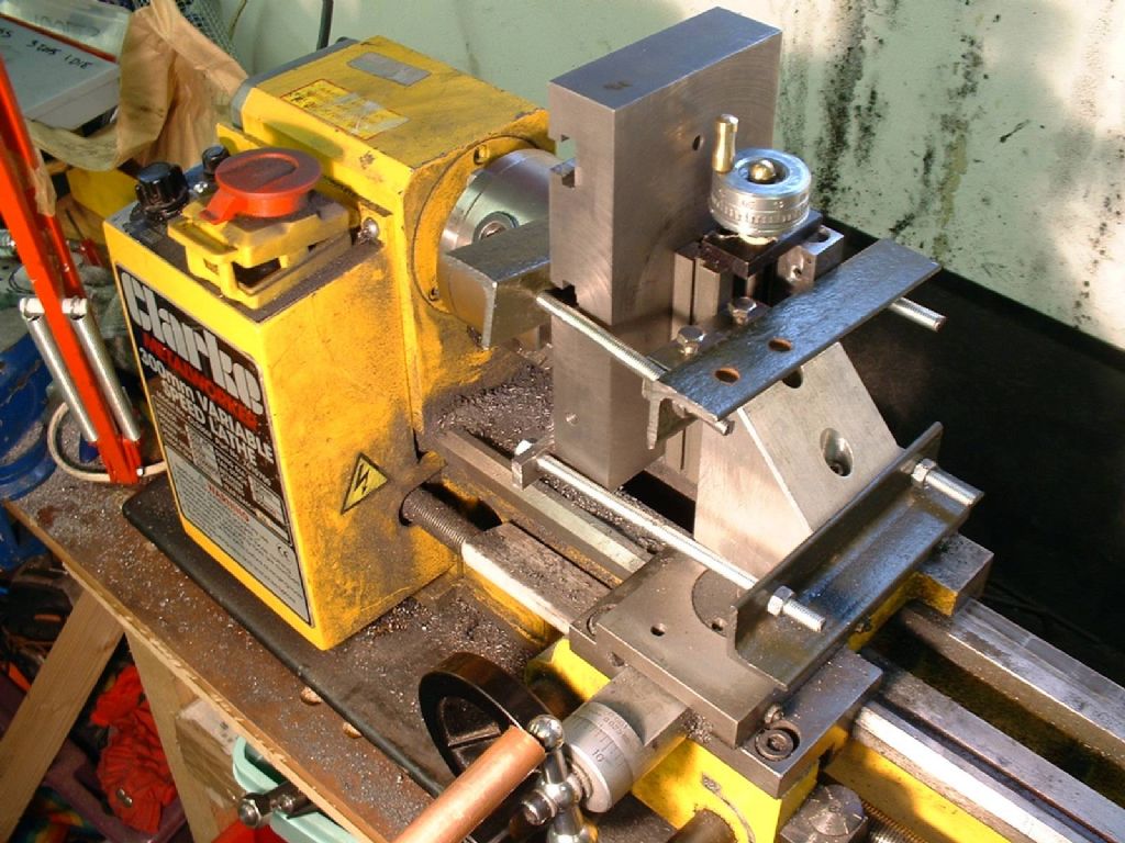

          You need a vertical slide.
          Make a filing rest, with two rollers either side of the cylinder to support the file and you will be able to quickly file a very flat surface. Naturally you will need care with the final finishing.
          This example is probably over-complex for what you want to do, but it shows the principle. The work is held on a mandrel in the lathe.
          http://www.hemingwaykits.com/acatalog/Precision_Filing_Rest.html

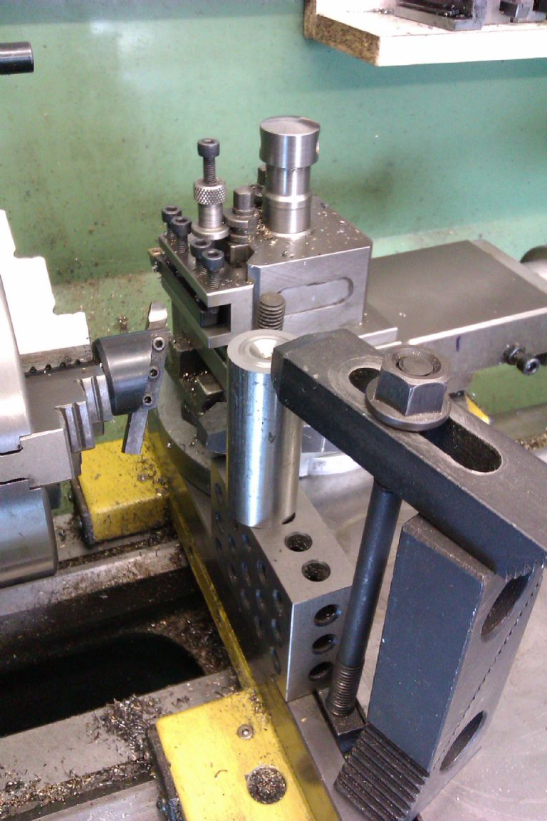

                    Flycutter in the chuck and cylinder mounted vertically on the cross slide. If the cylinder is also mounted centrally to the lathes centre height and the flycutter set to swing a 30mm radius you won't even have the bits in the corner to file off.

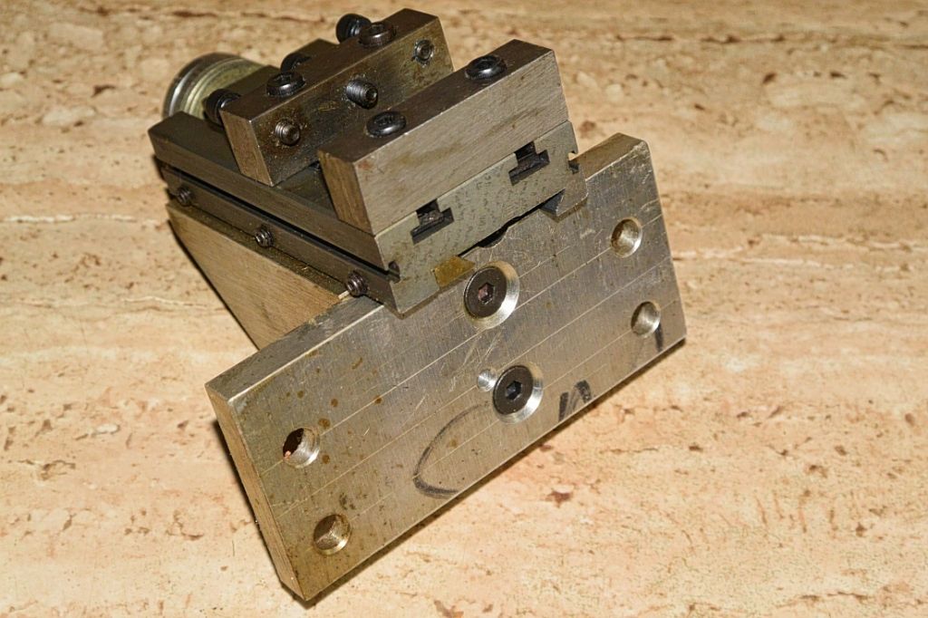

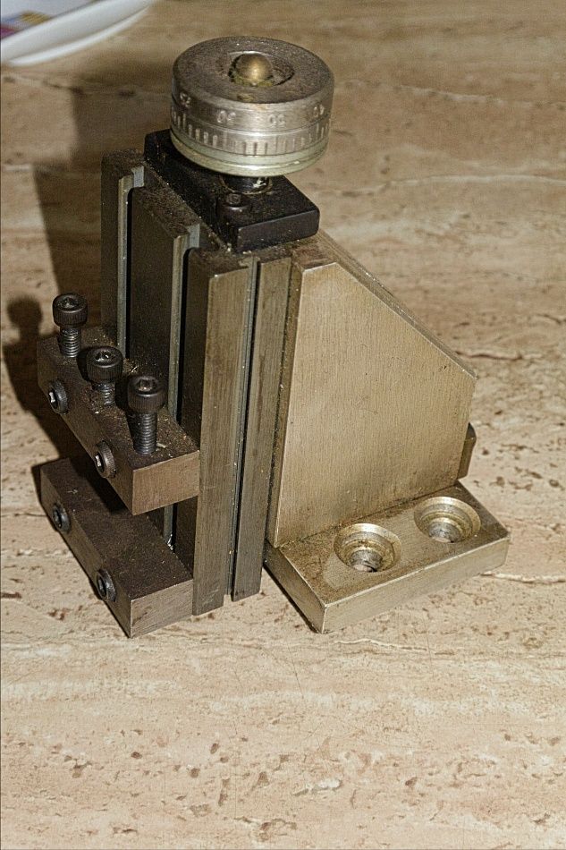

                            This is mine – didn't sell it with the lathe as they can be useful.
                            and this is how I mounted the plate on the bottom
                            I just tapped it's fixing holes but it would be easier to simply fix from the top as it's usually mounted. For a Taig there is a slide down brass plate at the rear so that engages with the slide to make it square to the axis of the lathe.
                            You have a T Slot that attaches the compound slide so could mount it on a plate and hold it in place with that – 2 T nuts. I've taken the shot with the table right down so that it projects past the base – it's important to allow that to happen otherwise height is lost.
                            If you do it there will be a need to do some sums to get the max possible travel and that may set how thick the mounting plate needs to be. You may find that it needs to be offset from the T slot to the centre of the lathe so the fixings into it are always in sight or they might turn out to have to be under it. No problem just means fitting 2 parts when needed. I don't think it would take long at all to make the parts needed. I don't think that adaptation actually took me an hour to do
                            The vice on them looks crap but actually works rather well. It holds things tight and it's easy to make custom jaws in it.
                            Pass on using these on a mini lathe which might be your next step but I think Neil may have given one of these some serious abuse on one without problem. Some one or the other has anyway.
                            Fact is a lot more things can be done on a lathe that has a vertical slide, more than people might think.

                              Brian, this would be the sort of setup with the cylinder vertical.
                              The curved face is quite easy to do with a simple home made between ctrs boring bar

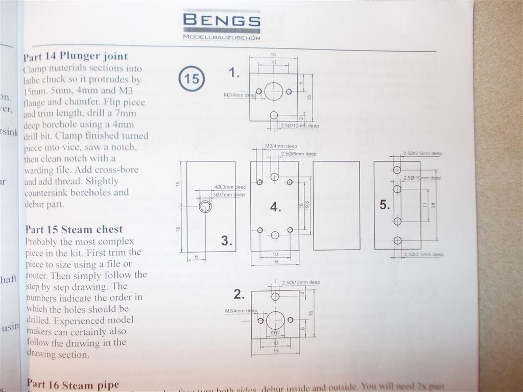

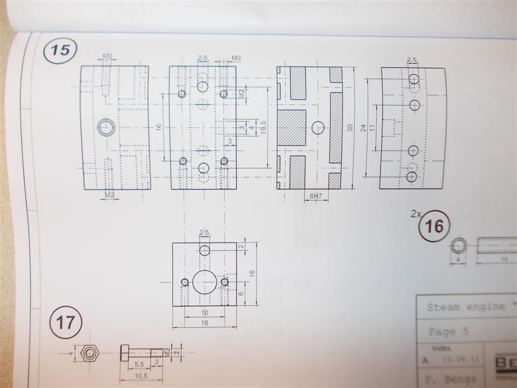

                                First thing is to either buy the Taig vertical slide or make some sort of clamp to fit to my lathe. Nothing can be done until then. I think it might be easier to stick with the instructions and machine a flat surface on the cylinder. Cutting a curve on the steam chest is all very well in theory but it might raise some unexpected problems with respect to the ports and threaded holes.
                                Below are two drawings of the steam chest. Forgive my ignorance but why are there 4 holes on side 5 ? I thought this was the side attached to the cylinder and that only has 2 holes to be drilled in it.
                                Edited By Brian John on 03/09/2016 10:43:28
                                Edited By Brian John on 03/09/2016 10:50:42
                                Edited By Brian John on 03/09/2016 10:53:17
                                #253832
                                  The two inner holes are actually blocked off when it is soldered to the cylinder. in the same way that the two holes drilled in from the ends are.
                                  This is a fairly common way to get the steam passages into a solid block of metal rather than them being cast in on a casting. If you look at the section on teh second scan and imaginge these holes closed you will see the steam flows in a "S" direction
                                  Edited By JasonB on 03/09/2016 13:49:41

                                          smile p I like the handle extension on the cross slide Neil. Must have been hard work milling the slots or devil maybe you have soft hands or a blunt cutter.
                                          It looks like it fits on a mini lathe fairly well.
                                          Glad you posted that because Brian's repertoire could be extended a fair way with a vertical slide and Opti might do a small light weight miller with a fault. Might make for another long thread though. Plus of coarse millers tend to need to more weight than small lathes due to rigidity problems.

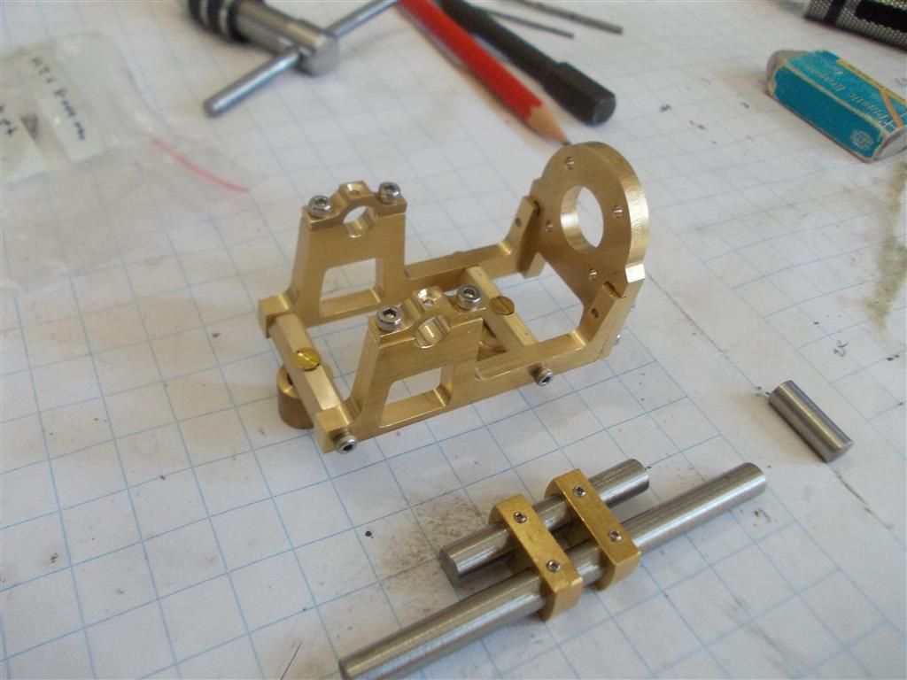

                                                      In the mean time I have completed all the drilling and tapping for the frame and supports. I am using socket head bolts rather than the supplied hex head bolts as they are much easier to work with. I have also substituted hex bar for the supplied square section bar for the two cross supports as the hex bar is much easier to tap and drill on the ends. The square bar would have required a jig for that. I am surprised that they have not used bearings in the crank supports.
                                                      I am still having problems with the crank : I should have drilled them together as they are not parallel with each other. I will have to order another set of crank plates and give it another go.
                                                      Edited By Brian John on 07/09/2016 08:30:04
                                                      Edited By Brian John on 07/09/2016 08:34:37
