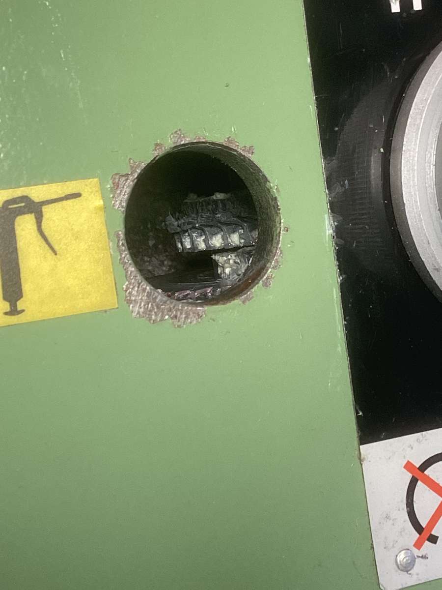

      The teeth on the plastic gear that engages when low gear is selected on my Warco WM18 mill have deformed (like in the middle picture of post number 30) in response to an attempt to cut through some mild steel plate with a 22mm Rotabroach annular cutter.
      Can anyone give me some tips on how to go about accessing and disassembling the gearbox to replace the damaged gear? The parts diagram with the mill doesn’t really give much help in this respect.

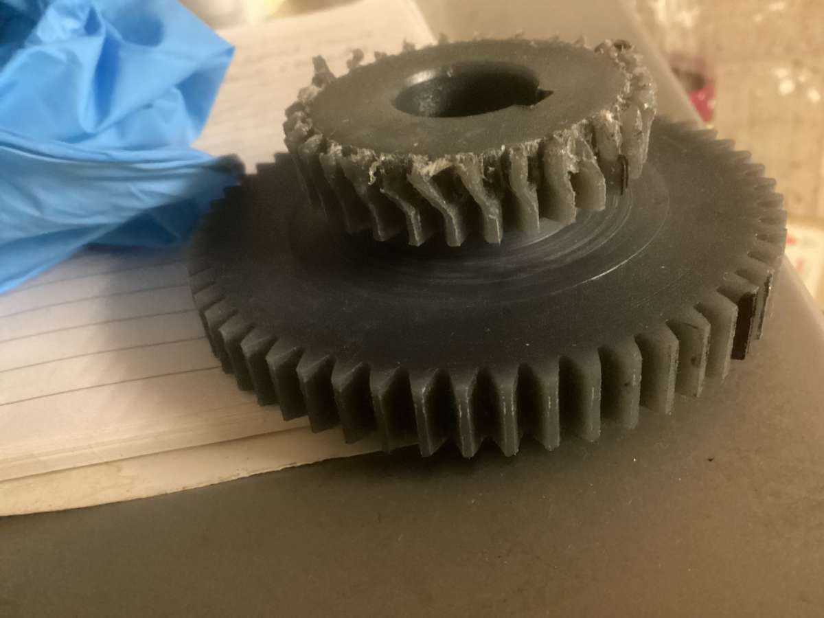

                      Edited to add photo of my gear:
                      deformed Warco gear

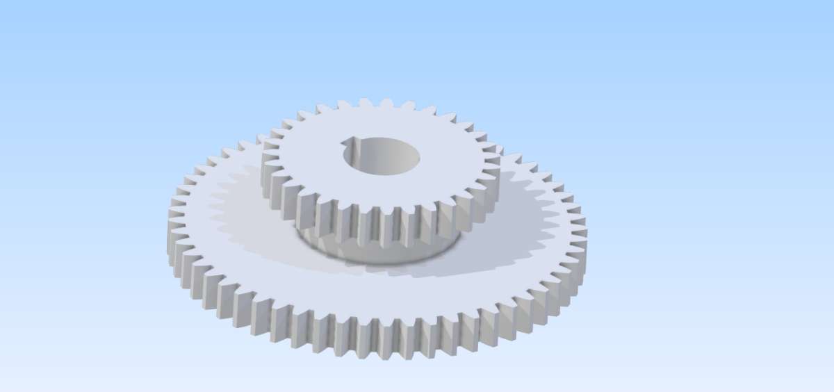

                                        Once sizes are known I expect a member may offer to draw it for you. One of the reinforced plastics may be a good halfway house between metal and just plastic.
                                        gear 2

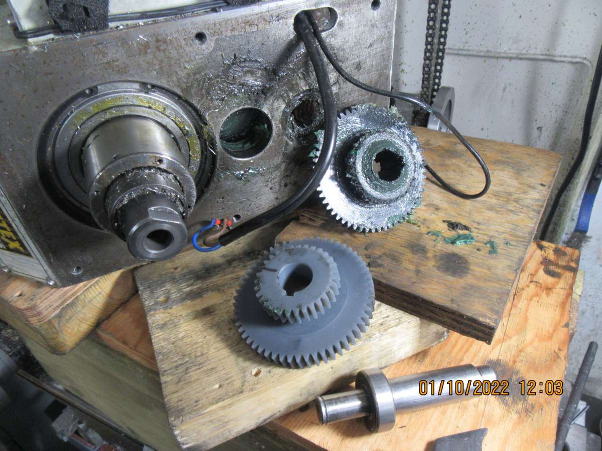

                                            Is it me or on the 2nd U tube link posted by Pete Greene from 6.00 on, where the guy actually tests the shift, does the meshing gear that you can barely see, have a touch of vertical float?
                                            Interesting how they all (so seen) seem to fail on half engagement.
                                            Might be worth checking the gear select detent is working as it should. If it’s OK then consider that the plastic gear is unsuitable for the load applied and it’s deforming under that load. I have an unused 30mm Rotabroach with about a 4mm width of cut. I would have thought that was a huge load on a gear train.

                                                      To update, pictured below is the damaged gear.
                                                      The dimensions are as follows:
                                                      Complete gear – 28.65mm thick;
                                                      Big cog – 56 teeth, 88mm diameter, 11.3mm thick;
                                                      Small cog – 31 teeth, 50mm diameter, 11.3mm thick;
                                                      Bore – 20mm diameter; bore’s keyway – 6mm wide, 3mm deep;
                                                      Connecting/separating “shaft” – 33.4mm diameter, 6.45mm wide.
