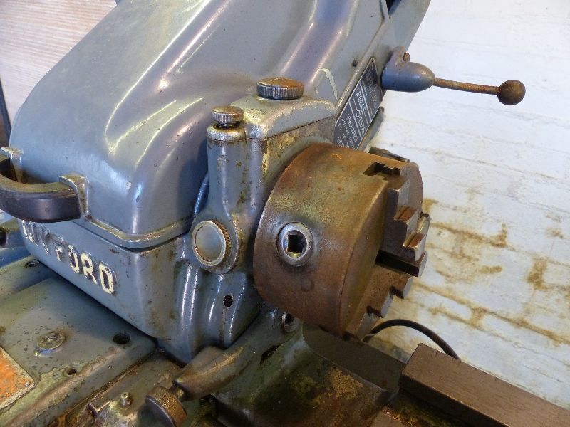

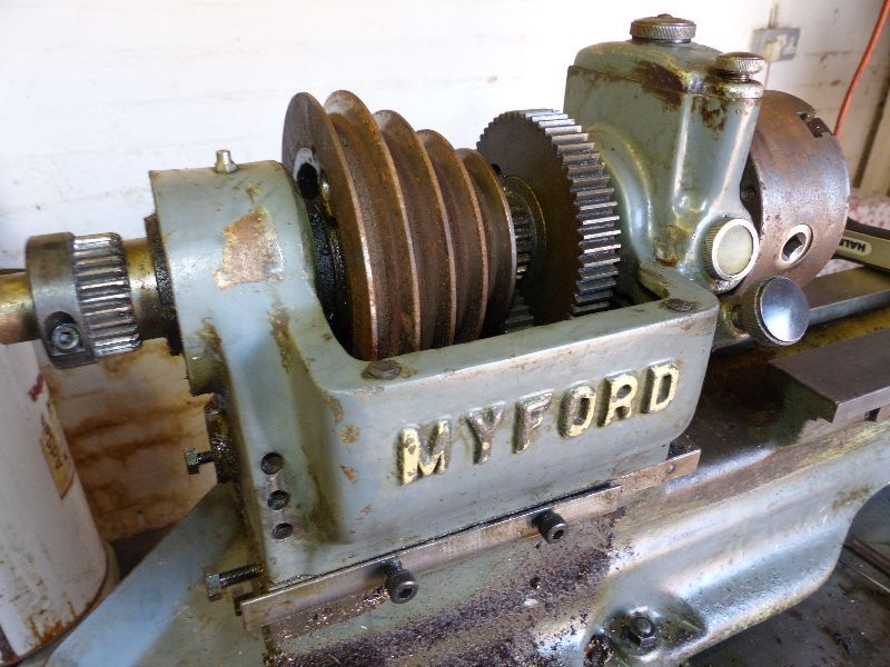

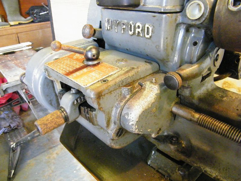

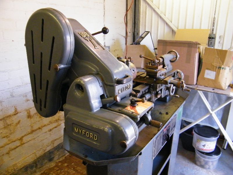

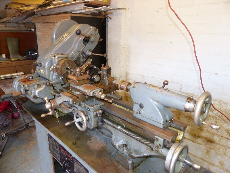

      Some pics :-

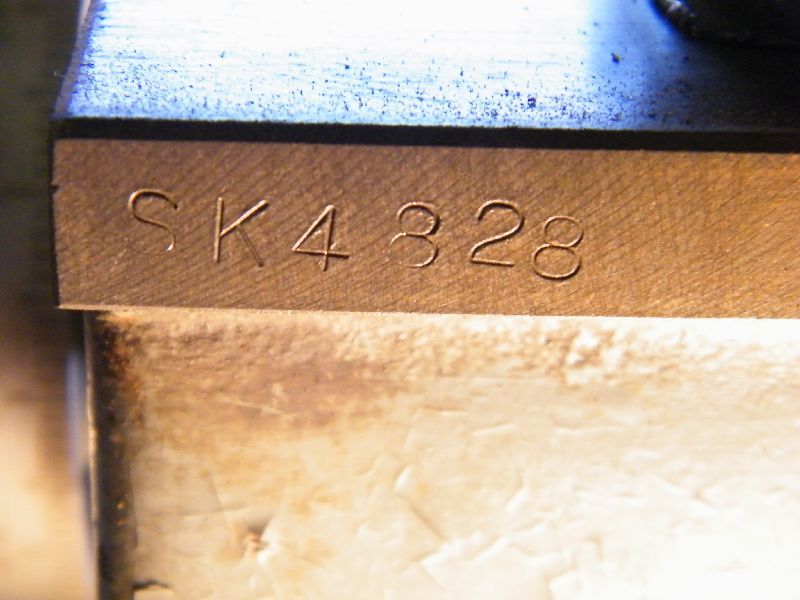

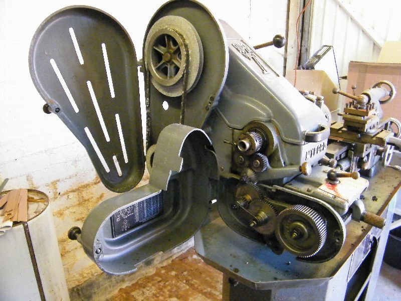

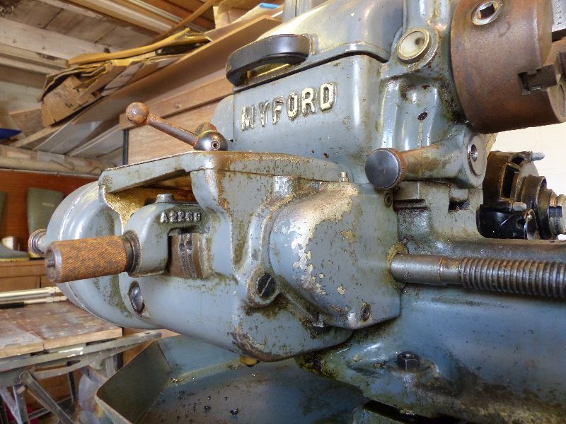

      The Serial number tells Me that I have a lathe built between 1955 – 1958, ( I was also built in 1958……) and the head stock design tells Me it is a MK1 with oil drip feed:-

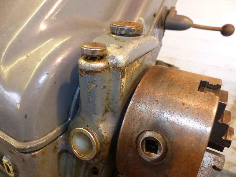

      …and the early QCGB:-
      ….and early clutch:-

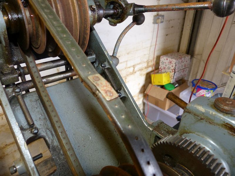

      I lubed it and carefully ran it up and it seems to run OK, but the motor lags behing the switch (Salton) by about a second (normal?) and does not appear to be on a resiliant mount, but I may look at a Newton Tesla 3 phase conversion set.
      Clutch works fine!

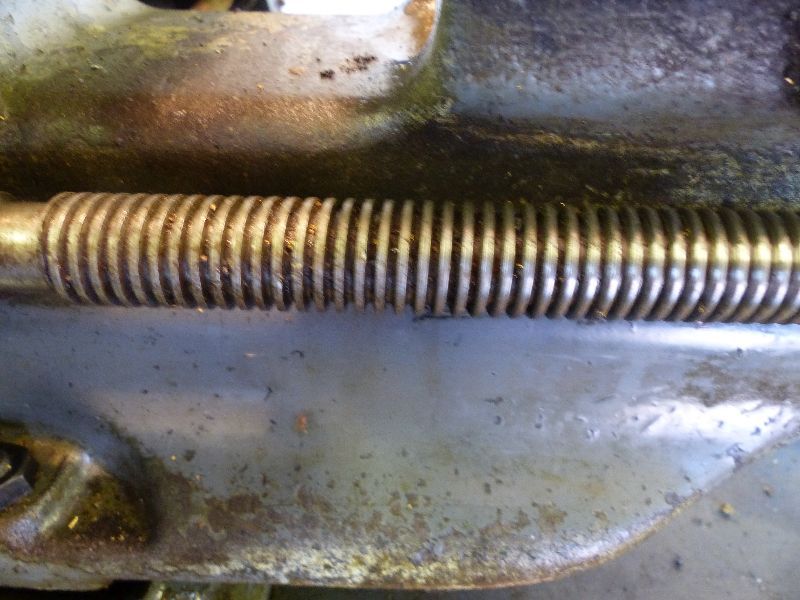

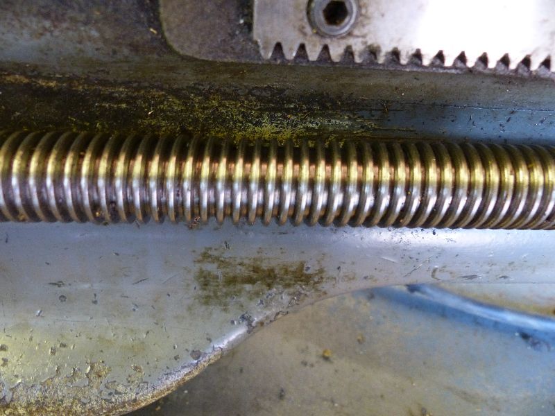

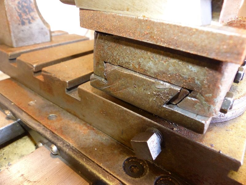

      Apart from general crustiness, it seems in quite good health, only signs of trouble where a bit of chuck rash and wear on leadscrew thread, and the usual wear on the bed causing a bit of tightness about 12" along.

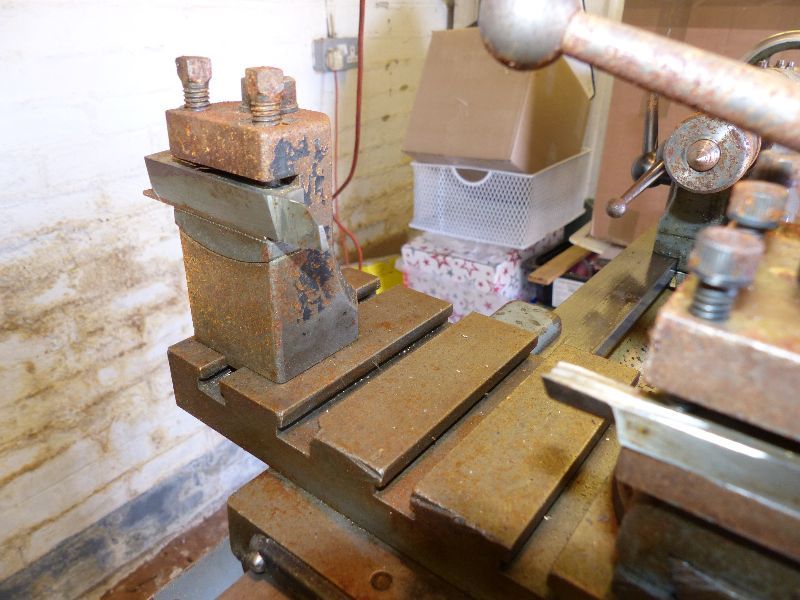

      Rear toolpost fitted (Myford?)
      The plan is to strip, paint and rebuild it with new bits where nessecsary, I will decide on bed re-grind when I measure it up.

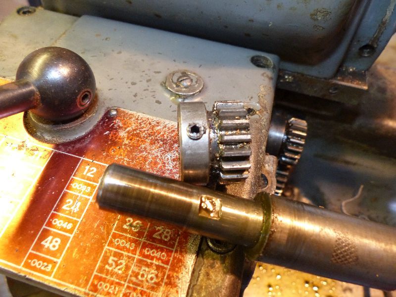

      Since taking these I have started stripping it, but not sure how the leadscrew detatches from the gearbox, not found a lot online, any ideas?

          Yes, that RTP looks like an early Myford job with its boat-shaped tool height adjuster.

              I note comment about rear toolpost. I can confirm that it is Myford – I have one.
              My S7 dates from around 1971. Now got Newton – Tesla vfd drive as the old motor 'went home'.One of the best extras that can be fitted to the basic lathe, in my opinion. I have collected quite a few accessories over time. Very satisfied with my purchase many years ago.

                      Morning Pete, welcome to the Myford "it's older than I am" club – which mine is. I've got one looks exactly the same in my shed, love it to bits. It's a little bit older than this but it's a trooper.
                      Two little jobs to recommend to you if I may:
                      1. Clean the half nuts, as that is almost certainly the cause of the thread wear you show on the leadscrew. That means withdrawing the leadscrew – the bottom nut will come out downwards but the top nut is held in by the lead screw. But I bet the halfnuts are full of an abrasive mix of compacted swarf and old oil, which is abrading the lead screw and stopping the half nuts engaging fully.
                      This means removing the leadscrew, come back to that.
                      2. Cover the ventilation slots in the motor. The more modern version has a totally enclosed motor, but this one is vulnerable to bits of swarf taking a hike down the openings in the motor. Can be exciting.
                      Going back to taking the lead screw out, I think I'm right in that the leadscrew you have does not go right through the gearbox like the later one does, so all you do it remove the little cover RHS of the QCGB and unto a grubscrew (maybe two?) to loosen the drive gear just inside. With the half nuts handle removed, now remove the two screws at the tailstock end of the leadscrew which mount the RHS bearing to the bed of the lathe. The lead screw with hand wheel, bearing bracket etc should now slide to the right, out of the half nuts. I haven't done this for ages, if anyone else knows different or I've left out a stage please correct me.

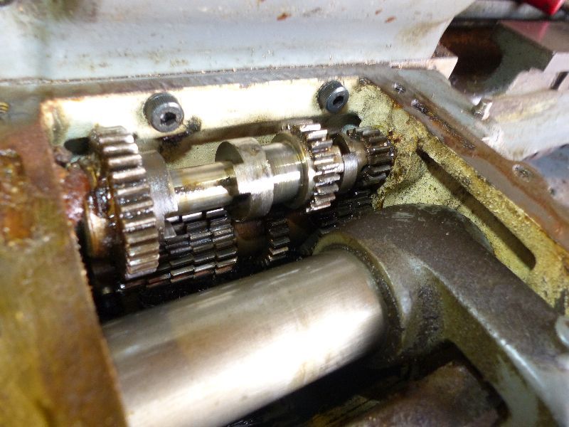

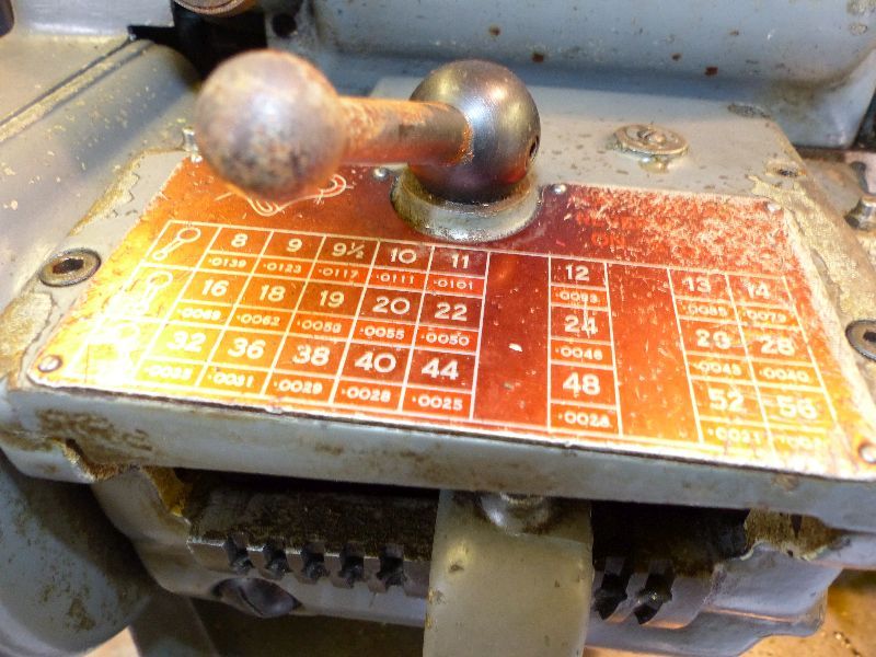

                      One other comment – you have the (contemporary) Mark 1 gear box there – if you get into playing tunes on the gear train between the mandrel and the gearbox to cut threads other than those shown on the gearbox legend plate you need to know that your gearbox runs at half the speed of the later Mk 2 gearbox. Plenty on here to explain what that does to the arithmetic, more anon.
                      And lastly, my take on the bed wear issue is that unless it is completely outrageous it is survivable, and getting fixated on whether the bed is parallel is not necessary.
                      HTH Simon

                        I have literally just come back in, discovered the secret of how the leadscrew is connected to the gearbox,but the only Allen key I hav'nt got is…….smiley

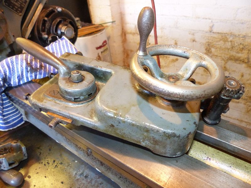

                        Anyway, I removed the gear that drives the leadscrew and it slid out of the box!
                        As it stands, it is sitting with the apron, g/box end casing and R/H mounting and handwheel still in place ready to stripdown.

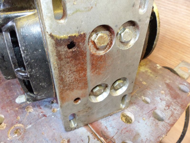

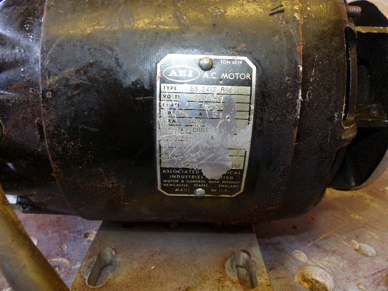

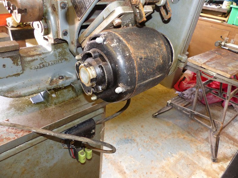

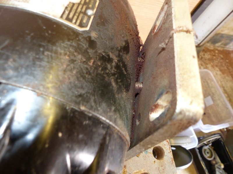

                        I'm going to remove the motor tomorrow, from what I can see it seems to be bolted to an 1/2" aluminium
                        Plate, the bolts appear to go through the motor casing!
                        The halfnuts are there, er, somewhere, covered in what appears to be sawdust, I will give everything a good clean as I go.

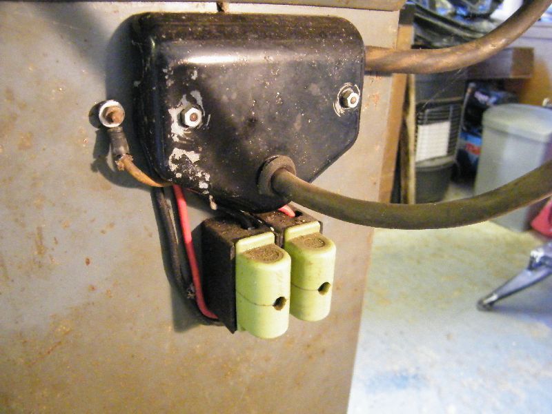

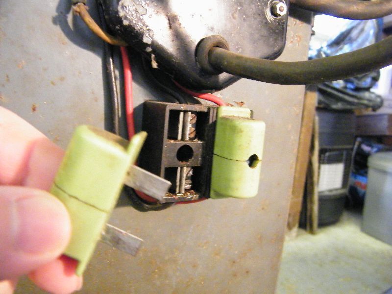

                          Please Please promise that you won’t connect that lathe up to power again before you’ve had those electrics professionally checked out!
                          Looking at your pictures I am sure you have some serious safety issues!

                              Hi V8Eng:- Rest assured I will not be powering it up again, I only run it up to see if the motor ran, and gearbox and clutch operation.
                              I would have preferred to keep it 'original ', ie new drum switch, single phase etc, but have decided for safety and ease of operation to fit a new 3 phase motor with VFD etc.

                              I hav'nt found a number on the gearbox yet to date it, I understand the 'Early' early boxes had unhardened gears, but I think they pre-date this year.

                                Why do you think that? Yes it's old. Yes there isn't secondary isolation over the wiring. Yes it certainly doesn't comply with the 18th edition of the Regs, but there is no intrinsic danger visible…
                                  It's under the cover at the tailstock end, QC followed by 4 numbers less than 2496. If you know the lathe's history and it was not in private hands, then quite likely the gearbox was retro-fitted with hardened cogs at cost by Myford as there was a recognised flaw. Private buyers were not told I believe. The guts of the gearbox are identical to the later version but external drive was totally different. If you want to cut anything that is not an imperial thread, then you need to consult those who know.

                                      If I did decide to use the original motor it would have had an overhaul/replacement, rewire and new switch etc, but I'm not sure if it would cost much less than fitting a new 3 phase motor etc., coupled with soft start and variable speed seems a worthwhile step.
                                      Also I'm not sure how the motor is mounted yet, it does not appear to have mounting feet, it looks like it bolted to an aluminium plate through the motor casing!
                                      I'll know more tomorrow when I remove it from the motorising unit.

                                        Hi Pete, thanks for those kind words, good to hear you manged to wiggle the lead screw out successfully.
                                        Given the wear on the lead screw, you might decide to replace it. I have doubts if you'll find a new direct replacement, but the lead screw for the Mk2 S7 can be altered to fit, though I fancy you'll need a lathe to do it. Essentially the old screw is shorter than the new one, I can't remember if it needs a shoulder turned on the end to take the drive gear, when you're ready post a picture and we'll fathom it out.
                                        Where are you? If you are anywhere near West Glos UK I'd be pleased to help. Of course that's not going to happen for the foreseeable future while this corona virus stuff is going on.
                                        In passing, I checked the serial number of mine, it is SK 3534 which I believe makes is vintage 1953. Two years older than me!
                                          No intrinsic danger visible?
                                          My main area of concern was those fuse holders, they are of a type which exposes the live connections completely when the fuse carrier is removed, being uncovered on the machine’s rear there is no protection to them from spilt oil or coolant etc.
                                          If the wire colours are correct it also looks like both the live and neutral are fused.
                                          If the wiring standards are like that on rest of the machine then it spells even more trouble.
                                          Get an unknown electrical system checked out! Nothing to do with elf n safety or an edition of the Regs, just sensible precautions and hopefully common sense!

                                            Thanks for the info on the leadscrew, as You say it's a 'chicken and egg' problem when You have to repair Your lathe with no lathe!!smiley
                                            Before I stripped in down I checked for slop on the threads with the halfnuts engaged and did not feel any discernible movement, in fact I was quite surprised when I saw the wear!I
                                            On the plus side, if I found it to be a problem when rebuilt, it's not a major job to take it out to replace it (now I know how!!)

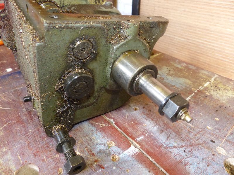

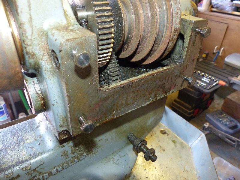

                                              Leadscrew released from captivity, this earlier box supports the end of the leadscrew, loosen the grubscrew to slide it through the driven gear:-

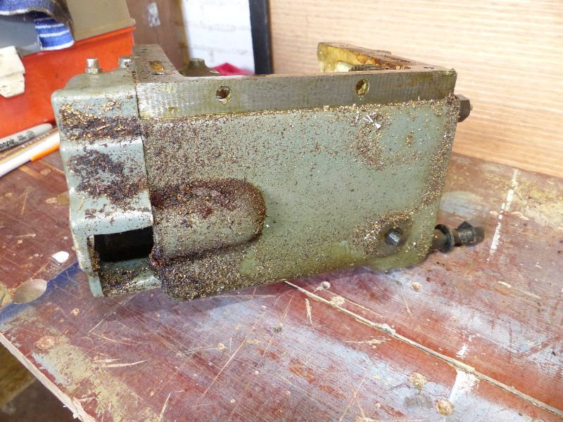

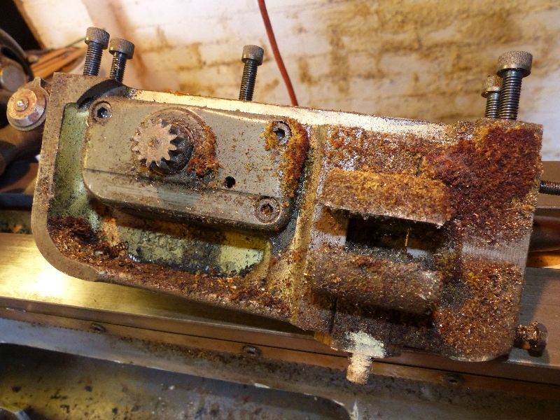

                                              Apron could do with a bit of a clean (Someone made a Fruit Bowl?):-

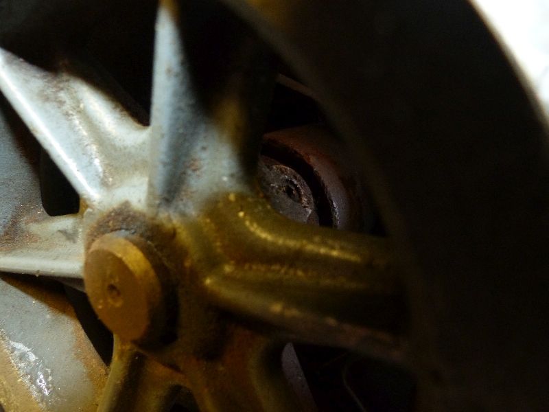

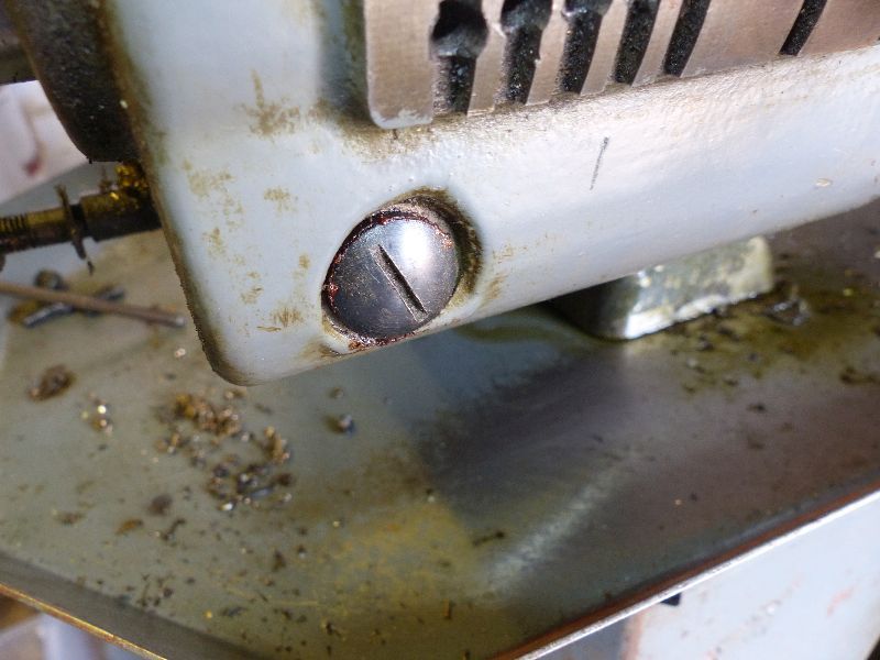

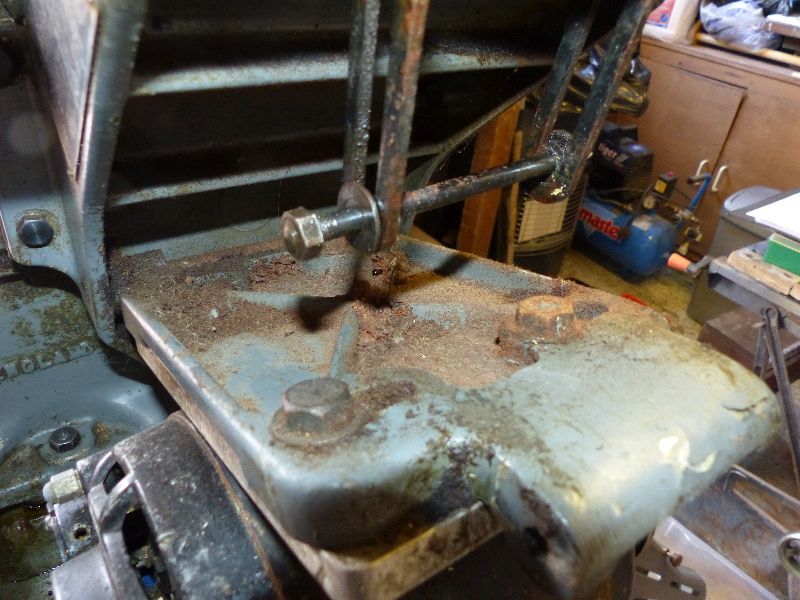

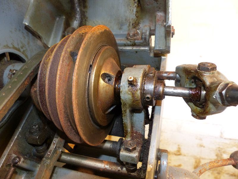

                                              Motor pulley came off alright, but missed one of the TWO grubscrews on the countershaft pulley boss ( Crack….Ebay!frown)
                                              It might be able to be welded, I'll have a look….
                                              This is the one I found…….

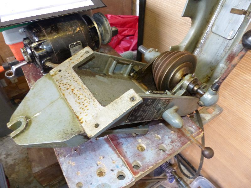

                                              Motor mount plate released to swing down for better access and motor removed,it is a single Phase 1/2 hp not resilliant mounted:-

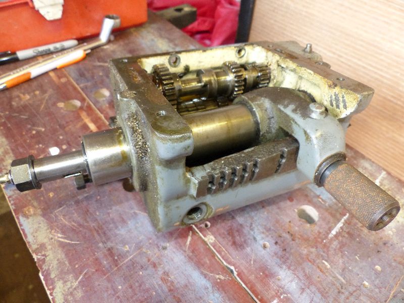

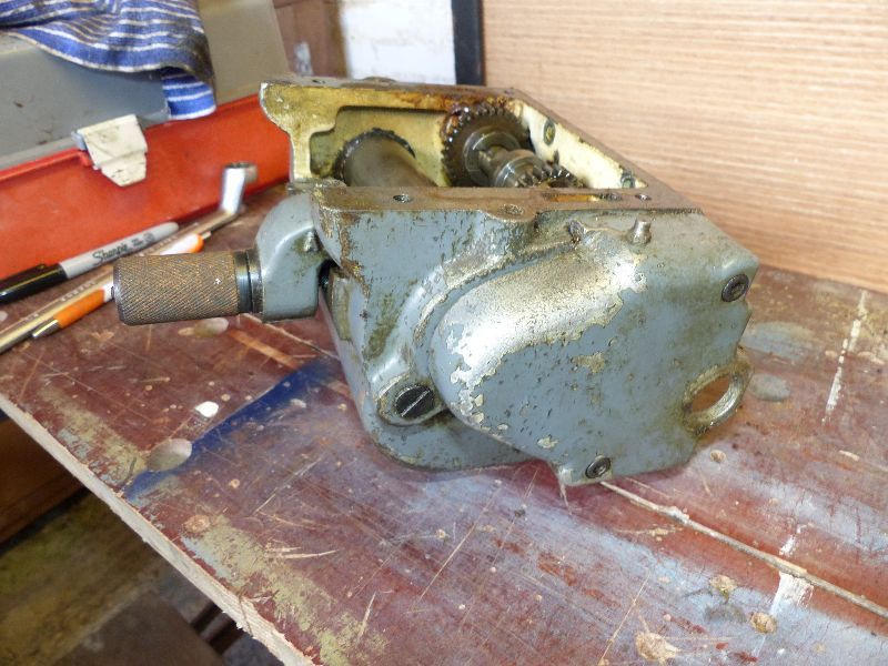

                                              Gearbox is removed by taking off top plate to access two capscrews at top edge, and removing plug at the lower front of box gives access to a slotted screw that picks up one of the redundant leadscrew L/H bracket holes.
                                              Packing strip at top recovered and put back on bed with screws to keep safe:-
                                              Some views of removed gearbox, serial number ( stamped on top R/H side of casting under output gear cover(, shows it to be an early, early box:-
                                              Think I will treat it to a new belt smiley !:-
                                              Motorising Unit removed, bolts screwed back in to headstock for safe-keeping:-

                                                I agree with V8 and it's all easily fixed. In addition to the dodgy fuses and exposed wires, the earth is a tiny rusty bolt and the cables look like rubber. Never trust old rubber…

                                                      Hi Steve!
                                                      Nice workshop You've got there!
                                                      Myford is looking sweet and the Tom is in really nice condition!
