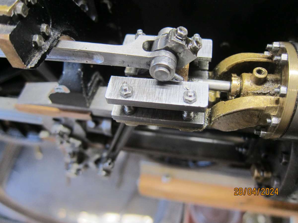

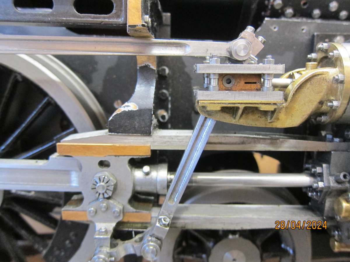

      Hi All – I am looking for a means of securing a parallel silver steel retaining pin in part of the valve gear of a 5” gauge steam locomotive.  The 3/16 diameter pin is designed to provide a smooth running fit through the middle hole of a combination lever which is supported either side by corresponding holes in the valve cross head assembly.
      Following the “words and music” given in the build notes the hole in the lever has been reamed 3/16” and the holes in the valve cross head have been drilled using a No. 13 drill (0.185”) to provide a retaining fit in the valve guide.
      In practice my No.13 drill has drilled slightly over sized and instead of providing the required friction fit for pin retention the drill has resulted in a freely rotating fit. Now in any other situation the problem could be overcome by putting a head on the pin and a retaining collar at the free end but the current location does not provide the space for this approach and so I am left with looking for other possible solutions.
      My thoughts have centred on using a Loctite retaining compound but if so I would like to be able to drive the pin out at any time for possible servicing/replacement of parts without having to use too much brute force (or excessive heat) but I am uncertain as to which would the best choice of Loctite (or similar) type to use.
      There may of course be other possible means of providing the required interference fit for the pin and I am open to all such suggestions.
      Hoping that someone will be able to come up with a working solution.

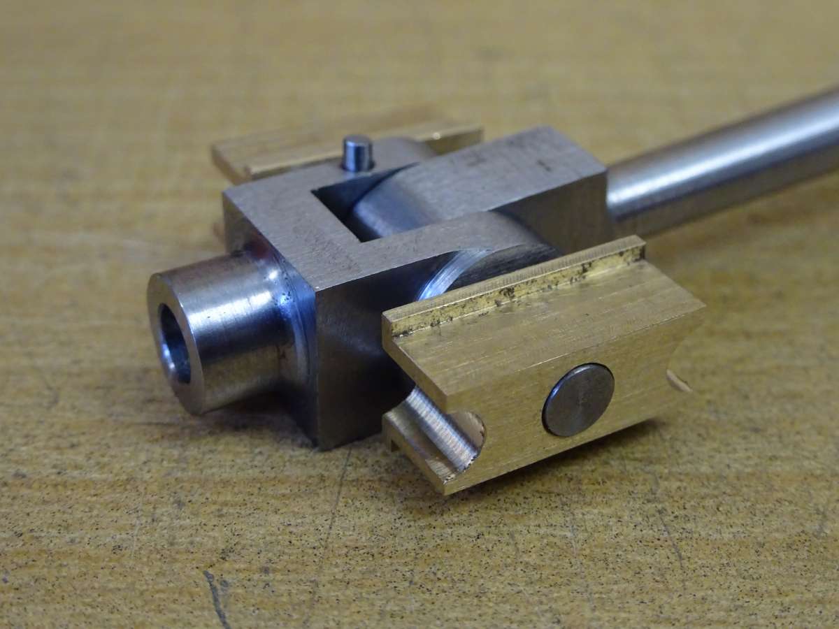

          Can you drill and ream one of the members for a taper pin, these are  a 5mm pin so not far off your 3/16″, fisrt one the taper pin just cuts half way into the side of the pivot pin. Second it goe sthrough th emiddle

              The location of the cross head guide bars would make the use of a taper pin difficult and at this stage I would rather pursue the idea of an easily removable Loctite retaining compound.  The 3/16 diameter pin is shown in the second photo as currently fitted with a through hole.  As can be seen, the presence of the guide bar pillars make it impossible to fit a pin with an integral head and collar arrangement
              Combination Lever Drive Pin (1)
              ytty
              Combination Lever Drive Pin (2)

                                                      Some sign of success!  Having tried the 6BA grub screw into a pin with a split end without any joy I changed tact, re-drilled the hole 2.5mm, tapped out to 3mm and inserted a short 3mm c/s screw with the head turned down to 0.0170. Net result, the desired tight fit in the cross head without the need to do any dismantling and visually quite pleasing. Current thinking now is to put a plain screwdriver slot into the inboard end of the pin  enabling it o be inserted from the front whilst being held back with a modified screwdriver at the rear. Anyway, that is my current thinking. All good stuff.
