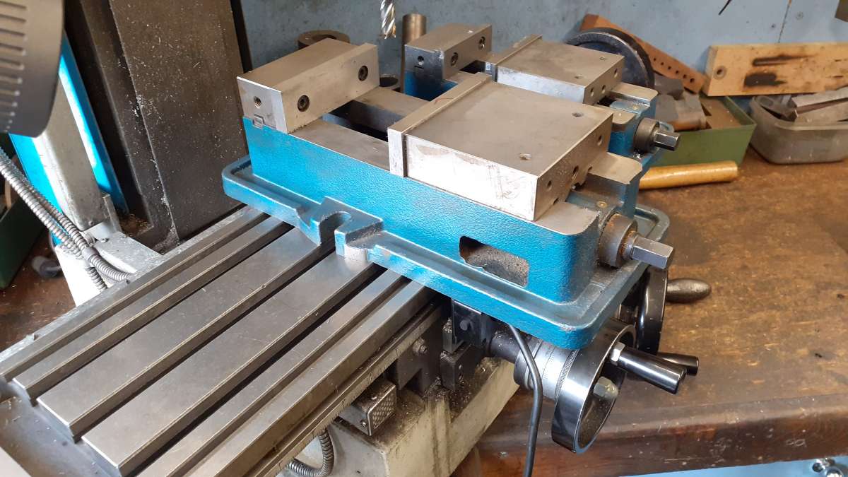

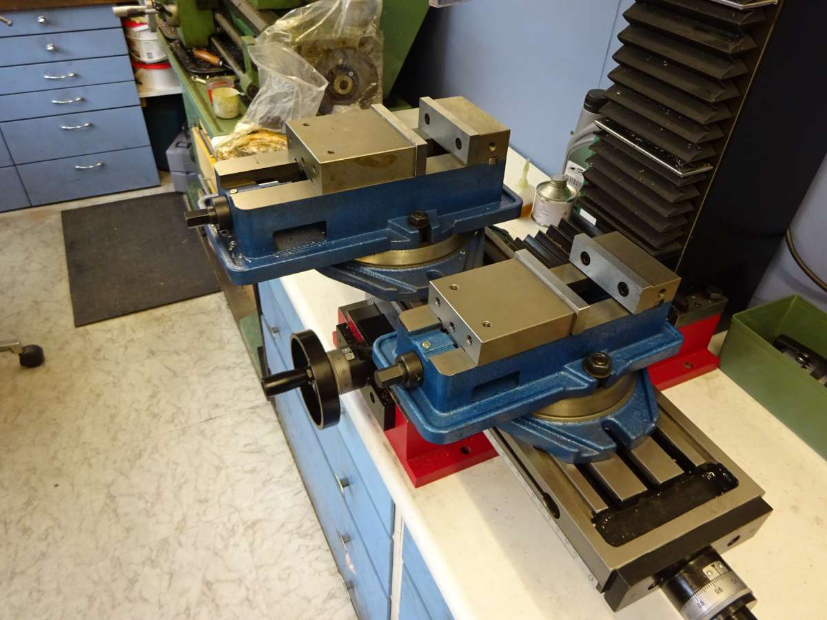

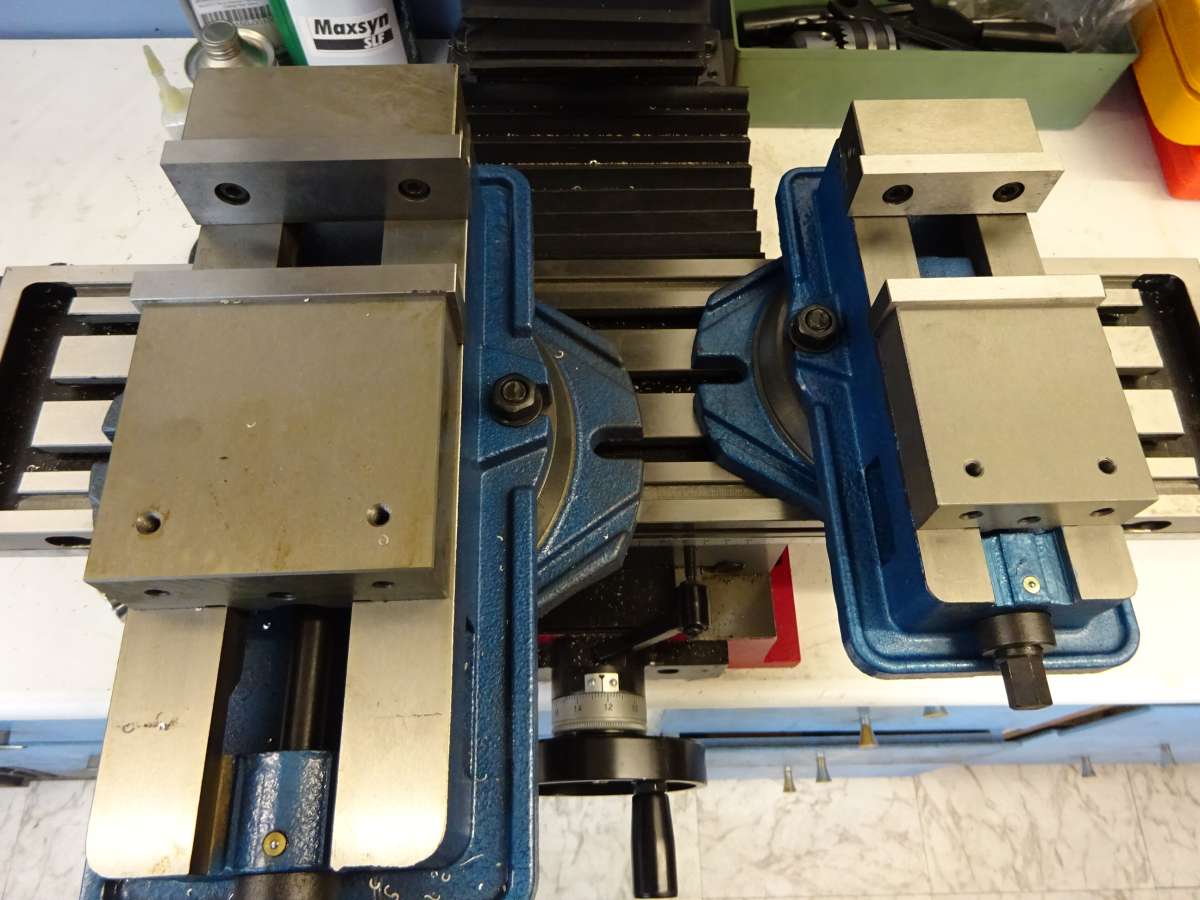

            There are a couple of issues with big vices on small mills.
            If bolted to the middle tee slot the fixed jaw ends up quite a distance back which can mean you run out of forward Y axis movement when wanting to clear a large diameter cutter such as a facemill of flycutter.
            If you use the front tee slot to avoid this it means there is a lot of weight hanging off the front of the table that can affect front/back tram a sthe table gets tilted up at the rear.
            In either case you have a lot of vice overhanging the Y axis handwheel which can make it harder to read  the dial. Though that can be used as an excuse to bring forward the fitting of a DRO
            Al lot is going to depend on the sort of work you intend to do but if you are going to be doing a lot of work that actually needs the capacity of a 4″ vice then the small mill may not suit.
            Here are a few images to show how the various vices fit on a SX2.7 which does have a smaller table, you may actually get away with the 100mm as I was thinking your WM18 was a bit smaller.
            I’ll take a couple mor ephotos a bit later of them on my larger X3 and without the swivel bases fitted.

              The larger vice is larger in all directions including more overhang at the rear of the table and you loose nearly an inch of daylight under the quill.
              Figures for the versatile vice below

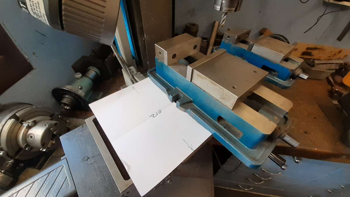

                      Hold on
                      I’ve just put the two onto my X3 which has  a smaller table than the WM18 and think you can fit the 100mm OK
                      The paper has the 210mm width of the WM18 marked onto it so overhang is not too bad. If you are really worried then the Iron 100mm does not have the lip around the edge so has a smaller footprint for the same sort of capacity
                      I’ve drawn out the footprint of the two vices that you can print and put onto your mill to get a feeling for what it will be like, they will print full size at A4 but the 100mm will need two pieces of paper taped together. PDF here

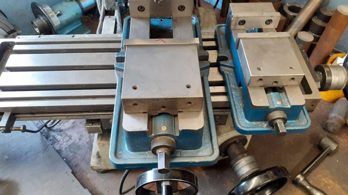

                              Ah that is about the same as my X3 @170mm wide, couple more shots of the two on that

                              Robert Bowen-Cattry
                                @robertbowen-cattry70600
                                Yep, confirms my initial thought, the 80mm seems a better fit for me. Cheers Jason.
