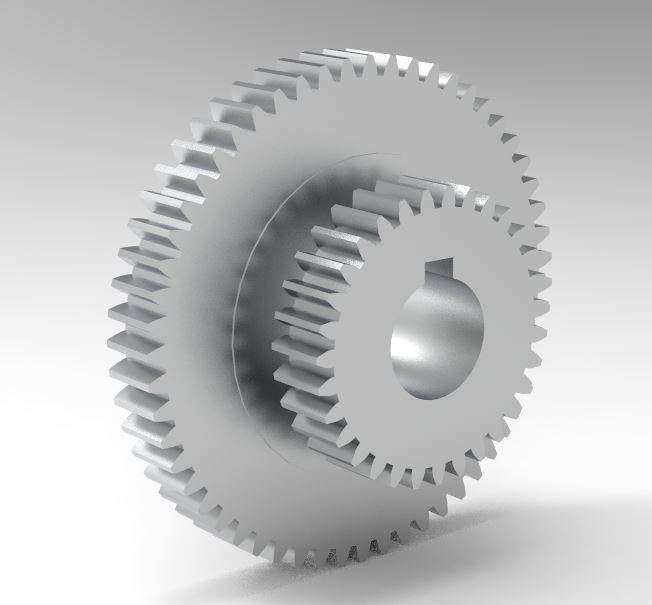

            … which makes ‘about 0.6mm’ on 87mm a reasonable amount of growth for a hygroscopic material, methinks.
            Perhaps more relevant though, is the fact that the small gear appears to have been only meshed to less than half its width.
            IMG_9342
            #720700
              Yes that is what I said in my first reply
              #720703
                11.3 + 11.3 + 6.45 = 29.05, in my book that is more than 28.65. I’ll draw it for you but need numbers that work.

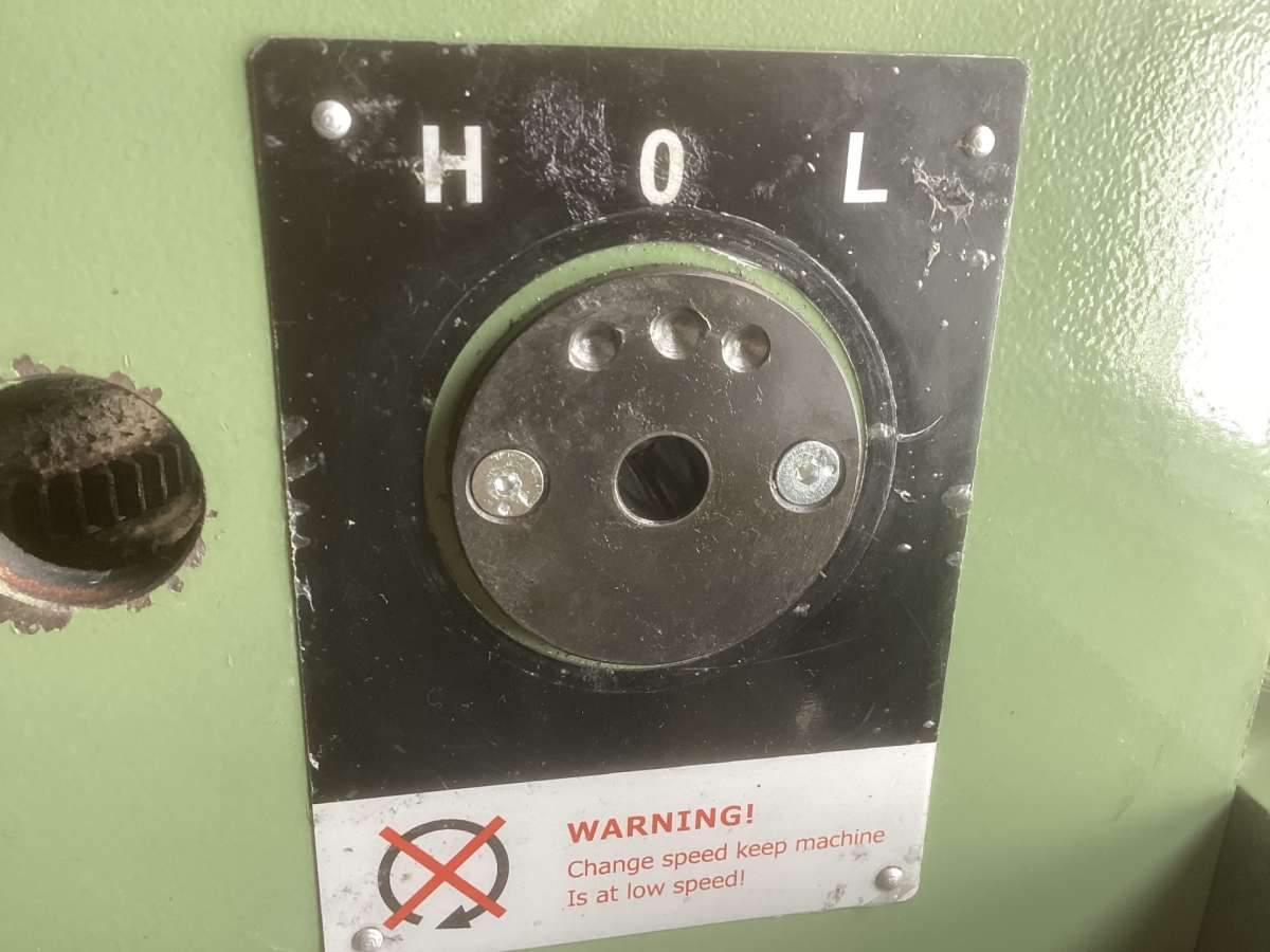

                        I don’t know how important the slightly raised areas are, nor how to describe them numerically, but maybe if the extra 0.4mm were distributed equally between the two cog thicknesses whilst preserving the given dimensions of the connecting/separating shaft there wouldn’t be too much of an issue. If I’ve read him rightly, DC31k does suggest a slight oversizing of the cog thicknesses may not be unhelpful.
                        On this subject – the apparently only partial-thickness-engagement of the low gear with the spindle gear (both on my machine and on all the other examples I’ve seen on the Internet of the same stripped gear) – I’m wondering whether this may be something to do with the positioning of the detentes in the gear selector plate, rather than, or perhaps as well as, with the thickness of the cogs.
                        I’ll try to explain. After my gear was damaged but still in situ, I noticed that whilst the high gear sat perfectly level with the spindle gear when high gear had been selected, the low gear showed a tendency to drop back down slightly once the my hand let go of the knob and the ball bearing inside had settled back into its relevant detente.
                        It was not very easy to be sure of this, though, because the mangled portion of the gear made it difficult to select low gear at all. By way of explanation, in the photo at the foot of this post showing the circular gear selector plate, you will notice that the detente for the low gear is considerably closer to the central detente than the high gear detente is. Is this a factor in the unsatisfactory engagement, I wonder?
                        What I’m planning to do, assuming I get a new gear of some kind made and fitted, is to see what gear selection looks like with the new gear and the existing gear selector plate. If the new low gear visibly drops back down slightly away from full engagement when low gear is selected and the selector knob is released, I think I will know with more certainty that the detente position for the low gear isn’t far enough away from the centre to keep the gear in the correct alignment.  I will then set about making a new gear selector plate (probably from gauge plate) with the low gear detente countersink somewhat further away from the centre than on the present one.
                        Any further thoughts would be much appreciated.

                        #720797
                          Bill, the post I took the picture from in this reply of mine went on to show a clamp that the guy made to lock his selector know in the fully engaged position as he too found that the selector and therefore gear worked the it way down. It was a bit rough but did the job. I will see if I can find it again.
                          If the existing plate is just held by those two screws you could just rotate it 180deg and drill some new detent holes.
                          If 29.45 Overall is OK I can easily put a 0.2mm raised area either side of the large gear or could reduce the central bos sto keep OA as 28.64 with the 0.2mm bearing. then you have the option to print or go elsewhere.

                            On the detent plate, should it be a large diameter plate to give more authority. The detent lever on a Centec is much bigger.
                            The 2nd U tube link posted by Pete Greene from 6.00 to 6.04, where the guy actually tests the shift, the gear with the bad one that you can barely see, seems to move down as the gear is selected and up when not selected.
                            If the gear below is moving away under load and the detent is bad as well.??
                                Is it the size of the plate or the shallowness of the divots that is likely to be causing a problem?
                                I was just to post asking whether drilling through holes in the plate and using a pin-type locking mechanism might go some way to solving the problem.
                                Maybe it would be possible to remove the existing ball detent and spring, drill and tap the hole and use a long dog point grubscrew with outboard grip/knob to lock the lever into place.

                                    Countersinking three new detentes on the opposite side to the present ones certainly seems like a time saver compared with making an entirely new plate, not least because it’s not just a round plate but a top-hat shape with an integral spigot that passes through the sidewall of the mill head.
                                    The thread about the Craftex mill makes for interesting reading. I’m not sure I’d opt for Brian Rupnow’s lever lock solution, though; it seems a bit cumbersome and, if I’ve understood things correctly, the locking pin/screw locates against the back of the motor cover, which is only plastic.
                                    Dave and DC31k, re your comments about the detente plate, I would say the plate is large enough for the purpose and the detente divots about the right depth (I’ve never known the mill to actually jump out of low or high gear); the problem with the gear selection, I suspect, if there really is one, is that the low gear detente isn’t sufficiently distant from the centre detente to hold the low gear in its correct position at the very top of the gear shaft; instead it appears to slip back down the shaft slightly as the ball locates in a poorly positioned detente.
                                    DC31k, a pin or dog point set screw in a hole rather than a ball bearing in a detente certainly seems like a more secure locating/retaining solution. I may well resort to this if I feel even a repositioned ball detente isn’t getting the low gear to stay where it belongs.
                                      Jason’s idea above about rotating the detent plate is a good one. Maybe you can put masking tape on it, reinstall the knob and mark the best postion for the three gear states.
                                      It could be that the OEM has assumed symmetrical about neutral and you might find that is not the case.
                                      Keeping the ball and divot is most ergonomic and once the position is established, it is easier to convert to a pin retainer than to go in the other direction.

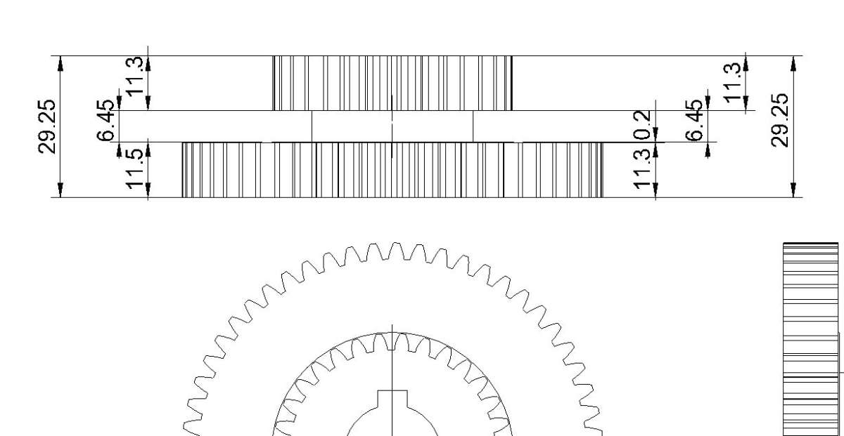

                                        Jason, the overall thickness is 29.05, though as we’ve said the sum of the cog thicknesses and the connecting boss comes to 28.65. I don’t think adding a 0.2mm boss either side of the big cog to make up the difference would do much harm.
                                        11.3 + 11.3 + 6.45 = 29.05. not 28.65.
                                        11.3 + 11.3 + 6.45 + 0.2 + 0.2 = 29.45 overall not 29.05
                                        For the 3D printing option it would make sense to have the large gear 11.5mm with a 0.2mm raised area on the inner face only as having it on both will not be the best option to sit it flat on the printer bed. If needed mount the new gear on an arbor in the lathe and skim 0.2mm off to leave just the raised central area.
                                        Gear is drawn just waiting for confirmation of thicknesses.

                                            Still can’t make it work out to 29.05
                                            If the top gear is a constant 11.3
                                            The Gap a constant 6.45
                                            And the large gear 11.5 when measured towards it’s middle
                                            Then total is 29.25
                                            Or
                                            If top is 11.3
                                            Gap 6.25
                                            Raised area 0.2
                                            And gear at it’s edge 11.3
                                            Total is still 29.25
                                            Neither is 29.05 or 28.64
                                            This is it dimensioned either way but total stays the same.

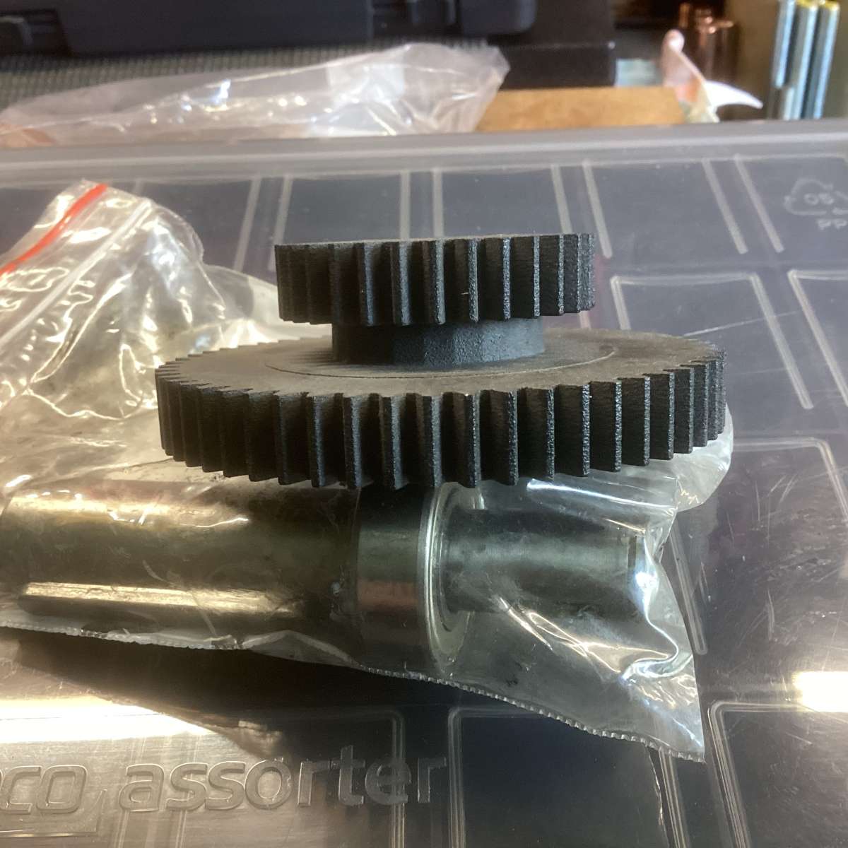

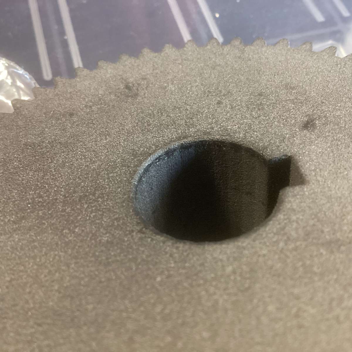

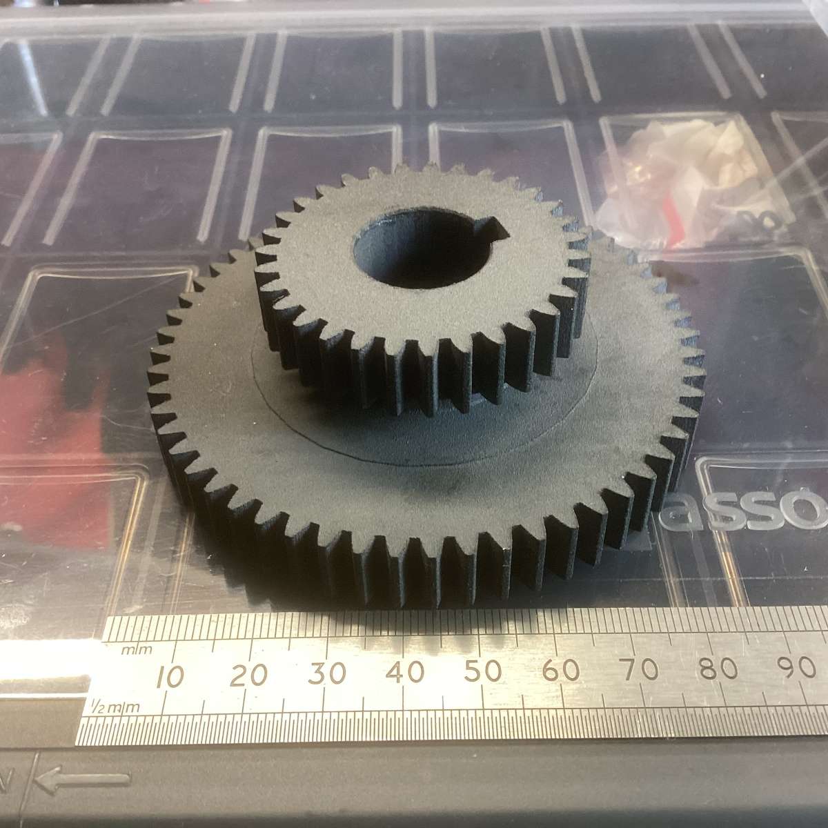

                                                    Bill Phinn
                                                      @billphinn90025
                                                      Just to update, I’ve received a newly made 3D printed gear from the print shop.
                                                      Apparently the material used is PA12. This is a form of nylon, I believe. I’m not sure how strong this is relative to other nylons or whether it’s the optimal plastic for a gear for this purpose. Unfortunately, I don’t know what percentage of infill has been used on my gear.
                                                      I’ve just watched a video of a test done by Youtuber Clough42. His results suggest that plastics such as ABS and certain nylons that people assume are a stronger choice for gears than the most commonly used printing plastic PLA may not actually be stronger than it and may in fact be weaker.
                                                      Anyway, I’ll have to fit the gear first and use it for a while before I can vouch for its durability.
                                                      Many thanks to everyone who generously offered me their help and advice.
