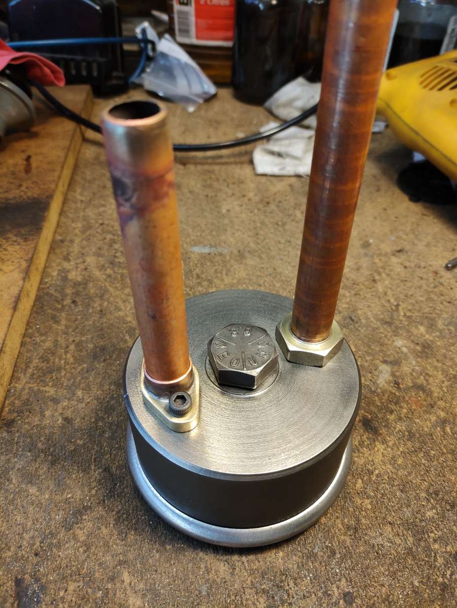

      My Centaur engine had got put on the back burner!
      Guilt kicked in and I am now in the process of mounting it on a proper base (instead of a lump of MDF!) and getting it to drive a generator and running off propane.
      One thing that is bugging me is the exhaust, I have made up a couple of trial silencers and been disappointed at the ‘light’ sound produced. Best sound I have achieved so far is using a long piece of 15mm pipe whereby it sounds nice and meaty!
      What have you boys used in similar sized engines?

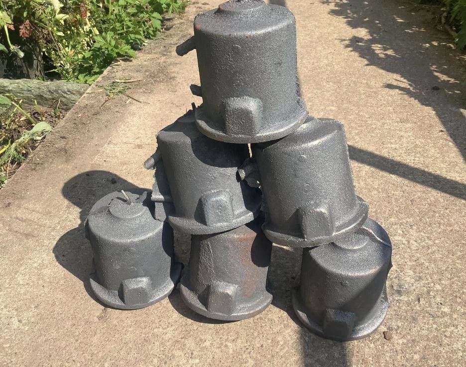

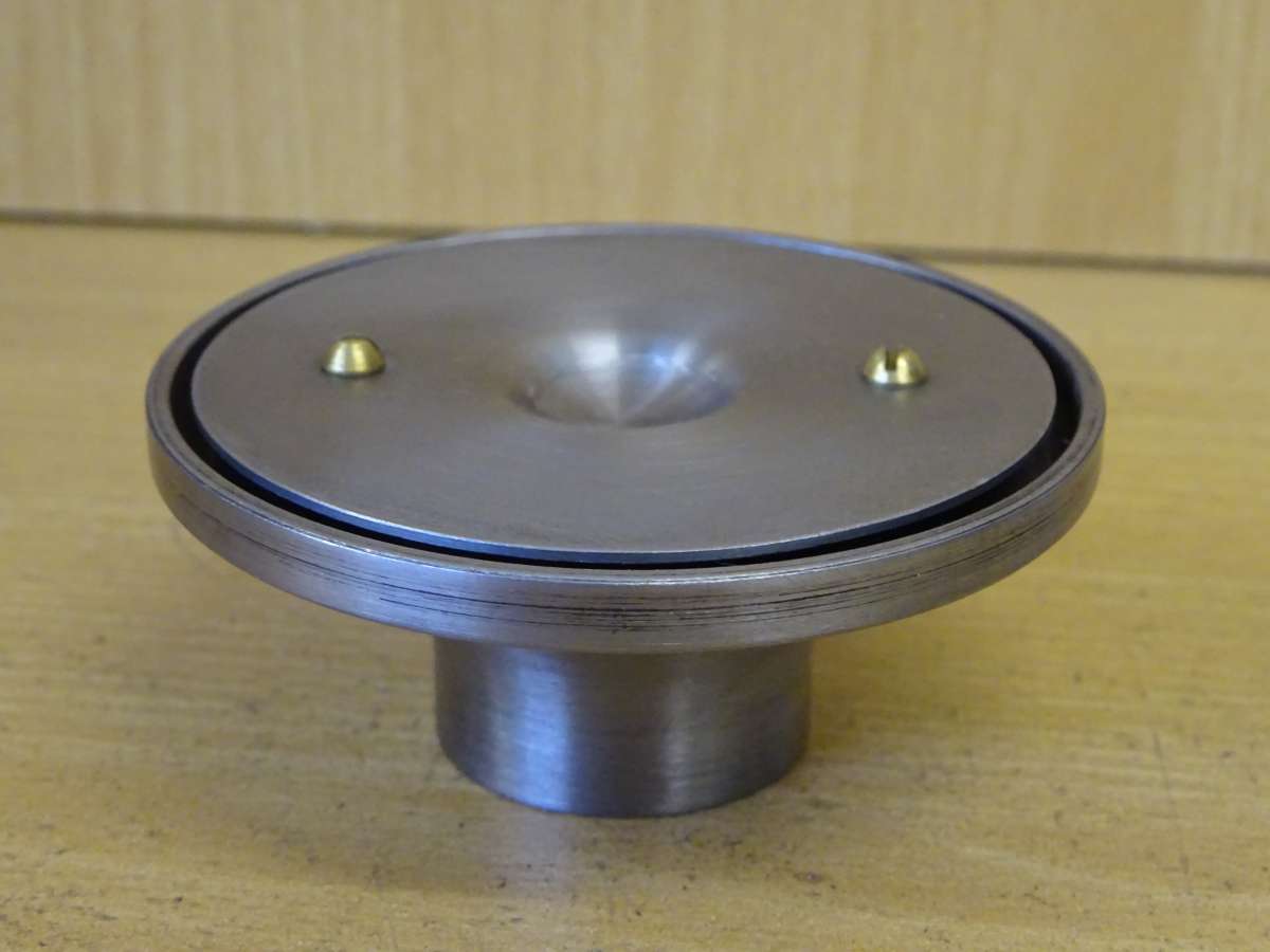

        A cast “pot” type silencer would look correct for the style of engine. I don’t think Graham Corry has any left, Adrian at Enginer’s Emporium also does some but not sure on sizes though easy enough to make from solid.
        pots

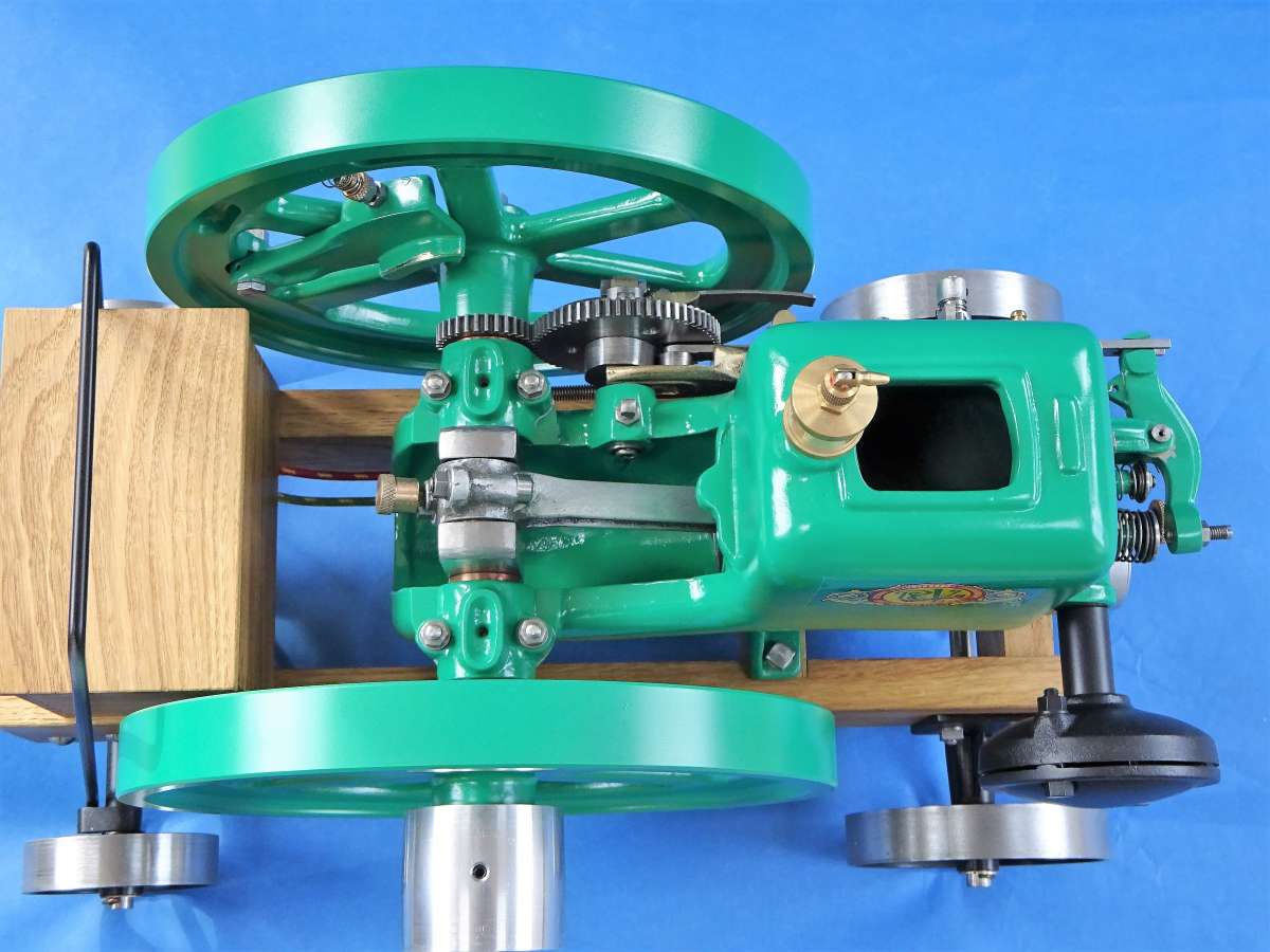

        Most of my open crank and hit and miss engines that do have silencers tend to be the pancake type, two discs with a small space between
        20230410_143512
        DSC01593
        DSC02658

          <p style=”text-align: left;”>Jason, thanks for your reply! The pot type could be the way to go, I’m guessing the larger the internal volume would be required for the beefy exhaust note I’m after?</p>
          Might try and experiment with some different volume containers (tins?) to get an idea.
          Alan

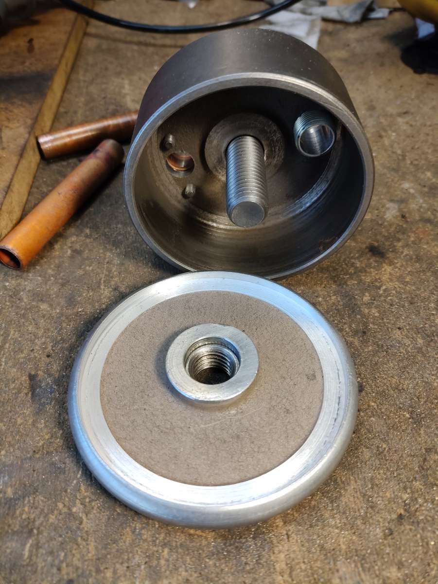

                    Had some experimentation today and decided that any short length of pipe makes for a fuller sound. So having a rummage through the ‘could be useful’ bits and pieces I found the cast iron outer shell from a centrifugal clutch and an aluminium handwheel which could fill the open end.
                    This seems as though it is worth experimenting with, the clutch part is about 3 1/2in diameter and a couple of inches long so it would look pot like! Will try and get some photos up.

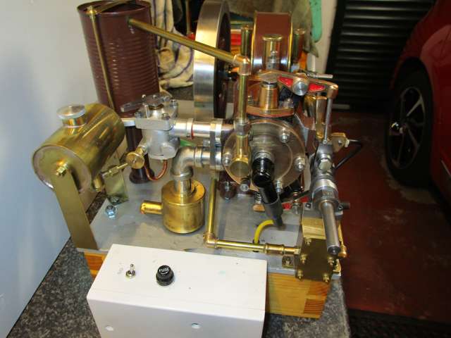

                      The exhaust on my Centaur is made from a piece of 2″dia brass pipe with a 3/8″ bore outlet. my engine has a new owner now
                      https://youtu.be/jxTixF_dQp8?si=wi_sauynTm2m_o-s

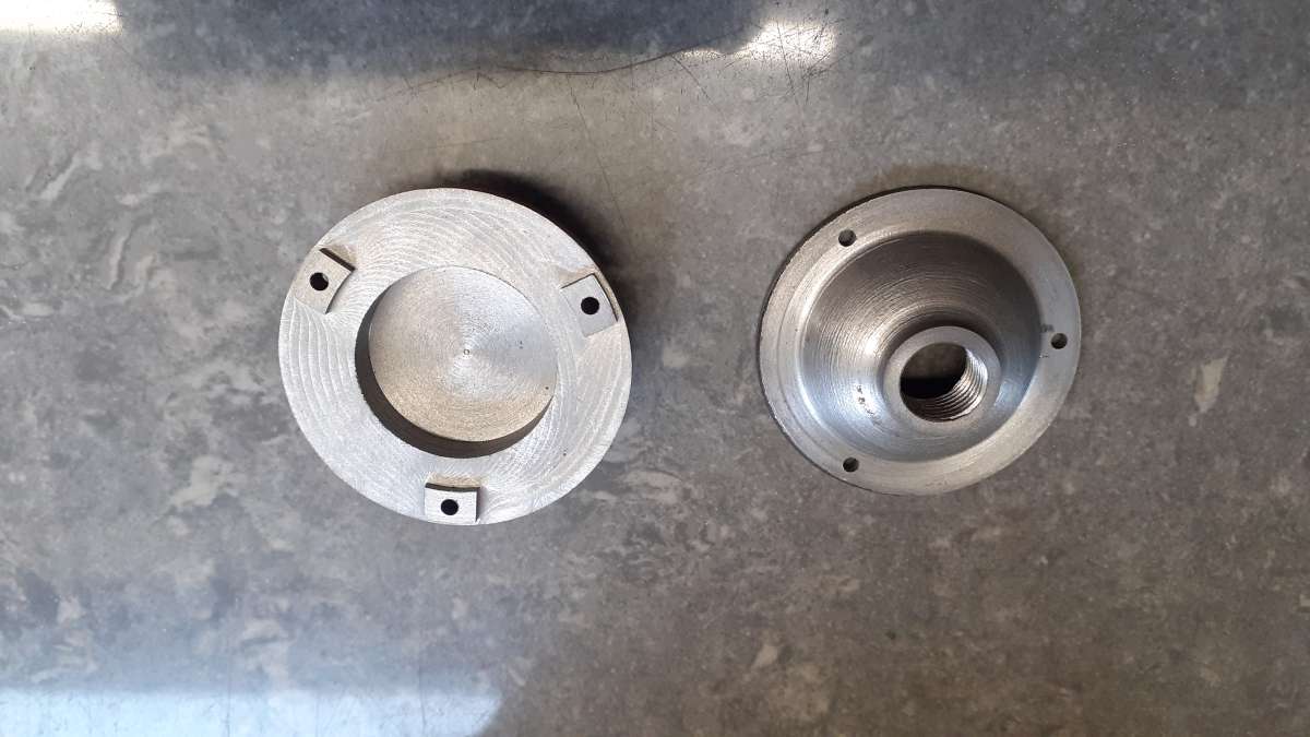

                        <p style=”text-align: left;”>Produced this trial exhaust pot today so the exhaust enters via the flange and possibly fill the insides with a stainless (scourer?) and the exit pipe could be adjusted in length for hopefully a nice beat!</p>
                        Alan

                          IMG_20240407_152220505IMG_20240407_152128121

                                FWIW, and as a point for further discussion, it’s actually noise that the OP wants to produce; I’d have thought (from several decades of motorcycle experience) that with the exhaust cam timing being so soft, compression being so low, & exhaust gas velocity so sluggish, that you’d be better off with a straight pipe deliberately tuned to give the strongest coincidence of pressure waves at the outlet, and to try and use resonance in the pipe wall itself to achieve the note you want.
                                I’d use a straight pipe (not too big dia. to keep gas velocity up), make it as long as looks ‘in scale’ / tasteful, and then see if you can ‘telescope’ a piece at the end and ‘tune’ it – somewhat in the manner of a trombone) – to achieve the note you want.
                                If you want to refine ‘tone’, I might try and use thin wall steel or stainless pipe – copper tends to be a bit ‘dead’ in it’s soft state..
                                ..as a last resort see what can be done to get the Ex valve to open and close with a faster action.
                                I must go to work..
                                ..the classic way to deepen the tone would be a megaphone – probably not the right look for a S/E tho’?
                                #728195
                                AJW
                                  @ajw
                                  Spot on Diogenes! You’re right I want the exhaust to sound like an exhaust and have reverted to the straight through pipe design with the length to be determined by experimenting.
                                  This is in copper at the moment but I believe I have some stainless tube somewhere! Don’t want to start mucking about with cam shapes.

                                            Thanks guys! I took the non scientific approach and have been silver soldering up all sorts of combinations! Final design uses 15mm pipe entering a piece of 1 1/8 in the side and exiting at the other end also in 15mm and must say it sounds pretty good!
                                            Stripped down for final assy at the moment but will put some photos up once assembled.
