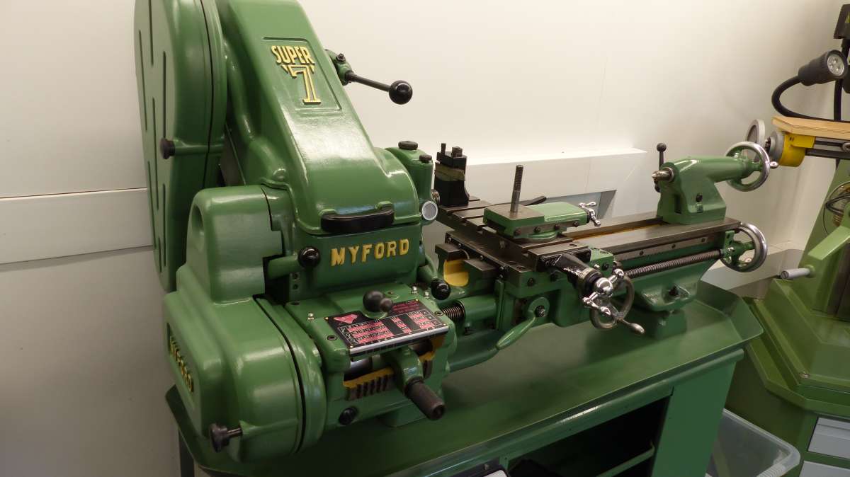

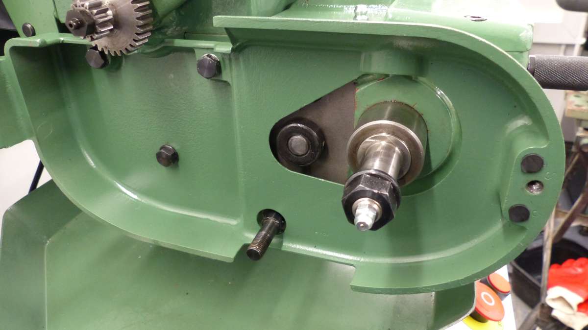

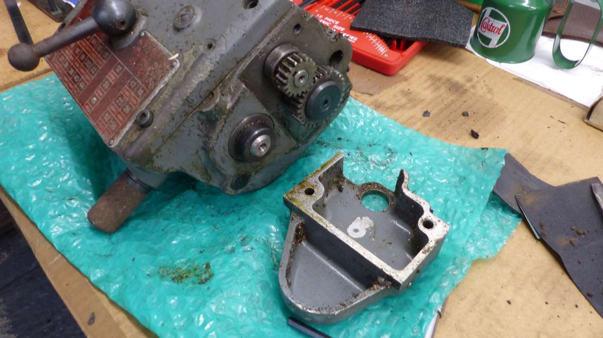

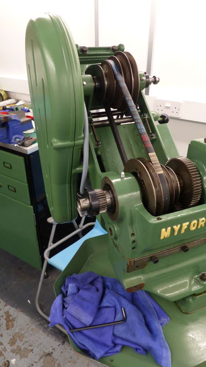

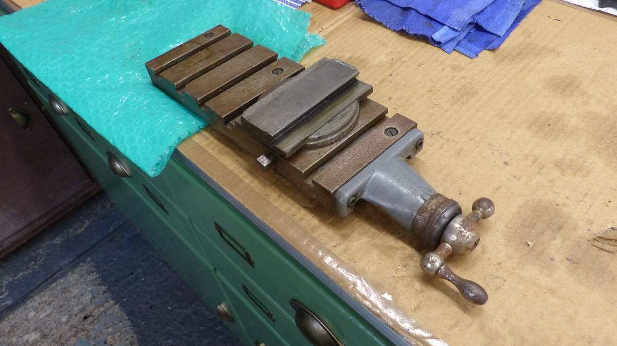

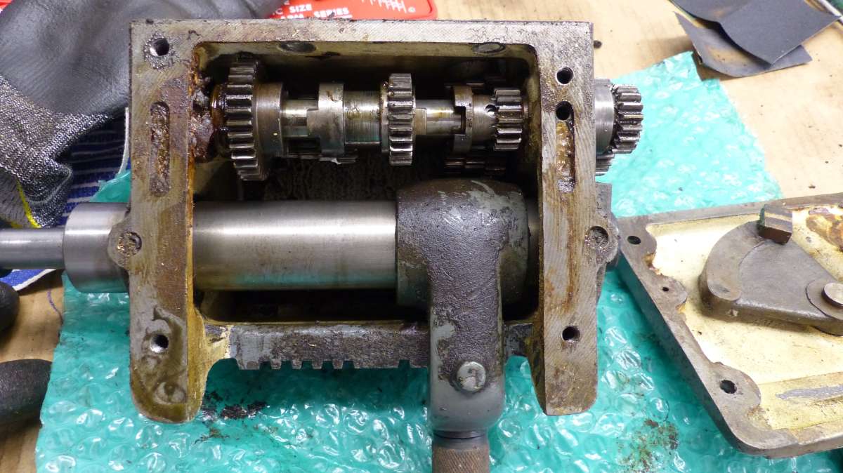

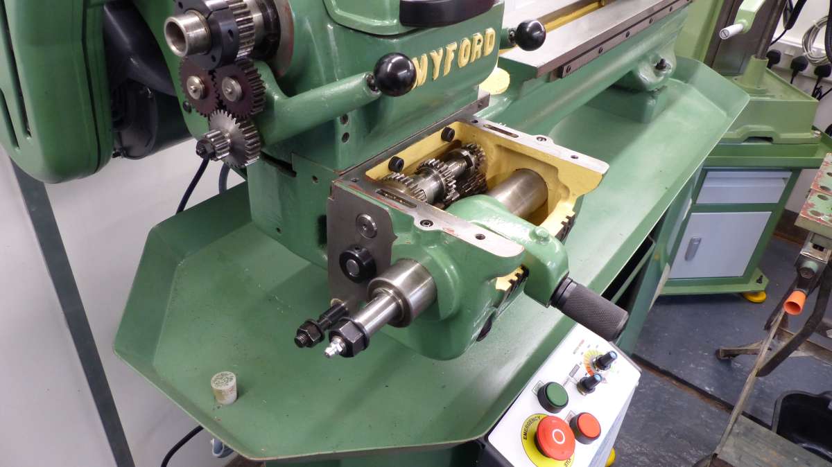

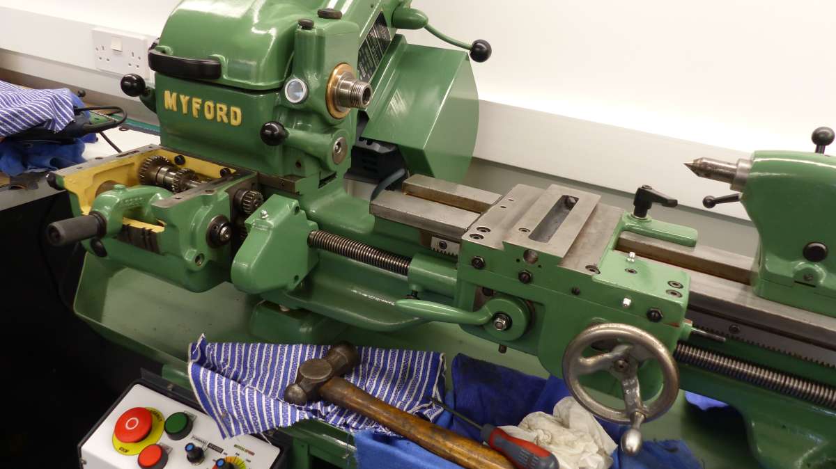

            More Photos:-
            107109110112114115116117118119120122

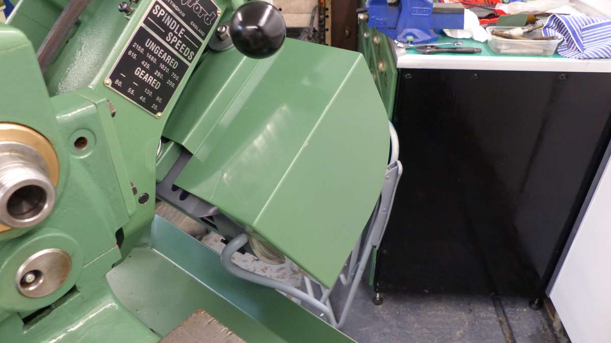

            Motor guard fitted, and belts and their guards fitted,original fixing knobs fitted in leiu of spring catches on later models. bump stops made from a length of ‘O’ ring material instead of £4 each (!) from Myfords.
            Tumbler reverse and back gear knobs fitted with later plunger fittings to speed up use.

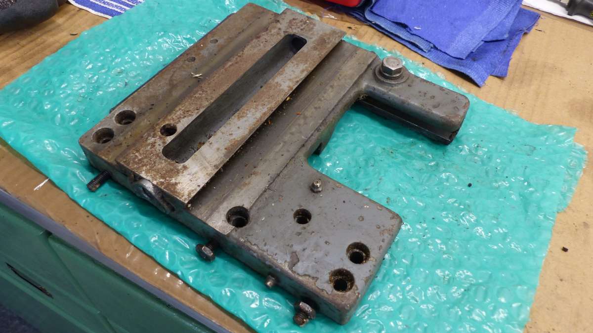

            Cross slide and saddle before cleaning up.

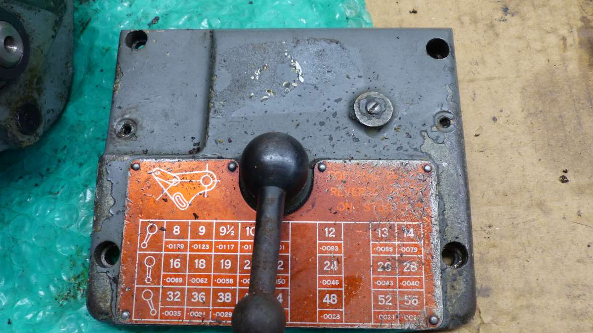

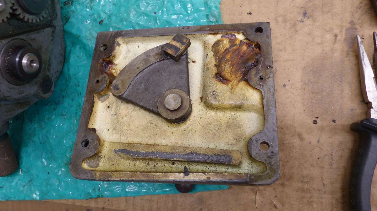

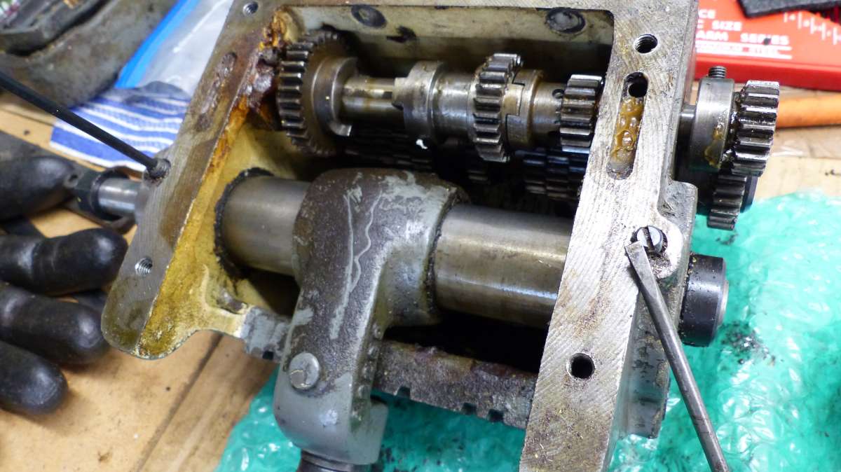

            Gearbox as removed,showing external gearing used on early Gearboxes.
            Inside of gearbox showing that it was well greased (?), and inside of box showing more grease and crud in oilways.
            Some slight chipping of teeth evident, they where unhardened in the Mk.1 boxes.
            Gearbox cleaned and rebuilt and refitted ready for oil. left loose for now to facilitate clocking of top suface alignment with bed for leadscrew height.
            More soon,  thanks for looking in.
            Cheers,   Pete

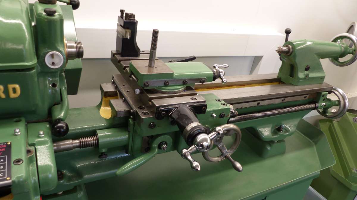

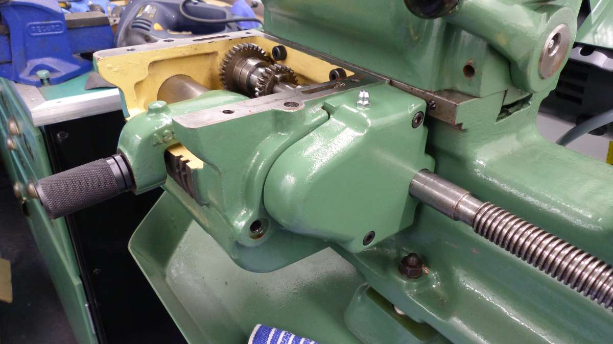

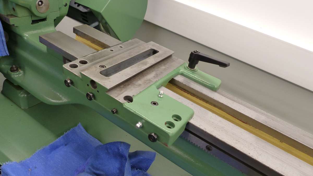

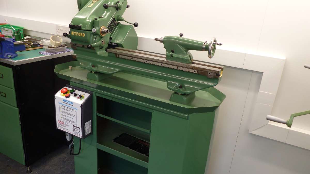

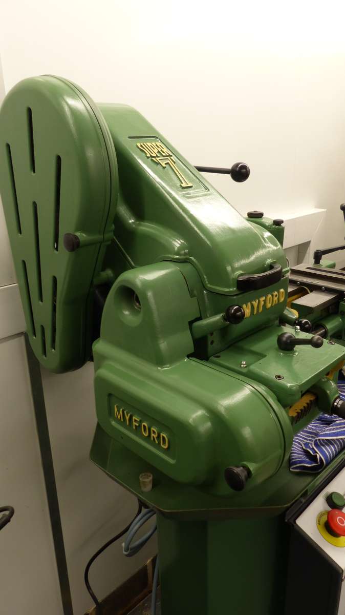

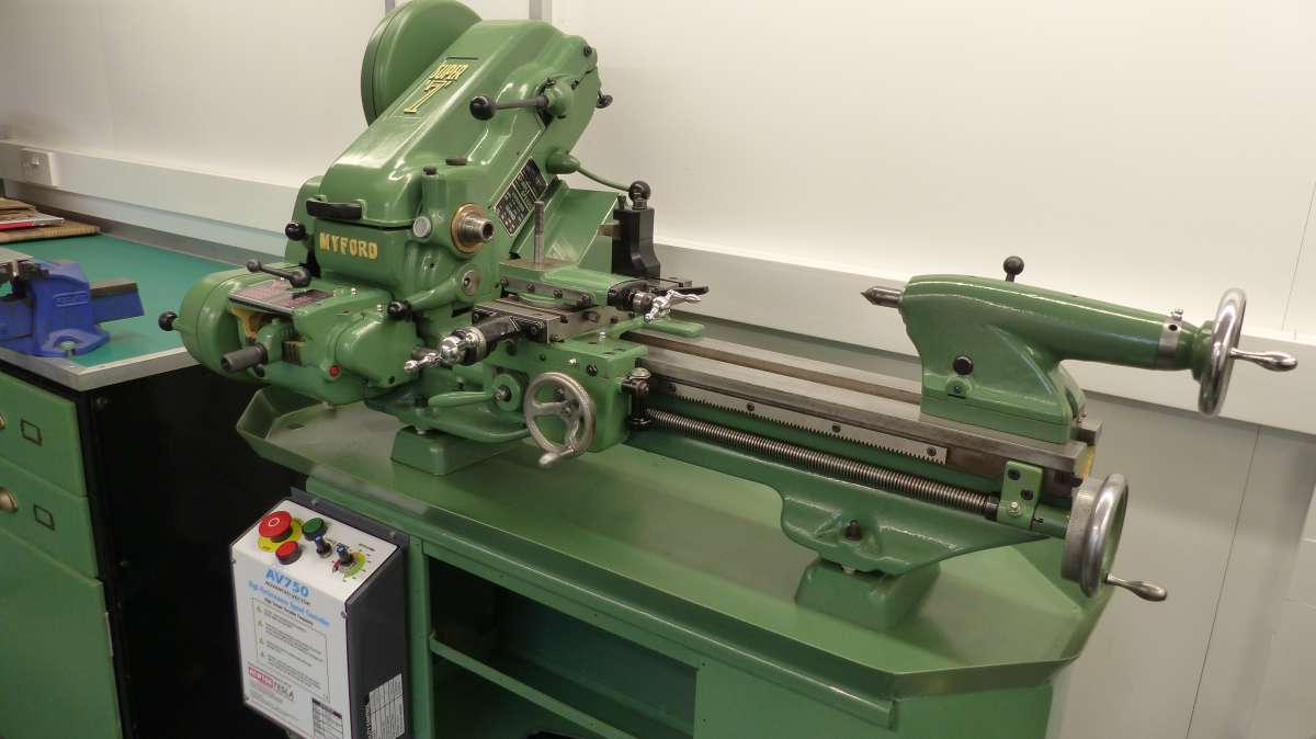

              Last set of photos:-
              123124125127128129131132133134135136

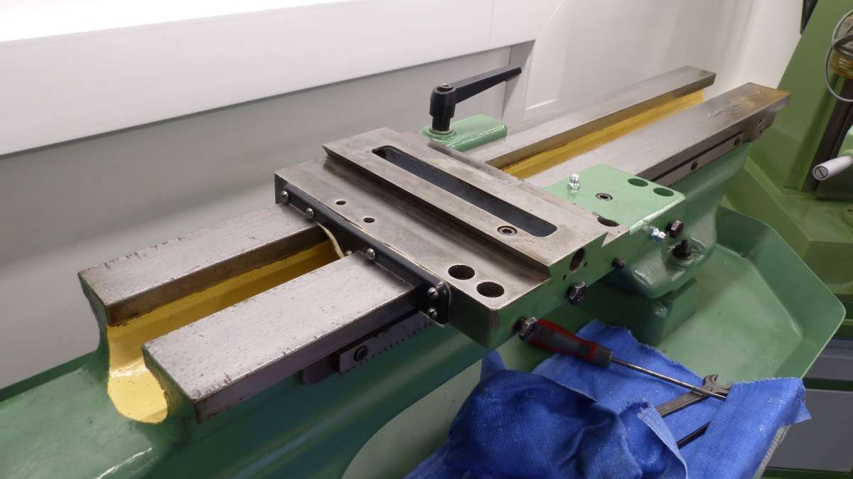

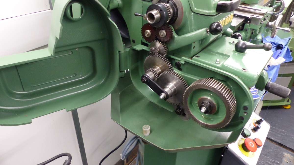

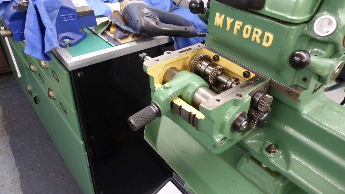

              The Carriage refitted with updated locking lever. Gearbox end cover left loose on leadscrew while drive gear secured,then bolted in place.
              inner drive guard refitted,stud at bottom will have nut and washer fitted before locking stud into gearbox casing with grubscrew.
              Outer guard re-hung on hinge pins,note rubber bumpers made from suitabe ‘O’ ring stock.
              Carriage,saddle,cross slide and compound re-fitted, feed screws and nuts were all servicable. ball handles,retaining screws and micrometer dials were all beyond saving, so were replaced with new ones from Myford.
              Saddle Handle will be replaced when I can get hold of one.
              Note telescopic swarf guard on leadscrew, and Myford rear toolpost fitted.
              I have sourced an original Dickson QC toolpost with a couple of tool holders but will need some more, has anybody tried fitting aftermarket (Chinese,Indian) ones, if so, do they fit the Dickson OK?

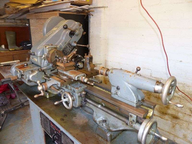

              Job finished off with new dataplate on gearbox lid,the later boxes had the same plate, so I was able to get a replacement one.
              Last photo is a before refurbishment shot to show the work involved in bringing it back to life.
              I have recently had surgery on My thumb for arthritis, so I am in plaster at the moment, but when i have recovered I will put down the floor tiles and fit a splashguard to the wall behind the chuck (which I have to clean up, 3 jaw and independant 4 jaw), and fit the nameplate to cabinet and pop the cork mats on the shelves.
              I will put a new thread up detailing the workshop refit when it is complete.
              Many thanks  to everybody that has helped and followed Me along on this journey, I can only apologise for the length of time it has taken to get to this point, but as They say ‘Life has a way of getting in the way’!

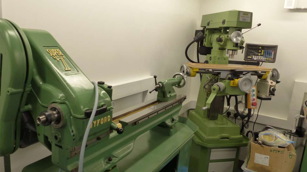

              Looking forward to making lots of swarf, and getting to grips with the Miller as well!!
              Many,many thanks to All,    Morty

                What a difference,  looks like new lathe, lovely restoration Morty.
