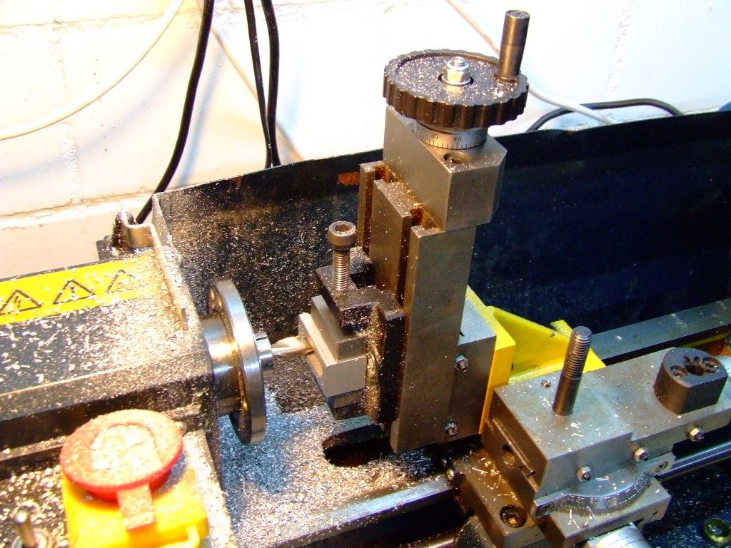

                      Milling on a mini lathe is quite feasible. Basic requirements are a vertical slide, some clamps to hold things to it (gravity is not your friend here when trying to set things up), some collets to hold the milling cutters and some milling cutters. Here are a few pictures of set ups I have used when I was starting out:

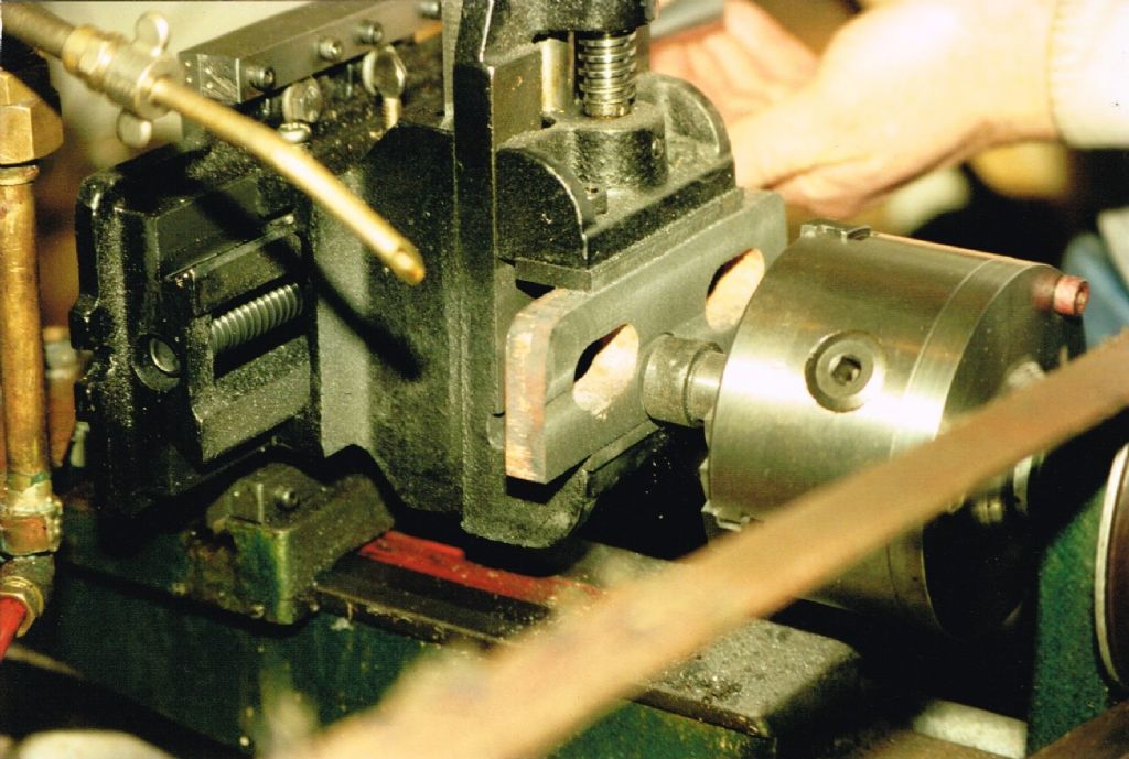

                              Hi, I've found a photo of a piece of cast iron that I milled in my father's old lathe, using a 3" cross vice and a home made fly-cutter. The cross vice had to be mounted on a fabricated plate, which was attached to an angle plate. It was a bit of a "Heath Robinson" idea, but it worked, and got the job done.
                              Regards Nick.

                                I think the Warco super mini lathe follows the ubiquitous 7X pattern, and therefore has a relatively short travel cross slide without T slots.
                                In order to fit a vertical slide it will be necessary to drill and tap some extra holes in it, either to fit a vertical slide bracket directly or to fit a 'boring table' that can then be drilled to suit whatever slide fittings are necessary.
                                This was my arrangement:
                                The boring table is secured using the top slide securing bolts / dowel at the front and an extra couple of tapped holes and a dowel at the rear
                                The fasteners can be accessed with the vertical slide in place so the whole boring table can be removed without disturbing its alignment.
                                FWIW, these are the dimensions of my plate – it was made from a laser cut piece of 12mm thick steel sheet with the surfaces 'as is': (I wouldn't bother with the 3/8 dowel holes again)
                                I sais that this *was* my arrangement: I have since done away with the adjustable angle bracket to try and make the arrangement more compact and rigid (relative term!). A carriage lock is a must!
                                Although limited, it has its uses:
                                The cutters are held directly in the spindle using morse taper 'finger' collets and a home made draw bar (suitably long bolt with a simple collar to bear on the rear of the spindle).
                                I also made a handwheel for the leadscrew to give a 'Z' feed:
