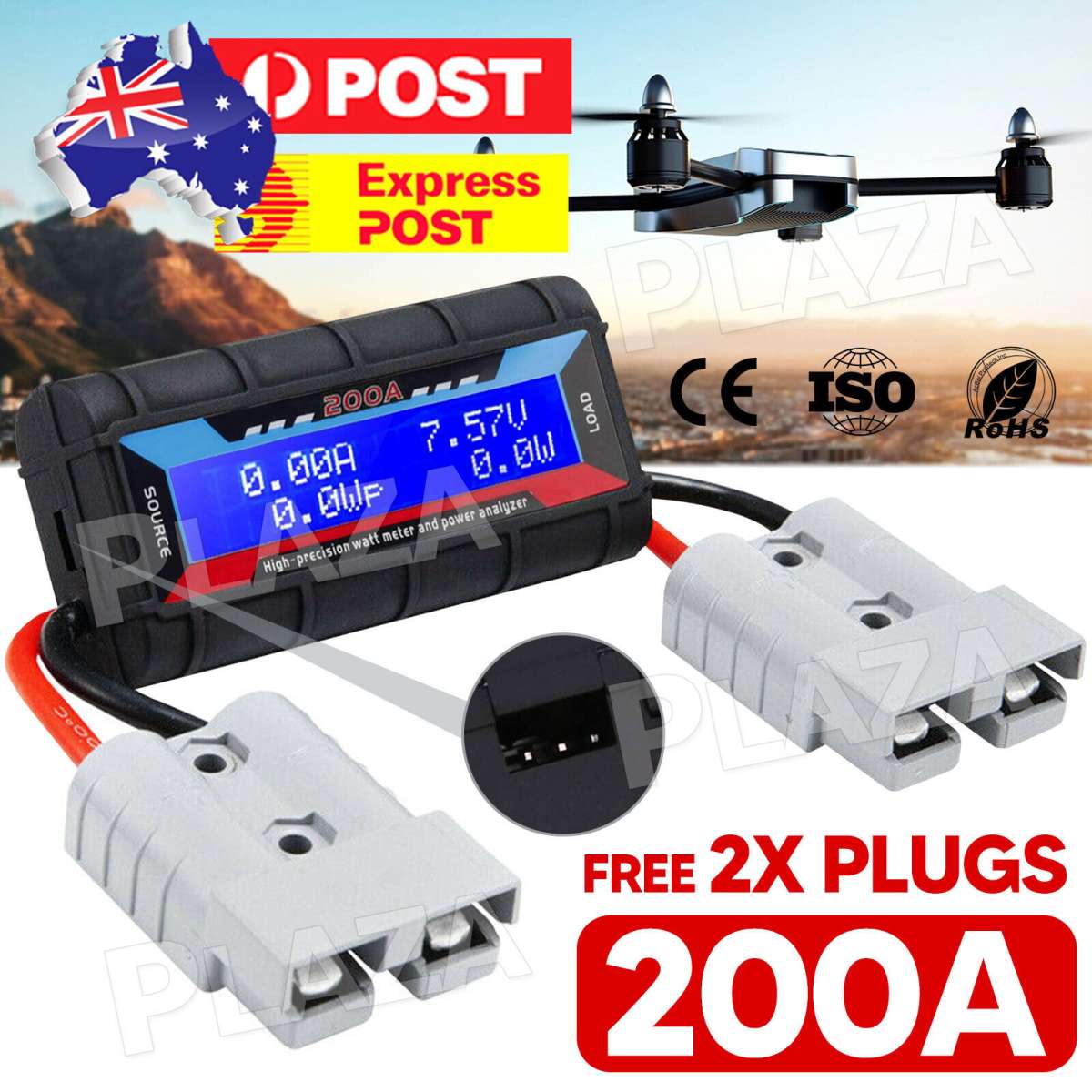

                  Paul Lousick
                    @paullousick59116
                    #726616
                    duncan webster 1
                      @duncanwebster1
                      That looks useful, available in UK at ~£10, thanks.
                      #726630
                      Paul Lousick
                        @paullousick59116
                        Having Anderson connectors on all cables enables you to plug in the meter at different locations to measure volts and amps. Input and output from the solar controller will give you an indication of its efficiency.
                        I have replaced my original PWM controller with a Victron MPPT which is more efficient. It is controlled from my phone and monitors power usage throughout the day.
                        #726656
                          On Paul Lousick Said:
                          I use one of these on my solar system when camping. (no blue smoke if connections are reversed) …
                          I don’t think Paul’s meter does what Duncan needs.  Digital ammeters seem to come in 3 varieties, all provided with a choice of shunts between 10A and 100A:
                          1. Most basic, measuring positive amps only, and I guess the device will probably fail if the output voltage is raised higher than the input.
                          2. Better version of the above, Paul’s example, protected with a rectifier so that the output voltage can safely be higher than the input.   But as far as I can tell from the spec, these don’t measure negative amps, would probably read zero A, which isn’t what Duncan needs.
                          3. Meters measuring both positive and negative amps, equivalent to Noel’s centre-zero analogue meter, that measure when a battery is charging or discharging.    They seem less common, but the giveaway is ± in the spec, and a minus sign on the amp display.
                          When I looked yesterday I couldn’t find anyone selling centre-zero analogue ammeters!   They must exist, but perhaps yet another technology going the way of the Dodo!
                          Ought to mention that digital ammeters are sold in both professional and consumer grades, the later description being a euphemism for “cheap and cheerful!”  The pro-grade versions are 4 to 6 times more expensive and may be worth the extra if the installation is exposed (not inside a comfy house), mission critical, or difficult to replace if the meter goes wrong.
                          However, if easy to replace, not mission critical, and the installation is done by a volunteer, then the domestic version is likely good enough for amateur purposes because up to 4 or 5 replacements will be cheaper than coughing up for one good one.    Different game when a North-Sea Oil Rig needs a meter to be reliable for 10 years, and an installer has to be helicoptered in to do the work.  In those circumstances, the purchase cost of the meter is small beer, so don’t economise on ebay!

                            Dave has beat me to it I don’t think Pauls item will work as Duncan wants ! The connectors are a clue to the sort of amps involved big ones not 300ma. checkout The Component Shop for small digital meters. My multi meter would do it but at nearly £300 15 years ago although waterproof it gets looked after. If something is leaking electricaly then a run through the wiring and system should find it, have the panels got tired, or the battery died ? Noel
