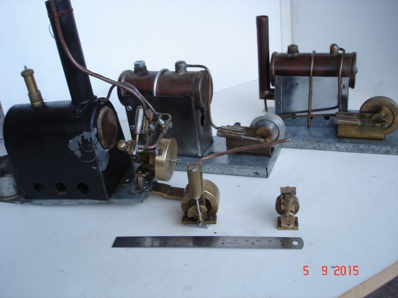

      #322794
      Ian S C
        @iansc
        Brian, good one, that looks a powerful little engine.
        On the last little boiler I made, I took the sides of the furnace and extended up and over the top of the boiler, leaving a gap of about 6 or 8 mm, I extended the bushes for the saftey valve and the steam out let to clear the casing, and this allows the heat to be directed at all the boiler surface. All it needs now is an engine that looks ok. Its the left one in the photo, I painted it with barbecue paint ?? heat proof. The steam engine is a 90* V twin wobbler.
        #322812
        Brian John
          @brianjohn93961
          That looks very neat but I am not sure my sheet metal working skills are up to it ! I might give it a go next time.

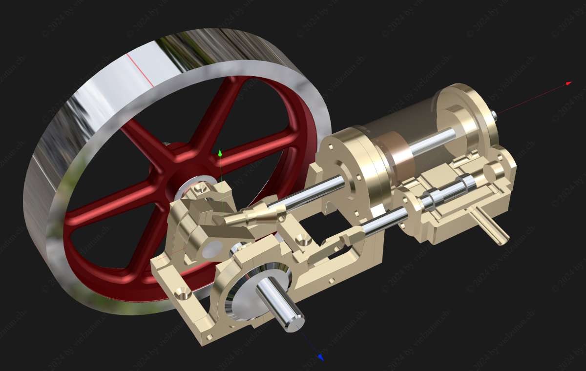

            Gentlemen,
            I’m aware that I’m joining this party a little late, last post being more than six years ago. Anyway, I just recently finished my own copy of “Danni” and it runs like a charm. Since I hate purely “me too” posts just as muchg as you do, here’s something fans and builders of Danni alike may appreciate:
            I’ve created a true to scale Interactive 3D Animation of Danni and published this on my website. Requires JavaScript to view – no strings attached. No fees, no registration required. The animation is generated in real time on your viewing device, be it mobile phone, pad or desktop computer. I’ advise to use a latge-screen device though.
            This is NOT the pre-computed or pre-rendered youtube-like stuff! Expect to be stunned:
            Here’s the link,
            https://vielzutun.ch/wordpress/Danni_animation/Three.js/Main.html
            and this is a teaser image:
            Danni_Rendering
            This animation becomes “interactive”, because you can
            • rotate the spinning model by mouse left-click&drag
            • pan the spinning model by mouse right-clicking&drag
            • zoom in/out via mouse wheel
            There’s also a screen menu which allows you to alter the animation speed, stall/restart the animation, unhide/hide those little screw heads and choose from hexagonal allen or torx form or ‘none’ (default), brass, stainless steel or mirror-like material or none.
            My further interest in Danny is not in letting it run as fast as possible, or powering some secondary device like a dynamo – quite the opposite: I’d like to tweak it to the minimum stable revolutions/unit of time. Currently I’m already down to approx 1/second, with the stock 80 mm flywheel.
            Feedback is welcome. My blog, which is – alas – german only, is rich in Photos, videos and computer-generated illustrations. The text blocks in between could be translated with the help of deepl.com or similar translation services.
            Enjoy!
