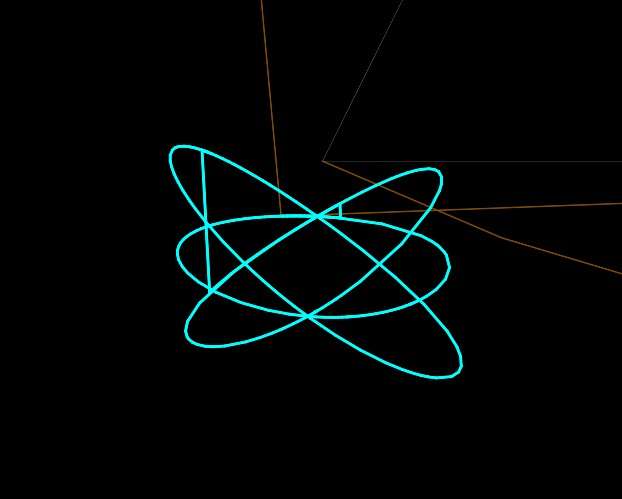

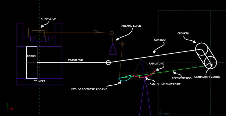

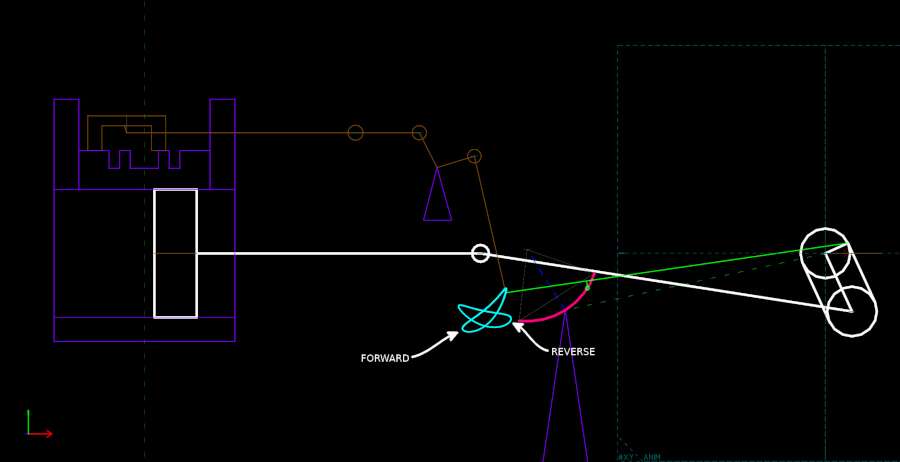

      I was re-drawing the Firth valve gear design from John Haining’s Superba/Z7S to 1:12 scale and metric dimensions. I’m using OnShape, which has the facility to animate assemblies, and the re-drawn Firth gear didn’t seem to work properly when animated.
      Unfortunately, OnShape does not (as far as I know) have any means to get numerical data from the animation. I had a look for (free) mechanical design software and found, slightly to my surprise, that there was little suitable. Eventually I tried Solvespace, which is intended as a CAD solid modeller, but includes a constraint solver for mechanisms. I wouldn’t say that it’s the greatest, user experience-wise, but it does the job, and it can trace the path of selected points – this is relevant, because the valve rod connection in the similar, but simpler, Hackworth gear is supposed to trace an oval path. This design does not:
      FirthValveGear_JH
      The cyan coloured squashed oval object is the connection path with the radius link set at at the forward-reverse mid-point. Since the ends represent the extremes of the valve movement this means that the valve moves more or less at constant velocity in one direction, and shows continuous acceleration and deceleration in the other. Which doesn’t sound desirable.
      It’s even worse at full forward or backward gear (edit: The curved link is in the backward gear position in the pic):
      FirthValveGear_20deg_JH

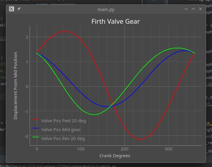

      I plotted the valve movement on a graph:
      ValveGearCurves
      (The ‘Mid Position’ referred to on the Y axis is actually zero at the extreme ends of the piston travel, front and back – I tried various ways to present these data and didn’t get round to changing the axis label).
      You can see on the mid gear curve that one section approximates a straight line, corresponding to the flat side of the traced path, whereas the other half of the cycle is more of a sine wave. The other setting are even worse.
      It’s clear that this isn’t going to work at all well, so, does anyone know the secret to getting Firth gear to work? It looks a bit similar to the Southern gear, but the eccentric rod is actually guided along the curved link, which is what generates its rather strange movement. I wondered if this is supposed to be cancelled out by the arcs that the rocker links travel through, but experiment seems to show that this isn’t the case.

          It does not look an ideal gear for anything, but I don’t suppose Fowler reversed the geometry so that the forward gear was the one with the better steam distribution?
          Road vehicles, apart from rollers, don’t need work very efficiently in reverse so although still a compromise, making the forward gear the more accurate would at least partially “work round” the problem.
          So what happens if you move the eccentric setting 180º – putting it on the opposite “side” of the crankpin?
          The curvature of the radius-link may be the main culprit: the smaller its radius the more the distortion and this could be with a very small radius change.
          The Firth gear is new to me but it looks like a “straightened out” Hackworth gear.  I have observed when trying to trace a problem with a ‘Wren’ locomotive that with Hackworth gear the more the die-block guide is set from the mid-gear alignment the more the connection-point locus distorts from an ellipse to a stylised whale. I’ve think I’ve also found this on paper with the similar Marshall and Bremme gears. These simple radial valve-gears don’t like being over-driven.
          Tightening the radius link curvature might increase the effect, and success of this gear seems to depend on a fine balance between the radius and the angle to which the link is rotated.
          I do wonder why Fowler used this, and how they made it work: they didn’t cheat by using unsymmetrical ports or valves, did they?
          I’d suggest first seeing what happens with the eccentric put on the other side, then modifying the radius-link radius a very small bit at a time to observe the effects in full gears, mid-gear and a couple of intermediate notches in both directions.

            The only Dockstrader simulation I could find that seemed vaguely similar was the Southern – this could be a backup option, since I think it could be re-arranged to fit a traction engine layout, and look quite similar to the Firth design.
            Nigel – yes, I wondered why they went for this. It saves a bit on ironmongery compared with Stephenson’s, but since these were Fowler’s top models and doubtless very expensive it seems unlikely that was the reason. I read somewhere that as well as being used on ploughing engines, they used it for rollers – piston valved in both cases.
            I did try having the eccentric 180 degrees the other way, to no avail, also using a straight link a la Hackworth – in mid gear this looked promising, producing an oval trace, but forward and reverse suffered the same kind of ‘stylised whale’ distortion (at least I’ve got a name for it now).
            I should have mentioned that the above simulation was done using the dimensions from Haining’s ME articles – he does mention having spent a considerable amount of time trying to get it to work.
            It may indeed be that Fowler’s used some extra cheat to get it to work – I wonder which rollers it was fitted to; the ploughing engines with it seem to have only been superheated export models, it may be none exist now to find out how it was done.

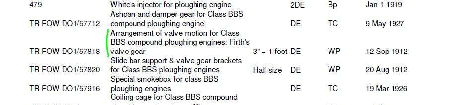

                  Might be worth seeing what MERL have on record, looks like they have the Firth Valve gear for the BBS and some of the valve parts for the Z7S. You could overlay Hainings ontop of those and see how things compare.
                  The BBS drawing is the same as the one in Gilbert’s book but will be a lot bigger at 3″ to the foot.
                  bbs

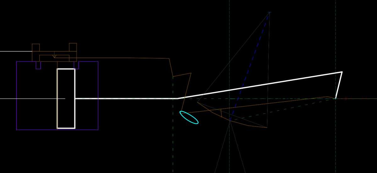

                        Well, some progress. I used the dimensions, in so far as they could be ascertained, from the Fowler drawing, and the results looked far more promising.
                        This is the path traced by the eccentric rod end for forward-, mid-, and reverse gears (ignore the vertical lines):
                        FromFowlerDrwg

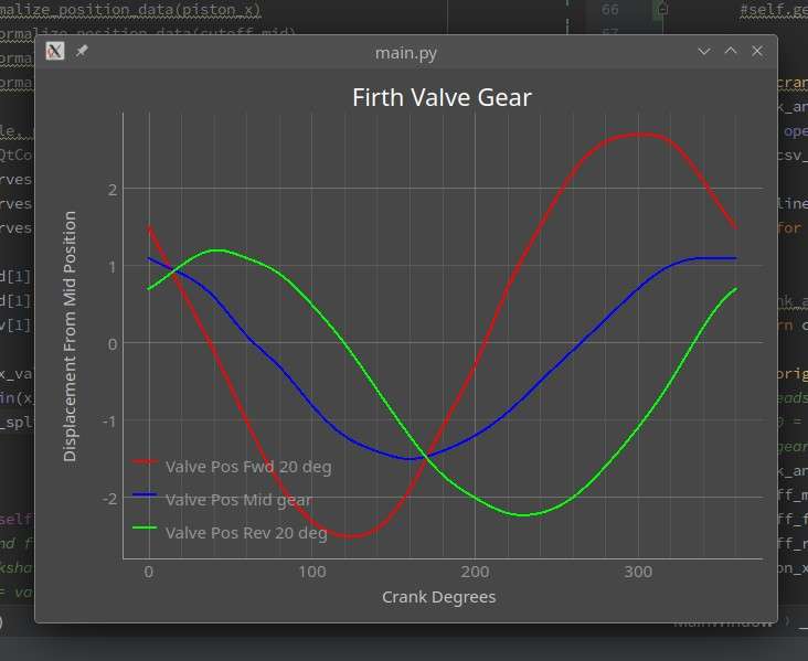

                        And this is the plot for valve movement:
                        CurvesFowler
                        The slight lumpiness is probably down to the difficulty of rotating the crankshaft to exact values in Solvespace (you can do it numerically, but the process is rather tiresome).
                        So not, perfect, but getting there.

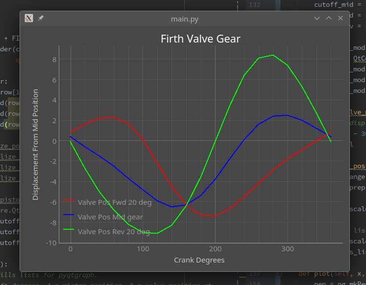

                          A slightly improved version (with the direction of the curves reversed which makes more sense to me – I think):

                              An update:
                              I ended up building a simulation in FreeCAD using the Assembly3 workbench, and a Python program to display the results graphically (thanks to Duncan Webster for sending me some information on valve gear design), and ran many, many test of different configurations of the Firth gear.
                              I found that it was possible to get a pretty much perfect distribution for both ends of the piston stroke, and forward and backward directions. Unfortunately, this could only be obtained by (considerably) lengthening the rocker arms so that, effectively, the distortion that this introduces counteracts the intrinsic distortion from other parts of the valve gear, but with the undesirable effect of imparting excessive side thrust to the valve spindles.
                              I decided to splash out on getting copies of the works drawings from MERL. There aren’t very many for the Z7S, but there is an arrangement drawing for the motion gear (drawing no. 57361), and although it isn’t dimensioned, printed full size on A0 paper it’s possible to measure dimensions from it accurately enough (especially given the fact that it’s going to end up scaled to 1/12th).
                              I found it was very different from the John Haining drawings – I guess that he had to do considerable alteration to get it to work with slide valves. I’m going to go with the original piston valves, which may be challenging at this scale, but what the hell, the whole thing’s going to be challenging.
                              The valve event plots look pretty reasonable – good enough to be getting on with designing the rest of the engine, though there could be room for some tweaking later (annoyingly FreeCAD proved very cranky doing this, and now refuses to get the previous simulations to work – there is a new assembly module in version 1.x and I’ll try re-building everything in that to re-test).
