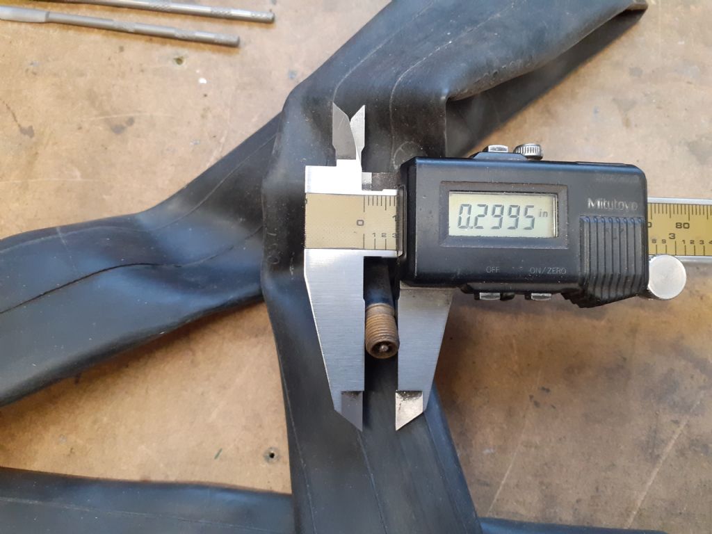

        Hi
        Can anyone tell me what size the thread is on the outside of a schraeder valve
        Thanks
        Dougie
        #519545
        Jeff Dayman
          @jeffdayman43397
          They are .302" x 32 TPI on the outside.

            noel shelley
              @noelshelley55608
              .302 sounds wrong ! 2 sizes ! There is the one used on smaller vehicles .202 od and a larger one for BIG vehicles. Cant find one at the moment. Noel   Ah yes ! Valve cap size is .306" X32 or.8mm for cars.

              Chris Evans 6
                @chrisevans6
                All the sizes are on the net. I get away with 5/16" x 32 tpi for the bigger ones when making motorcycle retaining nuts. The bespoke taps and dies are pricey for the odd nut.

                  Don't know what you class as a small vehicle Noel but this is a mountain bike tube, same fitting as all the cars I've ever hadsmiley

                  noel shelley
                    @noelshelley55608
                    I was thinking schrader valve not valve cap, so Yes jason your right ! That one is under size according to my schrader,michelin tool, .306". See edit. noel
