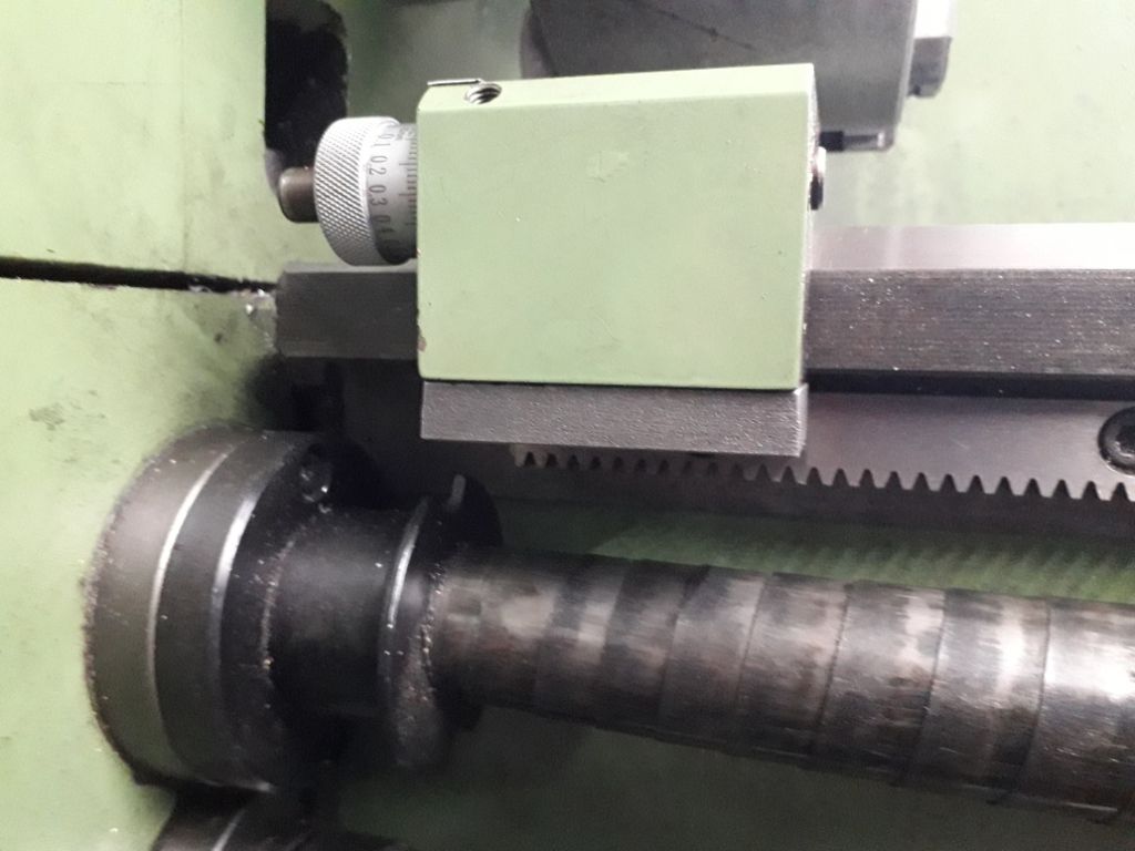

                                                Henry Brown
                                                  @henrybrown95529
                                                  Posted by Clive Foster on 08/11/2020 14:47:18:
                                                  I'm intrigued, how do you make a micrometer stop a bit of a fiddle to set up when you have a saddle travel dial.
                                                  Clive,
                                                  The issue is that the clamp is a right fiddle to get the stop onto the bedway due to the proximity of the covered leadscrew to a couple of fiddly cap screws that act on the clamp plate. I had another look at it this morning and it occurred to me that I could probably modify it a little to either replace the cap screws with hex head screws or drill a hole through from the top and have the clamping action made from the top rather than underneath. Another job for the roundtuit…
                                                  Henry.

                                                    #506192
                                                    Henry Brown
                                                      @henrybrown95529
                                                      Derek, I took my stop apart this morning and the thread is pretty crude (12mm fine pitch) so I'm not expecting it to be very accurate on its own.
                                                      Maybe you could fashion a cover to keep the worst off?
