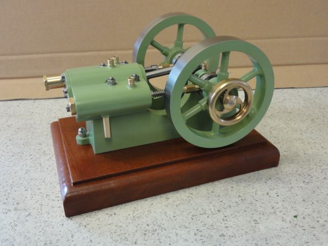

                    As Jason says I built a Jowitt from his plans.
                    You may see the resemblance. Being a bit careful with a penny, I made the flywheels rather than buy in a pair of castings. The wee brass pulley came from my come-in-handy drawer.
                    Jim

                        Very nice Jim, I hope mine turns out as well.
                        I think it a really nice looking engine, the shapely cylinder block and the twin flywheels. Also watching Jasons videos it sounds good to.
                        Ron

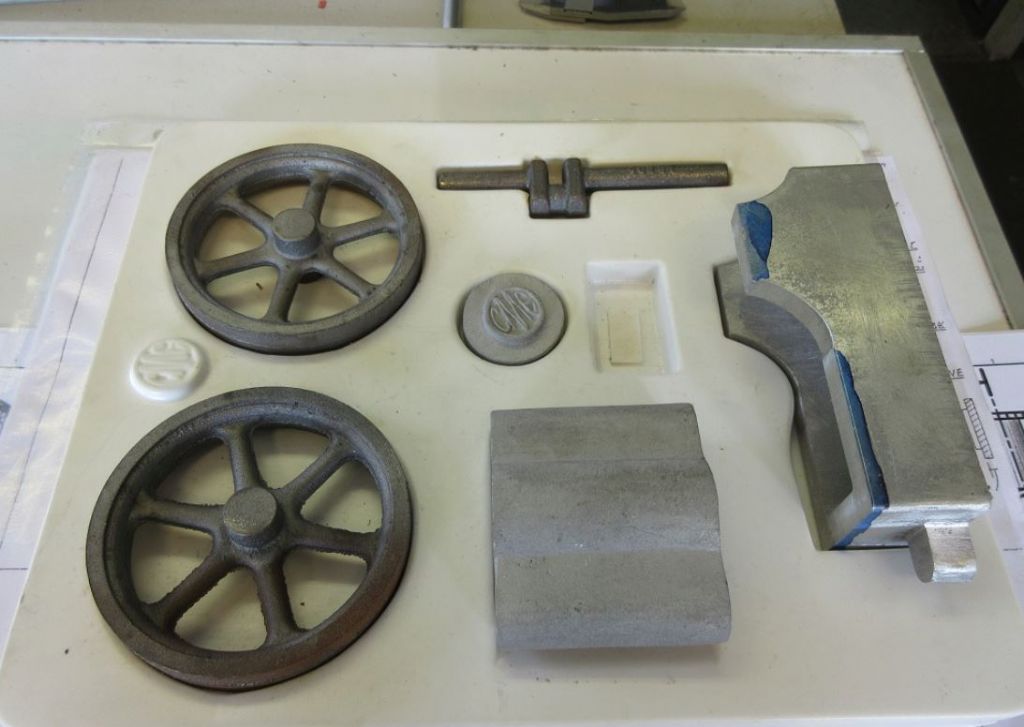

                            Bill, I give some history of the engine in my thread here
                            I don't think I had this photo at the time I did the build but it shows most of an original casting set with aluminium cylinder casting. Photo by Jo T.

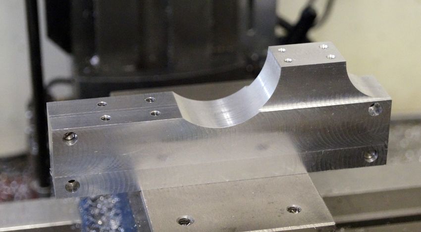

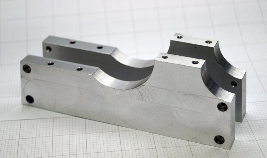

                                The side frames are just about there, still need to machine the 3.6 degree angle to the ends and sides. I have sent off for a digital protractor, I have been meaning to get one for a few weeks so now is a good time.
                                I machined most of the side frames with the ARC 25mm two insert end mill. I have been using it a lot lately, very good should you need to remove a fair amount of material and the surface finish is excellent, really impressed with it.
                                #452711
                                  Ron, the angle is not critical but if you can't wait for your new toy 3.6degrees works out quite close to 1/4" in 4" or 3/8" in 6" so easy to arrange some packing at those distances to set things up.
                                  #452721

                                      Up early and machined the angled ends and sides, went well and the transition to the vertical at the crank mount turned out ok.

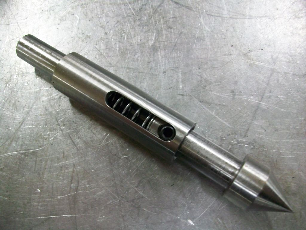

                                          Would anyone know where I can get a sprung centre for the lathe, I must be looking in all the wrong places as I havnt found one yet, well I tell a lie I found one but I am not paying £56 for one.
                                          I also wondered if its ever been featured in tool making over the years, I cant imagine they are too complicated.
                                          #453230
                                            I know a very nice man who would be only too willing to sell you one. or even more.
                                            Personally I don't use them just a bit of silver steel with a point held in the tailstock chuck and push the tailstock to keep the pressure. Hole in the other end drilled with a CTR drill will allow you to use taps that don't have a hole in the end.
                                            Or are you looking at my long one for setting up work in the 4-jaw?
                                            Edited By JasonB on 20/02/2020 15:53:15

                                                Thanks guys but maybe my description is wrong, I dont mean a sprung tapping guide the ones I have seen are a length of bar, I,m guessing but maybe 6-8 inches with a small sprung centre. Used with a DTI in centering a workpiece in the 4 jaw, you have a picture of one Jason in your build thread when doing the cylinder..?

                                                      Is this what you are looking for? I made this out of a bit of bar in the"will come in handy" box. One of the first things I made with my 1906 Drummond lathe.pumpcentre2.jpg
