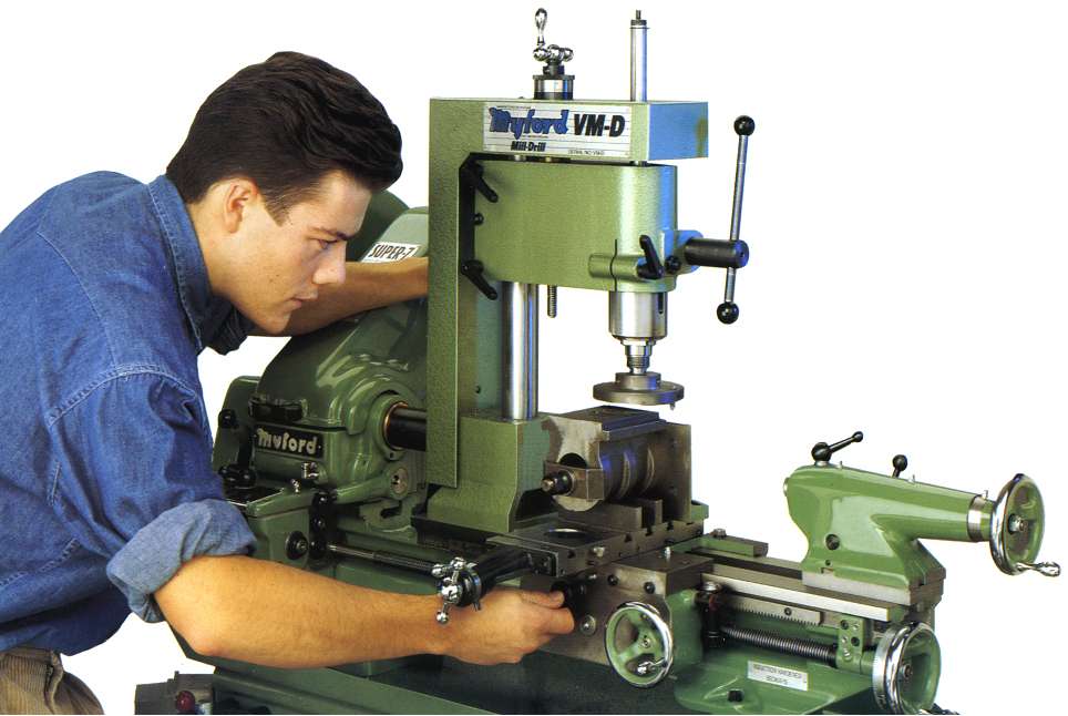

      Good Evening,
      I am a complete newbie, and back in May bought a 1955 Myford Super-7B which I am really enjoying learning to use.
      I would like to expand its (and mine) capabilities, I am considering a Rodney VM-D vertical milling attachment, but have read elsewhere that the ‘D’ is in some ways actually a step down from the earlier versions….
      I am clueless in this respect; can those more learned please advise if the VM-D is a worthwhile addition, or is there a better route to go down??
      I am limited in terms of space, and also funds – but appreciate that this isn’t necessarily a valid reason for not creating ‘space & funds’ if there is a more viable alternative… many thanks in advance 🙂

              Notice that old advertising photograph is so staged there is not only nary a scrap of swarf or oil anywhere, but the operator has not plugged or covered the top-slide hole to keep the chips out!
                    And no safety glasses!!!
