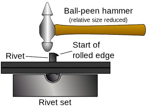

      Can anyone please point me in the direction of the correct dimensions for the hole in first stage rivet setting tooling as opposed to the domed snap tool for finishing rivets; and the amount of rivet projection required for tidy doming ..
      I am having great trouble getting decent finished domes and I think its beacuse I am
      A not getting the correct amount of material projecting and
      B not using suitable setting tools.
      Many thanks
      Brian K.

          Brian the form and size of the dome that you want to create is dictated by the grip length, the final closed length between heads, and the diameter of the rivet itself. The easiest way to get the right size is to refer to copy of Machinery's handbook or similar tome which will have tables to help. You may need to extrapolate and then experiment to get the final size right.

              Teh hole in the set is not that important, just a bit bigger than the rivit shank so something like 3.3mm on an 1/8" rivit, 4.8mm on 3/16" and so on.
              The amount projecting is slightly affected buy your snap as they do vary a bit but the correct projection for imperial snap head rivits is 1.429xD, treat this as a starting point and do a few tests in a scrap of known thickness and then adjust the lengths to sue whatever thicknesses of material are being joined

                    Hi Brian,
                    are you rough forming the dome with a ball peen hammer before using the snap?
                    Regards
                    Terry

                                the standard method for domed rivets is to set the joint, form the dome with the ball peen and then final finish is with the domed set. If you try to shape the rivet solely with the set the rivet will bend and produce a very poor finish. Soft iron rivets should need no annealing.
                                I have always used the 1.6 x dia for the dome allowance plus the required length, this gave good results. There was a good article which included advice for rivetting just a couple of years ago. I will look out the reference.

                                  Brian, I use the set to push the layers together, this does not start to compress the rivit and then unlike Terry I go straight at it with the rivit snap and a few blows are all that is needed.
                                  The ball pein is ok if you are working with a rivit in a nice flat accessible position but once you have formed a couple of hundred rivits on traction engine wheels where you can't get in with the hammer you soon get the knack of only using a snap. The other risk of using teh ball pein is that if you take a lot of little taps at the rivit you can start to work harden the end which makes it harder to form the final snap.
                                  I have seen the staged formers used on cold rivits with good results usually in conjunction with a jig to hole the formers upright and a hydralic press. Not really needed on anything below 3/16" though. I'll see if I can find some pictures, the ones I know of are only viewable if you donate to teh particular forum.

                                    Just looked for the phoyo but they will not be available, If anyone has Edward George's (Martin Wallis in ME) book he has a couple of pages detailing forming the rivit in 4 stages
                                    Set
                                    Flat ended tool to inittialy spread the rivit
                                    Cone ended tool to get a good spread at the bottom
                                    Snap to form teh final snap head
                                    This is what he used on his 1/2 scale Fowler with just a club hammer and a pair of ear defenders.
