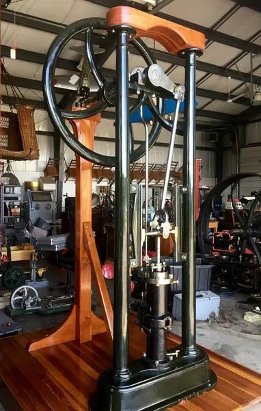

                              Cylinder on the floor crankshaft up in the air was quite common, the next step up from beam engines. There is a twin cylinder one in Bolton steam museum (nmes.org). For fellow pedants, cylinder up in the air and crank on the floor is correctly called an inverted vertical, but I suspect this has gone by the wayside.
                              Edited By duncan webster on 22/05/2022 20:56:48
                              #598923
                                And that is why Andrew Smith gave the model this name because it is a "real" or true vertical and one with the cylinder at the top is an inverted

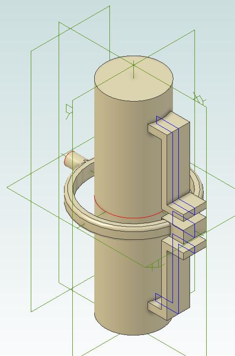

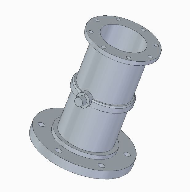

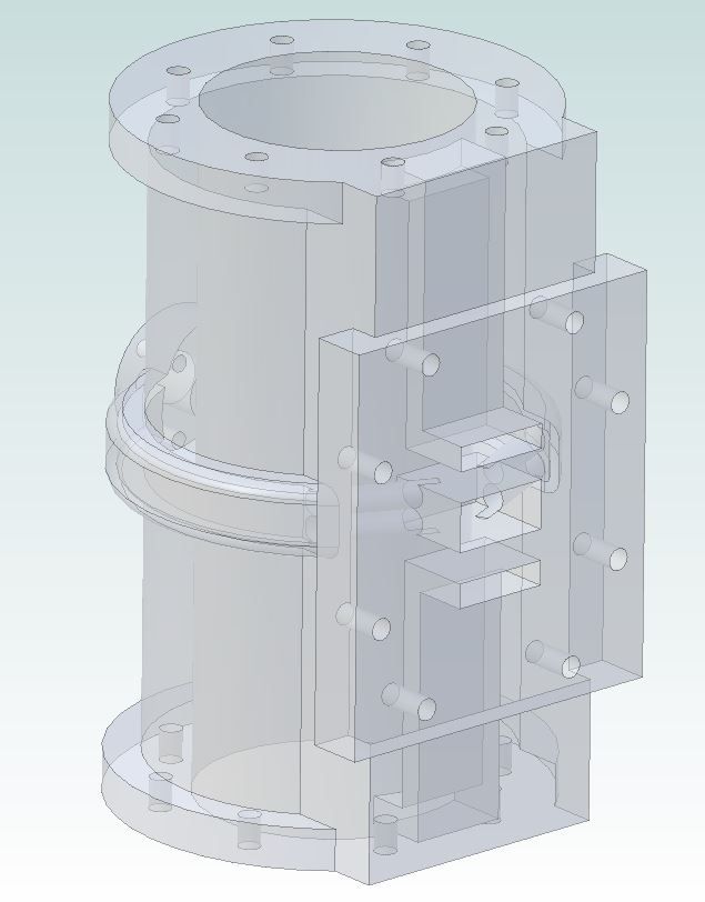

                                  The rear view transparency confirms an interesting detail: the exhaust is carried around the cylinder to the boss-thingy on the front, which would keep the cylinder hot. As the hollow band is more complicated to make than a steam jacket, I wonder if the idea was to concentrate heat at the cool point in the middle where the piston spends most of its time. I often focus on the quaint look of early engines without noticing the design is technically clever too.
                                  How would a hollow band around a cylinder be cast?
                                  #598979
                                    I don't think the wrap around exhaust would have done a great deal in teh way of cylinder heating a sthe area in contact with teh cylinder wall is quite small, mor ejust a way of getting the exhaust connection to where it was wanted. As can be seen on this full size engine the heating would be minimal
                                    As for how the part would have been cast that would have been done with an extra cor. As well as the main core forming the rough bore and the two dog legged ones for the inlets the stubby one for the exhaust port would have been extended around the cylinder and supported at the other side by a spigot which would have made the boss hollow and have been located in a suitable core print on the pattern.
                                    To convert the Stuart side exhaust to the front exhaust needs a cunning planwink

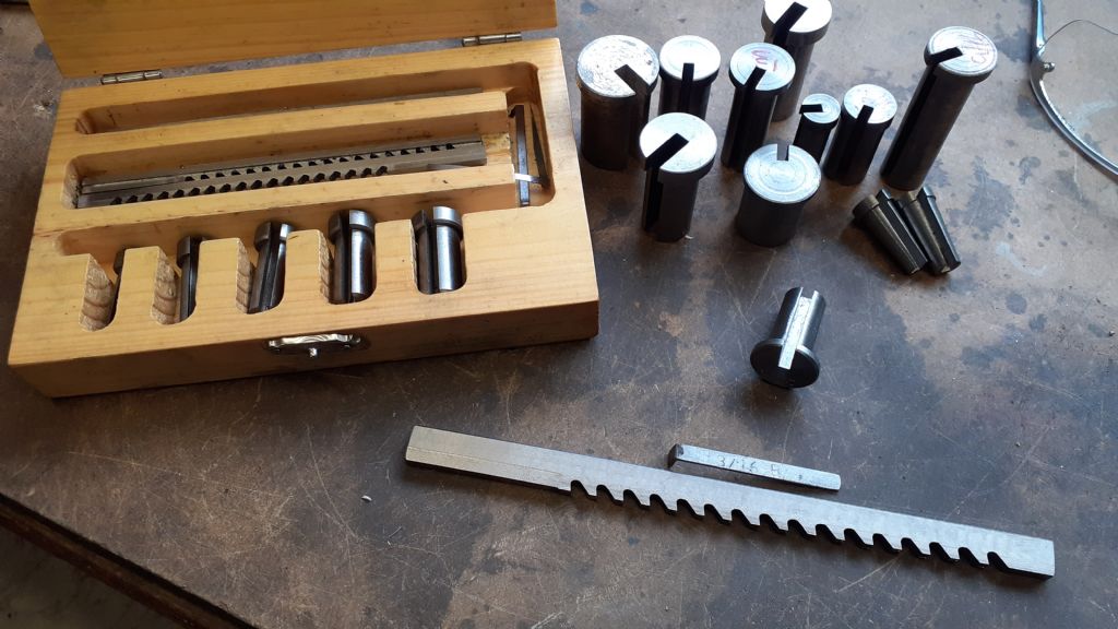

                                          It was a commercial broach but I made my own bush for it with the required taper. These are quite simple to make – just a top hat shape to fit the bore and long enough to support the broach for at least the full depth of the hole. After turning the bush is held in the mill vice at the required angle 1:100 for metric and 1:96 for imperial which is about 1.75degrees and a suitable slot cut into the bush. I've built up quite a few over time of different diameters an plain or tapered The one laying down on it's own is the one I made for this job.
                                          The key I either cut from gauge plate or rectangular section key steel if I have it, again setting to the angle and milling the face that will touch the flywheel. They are then blued and fitted using a fine but sharp file, I find if the stock is left long it gives you a bit more to get hold of when you need to remove the key to see where metal needs to be removed.

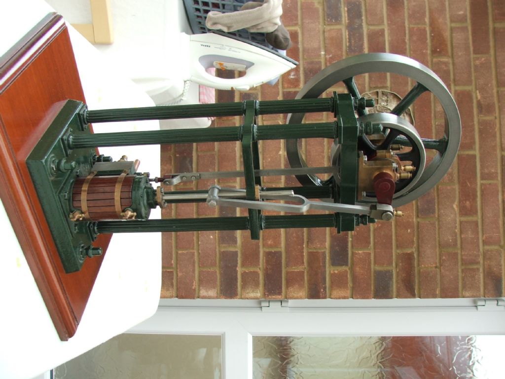

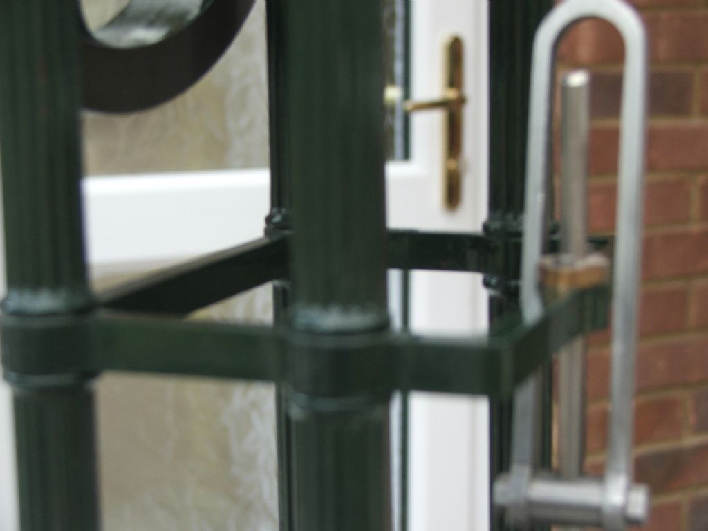

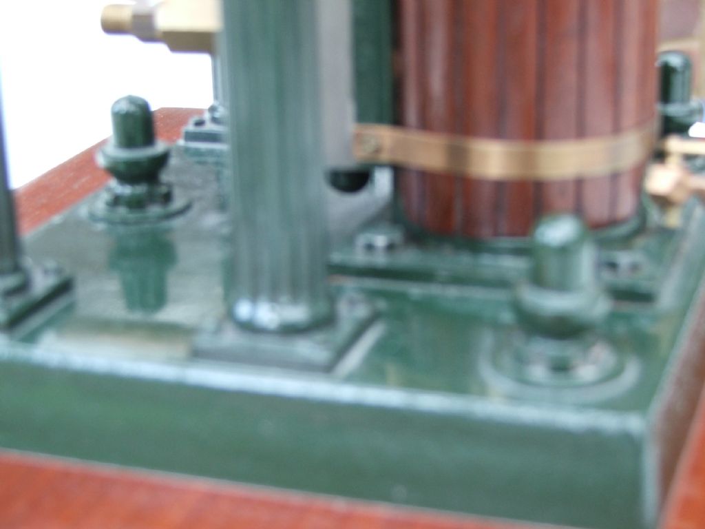

                                                  Real engineReal engineHi Jason
                                                  Thought you mite like to see my fathers take on the real. Fluted columns redesigned piston rod support acorn nuts and a large pulley, he wanted to fit a govener but that never got done.
                                                  Paul
                                                  l
                                                  #599803
                                                  paul rushmer
                                                    @paulrushmer83015
                                                    Real engine
                                                    Edited By JasonB on 29/05/2022 14:07:18
                                                    #599834
                                                      That looks good Paul and a few other small changes I can spot that were made too.
